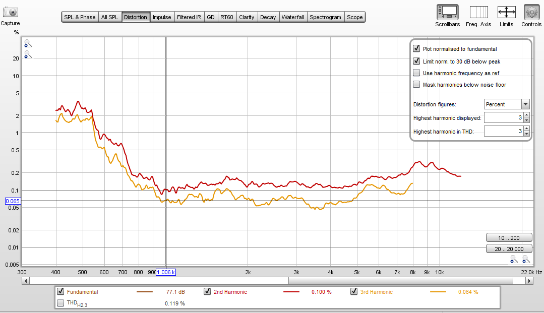

Look to your ( REW ) distortion pane ( as well as FR of course ) for guidance.
The following is the distortion profile of a Celestion CDX-1747 driver on a JBL 2344 biRadial horn ( from some of my own inventory ) .
Setup your distortion window options ( as I have done, by clicking the sprocket icon seen in the top right of my pic ).
The normalized distortion display gives a really good indication of where the driver/horn combo loses acoustic loading ( below that point, the ratio of distortion to signal starts climbing ).
- Crossing out of the horn/driver combo before that upwards climb is a very good idea!
( At normal home listening levels ) I wouldn't have any qualms in using a 1K crossover point for this combo ( assuming the frequency response also looked good in that area ).
LR4 slopes should workout & sound fine.
You have just taught me something invaluable. Thank you Earl. I will set mine up the same and double check. What else can the distortion measurement tell. I haven’t found that in any literature yet, which is why I consider all the input as “superfood”. Thanks again
