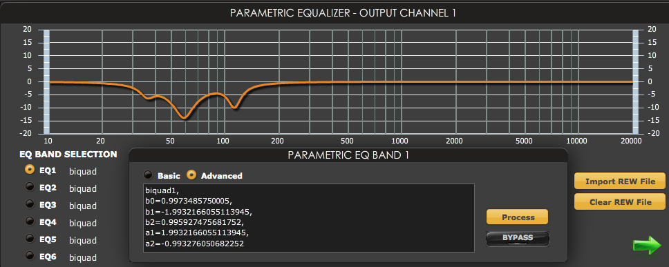

If you could maybe advise on the crossover- I would like to restart this with a clean sheet, taking advise from those in the know, and see how good we can get them to sound. I will do a FR of the jbl, and of the lowther, and post by the weekend so you can see as well. So, where should we start on the crossover��
a) Have you used the miniDSP eq functions yet (the screen that's pictured), or just the crossover function? Cos you should be able to get a better FR plot than you showed.
b) What HF horn are you using - is it the 2404H?
http://www.jblpro.com/pub/obsolete/2404.pdf
It looks about that size / configuration. Note that the spec sheet states a 3,000Hz minimum. Any horn that's substantially smaller than your 15" drivers is too small to cross at 900Hz.
So:
1st, try setting the crossover higher
2nd, apply some eq to flatten the response
3rd get a bigger & better horn

I don't think the OP is using a constant directivity horn. It looks like a 2404H, which has a diffraction slot, and very wide polars like a dome tweeter.
Thanks hollow. My horn is the jbl 2342. Much a bit larger than the 2404. If I remember correctly, they stipulate a minimum crossover point of 800, but can’t find it now
The 2342 (229mm square) has:
"Crossover Frequency: 1.2 kHz Recommended"
http://www.jblproservice.com/pdf/Theatre Series/3678HF.pdf
The much bigger 2344 (320 mm square) has:
"Minimum Recommended Crossover Frequency: 800 Hz"
http://www.jblpro.com/pub/obsolete/2344.pdf
...so moving your crossover from 900Hz up to 1,200 Hz may help.

Hi Guys..Yes, I am a salesman😀. Not wanting to sound lazy, but I am still a noob at DIY. After last nights posts, I have spent about 6 hours researching points on crossover design. What I have done so far, and please correct me where need be:
1) taken the manufacturer driver specs, and assessed them
2) based on them, agreed with hollowboy on a 1200Hz cross point
3) put the initial data into the minidsp and played around with it.
This is where I need input:
I have the Beyma SM115 starting off at 30Hz with a 48db/oct LR slope. Role off at 1050Hz with a 18db/oct BW slope.
I have the JBL 2425 starting at 1400Hz with a 18db/oct BW slope and rolling of at 18000Hz with a 18db/oct BW slope.
This means that the drivers cross at 1200Hz at -6db, and rolloff at 20000 Hz at -6db.
Am I on the right track so far? Please advise

Yes ( sort of ). There's more to it than simply picking a crossover point.
The 2425 on a 2342 biRadial horn needs HF compensation to ( essentially ) help flatten its response.
The un-compensated HF response ( of that driver on a 2342 ) will look something like this ( though this is a 2416H driver ) :
& the impedance of just the horn/driver combo will look something like this:
Are your JBL 2425 drivers the H or the J version ?
Since you have ( & can use ) REW, I suggest that you create your own frd & zma files using it.
The REW help file ( I believe ) can direct you on how to build a measuring jig so that you can make impedance measurements.
Once provided with those files, others ( including myself ) can quite easily publish an effective HF compensation network for you to build ( that'll help make that horn/driver combo sound listenable ).

Hi sir. Thank you for that. I must state, that I am not an expert on REW, however, am willing to give my best efforts in doing what you suggested. Anything that will help at this point. The more info and feedback I get, the more lost I am getting.
What should be my very first step in this process, so as to form a base on which to build?
Google "Impedance Measurement Jig"
Copy some of the pics to your hard-drive and then buy the parts to make up one of these test boxes.
In the meantime, create a measurement of your horn/driver combo ( no woofers ) from @ 1 Meter away , @ 20deg off the center axis of the horn.
Make it 30 to 40 db louder than the background noise in your room.
Zip the MDat file and then post it here.
