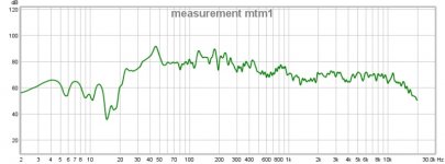

I would like to post my current measurements that I tried to take with REW using a Umik-1, and for one of you experts to have a look, and maybe help me with some further adjustments/advice.
Thanks for all the posts so far
Just need some advice on the measurements. 1- mix placed at the listening position with sweep over both left and right channel? Or 2- mix placed 1m in front of a speaker with sweep done on that speaker only. 3- individual sweeps of the bass drivers. And then kids/tops with mix placed in front of the speaker?

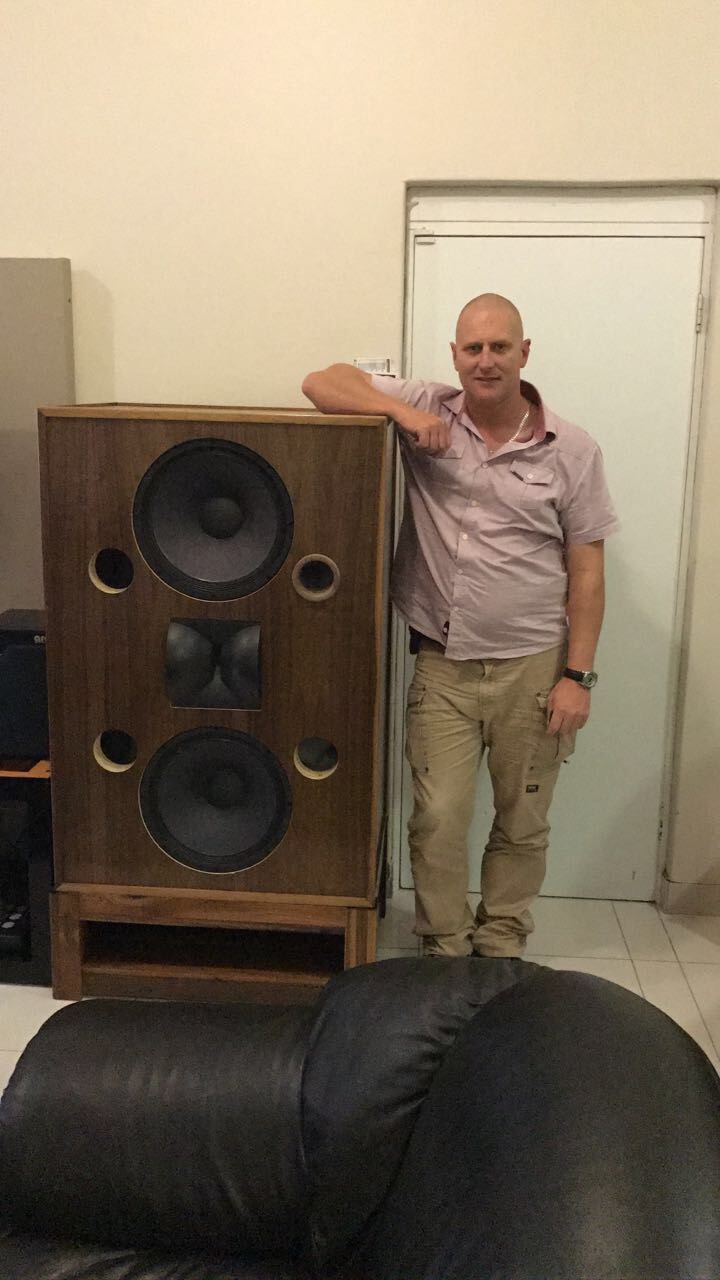

Hi guys. I'm back. sorry for going quiet, but work kept me out for as while.

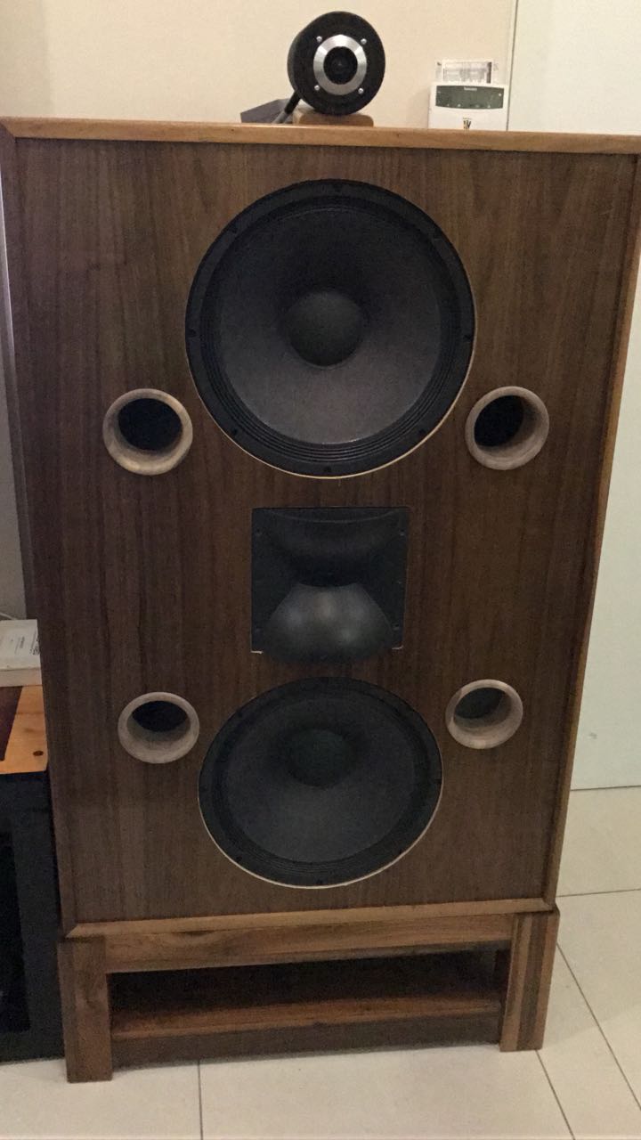

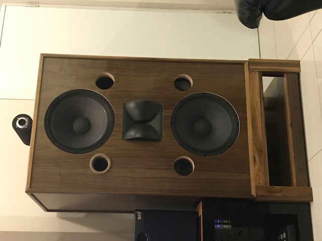

Some more info on the build. Internal dimensions are as follows:1148 h x 738 w x 520 d.
Please note that these are the internal measurements, giving me an internal volume of 440l. My ports are 85mm in diameter.
Would someone be able to help me by calculating the correct length that I should go using the Beyma sm115n which have an fs of 35hz. The ports are currently only 60mm in length, and there are 4 per speaker cabinet.

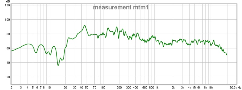

Your posted FR graph shows the range below 500Hz as +10dB relative to the treble, so it shouldn't sound thin, unless you like a very bass-heavy presentation. Was that test done in the same place that you listen?
On the FR plot, the 1-2kHz range is a little low, maybe that's the problem?
I'd suggest taking measurements at a few different locations, including exactly where you normally sit, and do some eq based on that.
