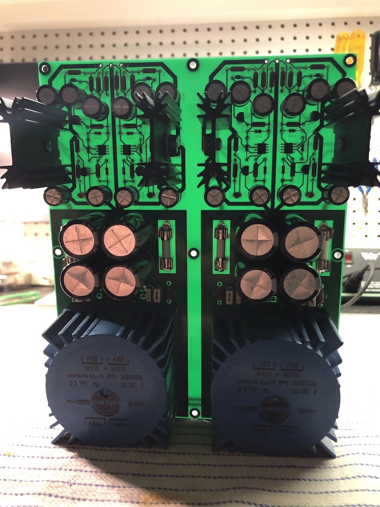

I built a power supply tonight.

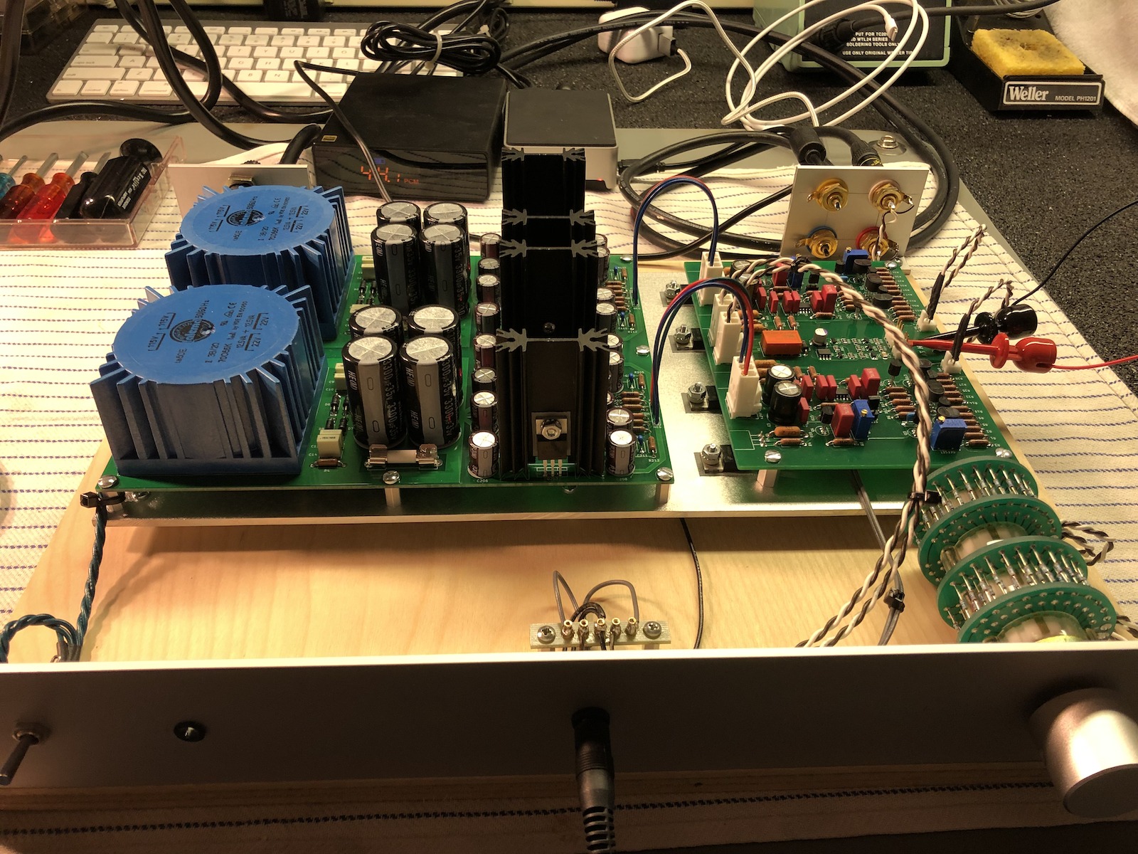

There's a blizzard outside. I went to You Do It Electronics last night to buy hookup wire and they had closed early. I'm not optimistic they will open today, but I can make do with the wire I have on hand. I made some progress with the mechanical part of building the A3 breadboard last night. With luck, I will have it running by tonight.

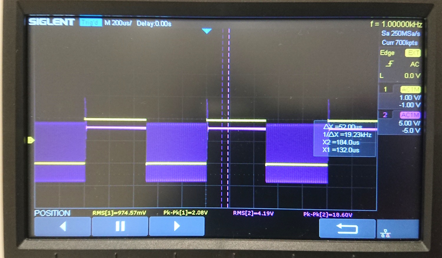

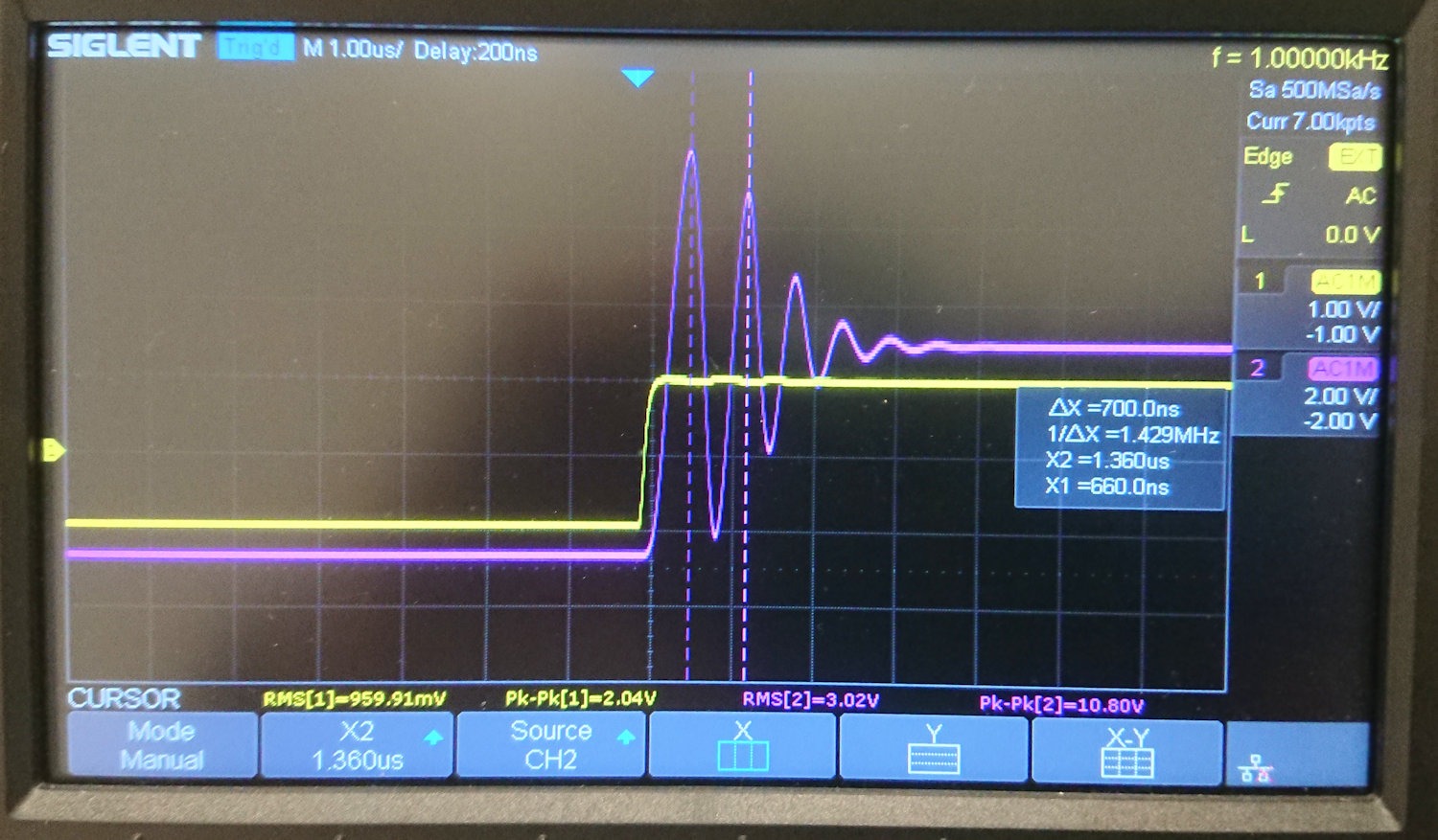

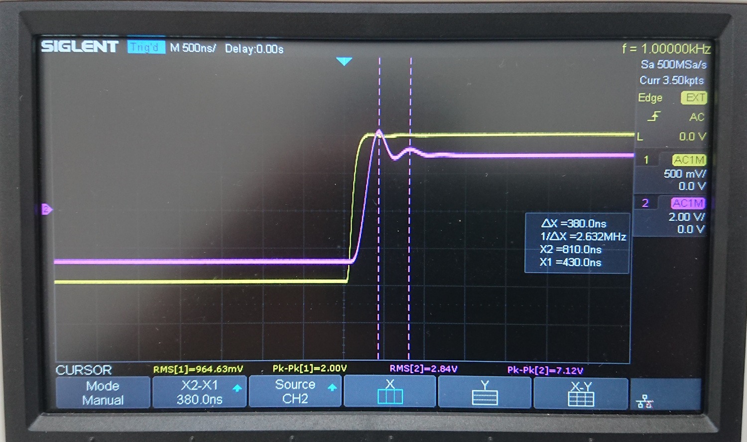

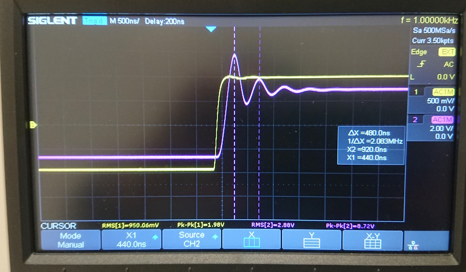

Hi All. A quick update (part 1) – testing my implementation of Henry’s “A2” with capacitive loading. 1 kHz, 2 Vpp square wave, no input low-pass filter. 33R load in parallel with 1, 10 and 100nF. At 1 nF things look very similar to the 33R alone (see earlier post) – some ringing at ~2.1 MHz. The amplitude is now a little higher. At 10 nF we have higher amplitude ringing, now at ~1.4 MHz. This frequency looks like ringing from the ~1u output inductor and the 10nF load capacitor, rather than the amp itself. At 100 nF – ouch, now we have oscillation! This was not always self-sustaining after muting the signal generator, but it did self-sustain once or twice out of perhaps 4 very short tests. With a ~200 kHz RC input filter in place, the same 33R+100nF load shows some damped ringing at 460 kHz, again consistent with ringing of the output inductor and 100nF load.
So looks like a little tweaking is needed - some results coming in part 2. One thing that I did notice in simulations of this circuit is that the LSK389B that I’m using in the IPS does behave differently to the 2N5564 that Henry originally used. The LSK389B is less well behaved. Could this be one reason why we’re seeing some different behaviour?

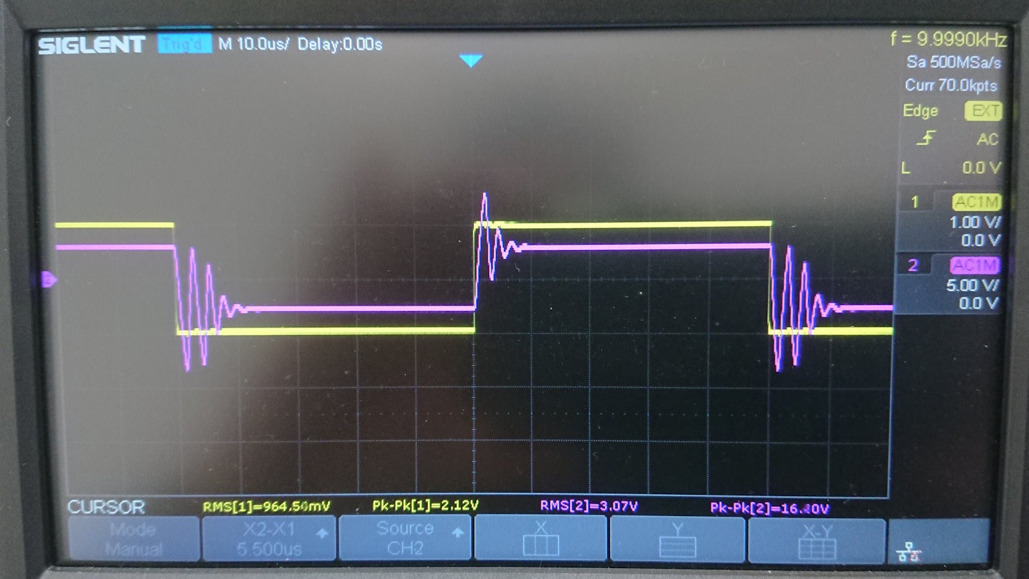

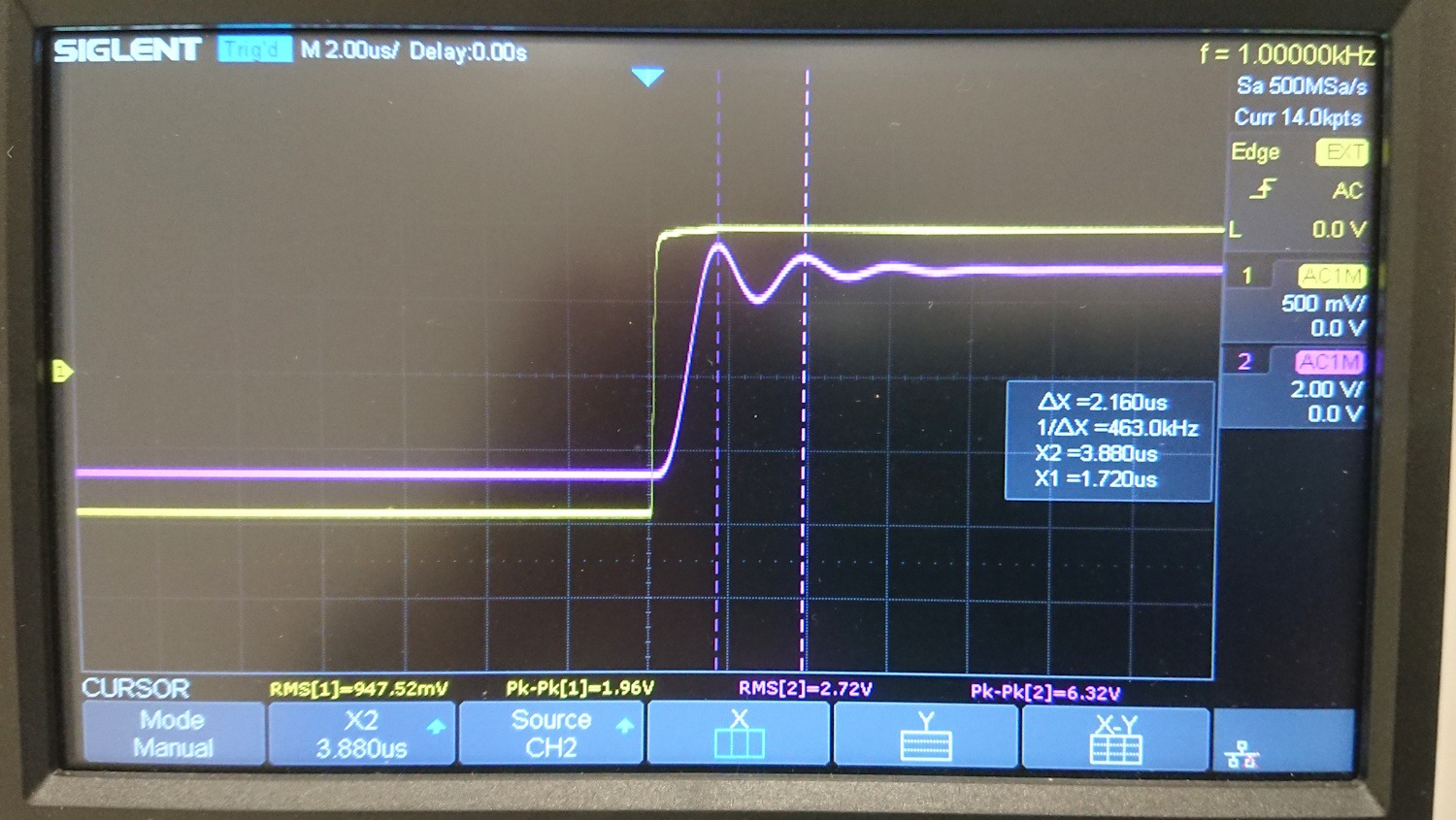

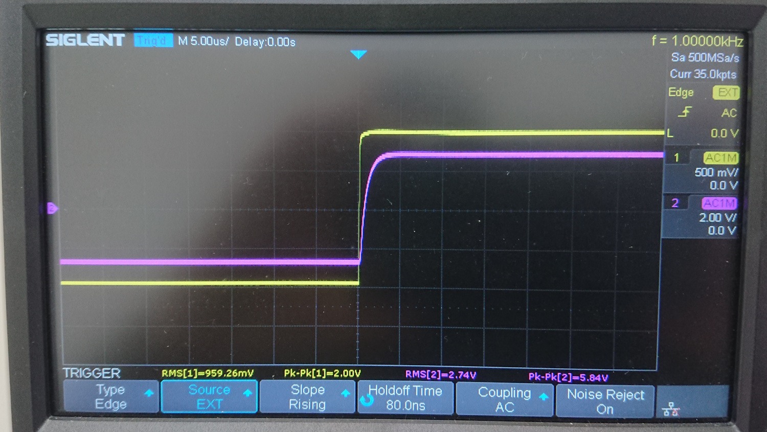

Update (part 2) – I thought it would make more sense to read if split things into a “before” and “after” post. I replaced the 10 pF capacitor across the feedback resistor with 33 pF. Simulations suggested that this would improve the phase margin. After repeating the square wave tests above things do indeed look better. With 33R alone there is still some ringing, now at ~2.6 MHz, but the amplitude is reduced and it decays more quickly. With 33R + 100 nF there’s no longer any oscillation, just some ringing at ~450 kHz, again consistent with the output inductor and 100 nF capacitor. With a ~200 kHz RC input filter in place the 33R load alone looks good, no sign of any of the unpleasantness seen before on the leading edge of the square wave. With 33R + 100 nF and the input filter there’s still some low amplitude ringing at 450 kHz.
So a good improvement. With the input filter in place the amp looks stable and I guess should be usable. Part of me wants to keep tweaking to reduce the small amount of ringing into the purely resistive load with the input filter disengaged. Henry’s amp only showed a small overshoot and no ringing, so it is possible to do better. However, when I tinker too much I tend to break things, so I think it’s time to take a pause and consider the next step!

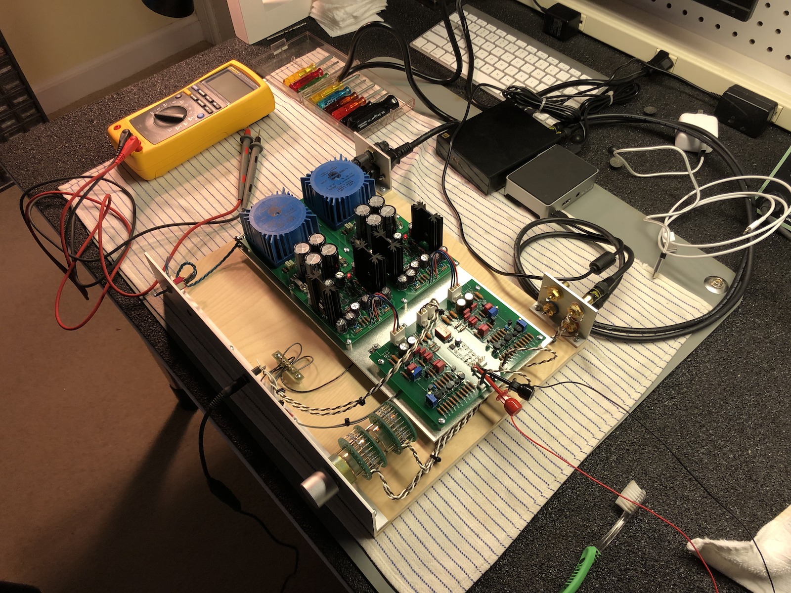

Darth Kittius woke me up at around 6:00 AM. I'm struggling on five hours of sleep, and it's a major nuisance to get out to the garage right now. But I'm almost ready to test the amp.
I will try to get to your simulation tonight.
I'm listening to this now. I still need to make a 12V supply for the muting relay, so running that with my bench supply.
I want to let it warm up and break in a bit before I try to describe the sound. TBH, I'm doubting my credentials as a "subjective reviewer" at this point, so I don't know how useful my comments will be anyway.
I don't have the impression I had before that the amp is so colored. This Super Regulator is tight as a... well.. it's stiff. So should be very good sound, but probably not the same sound as with the official power supply.
My general impression is much the same as before: very pleasant and relaxed to listen to with lots of good stuff going on, but not the laser focus of my other amps, including the Topping.
