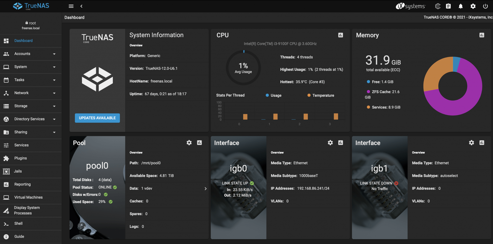

LOL, what you see in the picture is the whole system. Well, except for the music server. Topping E30 DAC, USB input, driven by Ropieee on a Raspberry Pi 3B. Server is Roon Core running in an Ubuntu VM on my FreeBSD-based (TrueNAS) storage server. I don't bother with ethernet, just use wifi and it seems fine. Headphones are Sennheiser HD560S.
I wanna say, you have to be a gosh-darned fricking computer genius to set up and maintain the software bits of a system like this. Definitely not for the faint of heart or computer-illiterate.

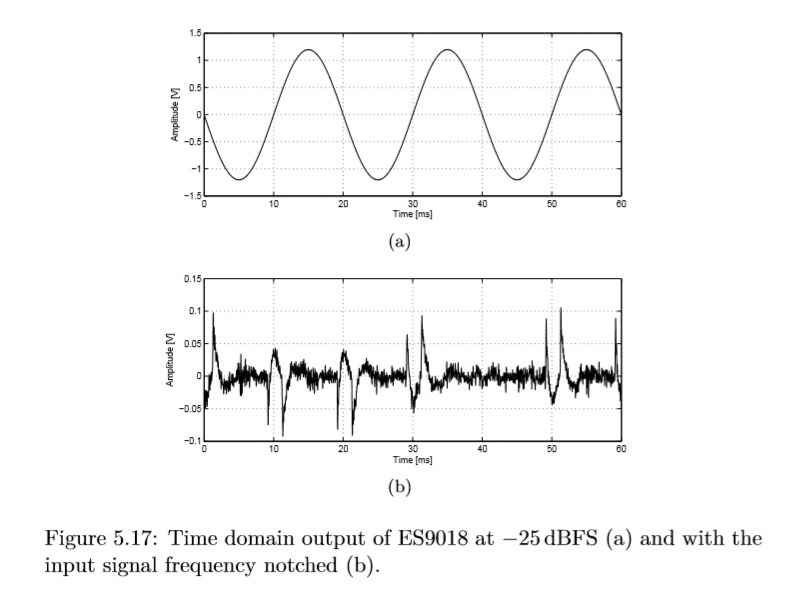

I'm not saying the power supplies won't make a perceptible difference. I just don't have any evidence that the Super Regulator is putting a signal on the rails that affects the sound. It could be that the amp sounds better with a less stiffly-regulated supply. Or, it's quite possible whatever artifacts there may be are invisible to a low-resolution instrument like my scope.
Its possible to measure audio on power rails with an AP. Sometimes something shows up. Of course could also be as Scott Wurcer suggested, that looking at things like distortion residuals after a notch and makeup gain LNA can be give different insights than spectral analysis. For example, a pic of a dac output residual posted by Scott is attached.
Its possible to measure audio on power rails with an AP. Sometimes something shows up. Of course could also be as Scott Wurcer suggested, that looking at things like distortion residuals after a notch and makeup LNA can be give different insights than spectral analysis. For example, a pic of a dac output residual posted by Scott is attached.
The regulator has non-zero output impedance so there has to be residual signal on the rails. The residual will depend on the design of the regulator. The question is whether or not it matters to the listener, and I don't know how to tell that from a graph.
