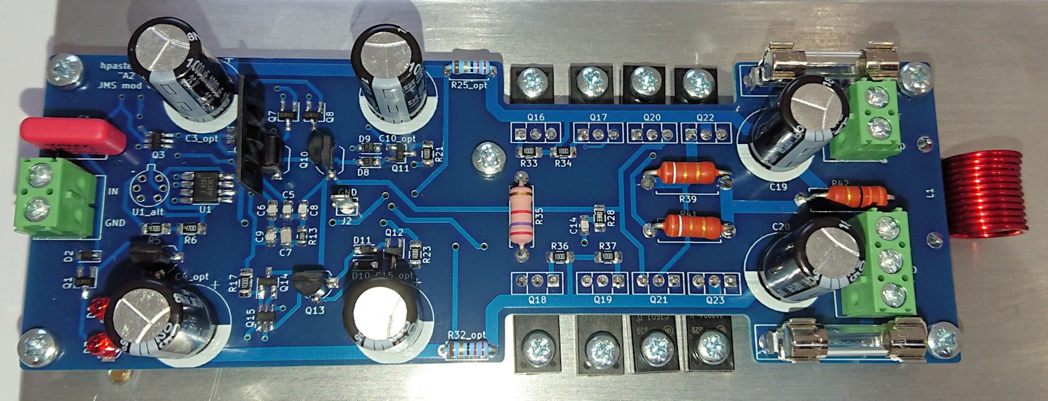

Hi Everybody,

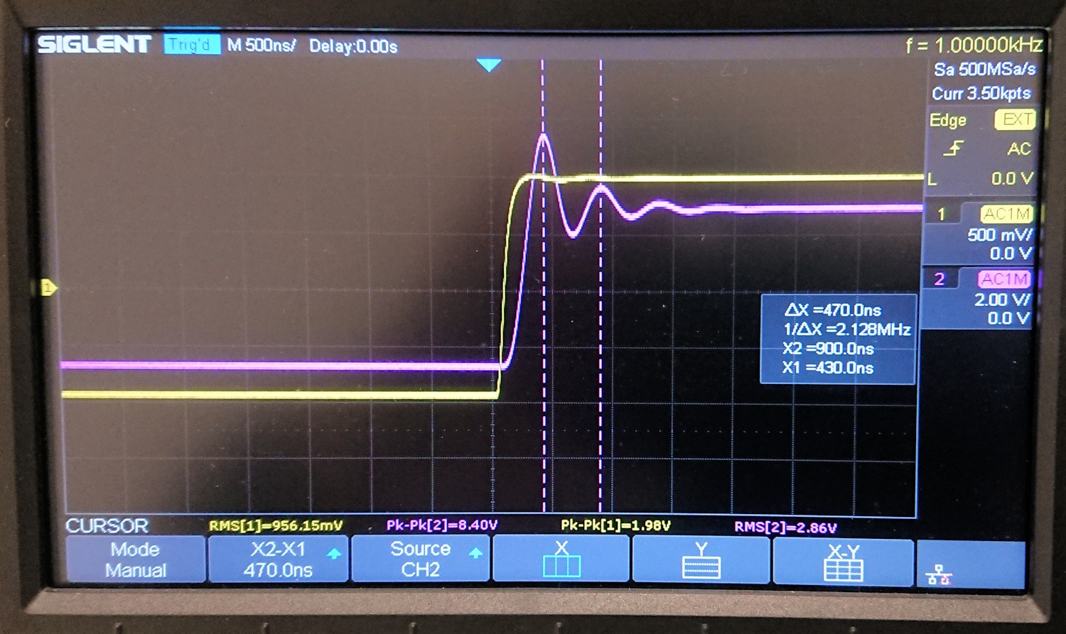

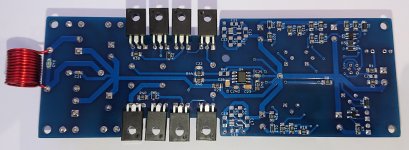

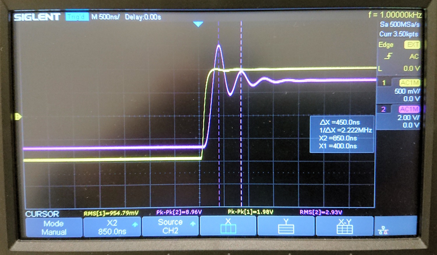

Please bear with me, I’m just a novice, but I’m having fun learning! I’ve been making progress on a slightly different implementation of the “A2” amp described earlier in this thread (schematic attached). One channel is built and I’m currently testing. The input ultrasonic filter and the servo output are currently disconnected for the initial testing. It’s powered by +/- 15V from a simple regulated (LM7815) supply, which is RC filtered before the IPS+VAS, rather than regulated, as the LDO regulators that Henry originally used are currently on backorder (I may see them by the end of this year!) It’s mostly looking very nice, well behaved and results are remarkably close to simulations. DC offset at the output is a measly 3 mV and seems stable, so the servo is a bit redundant, but nice to have anyway I guess. 1 kHz sine wave looks good all the way into clipping (33R resistive load).
I do, however, have an issue with the square wave response that I’d be very grateful for some feedback on from the experts. A 1 kHz square wave (2 Vpp) with either no load (well 1M + 18p from the scope) or a 33R resistive load shows significant ringing at ~2.2 MHz (~ the open-loop UGF for this amp). This is worse (higher amplitude) unloaded than with the 33R load. With an external RC low-pass filter at the input (~400 kHz) the ringing is obviously cut off, but there’s still some evidence of it at the edge of the square wave, which doesn’t look very nice. Funnily enough I didn’t simulate (not sure why!) the circuit without the input ultrasonic filter prior to building, but now that I do it’s clear that the simulation predicts all of this behaviour pretty accurately - oops! The difference being that the ringing is a little higher in amplitude and decays over a slightly longer period in reality compared to simulation.
I understand that TPC does bring with it the disadvantage of high-frequency peaking in the closed-loop frequency response and some corresponding overshoot on square waves, but what I’m seeing seems more significant than this. I’d be grateful for your thoughts on whether or not I’m overly worrying and that once the final ultrasonic filter (which will be ~220 kHz with the volume pot fully open, lower frequency at lower volume) is in place the problem will all go away, or if this is something that must be tackled now. In simulation, increasing the size of the capacitor across the feedback resistor from 10p to 33p tames the ringing and leaves just a more modest overshoot. This change increases the phase margin (from 57 to 72 deg), at the expense of the gain margin (from 20 to 16 dB), but otherwise the simulations look very similar. Is there any significant downside to making this substitution? Is this the best approach to take with this problem, or would you recommend any alternatives? I’m afraid that I'm rather ignorant about TPC, but Bob Cordell’s book has been helpful and I’m making my way through Michael Kiwanuka’s paper on TPC at the moment to try to improve.
Schematic and some photos are attached. Many thanks for your thoughts.

First of all, congratulations on getting the circuit working. This is no small accomplishment for a project of this complexity.
In principle, the extra capacitor in the TPC network should take care of the open-loop peaking. What I've read is that the peak isn't really an issue even if you don't correct it. In any case, its frequency is around the LF cutoff of the compensation network, which is at midband and so shouldn't affect HF stability at all.
I need to go back and play with my SPICE models, because I don't believe I simulated without the input filter network, either. I need to bear that in mind for next time.
You might want to try taking your signal from before the output inductor, to make sure it's not contributing to the observed ringing. You can also try putting some capacitance on the output in parallel with the load to see if it breaks out into outright oscillation. This is a good stability torture test. The inductor does a good job of protecting the amp from destabilizing with capacitive loads, but does introduce some benign passive ringing with large cap values. I posted about this in the Bob Cordell Amplifier Book thread but don't remember if I posted about it here also.
This is likely a global loop problem because increasing the feedback lead compensation capacitor helped. Your layout is different than mine and it's no surprise you need to tweak the compensation. I may have gotten lucky with my layout. SPICE doesn't know anything about the parasitics in your particular implementation. You may need to experiment. I've been happy with the performance of my board but I should probably invest in some test gear to let me evaluate loop gain. So far, I've taken the approach that the amp seems stable so the simulation must be ok. So many factors can affect real-world behavior.
There is that RC snubber on the input to the diamond buffer. I'm a little iffy on the exact values for those parts, so some experimentation may be in order there, too.
Feel free to change the compensation values as needed to get good measured performance. As long as it's just ringing and not going nuts, I wouldn't worry too much. This is only the second reported build of this circuit, so it's really still in prototype phase, and your board is different from mine. I'd say this is very good progress.

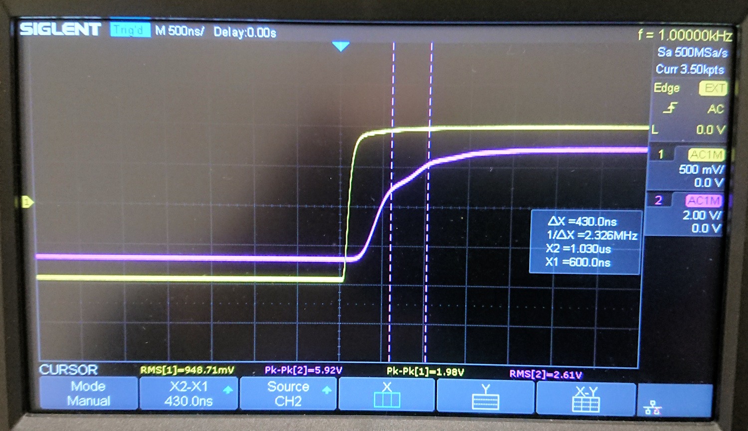

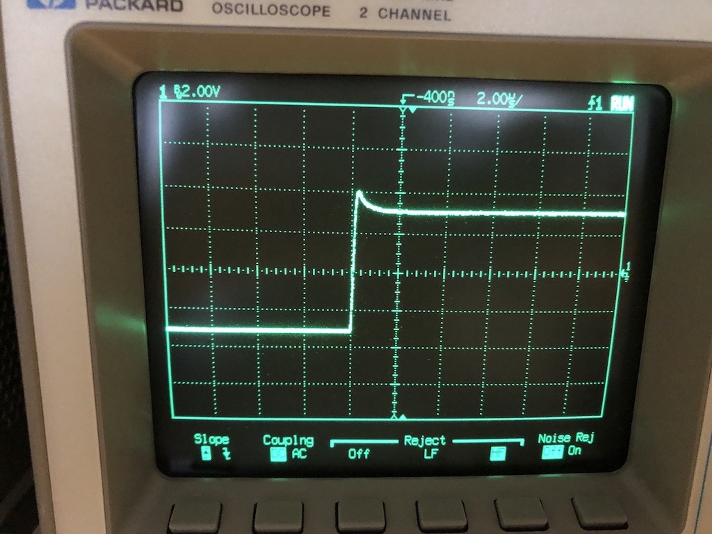

Here's a link to the Cordell thread where I posted my capacitive load torture test results: https://www.diyaudio.com/community/threads/bob-cordells-power-amplifier-book.171159/post-6871907
Initially, I had the ultrasonic filter in place. I repeated the tests with it disabled, and got the following square wave response with a purely resistive load:
I'm satisfied with this to the point where I don't feel like screwing with the compensation network, but I'm sure it could be improved.
By the way, congratulations on the "A3" build Henry. It looks great!
Thanks, John. You've done a superb job on your amp.
Thanks for the fast reply and the encouragement! I'm also very pleased with how it's looking so far – a very promising start. I think this is testament to a solid topology that you've put together. I'd seen your discussions in the Bob Cordell thread. I'd also be happy with that level of overshoot. Clearly my parasitics are a bit more troublesome at the moment! I've not tried any capacitive loading yet. That's next on the list. What I did do is to monitor the output before the inductor and I have the same issue. In simulation the big overshoot/ringing is clear with or without the inductor too. So I don't think this is due to the inductor, that will presumably appear with a larger capacitive load. It looks like the compensation network + the transistor substitutions that I made + any parasitics in this layout. I’ll have a tweak of the compensation and see what happens then – hopefully no full-blown oscillation!
I should be able to have a listen, in mono at least, this weekend after a bit more tweaking (and some tidying up of the rather messy lash up on the bench at the moment). I’m looking forward to hearing it.
Cool. I will tell you that mono listening is a huge letdown, so don't judge by what you hear that way. You lose all the ambience and spatial cues and it just sounds really boring.
I've been busy, but when I get some time I will fire up my SPICE model and see if I can improve the compensation. I'm convinced the basic design is solid, so it should just be a matter of adjusting parts values.
