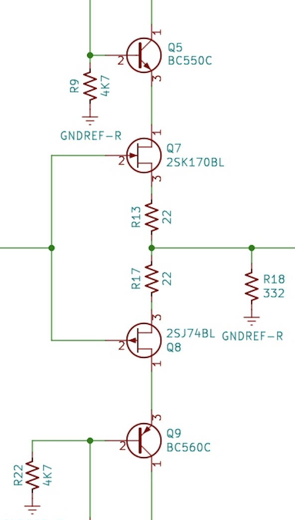

I've been thinking about current feedback amplifiers and wanted to share some comments, though not without trepidation. (The HPA-1 is, of course, a current feedback amplifier.)
There is a long and contentious thread on the subject here, where people far smarter than me failed to reach any firm conclusions. I don't want to revisit that chaos.
There are four "canonical forms" of feedback, and CFAs use the very same form as VFAs. Some people are bothered (but not me, mostly) that the term "current feedback" has been appropriated from its classic meaning to describe this topology. In the older sense of the term, CFAs are precisely voltage feedback amplifiers.
The main advantage of CFAs seems to be that they can achieve very high slew rates. This is because the IPS output current comes externally via the feedback loop, instead of being constrained by the input differential pair tail current source. This is a boon to IC op-amp designers, where supply current and package dissipation are important considerations, and parts need to be designed for general applications. With a purpose-built discrete VFA design, we can get around these problems easily enough. IIRC, my A1 has a slew rate of 100 V/uS and the A2 measures 50 V/uS. Arguably, 5 V/uS is more than enough for audio work, and 200 V/uS (obtained with a CFA) is absurd overkill.
Another purported advantage of CFAs is that the closed-loop bandwidth is independent of the closed-loop gain G = (1 + Rf/Rg), where Rf and Rg are the values of the two feedback network resistors. This is true but misleading. In a CFA, the input stage transconductance, and hence the open-loop gain, depends on the value of feedback resistor Rg. In a VFA, open-loop gain does not depend on the values in the feedback network. So, if you increase the closed-loop gain of a CFA by lowering Rg, you raise the open-loop gain, and this compensates for the drop in bandwidth you would get doing the same experiment with a VFA. On the other hand, if you change the CFA's closed-loop gain by changing Rf, you will see the usual tradeoff between gain and bandwidth.
Looking at the input stage of the HPA-1, you could convert it to a VFA by the addition of two more JFETs buffering the feedback signal.
This would make it exactly into a complementary-differential input stage, e.g., as described by Cordell and many others. It's interesting to think about what effect this would have on both technical and subjective performance.
CFA proponents often talk about the ease of compensating these amplifiers, but they are just as constrained by output stage poles as VFAs. The difference is that CFAs tend to have lower open-loop gains, so require less compensation for stability. You can crank up the open-loop gain of a CFA and then you run into exactly the same problems with phase margin as with a VFA.
In general, aside from slew rate, CFAs tend to have lower performance specs than VFAs. And there are some newer integrated VFA chips that achieve slew rates and bandwidths comparable to CFAs.
There is some debate about what exactly defines a CFA. Some people think it's synonymous with having a diamond buffer input stage, but this isn't true. The HPA-1 doesn't use a diamond buffer, but is a true CFA. The actual definition is clear: The CFA inverting input is a low-impedance (ideally zero-impedance) node, and can source or sink current to maintain its voltage equal to that applied to the non-inverting input. In other words, in a CFA, there is a unity-gain buffer between the non-inverting and inverting terminals. In all other respects, CFAs and VFAs are conceptually identical.
This is a little counter-intuitive, that the inverting input is actually the output of a low-impedance buffer. It works because the transimpedance stage that follows is driven by the input/output current from that buffer.
In both the VFA and the CFA, the open-loop voltage gain is the product of the first stage transconductance and the second stage transimpedance. This is partly why some people argue the two amplifier types are essentially equivalent.
All this notwithstanding, the current feedback amplifier topology is interesting to think about. There are many applications where CFA chips are the best solution, especially where wide bandwidth and very high slew rate are required. To my thinking, the differences between VFAs and CFAs are topological rather than fundamental. In other words, choosing a CFA design is a matter of implementation tradeoffs.
The premise of the current turn of this thread is that specifications and theory take a back seat to listening performance. So, while Douglas Self and friends can argue convincingly that VFAs are the higher-performance solution, the proof of the pudding is in the eating, as Jeff "Dr. Low Mu" Medwin would say. I am thinking and posting about this now because it interests me, but I can't begin to tell you what it all means for my satisfaction when the needle hits the groove, metaphorically speaking.
Given infinite monkeys and typewriters, it would be interesting to build a version of the HPA-1 that differed only in having those two extra input stage JFETs, to see how converting it from CFA to VFA (complementary diff amps) would change the sound. Or we could substitute a bipolar diamond buffer in the input. Heck, we could do that, and replace the MOSFET output stage with the diamond buffer from my A1/A2. This would turn it into the "canonical" CFA circuit. It would be a completely different amplifier then, of course.
