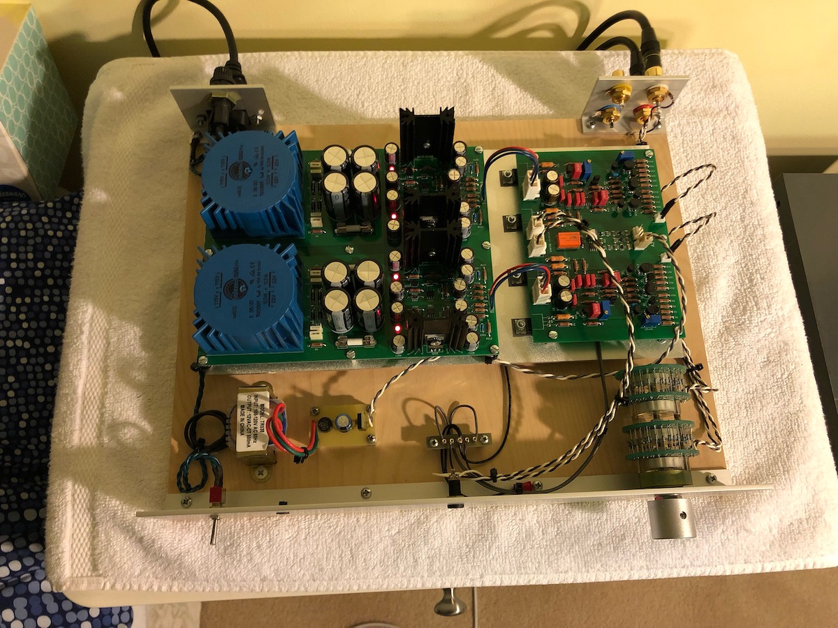

Before going back to work tomorrow, I want to give a final update on today's listening tests, begging your pardon. I'm not super-comfortable with this audiophile stuff, and I'm a little embarrassed by it all. But I realize you guys are paying me a generous salary to write about it, and I don't want find myself in breach of contract.
First thing is, I've heard the sound of the A3 change during warm-up so many times now that I believe it's real and not just my imagination. I didn't figure this out until today, so many of my earlier comments were based on listening to a cold or lukewarm amp. I will wait until I get the new power supply built, then start again with a fresh review and a properly warmed-up amplifier.
Second thing is, I've been trying to evaluate the A3 in comparison to the A2 and it's been really frustrating because I come away with different impressions every time. I thought it was just me being a bad listener, but I'm not so sure now. All I can say is the A2, to my ears, has improved dramatically over the weekend. If it sounded bright or overly-analytical before, I can't hear that at all now. In fact, I feel it's right up there with the A3. This is extremely inconvenient because it doesn't fit the tidy narrative about complex circuits and high-feedback amps versus simple, low-feedback ones. Plus, I have no credentials as an audio designer. It makes no sense.

A couple of people have asked about my A3 PC board files. I've decided to split off a separate A3 build thread and I will start by publishing my signal board Gerbers, schematic, and BOM there. I'm going to hold off on the Kicad files because I'm satisfied with the layout and I don't want to encourage a dozen variants to pop up in the field. Once I design the power supply board, I will publish Gerbers for that as well. I will get this going by tonight, hopefully.
I'm want to do this because I think the HPA-1 clone is a classic design and, with a little encouragement, has the potential to attract more builders.
I will reserve this thread for any future projects I come up with, to support people building the A2, and as a place for my yammering.

Tonight's project was to build a 12V auxiliary power supply to run the muting relay. That's done now, so no more being chained to the workbench and the HP power supply.
Next step is to put a bi-color LED on the front panel and hook it up to the timer connector. Can't live without that LED. The problem with these breadboards is I can't keep the cat from walking in the circuitry. :-(

The Dropbox folder contains the Gerbers, the schematic, and a copy of my Mouser order form. The latter does not include the audio transistors. Name-brand BC550C and BC560C are discontinued or out of stock at the major distributors, but seemingly reliable sources can be found on eBay. The other devices can still be had, but you will need to order from several suppliers. An indispensable resource is octopart.com. Check it out if you haven't already.
The 500 Ohm trimpot is mostly out of stock everywhere. RS components had 39 in stock when I checked earlier this evening. The JFETs come from the diyaudio store.
The 2-pin, 0.1" Molex receptacle housing is out of stock everywhere. TE Connectivity has a similar connector series that could be used instead.
The schematic shows an Omron relay part number, but I used the Kemet EA2-12NJ. This is in limited supply and marked as end-of-life. The substitute is EA2-12NU, which is the same relay with shorter pins, IIRC. The latter part is unavailable. Any other quality relay in the same form factor will work as well.
I used the tiny Vishay CPF2 parts in a 2W rating for the power resistors. They are more than adequate in this application. Be mindful of the small footprint; standard 3W parts will not fit.
Pads for the two "clean" ground wires are covered by resistors on top. The wires are intended to be soldered from underneath the board.
I believe the information in the files to be correct, but have not triple checked. I recommend that you verify everything carefully before placing orders for boards and parts.
