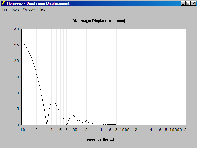

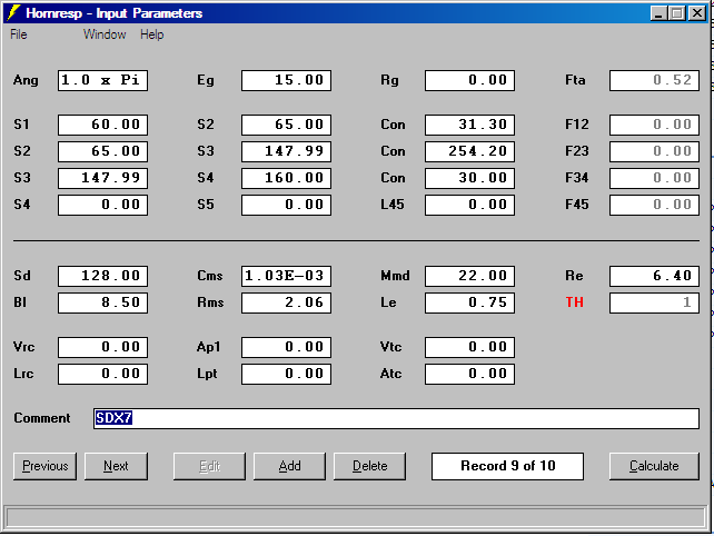

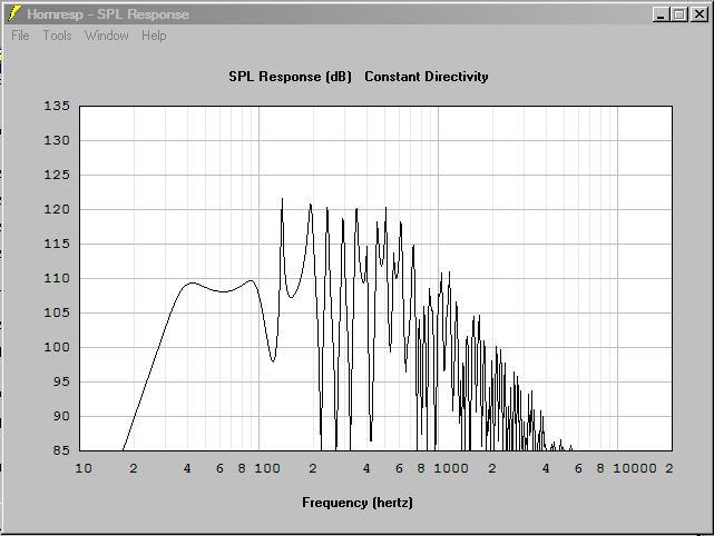

I was doing some research on a single subwoofer with smaller driver to better integrate with the fonkens in my small room. In particular, I was looking into the 30Hz volvotreter tapped horn project that uses the tang band w6-1139 driver.
The CSS SDX7 suggested by Dave also fits in this kind of enclosure. Playing with hornresp I came up with the following:
The response seems to be reasonable plain from 35Hz to 100Hz which is the the freq. intended to cut the subwoofer and let then fonken play.
Values from hornresp:
30Hz - 102dB
35Hz - 107db
40Hz - 109db
90Hz - 109db
100Hz -108db
The displacement is excellent at the main energy level. Maybe a sub-sonic filter to protect the driver?
Any comments?

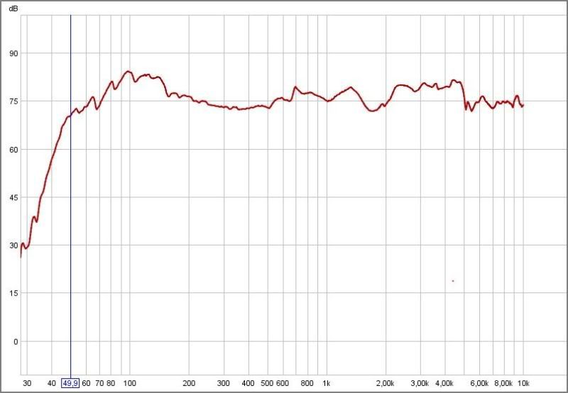

Just as curiosity, here is a graph of my fonkens (after the make-up treatment)
The measurement was done in semi-anecoic conditions with some room influence (most around 100Hz) and up to 10 kHz (the upper limit precision threshold of my measurement equipment).
Regards
HF

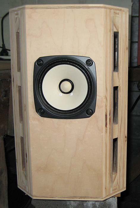

I have been listening to a pair of Fonkens that I built for a little under a year now and I'd like to say they are a very musical speaker and a pleasure to listen to.Big thank you to the team at Planet 10 HiFi.
I'm at the point where I'd like to add some bass support, I was thinking of using either the CSS SDX7 or Trio8, foot print isn't to big of a deal to me as long as my fonkens sit on top and don't look to out of place.
My cabinets are 233mm wide x 306 deep, slight deviation from the plans as I used thicker ply.
Any suggestions welcomed.
I do have pictures, not to sure on how to upload them.
Lindsay.
