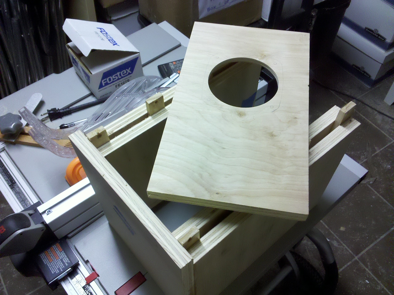

Sorry if I'm a little late to the party but I've been wanting to build a set of fonkens for a while and it's finally starting to happen. I'm up to the baffle as shown in the picture (hard to see but I have a decent chamfer routed into the back of the driver cutout), and I have a question: to rebate or not to rebate? I did some searching and it seems like it will make a audible difference, so if that's indeed the case, what's the best way for someone without a CNC router? I was thinking about cutting through the veneer with a razor along my driver tracing, and then using the router by hand with a straight bit and leaving maybe a 1/16" or so and chisel out the last little bit up to the razor cut. I'm worried about having an ugly cutout - I guess there's always wood putty to fill in if I make a mistake?

Back when i was allowed to build boxes, i was rebating a lot of KEFs. Similar shaped bezels as the FE127. My router was/is a little tiny rockwell. With a small straight bit i got pretty good freehanding, never quite mistake free. Slow steady take just a little bit at a time till i hit the pencil line. Leaving a bit so you can go in with a dremel or chisel will work.

in the case of any of the Fostex stamped basket drivers ( i.e. FE & FF series), I'd be inclined to seal the driver in sandwich bag and mount face down when using this method, as the flange is quite thin and radiused on the face
the small ridged diffraction ring outside of the surround should raise the flange enough to provide a more secure surface against which to register the router base, and the plastic bag would keep nasty wood chips out of delicate places
of course I have the luxury of CNC programs for these patterns, so have never needed to test the above theory, but I have free-handed a few myself - always gratifying to know you can if needed

Thanks for all the replies! I think I could probably get there free hand, but I really like the template method you described and feel a lot safer going that way. Of course, just my luck, I have a Dewalt DW621 router which has a rectangular base.. I guess I'm off to buy a round replacement base, gives me an excuse to buy another tool - I'm sure it will come in handy on all kinds of other projects too (that's what I keep telling myself each time I have to buy something else I don't have).
