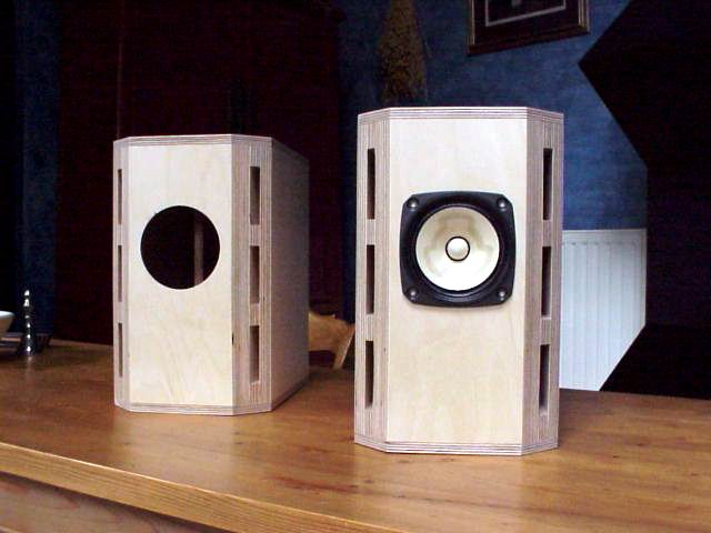

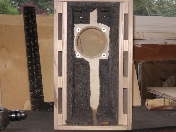

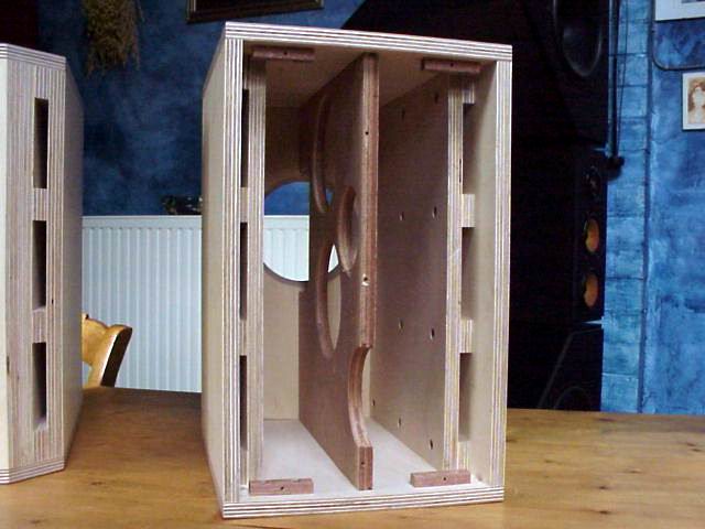

FWIW, there are two aspects to Dave's "fonken / mini-onken" design for Fostex, Mark Audio, and other driver makes.
1) The pain in the a$$ construction details of the original enclosure design - the 3-layer side panels with large edge chamfers and narrow front baffle. The trapezoid shaped ones are "double your fun".
2) High aspect ratio slot vents - usually in multiples, with dividing spacers which continue full depth of the enclosure to add some additional bracing - although the efficacy of that intention is debatable.
The latter has been incorporated in a large number of more conventionally shaped rectangular boxes - including floorstanders for drivers as large as FF165WK, Mark Audio Alpair10 - etc.

Hello! I have a set of these I thought I would share here. I have followed the plans to a T but used the Coral "Holy Basket" fe103a drivers and they really do a great job. I really like these speakers for the size and the sound they produce.
I am especially jealous of some of the lovely finishings you have all done on yours with the wood grain.
