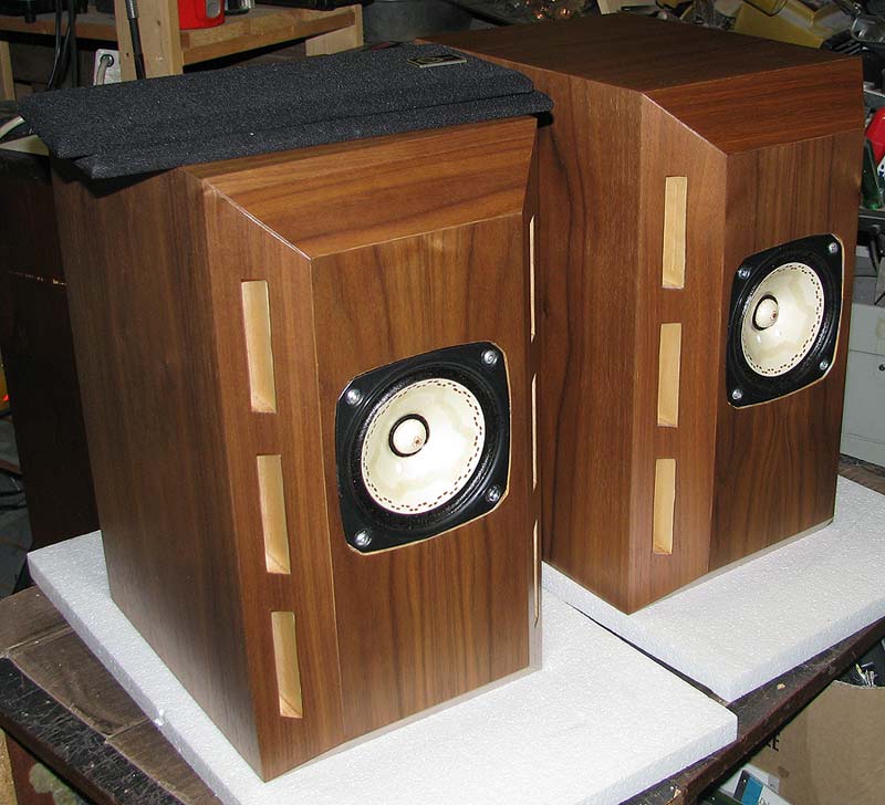

Is that a veneer I see before me?
yes
How do you make those nice speaker covers BTW?
A thin MDF frame, then we farm out the fixing of the doublenit cloth.
Held on with magnets so they are easily removed for serious listening.

The only thing holding up release of plans is my finishing them to the level we have set. If someone is eagar to build either the milli ot the micro, just mail me, i have plans enuff for an experienced builder.
from post #48
Um Dave does this mean that the plans on your site even though preliminary are not good to build??
Cause I already did, used 3/4" MDF but kept internal dimensions the same, now need to chamfer driver holes and put together. FF85 just waiting to be installed.
The plans for uFonken are just fine...
I'm creating a very comprehensive set of plans that i can ask a token for. The ones on the site are still valid, just that if you have to do things like changing material size, etc you have to do some thinking 🙂

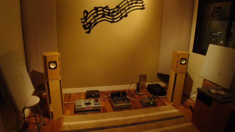

Dave,
The woofers of you last set-up picture, are active or passive? Do you filter them with a crossover? How do integrate them?
I was thinking about adding just one woofer (or sub) acting like a "sub-woofer" in a Tapped Horn enclosure and limit up to 70 - 100Hz and let the Fonken do the rest. I have already tested the fonken with my current TL sub-woofer and I liked the result.

I was really lucky the 1st time out, which slowed XO development down, but we are still playing. I had an old Ace Audio active XO, with 2nd order 100 Hz cross point. Modded a bit, it sounded WAY better than expected. I want to play with PLLXO similar to Tysen, and with both normal & buffered PLLXO based on the B1 concept.
When at its best, i'm using an SE tube amp on the top, and a 150W dual mono MOSFET amp on the bottom (it started out life as an OEM Hitachi built for Sears that had a net cost of -$400 (gotta love the price), then i let Daniel at it 🙂)

If you were running the FE127 on the HP output of XO, perhaps some of the harshness you heard was simply the sound of the XO itself? I guess the only way to test that hypothesis would be to fabricate a quick PLLXO at the same nominal value and see if it sounds more transparent.
XO of anywhere between 60-80 seems about right as a starting point for dialing in.
Judging from your photo, there appears to be a large piece of furniture and a window (to possibly a studio or is that outdoors?) on the right hand side of the room. That combination could well be biasing the reflective / diffractive characteristics of the room. Among other things, perhaps the mains could be pulled in a little closer to the center and experiment with toe-in, and try some pleated curtains or fabric blinds on the window.
The open wooden stands look like they could use some ballast for stability and perhaps mass damping or bracing for reduction of panel resonances.
I'm currently reading Floyd Toole's book on Loudspeakers and Rooms, and he has some interesting observations regarding treatment of front, rear and side wall reflection points. (as in lots on the first, some on the primary reflection point of the second, and perhaps less on the latter, particularly at the primary reflection points)

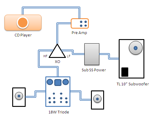

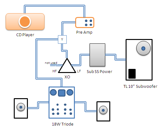

I really don't want anything between my power amplifier and the fonkens, but I still want that little small low frequency range to extend, with class, some demanding recordings.
I made 2 diagrams to explain the simple mod I made to the circuit:
BEFORE: The tube amplifier was receiving the HF output of the crossover, it means that the bass was being filtered out (I suspect also that some HF distortion was being introduced). This cut-off frequency is fixed and was removing some important information that I wanted. The LF output feeds a solid state amplifier. This specific LF output is more flexible. I can control the level and also the lowpass cut.
AFTER: I just used a simple RCA splitter and fed the tube amplified directly from the pre amp output. From the splitter I fed also the subwoofer amplifier. This way I have full fonkens playing and I can control de gain and cut and set it just in the low register needed. I was concerned about using the splitter because of hanging 2 devices in the pre amp output. I don't have the input impedance values of my powers but I think they are high enough. I made lots of tests and didn't hear difference of the fonkens performace specifically for each case.
I just need to find the optimal point for the subwoofer and I will have everything I need.
What do you think?

If you feel that giving the fonken some bass relief, a single cap in series with the tube amp input will give a 1st order roll-off with no extra electronics. Use the RC time constant (with R = input impedance of your amp) to calculate the XO point. The intrepid would actually go in and shrinkl the size of the coupling cap and introduce no extra parts into the circuit (assumes no global feedback loop)
dave
dave
If you want to play louder.
Also i expect you would get some benefit in the midrange... it has to be done very transparently. Especially after you treat them, they are incrediably capable downward dynamic range wise.
