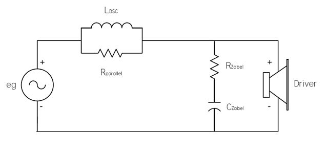

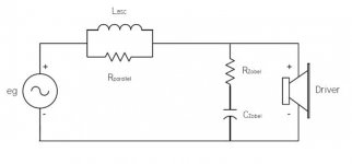

> For the record i used Martin spreadsheet and it gave me a zobel network of 8R and 0.71uF (I used 0.68) and a 1.5mH and 6.8R in parallel on the hot.<
Hello Fran,
I am currently building a pair of fonken's and was wondering how to connect the parts of the correction network you described.
Thanks for all the great info.
Rob
Hello Fran,
Rob
