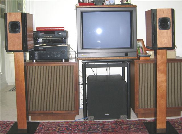

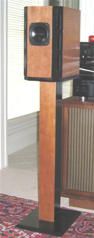

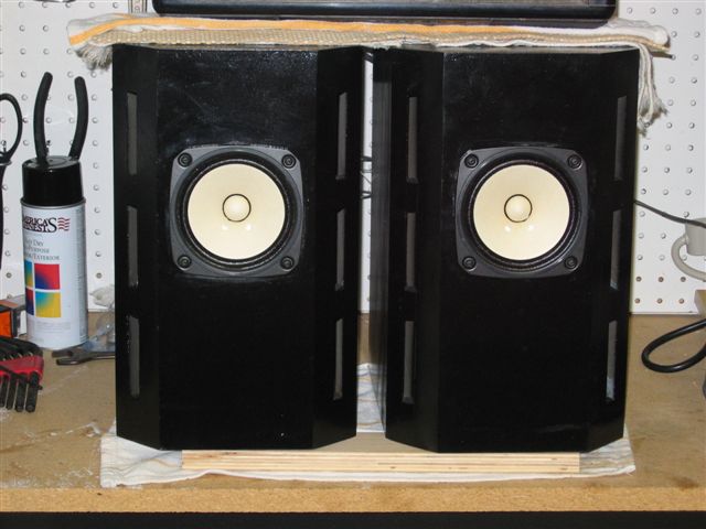

I finished these over a year ago but only recently learned how to post pictures. The initial build was a pair of mules out of MDF. I painted them black so I could get them in the house for evaluation. They sounded good enough to justify a second build out of birch plywood. These sounded good but had a harsh edge especially on female vocals. I performed the cone treatment (old one ) and noticed an improvement but it was still there. Maybe I will try a little more dacron on the back wall. All in all a very satisfying build for the money. The stand was a knock together from scraps that turned out fairly well. They are filled with sand.

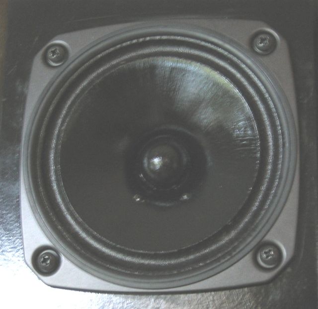

Ray Collins said:These sounded good but had a harsh edge especially on female vocals. I performed the cone treatment (old one ) and noticed an improvement but it was still there. Maybe I will try a little more dacron on the back wall.

At this point i'm going to surmise that the 7k peak is something some people can listen thru and some can't (some even consider it a positive feature of the driver -- not me). It is more noticeable on audition with the stock drivers, but still shows up in an on-axis FR after treatment.
Female vocals is one of the things we use a lot of for testing -- Loreena McKennit, Wailing Jennys, Patricia Barber, Jane Monheight, Dianna Krall, Victor Lazlo....
I'll have to dig into this problem and see if it can be ameriolated without subtraction.

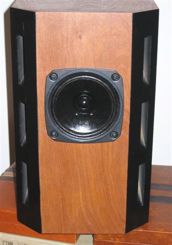

I wanted to update the thread here (although what I'll post has been posted elsewhere).
OT: a pet hate of mine is when a thread is left hanging - and its always the info thats missing is what you need🙄
So, in my posts in this thread you will see that although the soundstage and so on was great from the fonkens and floorstanding fonkens, the bass was just absent. Adding a BSC helped a bit, as did positioning, but still just not enough bass. In fact I went and built some 3D horns and got more bass from them.
So anyway, on another thread here I found the solution. On the fonkens some of the internal wadding was just partially blocking the ports each side. I couldn't feel it or see it, but I got my young son to get his hand in there and he could feel it. So I removed the offending pieces and now they sound great.😀 😀
So after a few days of listening to them I thought about the floorstanders that I had given up on. In this case I had added some wadding to the back panel when I glued it in. I removed all this as with the fonkens and now theres plenty of bass too.
So overall a great result. the moral here is to make sure you keep all ports well clear of any wadding material - and don't use any on the port at the back of the floor standing fonken.

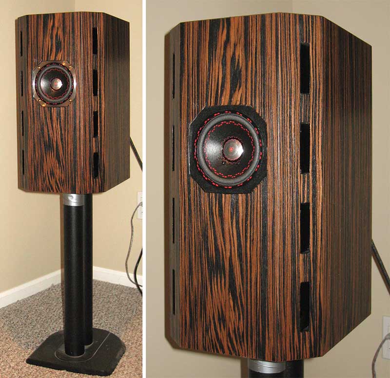

jrebman said:was glad to see another mention of the fonkensteens.
Andrewbee said:Madagascar Ebony?
They look gorgeous.
Slightly different species of the genus, actually - Macassar* In this case, paper back veneer for "ease" of working around the recessed driver and port slot cut-outs. Took the best part of a full 4x8ft sheet to get reasonable grain matching on all 6 sides.
4 coats of 25 satin (25`)water-based lacquer
thanx for the compliment
* there are over 300 species in this genus, but relatively few commercially viable.
