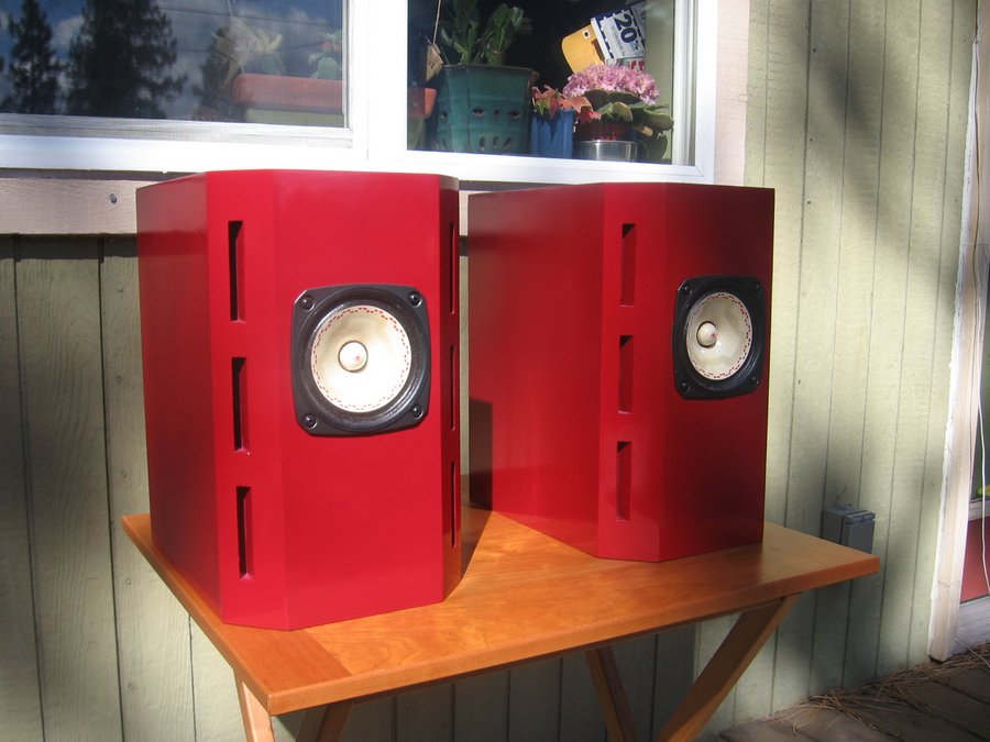

This is a post really for Dave (planet-10)
Ages back, you had a pic of some woofers you had put together for the fonkens - they actually worked as stands for the fonkens and shared the same profile as them.
Are plans available for them?

woodturner-fran said:Ages back, you had a pic of some woofers you had put together for the fonkens - they actually worked as stands for the fonkens and shared the same profile as them.
Yes. But althou performance is good i know we can get more out of the SDX7 so the SDX7 are going into something new (and simplier/sealed) and i have a set of different more suitable drivers (surplus pulled from the warehouse -- not eavailable new, so scarce -- but i may be able to scare some up).
The new ones are easily buildable from the old ones, with only a couple tweaks.
And i'm sure any number of drivers would work (i like midbasses with extended response). Maintaining the Fonken footprint, and keeping the height down to reasonable, you end up with a maximum of 28 litres ro work with.

Mine use a pair of CSS SDX7 per side push-push. Actively XOed at 100 Hz.
And to show how little "measured" extension they provide (obviously measures only tell a small part of the story) -- with a little electronic trickery i know i can get the new fonkenWoofs to 25 Hz in room.
dave

woodturner-fran said:I have 4 x bass speakers from an old pair of B&W speakers - 7" sets. They measure 11.7R impedance and are c.1985 vintage. ... Do you think I could make up something like your "stands" using the B&W drivers?
We;d either need T/S parameters or know what B&W they came out of (and the dimensions of that). Whether the box is sealed or ported is really dependent on what the driver likes.
The discussion of doing what you need has its own thread all-ready so alot of the questions you haven't asked yet are probably answered.
http://www.diyaudio.com/forums/showthread.php?s=&threadid=136956
Ben is building some woofers with some surplus Eastech woofers i had (same driver as i'll be using to fill the holes in the FonkenWoofTL when i take the SDX7 out.
