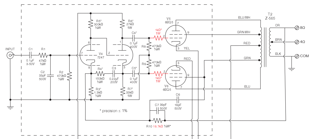

I figure C6 and C7 are on the top side of your pcb. I think you verified before that you have picofarad values on the page where you uploaded your Excel spreadsheet.
Can you or have you done a visual inspection to make sure that C6 is indeed close to 18pf and C7 is indeed close to 39pf and not accidentally reversed?

Yes, several times. Except that I could not get a stable meter reading on the 18pF. All four caps are clearly marked and are in the correct spots. They are Cornell Dubilier mica. I made sure that I installed the components with their values positioned so they can be read.
I have new C0G 18pF and 39pF MLCC Kemet caps sitting here. I haven't tested their values yet.

What is the function of C7? Something about a time constant, correct? The cheapo Chinese amp kit that I built just uses a resistor there.
Screen stoppers ?? 100 ohm is a suitable value.
One thing at a time. They would just be hanging loose inside the chassis because there is no place to secure them. Heavy wire -> resistor -> socket pin. Besides, I am not yet convinced they are needed.
C7 is a "phase lead" capacitor, and increases the phase margin of the amplifier, which improves stability.
Its value depends critically on the exact circuit and parts used, especially the output transformer.

The verdict is in on the four grid stopper resistors: use them! They have solved three issues. 1) The harsh edge to the sound that caused my original complaint mostly went away. 2) The instability of the output tube bias as the amplifier warms up is solved (was unstable for about two hours). 3) The range of adjustment for the output tube bias is now within specification and the potentiometers need not be maxed out.

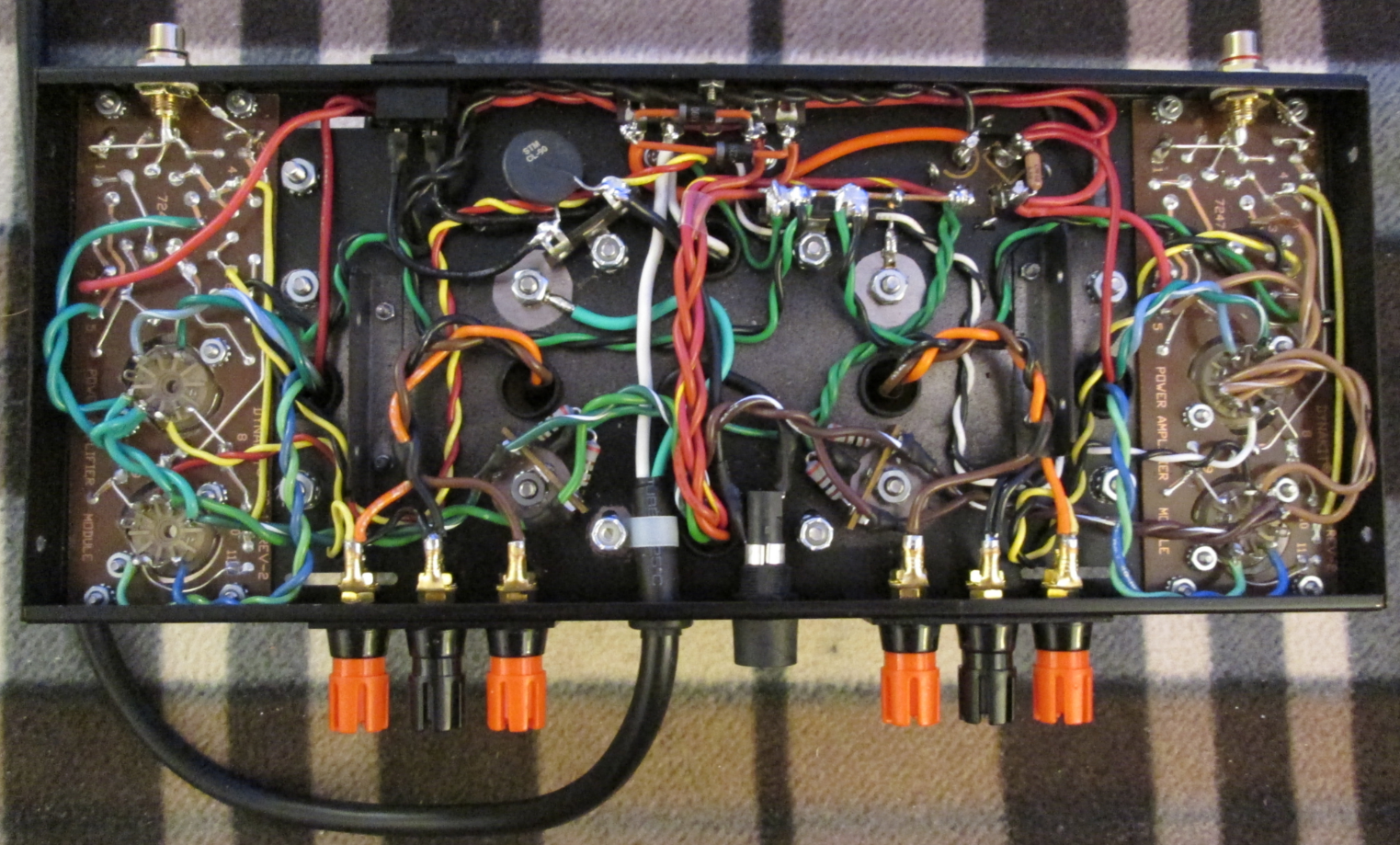

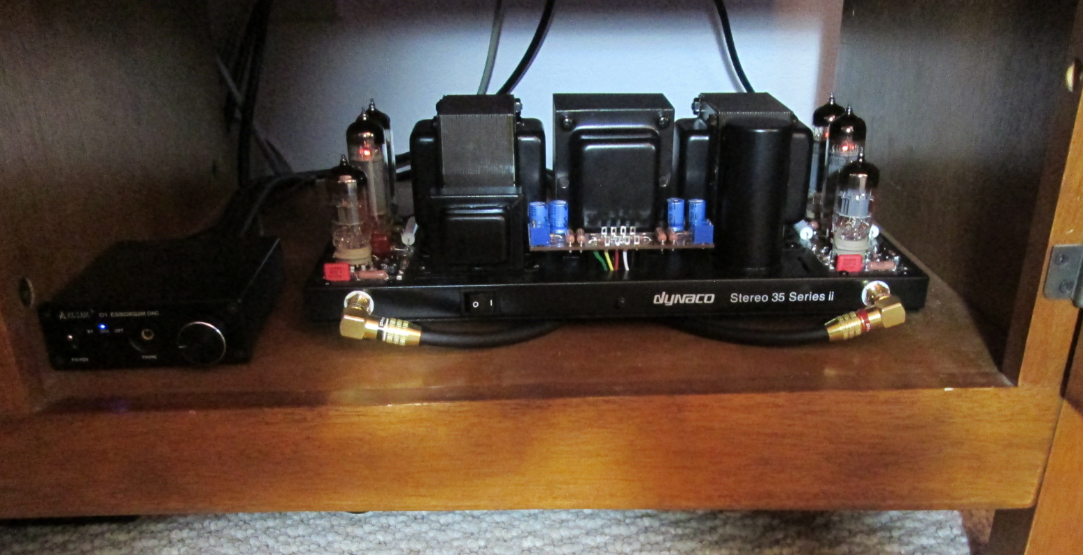

I thought I would give a little update on this amp. It is FINALLY giving what I consider great sound. I had to do several things.
I spared no expense on this amplifier build ($1,336 plus paint and decals last I checked) and added every available doo-dad and add-on and upgrade and mod (see thread), and I am glad it's FINALLY producing the quality of sound that I expected from it. 👍
I'm very happy with the all-black custom paint and decals. I hate silver and chrome. The front power switch was a great addition, as were the custom binding posts spaced for dual banana plugs. That black can cap is hiding three 120uF filter caps inside. The filter choke is a nice addition. The individual bias for each output tube seems to be working very well, and I run it a little above spec. Is it really a Dynaco ST-35? No, it is not really with all of the modifications. That's why I called it a "Series ii" 😀. I bought the tube cage for it in case a future owner ever wants the protection, but it runs so hot that I can't stand to put it on the amp.
The build date that I put on it says June 2023. I had no idea that it had been that long. My how time flies.
- Added four 1k grid stoppers to the four output tubes.
- Replaced the four mica NFB caps with new C0G 18pF and 39pF MLCC Kemet caps.
- Replaced a questionable output tube that just wouldn't bias like the other three were. The seller sent me one with identical test values, and replacing that one tube in the quad made a huge difference. I am thrilled with the quads of NOS Russian 6P14P-ER/6П14П-ЕР that I have bought for this amp and another. I think I want to invest in a lifetime supply. Like gold, good tubes seem to hold thier value or go up over time.
Very nice ST-35!
I'm using the same power tubes albeit branded Sovtek EL84M in mine with the same bias board.
However I did prefer the GE 12DW7 drivers over the JJ's. Maybe it has more to do with the speakers I'm using with this amp? I dunno. I tend to use a lot of JJ 12AU7's and 12AX7's though. The cage does get hot on the sides due to the power tubes. For whatever reason Dynaco only had two slots near the bottom put on each side if the cages. I want to find someone with a CNC machine to add more to the side panels. The cage should have had perforated sides like the rest of the cage.
I do wish Dynakit had sold there kits with solid core hookup wire instead of the stranded. It would have made wiring this thing easier, especially around the sockets.

Very pretty kit I must say.Update: here is the final schematic as-built. Parts in red indicate additions/changes vs. the kit.
I see in the mod the power supply input capacitor went from a 60uF input capacitor to a 120uF input capacitor.
Caution is always advised anytime you increase the capacitance value of the first capacitor in any capacitor input power supply even when solid state diodes are used.
Why?
Increasing the input capacitor value will reduce the conduction angle of the rectifier diodes.
Reducing the conduction angle of the rectifier diodes increases the peak rectifier current.
Increasing the peak rectifier current increases the transformer IR losses and the rectifier power losses by approximately the square of the increase in the peak rectifier current.
So in simplified terms a 10% increase in peak rectifier current can cause a 20% increase in transformer IR losses and so increase the transformer heating.
If your power transformer is designed to take the extra heat no problem but if not it may well live a shorter life.
Adding extra capacitance to the second capacitor after the inductor is a much safe location to increase capacitor value as it does not increase the peak rectifier current except at the point of turn on. This is also a far more effective location to reduce ripple by the addition of power supply capacitance.
