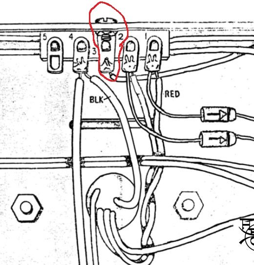

I have two questions. Is this terminal 3 (5 lug terminal strip) electrically connected to the chassis?
Are terminals A and B on the filter capacitor the negative poles of the capacitor? Do they form the chassis ground?

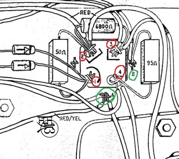

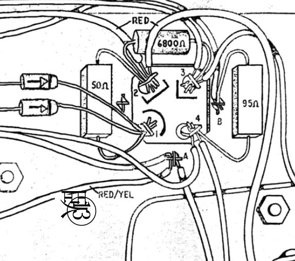

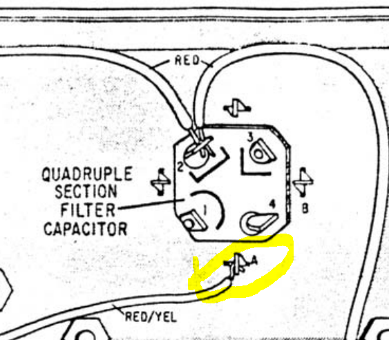

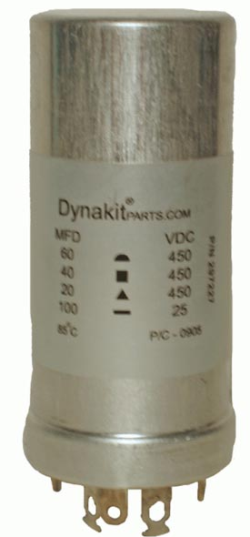

Good morning! I have another question. About the quad filter capacitor.
Since I don't have the original capacitor, I bought 4 individual capacitors (68uF 450V; 47uF 450V; 22uF 450V and 100uF), but I don't know how they connect to 1, 2, 3 and 4 and to terminals "A" and "B". Can someone help me understand these arrangements?
Bom dia! Tenho outra duvida. Sobre o capacitor quadruplo de filtro.
Como eu não tenho o capacitor original, comprei 4 capacitores individuais( 68uF 450V; 47uF 450V; 22uF 450V e 100uF), mas não sei como eles se conectam aos 1, 2, 3 e 4 e com os terminais "A" e "B". Alguém pode me ajudar a entender essas confecções?
As i said at audiokarma.org :
The schematics is your help here.
P.12 lists the resistors and capacitors.
C8A = 60uF
C8B = 40 uF
C8C = 20 uF
C8D = 100 uF 25 Volt. This is the catode cap for the EL84
C8A = 60uF
C8B = 40 uF
C8C = 20 uF

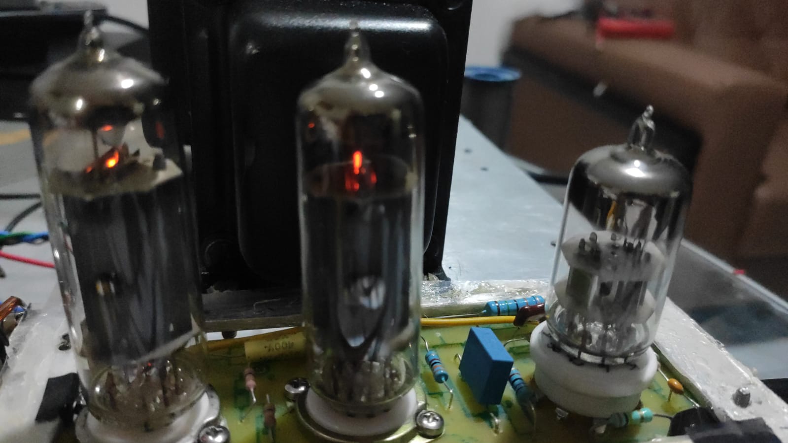

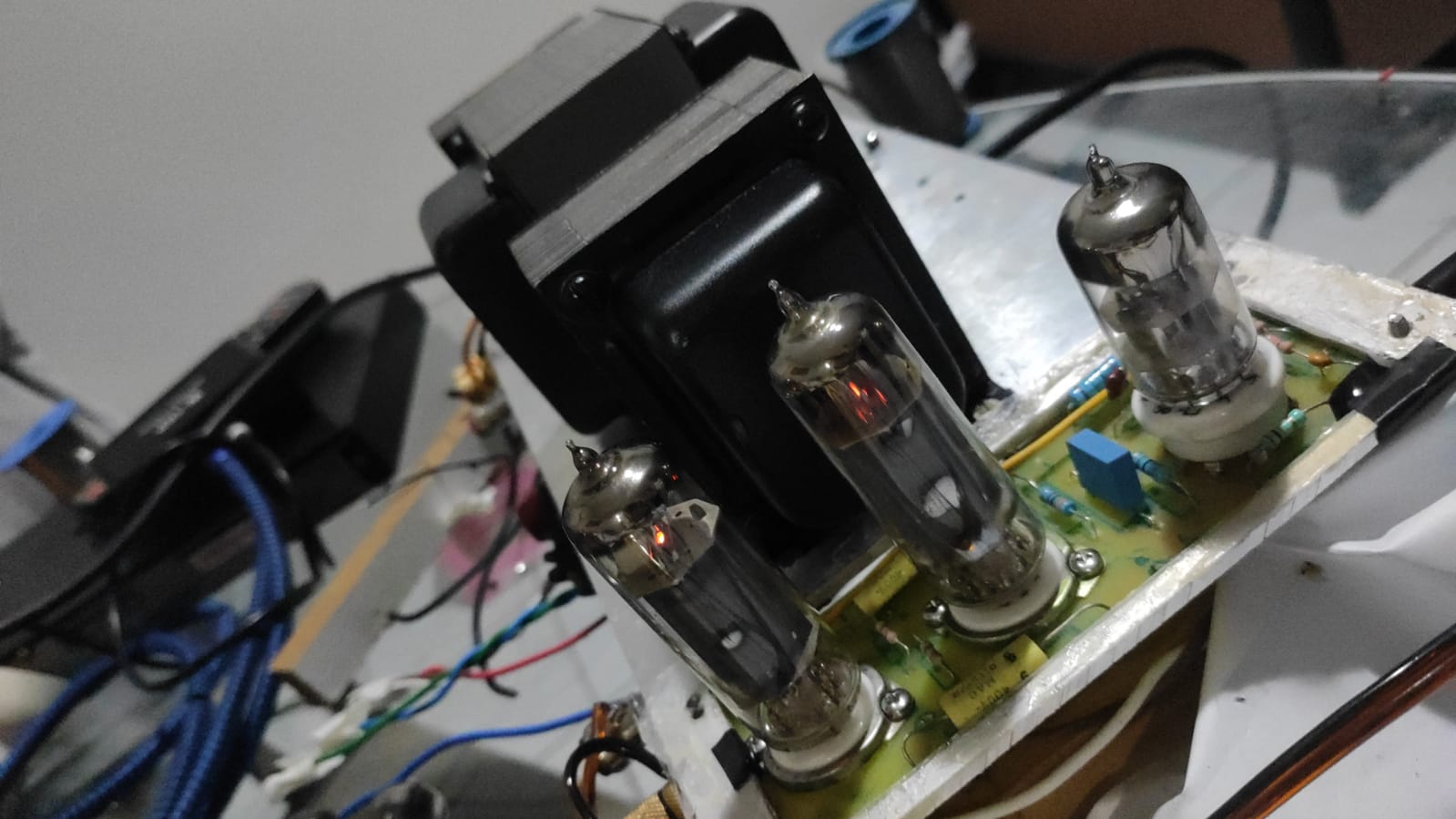

I am continuing to assemble my ST-35 clone. The first valve is cold, there was no warming. The sound is very low, I just set up a channel. Can anyone help me?
(Estou continuando a montagem do meu clone do ST-35. a primeira válvula está fria, Não teve nenhum aquecimento. O sem está bem baixo, eu só montei um canal. Alguem pode me ajudar?)
An ST35 clone uses a 7247/12DW7 first tube and EL84 power tubes. Were your PCBs designed for 6N2/6P15 and what is the schematic for your version. You know these tube are different from the “real” ST35 tubes and may not work properly unless the circuit is adapted?
If your 6N2 tube was not heated at all you probably would not hear any music. Have you accounted for the fact that the 7247 tube is a 12/6 volt tube where the 6N2 is 6V only? If you PCB was not specifically designed for 6N2 tubes you are possibly not heating it correctly. Check which 6N2 pins are connected to the 6.3 Volt heater supply and make sure pin 9 is not. Pin 9 should be grounded for 6N2.
Dear François, good morning!
The board was designed for 7247 and 6BQ5. When I use the valves (7247 and 6BQ5) a very loud whistle comes out of the amplifier. And I have to turn it off immediately.
I will do the checks you recommended.
"a large whistle" could be an indication of wrong polarity of the output stage, the nfb becomes positive feedback.
To confirm this disconnect the nfb, if the amp is not "whistling" this is the cause. Switching the output from the phase spiltter to the EL84 will cure this. Or swich all plate and g2 connections between the el84.
What is the NFB?
How do I disconnect the NFB?
Can you explain it to me better, since I don't have much knowledge in this area?
nfb = negative feedback. Takes a signal from the speaker output ( 16 ohm tap in this case) and feeds it back to the beginning of the amp,What is the NFB?
at the cathode connection of the first tube. If the phase is wrong ( transformer connection plate-g2-transformer tap )between the 2 el84 then the NFB becomes positiv creating an oscillator instead.
