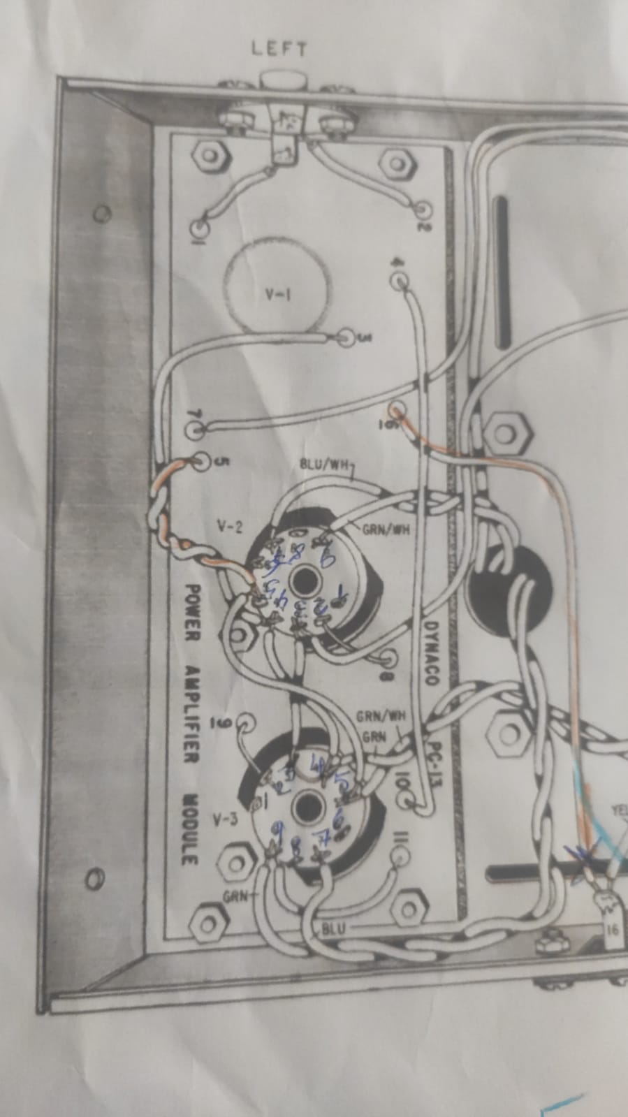

Taking this board as an example the "L" plate where I indicate with arrows A, B, C, D, E, F and G, which should I make the suggested changes?
rayma Moderator Joined 2011 Yesterday at 4:11 PM #304 Yesterday at 4:11 PM #304 No specific changes, but verify whether all the output transformer lead connections are correct, for both channels.
