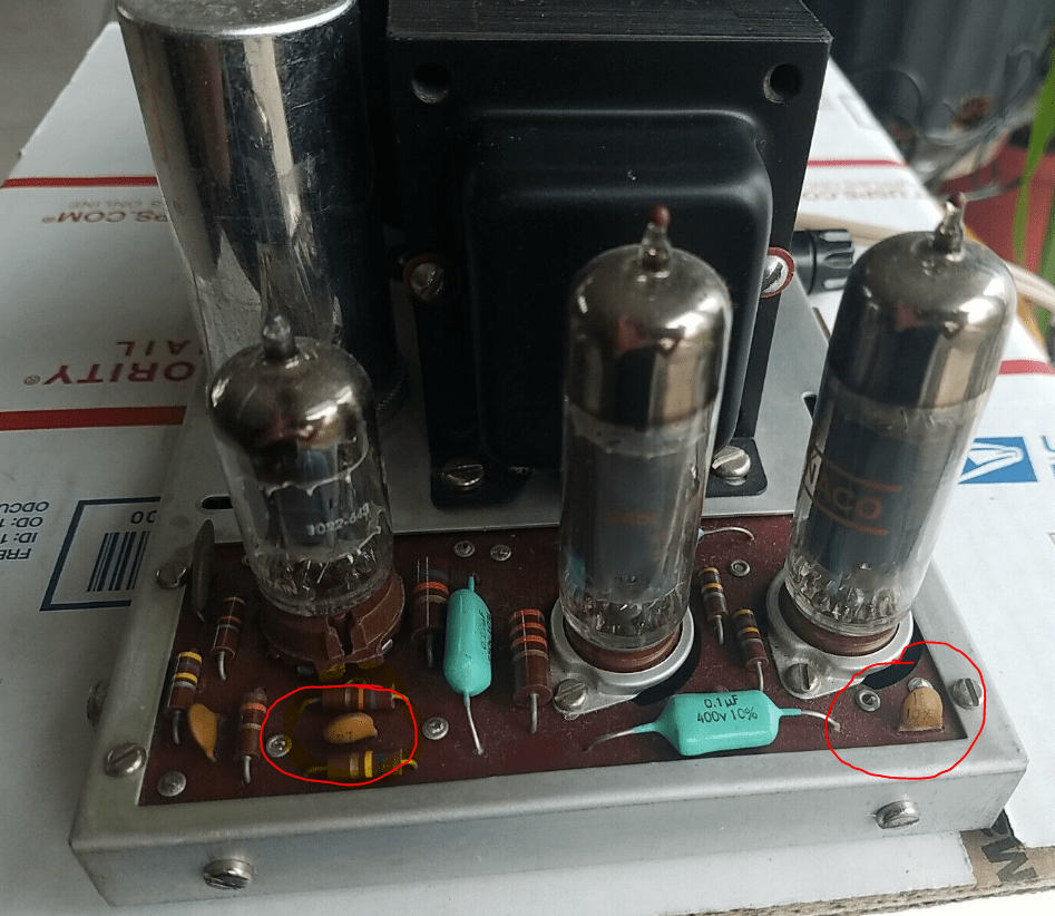

I still wonder about the fact that the original design used traditional ceramic disc caps in the feedback circuit instead of the mica caps that come with the kit. I wish I had been able to get a stable test reading on the tiny 18pF mica caps, but my meter wouldn't do it. I wonder what audible difference ceramic caps actually make in these 2 NFB positions, either the old style disc or MLCC? Like these:

The ceramic caps of yore were well known to be of very broad tolerance specification, somewhat like electrolytics in that sense.I wonder what audible difference ceramic caps actually make in these 2 NFB positions
They were widely used in kits, especially the IF strip as 10,7 MHz bypass of FM receivers such as Eico & Heathkit.
My recollection is the 0.01 microF is series resonant when the leads are cut to about 1/2 inch.
C6 is used to fix problems sometimes encountered in FB amplifiers at HF due to stray capacities & inductances in OPTs.
I did run into such a problem when running a Hammond 1618 in a PP circuit many years ago. A small cap such as C6 was the remedy.
The primary in many low cost OPTs is wound serially, I found the capacity of the primary to the core was sometimes 200 pF greater
from one end than the other. 🙂

Given that the Kemet (or cheaper Murata) MLCC caps are 5% C0G caps, I wonder if there is any difference at all between those and the mica caps that came with the kit. I found this, but I don't understand technical details in the thread:
Audiophile dislike ceramics. But C0G has best distortion performance and is very cheap. It beats everything else.

COG/NPO caps are perfectly fine for the job, with very low DA and minimal parasitic inductance. Mica is a "found material" and measured performance near the audio range varies with different tests and samples. It's great for RF, very stable with time and temperature (if selected for that), plenty of voltage rating available and possibly fine near audio frequencies. The little see-through polystyrenes aren't made anymore AFAIK (nobody -read Dupont- wants to make the sheet PS) so are probably only interesting to folks with lots of them laying around. Great, but hardly necessary.
The little WIMA FKP-2s are beautiful, and everyone should buy a whole collection while they're still available (wire lead parts are dinosaurs today, gone tomorrow) but 630 Volts rating is the bare minimum for the smaller one. Unless you're a grandparent, buy some nice resistors too. Tick, tick.

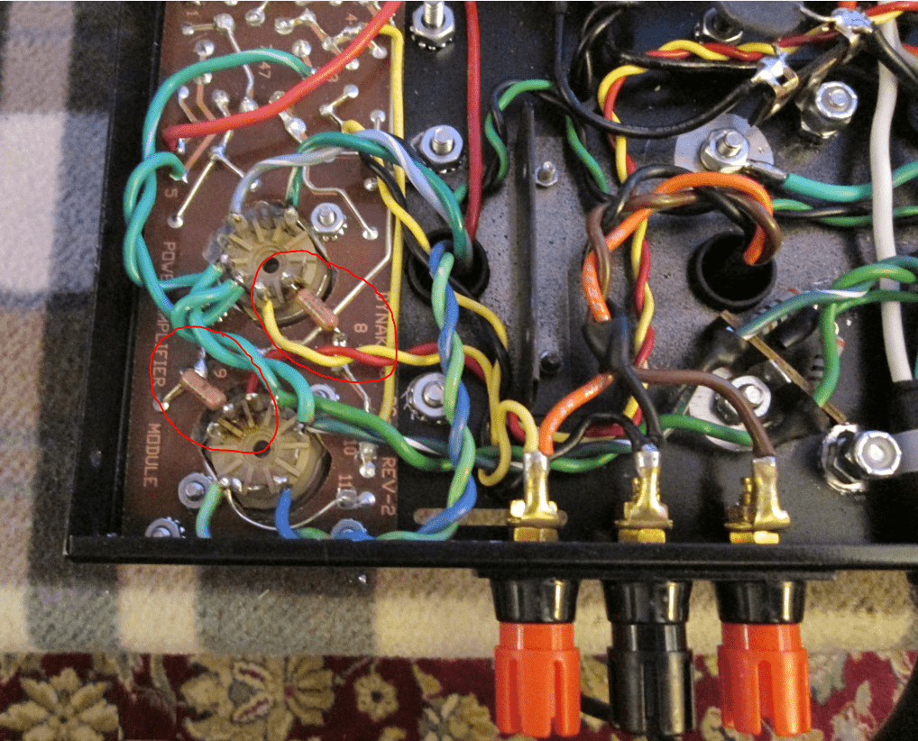

1k Ohm grid stopper resistors arrive tomorrow. Maybe I can get them in place this weekend. It will be very interesting to see if they actually make a difference.

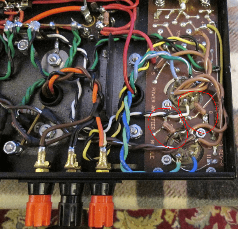

Well, well. What a difference 4 resistors can make. After a few hours of fiddling around inside the tiny chassis, I got the four Dale 1k Ohm grid stoppers installed. I can find no reason why these should be omitted. Does anyone have a legitmate reason to leave them out, other than to save a few dollars? The original circuit does not use them. They replace four short jumper wires from the PCBs to the tube sockets, and they fit perfectly.
So far, I haven't had a chance to do any real listening. However, when I held my breath and turned on the amplifier after the installation, the bias pots needed to be adjusted a whole lot. I had to turn, turn, turn the four pots down, down, down. They were up at about 45 mA when I turned it on. The highest I had ever gotten before, even with the pots all the way up, was 40 mA. They were at 37mA before I installed the resistors. After a whole lot of pot turning, I finally got them down to the 35mA spec. So, I let it play in the background for about 2 hours while testing the bias once in a while. The bias setting seems to be more stable now, changing much less as the amplifier warms up.
As I said, I can't judge sonic changes yet. Maybe tonight or tomorrow. Given the above notes, what changed when I installed these four resistors? Did they likely stop some sort of oscillation that was happening? How did that affect the bias setting so much?

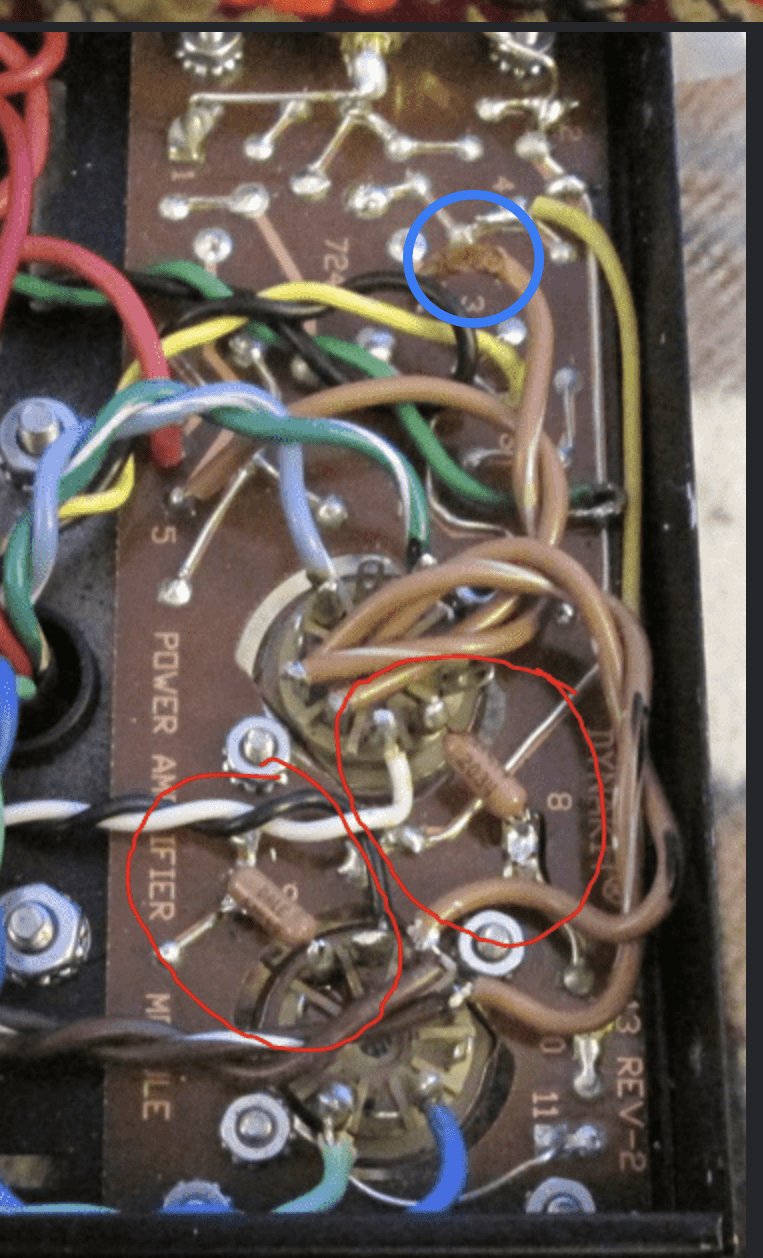

The ST-35 is stable with real EL84 tubes. But small changes can make it oscillate, even installing EFB
might cause real EL84 oscillate ( which is documented in the EFB documentation). As you use
cheap EL84 lookalike it's maybe an explanation. While you are "at it" you could install 100ohm screen stoppers too ..

They are actually more expensive than some EL84, and they have better life than EL84, and the same specifications as EL84, and they are proven to work in this amplifier by many users. I have two types on hand. Been through that. Not an issue as I have stated repeatedly.

Area circled in blue above appears to be a little concerning, i.e. insulation is burned off. Either replace or make sure wire is conducting.
You are correct and have excellent eyes. I did hit that wire briefly with the side of my soldering iron. It did not burn through the thick insulation. No conductor was exposed. It's one of the heater wires to the 12DW7.
The bias setting is much more stable than it was before, changing very little as the amplifier warms up. Still evaluating the sound.
