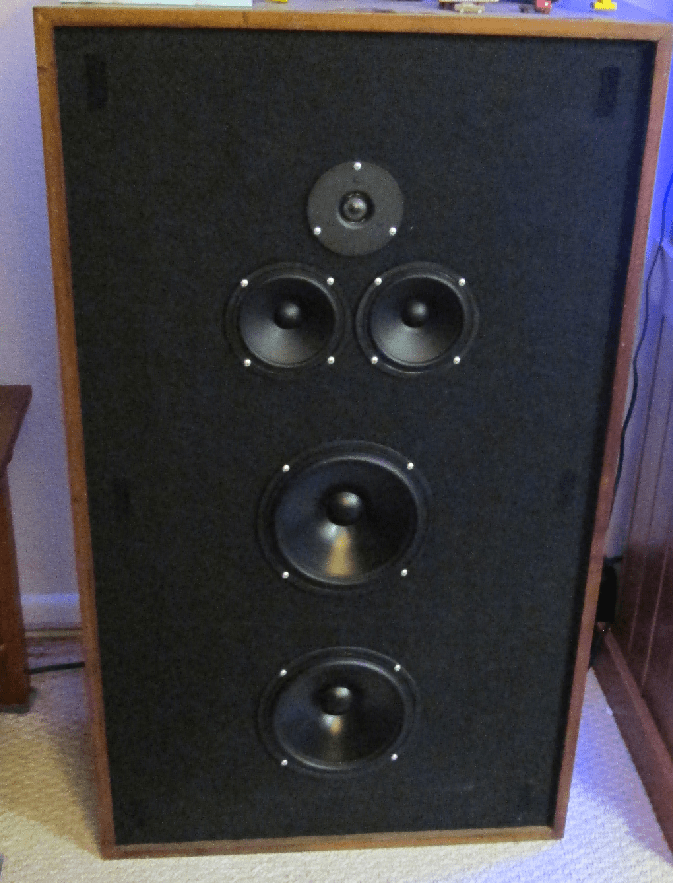

Please post a picture of your speakers when you can.
I knew someone was going to ask that. I have written this up somewhere before, but I forget where I posted it.
I spent a summer about 30 years ago housesitting for 3 months, taking care of two cocker spaniels while the owners were away (no comment on the dogs' intelligence) and I took that time isolated to do math and drawings for different designs about 8 hours per day most days. I was getting paid, ROFL. I spent the rest of my time reading papers by Paul Klipsch and various pro audio engineering references when people still used something called a public library. Very informative. Remaining time was spent in live jazz clubs listening (no comment on anything else done there). No computer. All math done by hand and with a simple calculator. I still have all of the math written down in a folder.
I then tried a number of different designs including open baffle because I had access to a neighbor's wood shop and I could knock out as many enclosures as I wanted any time I wanted. I learned about distance-related acoustic coupling between drivers, and I learned the critical nature of the baffle step, and then I finally admitted to myself that 99% of all loudspeakers need to account for a room with a floor and a rear wall somewhere. Go figure. 😀 Once we accept that fact and plan for it, we can design for the rest of the intended room. Every room I ever will have will have wall-to-wall carpet and/or heavy area rugs covering everything. Almost every room I ever have will be have side walls at different distances. So we have to account for that. Then there is the ceiling. Yes, we need to account for reflections and interactions there too. I always have a standard ceiling, not vaulted, so add that in. As for the rear wall, I don't live in a warehouse and can't ever have speakers 1/3 of the way out into the living room. So we need to account for interactions with the rear wall and if we are smart and planning well then use it to our advantage. Notice the method to my madness - you can't plop any speaker down in any room and expect to get the same result as someone with a different room.
I also developed a speaker technology that I have thought about patenting for decades. It hasn't ever been done before. I implemented it for testing in a small speaker but don't use it currently, sadly. Maybe one day. I just don't see a market for it due to the extreme cost and engineering and construction difficulty of implementing it. It's all written down and will be made public by a relative should anything happen to me.
I have always wanted to design and build a floor-to-ceiling line array speaker for fun, but it's huge and time consuming and expensive and I no longer have access to a wood shop.
Enough of that.
The picture of the Eviction Model 1 Loudspeaker
It may not look fancy as it's "just" a large 3-way floorstanding speaker. Roughly 4 feet tall. It's the engineering and voicing during development that makes them work. Boston Acoustics did a similar physical configuration and so did JBL, but they both overlooked one critical factor that I didn't overlook. They work for me. They can reproduce a pipe organ or a snare drum accurately, and with a 300 watt per channel amp, they will do a snare drum at doggone near correct volume in a small room. Very efficient. Use the "next room test" on any loudspeaker. Put a drum set in the living room. Go into another room. The drums will still sound live. Go to the other end of the house and close three doors. They will still sound live. Go out to the street. They will still sound live. What about the speakers? Yes. I have done it all. I have even taken them outside for testing to eliminate side walls and the ceiling. I had to notify the neighbors first of course.

Wow!
That is a very nice loudspeaker.
The idea that the speaker is not dependent on the listener having to sit in the sweet spot is probably one of the most important factor of your speaker.
I am impressed.
Only once or twice in my life have I been able to walk from the listening room to another room, and had it sound "Live".
But I was curious about the parallel woofers and the parallel midranges, and how that might affect the "different sound" of the ST-35 versus other amplifiers.
The Vifa woofer DCR is 5.7 Ohms, 2 in parallel is 2.85 Ohms DCR.
The woofer impedance graph shows 6 Ohms from 200Hz to 600 Hz (3 Ohms for 2 in parallel; pretty close to the 2.85 Ohm DCR).
I expect that at the port tuning frequency, the parallel woofer impedance may be somewhere between 3 to 4 Ohms.
The Vifa midrange DCR is also 5.7 Ohms, 2 in parallel is 2.85 Ohms DCR.
The midrange impedance graph shows 8 Ohms from 400Hz to 900Hz (4 Ohms for 2 in parallel).
I am sure there are a lot more factors that affect the impedance versus frequency, such as the crossover, series resistor for equalizing sensitivity, the cabinet, stuffing, etc.
You know all that about your speaker.
It does appear that some amplifiers might sound different, depending on your speaker's impedance versus frequency.
I hope that the ST-35 can be adjusted to sound the way you want it to sound with your speakers.
Good Luck, and happy listening!

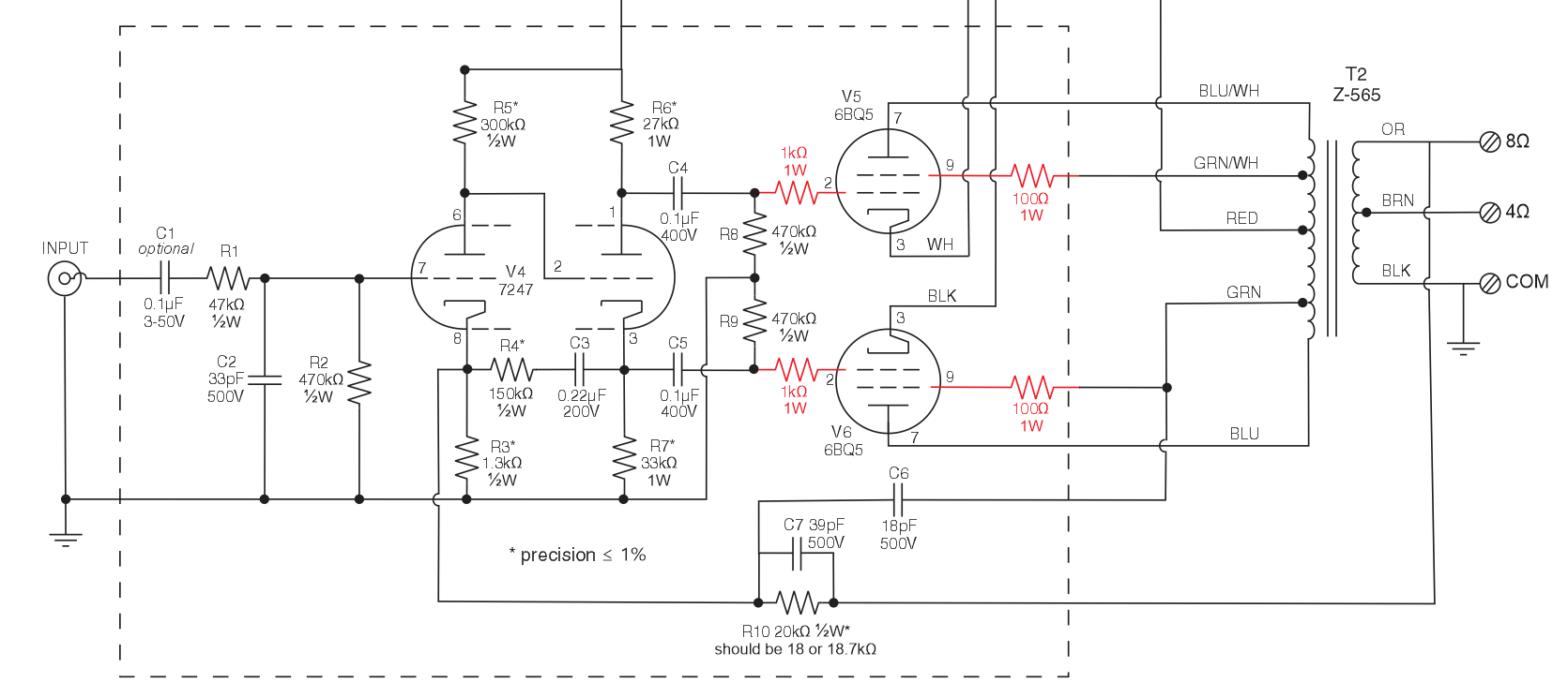

To those of you proposing that I modify the amplifier, it would look like this, in red, correct? The 100 ohm would be hanging loose in the air, which is not ideal. The 1k ohm is very easy and would have the most benefit, correct? I could do the 1k ohm resistors in just a few hours, if I order the resistors. They would simply replace an existing jumper wire from the PCB to the tube socket. Other than $10 (because of shipping cost) and a few hours of time, is there any downside to adding those 1k ohm resistors? Both the ST-70 ii and the cheapo Chinese EL84 amp kit do have them in place.
Never Get Old,
1. Agreed, use the 1k resistors at pin 2; use the 100 Ohm resistors at pin 9.
2. An easy modification that should fix the 8 Ohm and 4 Ohm tap problem.
Change R10 from 20k to 14k (or 15k, whichever is easier to purchase)
Change C7 from 39pF to 50pF.
Then remove R10 and C7 (now 14k and 50pF from the 8 Ohm Tap, and re-connect them to the 4 Ohm Tap.
Now, wire your speakers to the 4 Ohm Tap.
The negative feedback is now coming from the Tap that your speaker uses.
I bet that fixes the problem.
6A3sUMMER's suggestion moves the feedback tap down 3dB and then decreases feedback network impedance 3dB to keep closed loop gain at its original value. This is almost not even a modification, merely an adjustment to optimize for desired OPT tap. If you were to keep the existing values and simply move the feedback source to the 4 Ohm tap you'd have 3dB higher closed loop gain and 3dB higher source resistance to the speaker (from both taps), and 3dB higher distortion. Super easy to try, but maybe or maybe not what you want. Amplifiers have been made with feedback taken from multiple taps and mixed together, or from dedicated feedback windings (although this is for distortion reduction and a step away from your goal).
Grid (G1) stops are also not a modification and are only left off output valve grids for cost savings. David Hafler ("The cheapest part is the best part.") knew how to keep his stuff affordable, but he had those exact Eisenhower era parts and layout right in front of him to work with, so could confidently bend Best Practice in ways that DIYers shouldn't (and needn't - parts are cheap). It was Japanese fashion in the 1980s to omit grid stops, probably because of how schematics would look, then it became fashionable in the New York Noise set and both were popularized by Sound Practices magazine in the 1990s. Foolishness, but we're only young once, if at all.
Screen (G2) stops are less critical but if used many would recommend that they be very low wattage or even "fusable" resistors, the hope being that in some catastrophic overcurrent failure mode they'd bake open before the screens get too cooked. I've heard of a situation where this actually saved the valve, and therefore a matched quad of valves. Easy enough anyway.

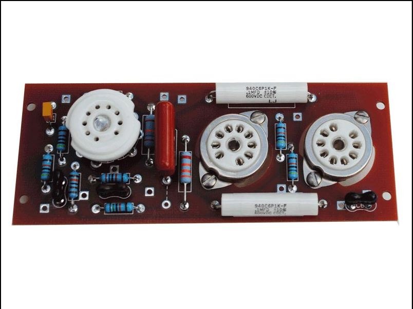

The ST35 boards are sometimes prone to oscillation , different tubes might be all that is needed. Even inslallingWith all that cash & sweat you have invested in various amplifiers & speaker systems over several years you could
easily have bought a first rate scope, SG & other test equipment. And learned how to use it all to advantage.
On this amp there could be bursts of ultrasonic oscillation that could be detected with a scope.
And fixed with low value, carbon composition resisters in the plate & screen leads close into the tube sockets.
But difficult to do on a PCB.
Running up close to the dissipation limit is never a great idea, if the line goes high the result could be red plating or worse.
The heat is a problem for the PCB unless it is MIL Grade. 🙂
EFB kit can provoke this unless screen and grid stoppers are installed.
Yes, building amp lacking oscilloscope is asking for trouble.
