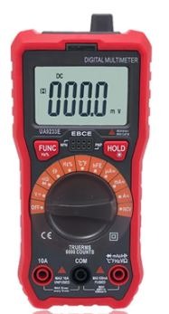

I might buy another meter I suppose. What would cause those millivolts there?

This small DC voltage isn't significant. Some comes from leakage through the coupling caps and some comes from grid current (which is never zero, and increases with current).What would cause those millivolts there?

Is there an inexpensive meter for sale online that's reliable and trustworthy?

I think you said that you do not trust your DMM.
Otherwise, I would suggest accurately measuring the DCR of your loudspeaker.

It's not that I don't trust my meter or that it's known to be bad. It measured all of the resistors and capacitors exactly to their label specs, except the smallest of the feedback caps in the low pF range, where I wouldn't expect it to work well. Someone here also questioned its ability to measure millivolts accurately. I can't say that I have any way to verify its accuracy in the millivolt range. So, the option of getting another meter was presented, and that's manageable. I do trust the one I have to accurately measure the DCR of the speakers. I have no reason to suspect it measuring that.

If you had a good DMM, you could accurately measure the DCR of your Loudspeaker.
