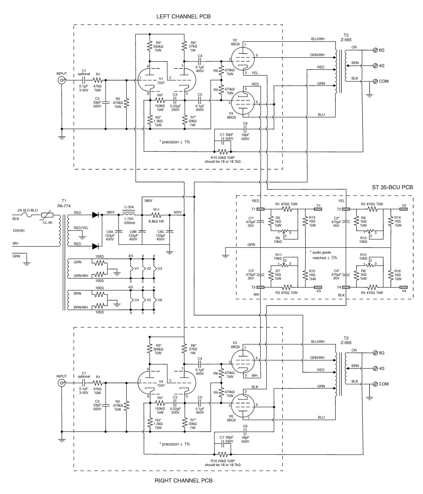

Your schematic in Post # 170 is not the same as it is in your Post #1.
From the multiple documentation of your posts, I feel like a dog chasing its tail.
The schematic in post #1 is the ST-35 as I built it.
In #170, that is the schematic of the simpler, cheapo $400 Chinese amplifier kit that I built recently. I was looking at it - for comparison purposes only - since it uses these same output tubes, and I like it very much. Sorry for any confusion.
I'll post the current ST-35 schematic again here so people don't have to go back to post #1. For those interested in a feature summary comparing the ST-35 built here vs. the original ST-35 design, I also wrote this change list as well as a pictorial wiring diagram in addition to the schematic.
So far, I am not convinced that you are running 35mA cathode current in each individual output tube (that is the sum of plate current and screen current).
When I perform the adjustment procedure, I measure 350mV at each of the test points for the 10 ohm resistors. The bias adjustment procedure is as follows:
Power on the amplifier. Set meter to DC Volts. Place black negative probe on board ground reference screw. Place red positive probe on terminal post V1. Adjust potentiometer R9 until you measure 0.350 VDC (350 mV).
Repeat above procedure at R10 & V2, R11 & V3, R12 & V4.
The current setting of each EL84 output tube should now be 35 mA. This can be adjusted to your preference via the on-board bias potentiometers, providing a useable range of 320 to 450 mV (32 to 45 mA).

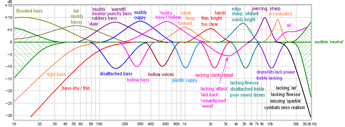

Maybe this helps correlating the subjective with the objective (it’s a hobby anyway!):

The red bass line labelled bass-shy/thin and the red mid line, at least the words harsh and thin plus the turqqoise line edgy and sharp. I doubt the amplifier actually measures per that chart, but the perception of the sound would be described that way verbally.

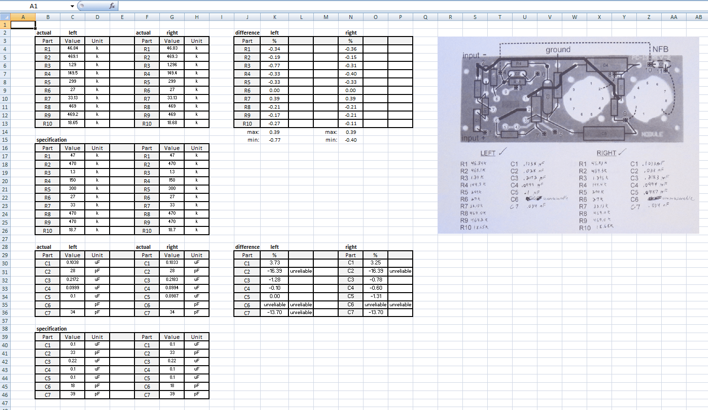

But I am a testing freak. I measure all resistors, caps, passive parts;
Like this? I tested every single component when I got it from Mouser/DigiKey, then put it in the proper bag with the corresponding Dynakit parts, labelled the bag with the correct value, and then as I put each and every component into the circuit boards, I measured, matched L-R, and wrote down every single value on a worksheet:
Tonight I dropped it all into Excel to quadruple check all values and to see what my variances actually were. Of course, these numbers are only as precise as my inexpensive meter, but they should be close enough. Almost all resistors were 1% or less tolerance from Mouser/DigiKey to begin with. I can't find the sheet where I hand wrote the actual measured values for the bias control circuit board right now, but it's here somewhere. I can read all of the values on those few parts visually, and still have the labelled bags, and they all match spec with each one in the right holes. So everything is documented as the correct values, and we can rule that issue out.
I have a sneaking suspicion that this situation has something to do with the add-on adjustable bias kit.
@6A3sUMMER, you pointed me in a valuable direction. I am not convinced either. Referring to the measured voltages in post #172, why are my voltages universally low on pins #3 of the output tubes?
Using the bias adjustment directions, I measured 350mV at the 10 ohm resistors, as in post #173. Tonight, out of curiosity and frustration, I turned the four bias pots up as far as they would go, which gave me 366mV. Wow, what an improvement. I could hear the change as I sat on the floor between the speakers turning the pots. Most of the harsh midrange edge is gone now. The bass is significantly better, and the sub-bass is better (but still not enough).
Now the questions are:
- WHY?
- Which components do I change and to what values to get the potentiometers back to somewhere around center instead of maxed out, leaving me no more adjustability?
- Is 366mV actually the correct value in this case? Should it be slightly higher? I can't test that because the pots are maxed out.

I have no reason to supect it, but anything is possible. I wonder if I have something with a known mV source around to test. I don't have access to another meter unless I buy another one.
Looking at your measured voltages I noticed you measured 10-15 mV on the output tube grid pins. That should be 0 according to specs.
I did notice that. I have no idea what would cause that unless it's the tubes themselves, or the meter somehow measuring something that is not there. All of the component values in the whole amplifier have been confirmed 4 times and actually tested 2 times. I was extremely careful with all of the solder joints and therefore doubt there is a bad one anywhere.
I only tested with the 6P14P tubes, and only then with them at 35mA. Perhaps I will retest with 6P14P-ER next time I remove the amplifier.
Something ain't right here, and I can't figure out what it is. It sounds good with the bias pots maxed out, but it shouldn't require that. Regardless of possible meter issues measuring millivolts, the fact is that the amp only sounds good with the bias pots maxed out, for both the 6P14P and the 6P14P-ER.
Has it been said that converting to fixed bias would have advantages?
I don't want to change the design. It should operate and sound good with the given design, and it does with the bias pots maxed out.
One could also get a quad of matched EL84 which is what the transformers are made for.
Reducing number of unknown will enhance trouble shooting.
