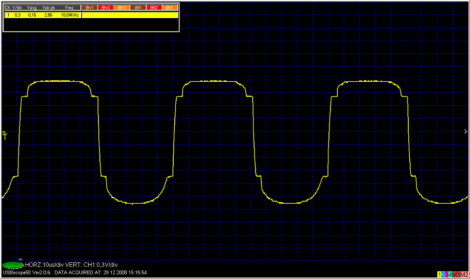

Scott, thanks for your input, I should have mentioned that I simulated the BJT preamp, and BJT models are sometimes not 'that' bad.
However, I failed in simulations of output current limitation (shrt), simulation showed total nonsense (no Vbe zener etc.) -
Hereby the measurement on output Re resistor (2R7), output shorted to gnd. Input is 8Vp-p, gain 4x approx.
BTW, I studied enthusiastically Wong and Ott during my university studies.

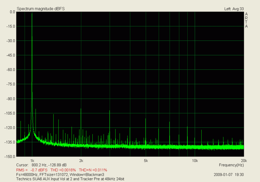

Here's a measurement made witht he Tracker Pre in unbalanced connections with no special consideration taken for
ground issues or signal conditioning or battery power. Just connected the Tracker Pre to a Technics SUA6 line amp.
Spectra is not as clean as it can be but the noise floor is still
at 140 dB.
This time I used ARTA for software.
Sigurd
at 140 dB.
Sigurd
Thanks. Can you change the FFT window type (Hanning, Flat, etc...)?
What chipset is this audio card using? What type of opamps?
How many averages are you using? How long is a measurement cycle?
Yes, one can change to several FFT windows.
I highly recommend to try out the software ARTA (incl STEPS and LIMP) and also SpectraPlus.
ARTA is only about 100 Euro. SpectraPlus is a professional SW.
Both can be found as demos.
The Tracker Pre uses these converters: AK5385 and CS4392.
If you want better ones, the EMU 1616m uses AK5394S and CS4398 and the 1515m has even lower THD and better SNR.
I do not know what OPamp the Tracker Pre uses.
Measurement time is dependant on FFT size and nr of averages. At 128k samples with ARTA each sweep takes about a second.
At <16k it is real time.
I use between 1 and 100 averages depending on what type of measurement I do, and what accuracy I want.
Sigurd
