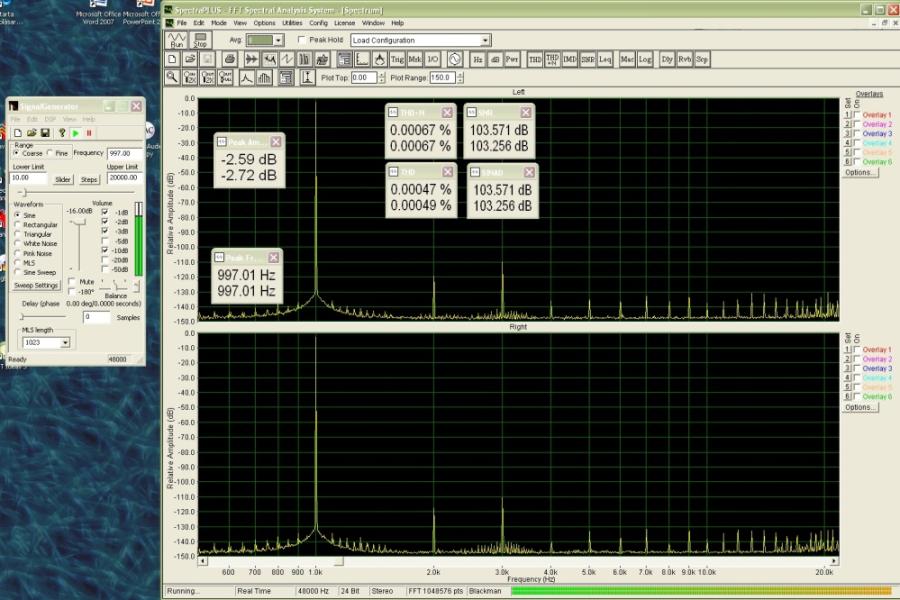

getting such low noise levels with a decent sound card is not that difficult if you have good software to match it.
Here's my USB soundcard's THD and THD+N and SNR. Line out - > Line In. Balanced mode.
FFT size is 1024k.
Adding average makes a clean noise floor.
Sigurd

Sigurd Ruschkow said:
Syn08,
FFT size is 1024k.
Line out -> Line in balanced mode is like the AP self test. The problems are starting when connecting to the outside world (ground loops, EMI radiation, etc...). Otherwise said, I'm not surprised by the intrinsic noise floor of the sound card but by the low noise of the entire measurement setup. In post #338 http://www.diyaudio.com/forums/showthread.php?postid=1704731#post1704731 while measuring the preamp, the noise floor is -132dB, and this is not even in a balanced configuration! That's why I'm asking about details on the measurement configuration.
What sound card are you using? I have tried last year a Lynx L22 and I was unhappy with the results. Of course averaging helps but it took forever to average down to a reasonable floor.
A question I was never able to get a good answer for: if soundcards + software are that good, how come AP is still in business?

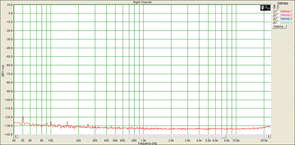

syn08 said:
- I'm stunned by the sound card measurements results. Care to disclose a few details about yours and your friends setups?
Well, there is no mystery, though it is not so very easy. Clean background depends a lot on:
- generator used
- sound card used
- coupling used (interconnecting cables, ground loops - loopback method is unusable, higher frequency ground loops through capacitance of power supplies etc. etc.)
Several hints:
- use very clean signal generator
- use battery supplied PC or isolation transformer before PC
- minimize length of interconnecting cables
- use differential measurement (if possible) even for single ended measurements, i.e. subtract possible hum voltages on ground return
- use transfomer coupled generator if available.
Anyway, I can achieve very clean background even in a real audio chain setup with CD/SACD player, standard cables used (RG-59), no transformers, no differential channels:

I only wanted to show you how good a cheap soundcard can be. Not how to get that good performance in a test setup. To get good performance in a test setup you have to do the normal
measurement performance work - and maybe some more work as
there is not much signal conditioning made.
One of the reasons for useing an AP instead - much less hazzle, and traceability, easy of use, programability, support, training, calibrations made et etc. AP is not "only" a measurement box.
The soundcard I showed is the EMU Tracker Pre costing about 150 USD!!
It is a USB soundcard and I prefer the soundcards to be external.
Sigurd
