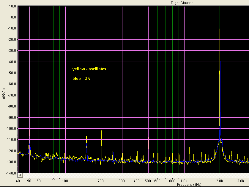

Quite large number of units were assembled and produced, and a few of them had strange behaviour. There was a hum and noise in the right channel (designation according to documentation). Also, DC component was unstable when turning the pot.
The reason was oscillation in a diamond buffer, about 200MHz. When measured THD, mains line components and LF noise increased.
The solution is to add 100R resistor before input of the diamond buffer. And 2 PCB tracks must be cut. Please see the images. I am sorry for the problem.

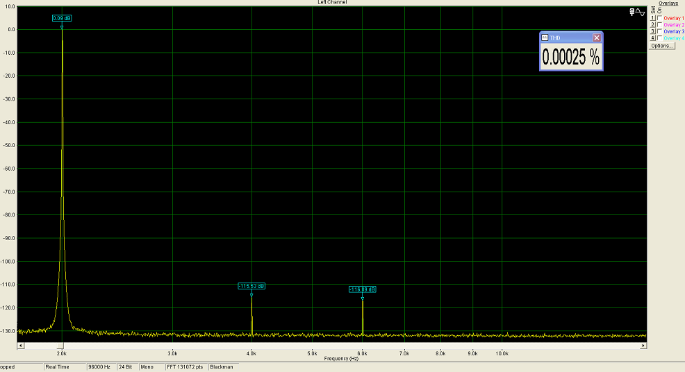

PMA said:Hi Nico,
we have some new results as well. The feedback is 12dB.
Excellent achievement with so little feedback.
Run it open loop with only a tiny signal before clipping. The THD should only be 12 dB higher, than this then.
Nice work
Yes it is, about 4x higher. It is all about distortion cancellation in input complementary-differential stages, exact BJT PNP-NPN matching and emitter (degeneration) and bias resistor sellection. I cannot get this with JFEts.
PMA said:Yes it is, about 4x higher. It is all about distortion cancellation in input complementary-differential stages, exact BJT PNP-NPN matching and emitter (degeneration) and bias resistor sellection. I cannot get this with JFEts.
See if the design can work safely with 1.5 - 2 x the current rail voltage. THD is indirectly related to supply voltage. This is because distortion is related to second order intercept.
I see an interesting phenomina, I did not look carefully before. You have no even order products and only H3 and H5.
If this is a real signal then look for the problem in the signal generator, it may be generating these harmonics and not the amplifier. Try putting a very high Q passive filter at the output of the signal generator.

Yes, the design can work with higher supply rails. As is, I would not exceed 2 x 22V.
No, there is only H2 and H3. The base is 2kHz in the last measurement.

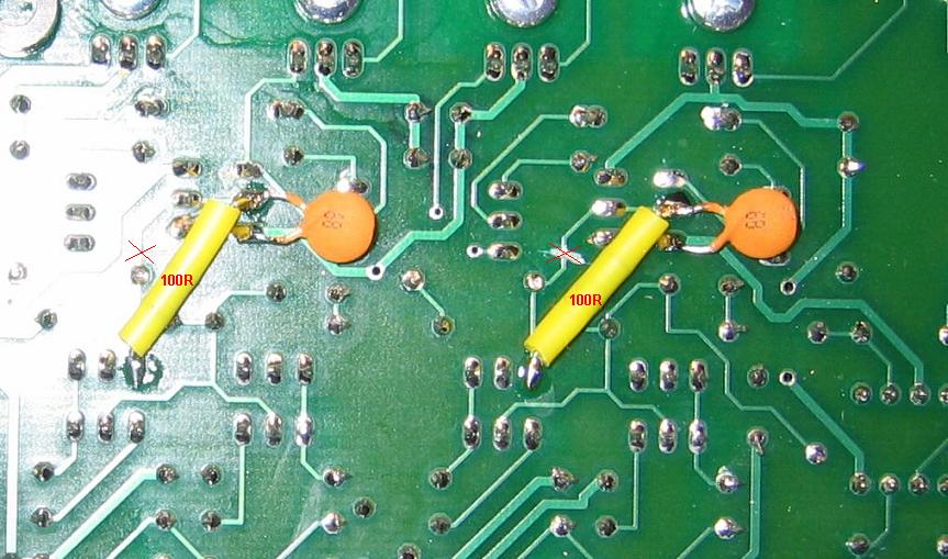

I had been fighting against HF oscillations in the output diamond buffer of some of the modules, and found the solution as described in
http://www.diyaudio.com/forums/showthread.php?postid=1690502#post1690502
but a 68pF cap must be added as well. Please see the photo. The modification has been tested since December 22 on several pieces successfully.

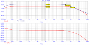

Make sure you also redo the measurements; if the cap is placed where I believe it is, it's going to be some significant impact on OLG, distortions and SR. I'm also curious if this change will affect the sound?
Both simulations and measurements were already done, as well as step response measurements. And listening tests also.
IMHO the circuit is still fast enough for audio use and has flat OLG above audio band.
THD spectral analysis shows almost no difference in audio band; step response is longer (rise time 880ns) and preserves same shape for large and small signals.
Simulation shown is without capacitor in input RC filter.
I would like to show the difference between oscillating and non-oscillating status in the same channel. It was pretty tough problem, not seen by scope at the output.
The 68pF cap position may seem strange, but remember they are the PCB parasitic impedances together with fast buffer driver transistors that made oscillation condition to fulfill. It oscillated locally above 200MHz, with almost no change in THD. The cap must be placed directly where it is.

I have no doubt that your preamp is still very good. Could you though describe the sound of the modified preamp? The impact of the two caps should be clearly audible.
I guess it has to be a ceramics cap,
but did you try with a polystyrene cap?
For littlest sonical impact.

Caps 68pF are NPO ceramic.

Something is not right... http://web.telecom.cz/macura/step_s.gif only 5V/uS? It says 0.3V/div and 400nS/div.
The cap is where I was assuming it has to be... But the 22k resistor, if installed, doesn't have a dramatic impact on the OLG (and hence THD)?
