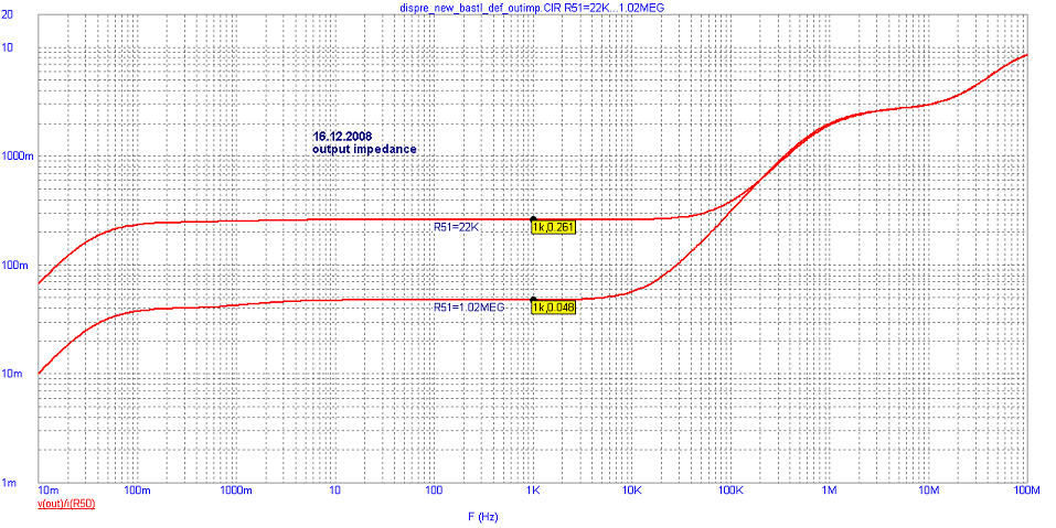

PMA could you please post Output impedance vs Frequency graph from MicroCap simulation?
Thanks, Borko.
Thanks, Borko.

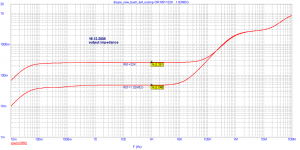

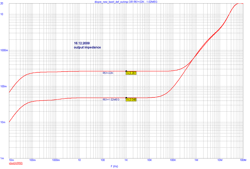

PMA said:The lower trace is for VAS unloaded, the upper trace is for VAS with 22k load.
Hmmm... So at (say) 1KHz the output impedance is 5 times higher with the VAS loaded. This is obviously because of the OLG decrease by the VAS load http://www.diyaudio.com/forums/showthread.php?postid=1702968#post1702968
Nothing unexpected so far, but then care to explain why other parameters (THD, etc...) seem to be unaffected by this OLG decrease?

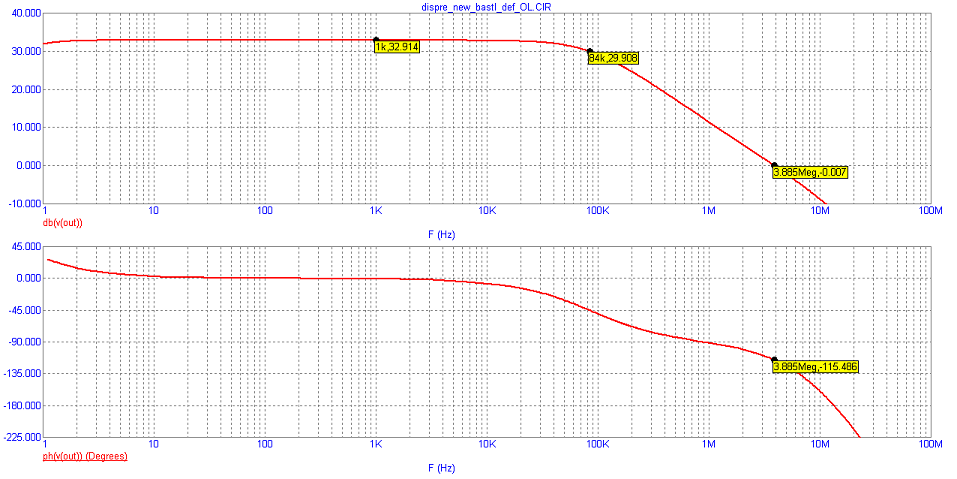

It was pretty tough to me explain it in Czech language on our forum. The case is that the basic condition of the classical feedback theory is not fullfilled - there is no ideal subtractor in the input, due to high emitter degeneration and Rbias + Rbias divider. But I will try in English too.
Look, this preamp has LOWER distortion after VAS load then without VAS load. Optimum VAS load is 22k - 30k. There is an influence with distortion cancellation NPN-PNP curves. I am telling you my secrets 😀

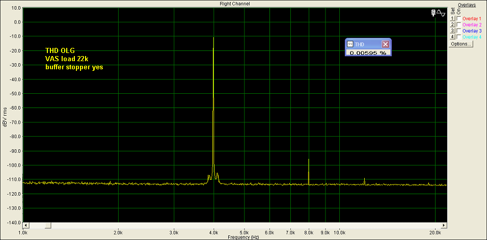

First, let us start with MEASURED OLG THD, with VAS loaded by 22k. OLG (A openloop) is 32,9dB in this case.
Now, several numbers from SIMULATION, as simulation fits with measurements quite well. Only measured distortion is a bit higher, depending on NPN-PNP matching.
1) VAS not loaded
openloop gain Aol = 58.2dB
closed loop gain Acl = 12.4dB
loop gain βA = 45.8dB
THD with open loop = 0.0085%
THD with closed loop = 0.00038% (you see it does not fit)
2) VAS loaded by 22k
Aol = 32.9dB
Acl = 12dB
βA = 20.9dB
THD with open loop = 0.0024%
THD with closed loop = 0.00033%
So, usual assumption that THD after closing loop is βA lower than openloop THD does not work here.
If the circuit was biased byCCS and had lower degeneration, the basic equations would work. BUT the dynamic behaviour would be changed the way I do not want, AND OLG would not be flat high above audio band, the condition I want to be fullfilled.

Regarding higher output impedance with VAS loaded: distortion is lower in case of the 'usual' link stage loading, i.e. 600 ohm and higher. In case of hard loading, like 32 ohm headphones, distortion is lower with VAS unloaded.

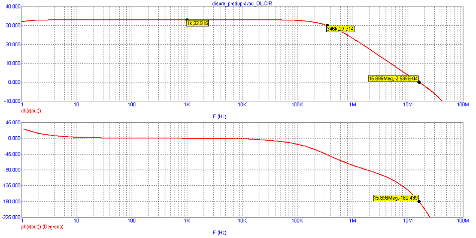

All these (Aol, Acl, loop gain, etc...) are at what frequencies? I'm still confused by these results. All I can tell is that loop gain at the THD frequency is not worth a penny specifying. What helps is the loop gain at each of the spectral components frequencies.
Example:
An amp has OLG of 60dB at 20KHz, 40dB at 40KHz and 20dB at 60KHz. Assume the open loop amp has 10V output with 2mV 2nd harmonic and 1mV 3rd harmonic, accounting for about 0.022% THD20 in total.
After closing the loop, the 2nd harmonic will be 0.02mV and 3rd harmonic will be 0.1mV, accounting for about 0.001% THD20 in total.
a) Simply dividing the open loop THD20 by the loop gain at 20KHz doesn't work. Comparing OLGs at 20KHz makes sense only in a single pole 20dB/decade approach.
b) Feedback can reverse the dominant harmonic. In the above example, 2nd harmonic is dominant in the open loop, while after closing the loop the third harmonic is dominant.
Does this apply to your amp?

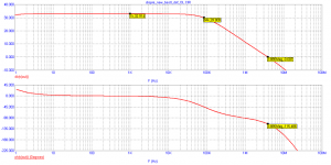

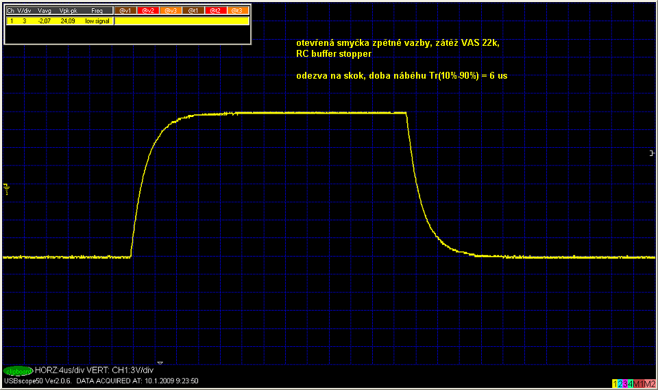

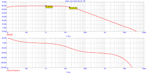

I know this, but simulated Aol curve, without VAS load, has F(-3dB) corner at 15kHz and at 350kHz when VAS is loaded by 22k. This is without rev. V3, and this is how it was simulated.
After V3, i.e. 68pF cap in buffer, simulated Aol (F-3dB) corner is at about 4kHz without VAS load and about 84kHz with VAS load.
OLG plot for VAS loaded by 22k, without rev. V3:
