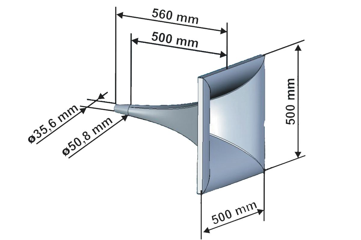

As previously suggested:
the Axi2050 + appropriate horn (the size of a K402) + one of Celestion's excellent 18" woofers in a big (front-loaded or br) cab would make a killer 2-way.
Another option would be a MEH, similar to Cask05's.

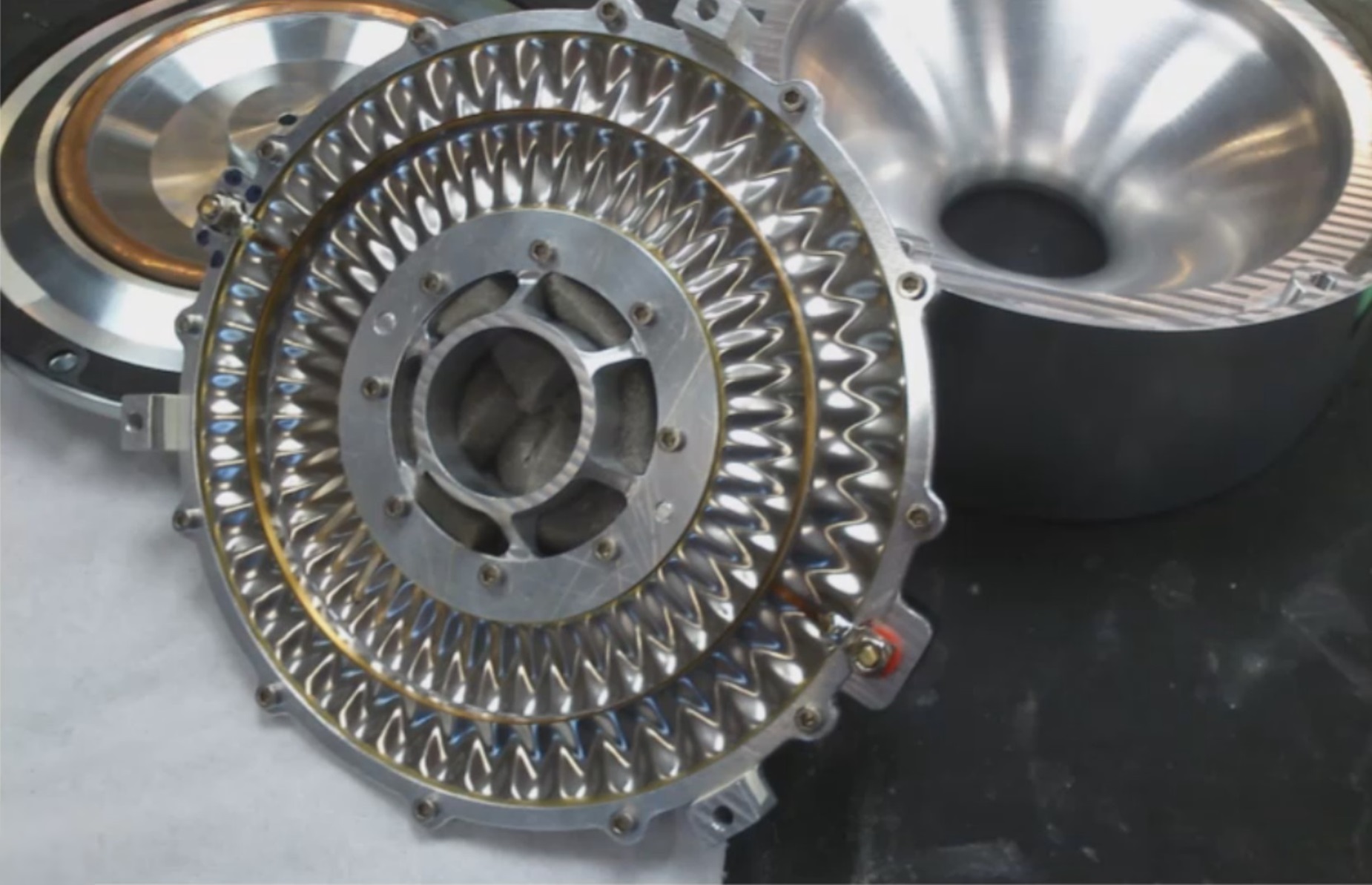

Moreover, the diaphragm of the Axi2050 is ultra thin. Combined with the phaseplug this leads to high efficiency, while reducing undesired interferences.
Compared to other wideband drivers the Celestion's design is very elegant.
There's only one moving part, but it's SOTA.
I think the Axi2050 constitutes real progress, it's the fruit of bright minds using advanced technology.
Celestion has spent over 15 years to develop proprietary software called Projector. It allows them to understand the activity of each little tweak in a model of a loudspeaker design.
Projector takes the principles of FEA – finite element analysis (a mathematical approach to solid mechanics) – and applies them to loudspeaker MANUFACTURE: mechanically, thermally, acoustically and electrically.

I don't think the features have a major impact on bandwith per se. It's the design of the diaphragm including the features that negate/overcome the issues commonly associated with large diaphragms.
This doesn't sound like anything extraordinary.
However, the solution Celestion's Lennon & McCartney have come up with, is beyond the Beatles.
Apparently, the science behind it has more in common with turbine technology than traditional loudspeaker design.
