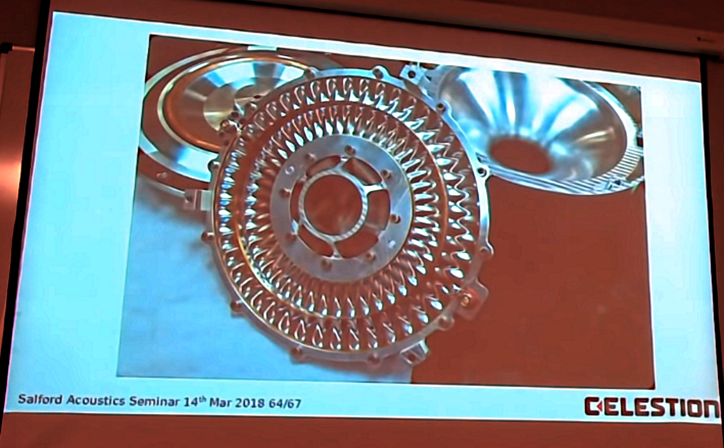

Axi2050 is big step forward and doesn't share much with other available drivers so it can hardly be compared to other drivers.
Lecture held by Jack Oclee-Brown explains it much better. I enjoyed watching it.
YouTube
Would recommend this video it's very interesting
From the video:
backside of the diaphram, the magnet system and outside wall of the phaseplug's outermost channel.

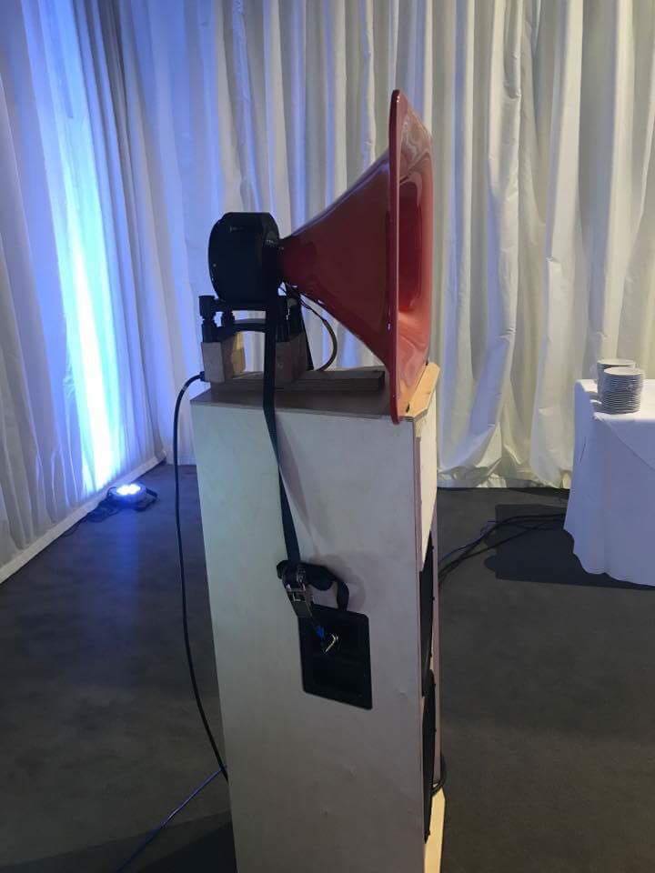

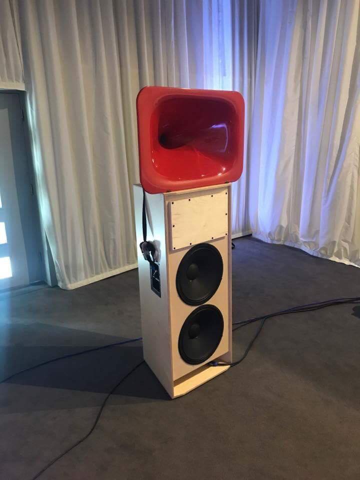

In this test set-up the Axi2050 + SEOS-30 cover 300-20.000Hz.
According to reports the combo did a decent job, but that's an understatement.
I am looking forward to the first Danley/PureGroove products with the Axi2050.

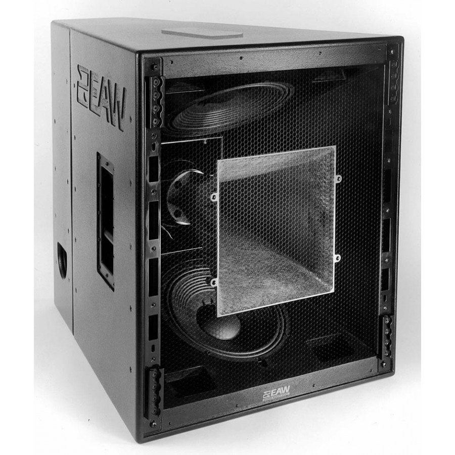

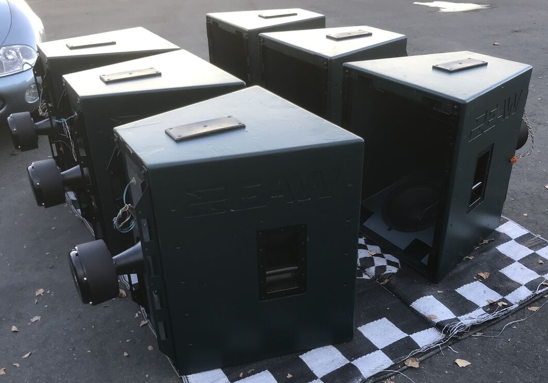

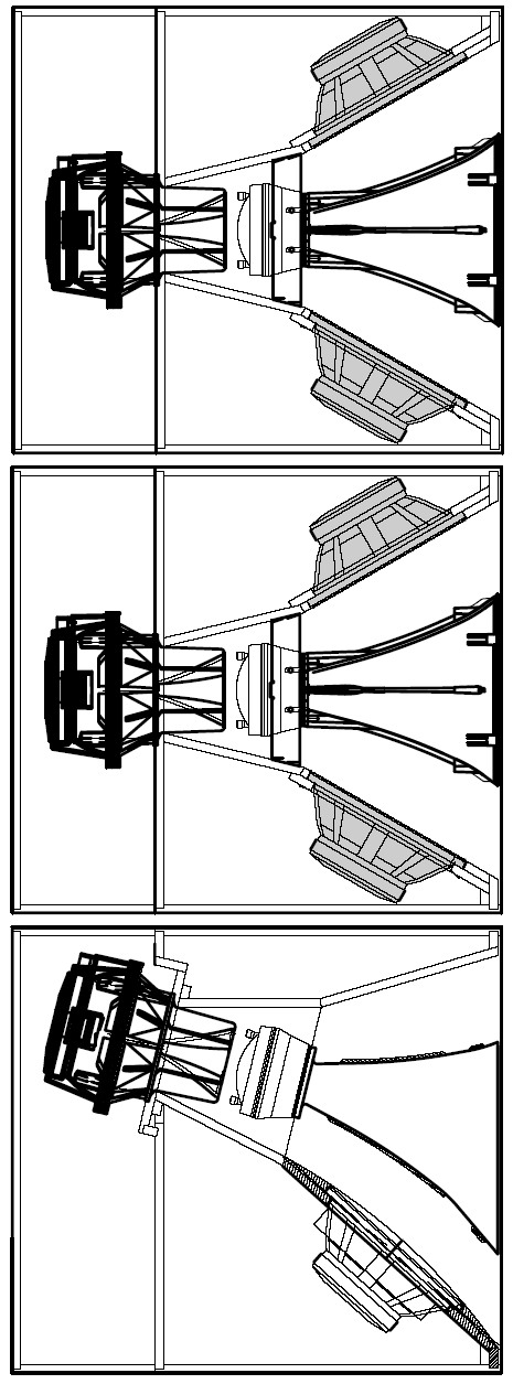

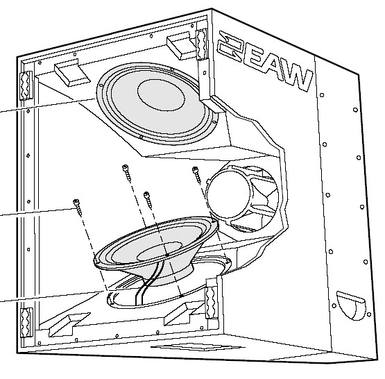

Have a look at these:

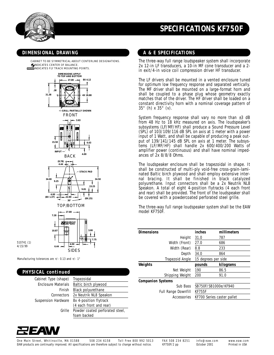

Parts I & II of the project (courtesy of Bernie Broderick):
Lots of good info! The low frequency performance is impressive..looks like it'll make smaller synergy horns obsolete by eliminating the need for close spacing at the throat.
I think 300hz is probably safe when combined with direct radiators but it might be wise to raise the crossover a bit if combined with a high power mid-bass horn section. They mention that the area is approximately the same as a 5.5" dome. It has 1mm of linear travel. It can only move so much air. For a very loud and clean horn-loaded point source PA system I would use it above 450hz.
