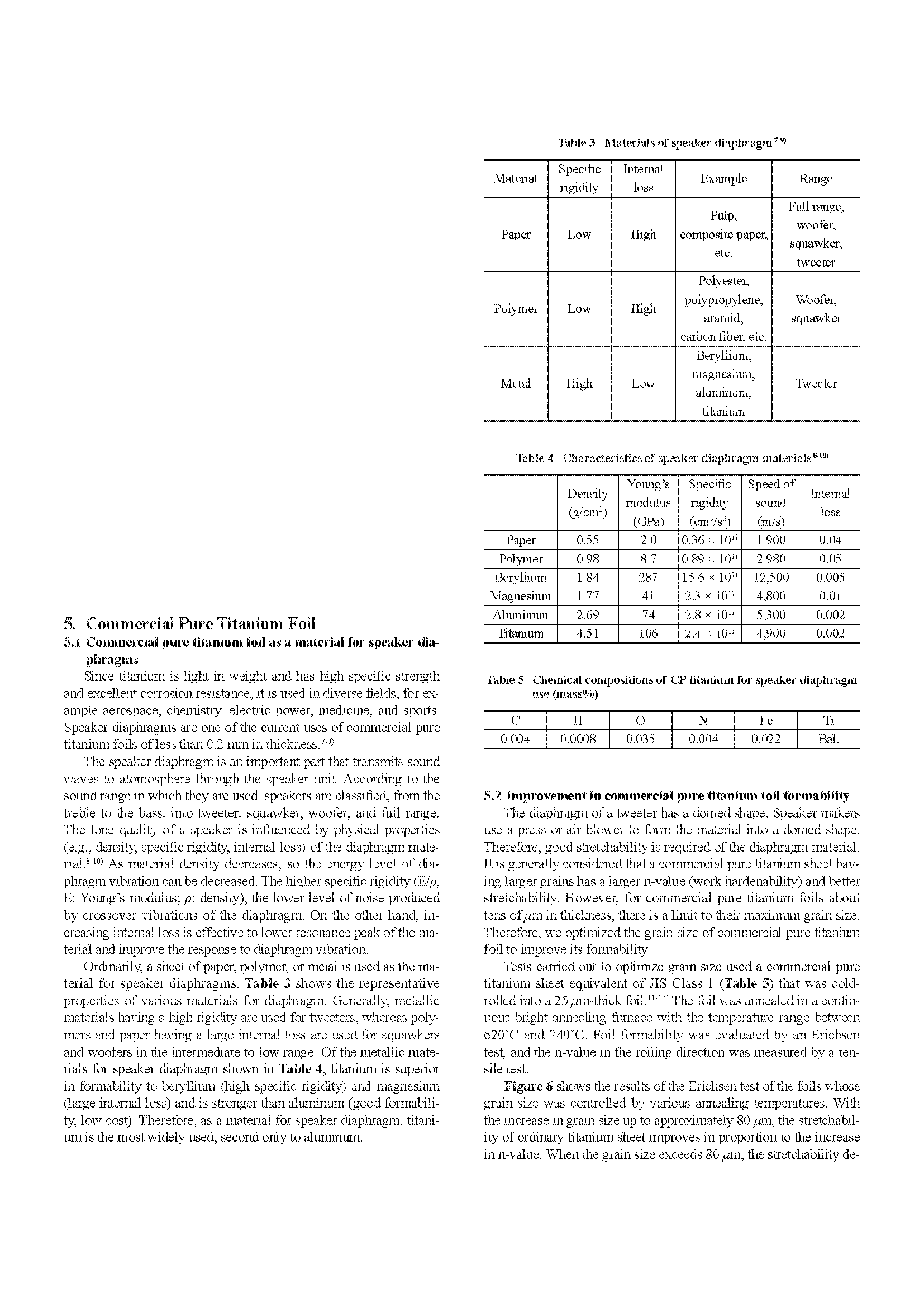

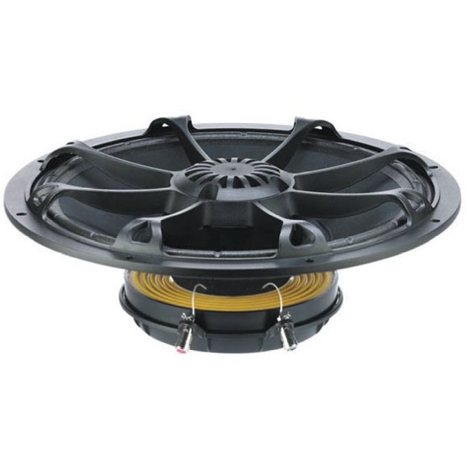

Is it an hydroformed diaphragm ?
It seems be extremely rigid and thin in order to offer some deformation, The structure may be affected by the metal fatigue ?
I think it's made using prevailing production techniques, hydroforming seems obvious. Nevertheless, it'll be difficult and expensive.
Titanium's strength-to-density ratio is unrivalled, this is probably the primary reason for using it.
I meant Titanium(alloy)'s tensile strength to density ratio, fatigue- and crack resistance, for the sake of completeness.
It should not be a pure titanium diaphragm, probably an alloy no ?

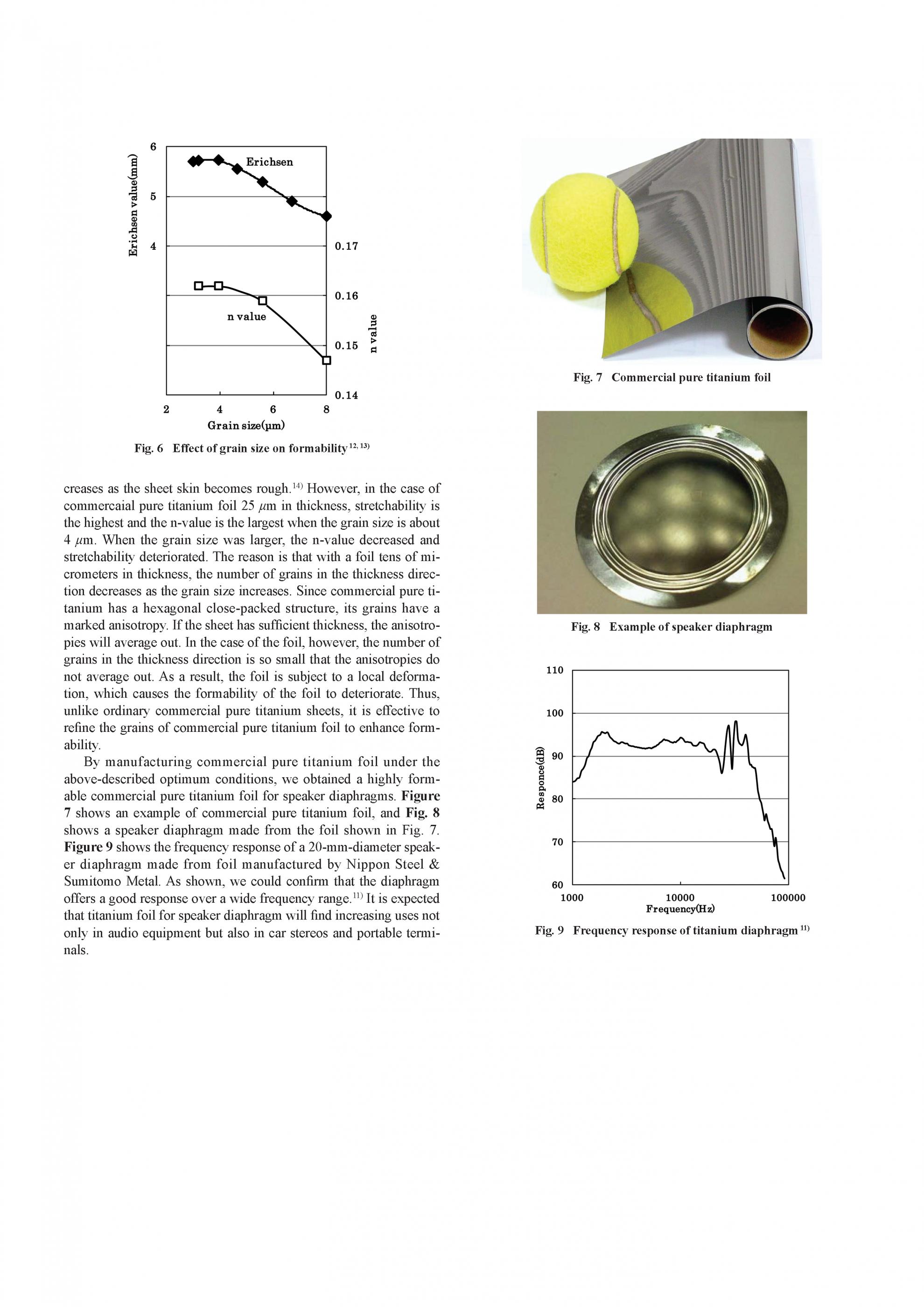

Here's some additional info.
The example presented in the documents seems to be a very specific Alpha Beta Alloy.
The base sheet for the Axi2050's diaphragm is probably even more specific.
If you do some research you'll find a large variety of foils are available.
The grain size and structure have a major impact on work hardenability (n-value) as well as stretchability.
These are related to thickness.
There are millions of possible alloy variants, the hardness can vary from 160HB to 20HRC and the elasticity modulus also varies from 300MPA to 900MPA, you should also add all forging techniques (a really vast subject) and at last add some layers of damping laquers (also a very vast subject).

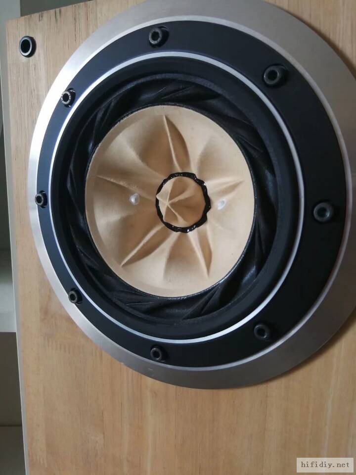

But, the vast majority of PA woofers have a simple paper cone

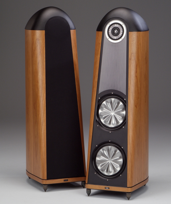

The axiperiodic pattern reminds me of the Thiel CS3.7, also the Fostex FE168EZ.

... the elasticity modulus also varies from 300MPA to 900MPA...
This is seriously incorrect, maybe it's a bad translation?
Best wishes
David
Best wishes
David
You are right, it is hard for me to speak in English about what i've learn in French, this is the elasicity limit.
The first early contact with the metal (young years)... at first i was trying to scratch the surface to see if it is hard (hardness parameter) then try to bend it to see if it is possible to deform it (elasticity parameter).
A good way to start to understand the basic mechanical properties (and their measurements) of the metal IMHO.
