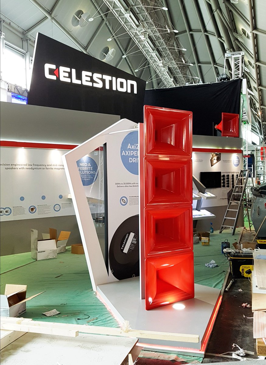

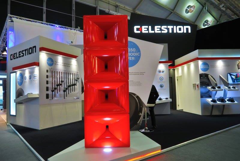

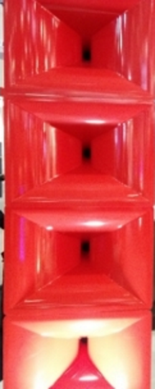

Apparently, the Red Horn shown earlier in this thread is a custom design, perhaps with input from Bjørn Kolbrek.

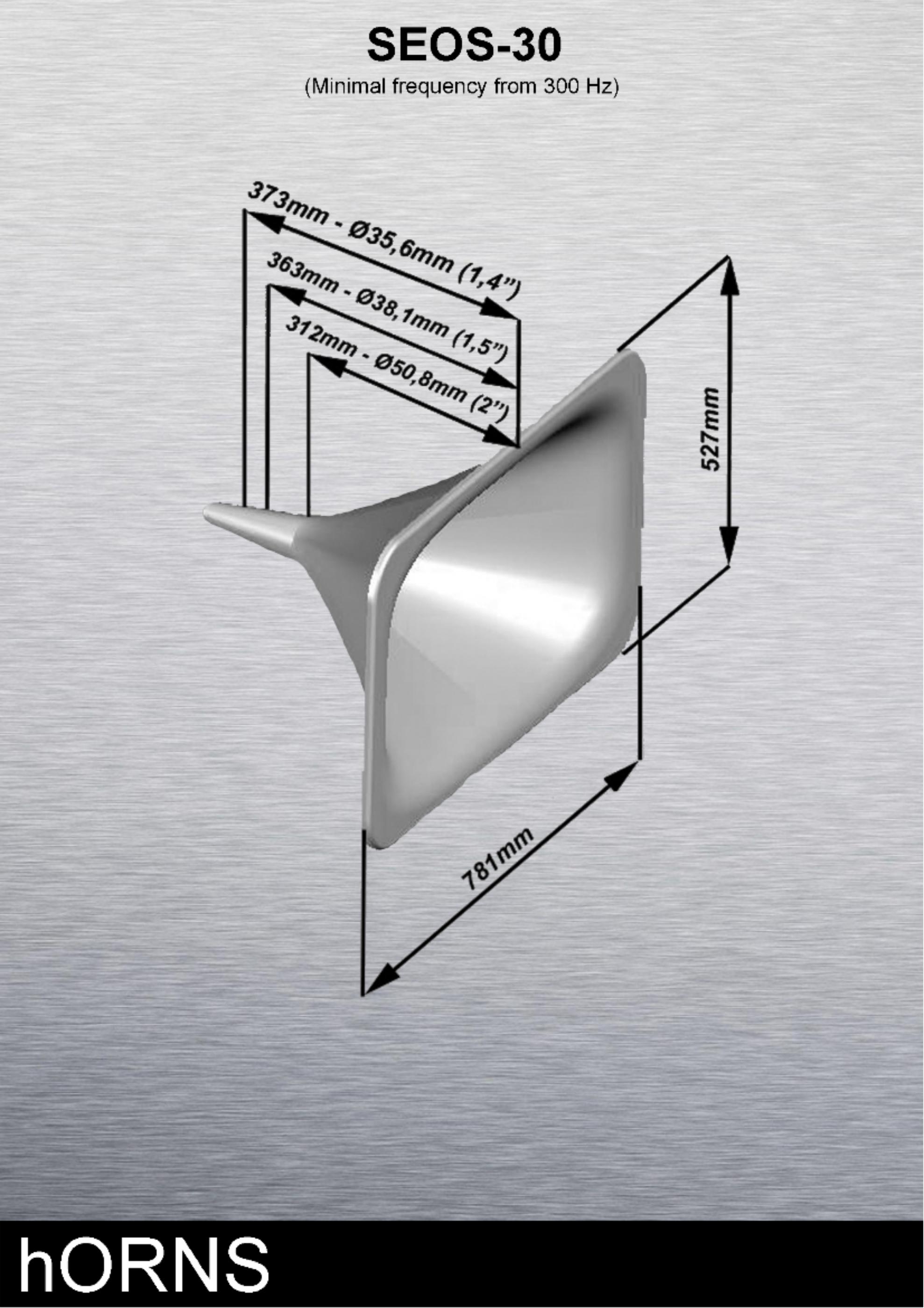

The Red Horns have been exhibited with the Axi2050 (instead of the SEOS) and were supposed to be used for the NAMM as well.
These are made by an UK manufacturer of bespoke Glass Fibre Reinforced Plastics (GRP) products.
...and with vertical to horizontal transition/slot.

I don't think the red horns are similar to Manta Ray horns, if that's what you suggested, silversprout.

The transition is very sharp and the first section looks really narrow, i'm perhaps wrong but i still vote for a mantaray profile.

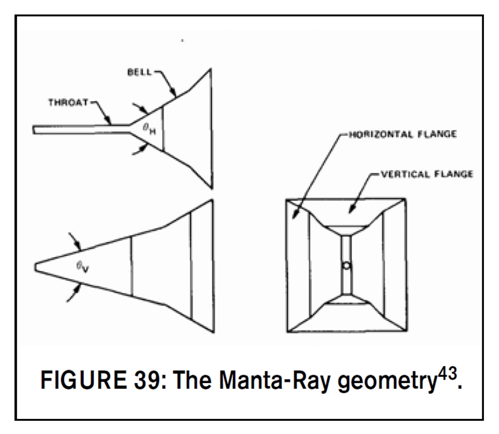

If you consider every horn with a vertical slot a Mantaray horn, I would agree. However, that would be an oversimplification. Moreover, a CAD drawing of the exterior can be misleading. Judging from the images, the actual horns are clearly different in my opinion.
Mantaray Horns
The Mantaray is a Constant Directivity (CD) design horn that keeps the dispersion angle constant for all frequencies, and reduces the beaming inherent in many loudspeakers. It was designed by Clifford A. Henrickson and Mark S. Ureda of Altec Lansing using the principles first established by Don Keele of Electro-Voice (later JBL).
The Mantaray separates desired vertical coverage patterns from horizontal, making it possible to design horns for a variety of coverage patterns. The Mantaray shape starts with a vertically oriented, narrow and sharp-edged JBL-style diffraction horn leading into a conical waveguide (earliest designs) or a square or rectangular horn with four planar sides. For midrange beaming control, the outer mouth was expanded further with a short, flared flange in the Keele style, or with added planar sides of a greater flare angle. Low frequency efficiency was not as pronounced as the constant directivity design. Unlike previous designs, the apparent apex, the focal point of pattern dispersion, was not the same for every frequency, making for an ellipsoidal wavefront rather than spherical. Because of this, the Mantaray could only be arrayed satisfactorily in one plane. Its abrupt breaks in flare rate caused diffraction, reflection and distortion components.
Most popular Constant Directivity horns suffer from non-spherical wavefronts, limitations in arrayability, distortion at high sound pressure levels as well as reflections and distortions related to the transition from diffraction slot to secondary horn. They tend toward a narrowing of dispersion pattern at the higher frequencies whose wavelengths approach the width of the throat or the width of the diffraction slot.
Not very compelling, I would say.
If you look towards the throat, the slot in the red horns appears to be a little wider and the edges seem smoother.
I think the description below (by Bjørn Kolbrek) is more appropriate.

The smooth, rounded edges at the end of the slot are clearly visible in the bottom horn.

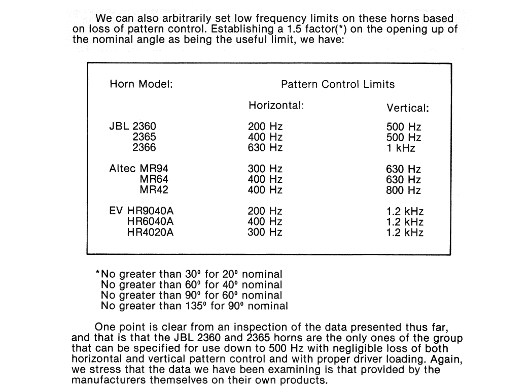

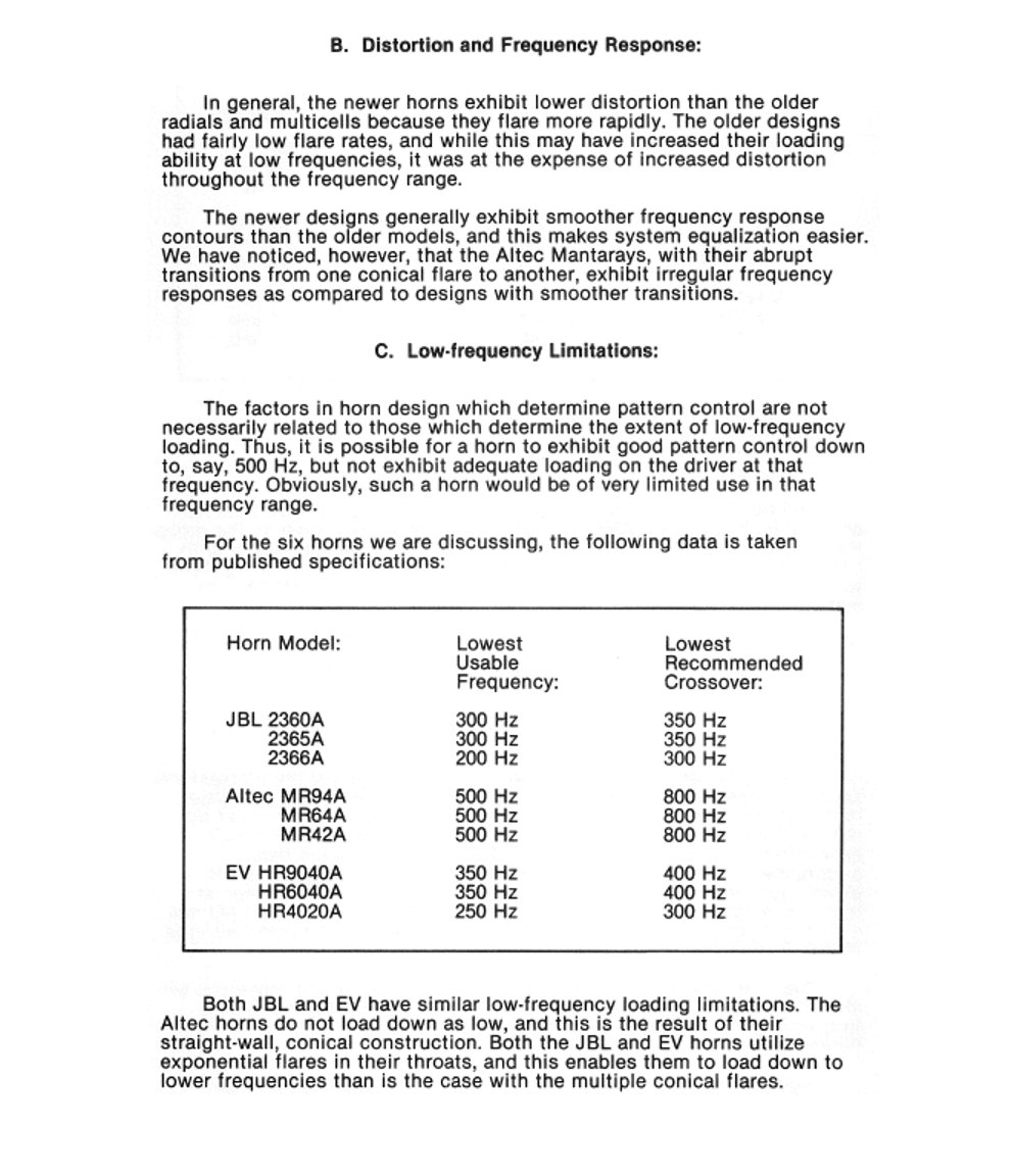

I will be curious to know the lowest recommended loading frequency of that CD red horn.
Considering the Red Horn's length (depth), the mouth circumference, as well as the parameters of the previously used SEOS-30, I would guesstimate the Red Horn loads the driver from 300-350Hz.

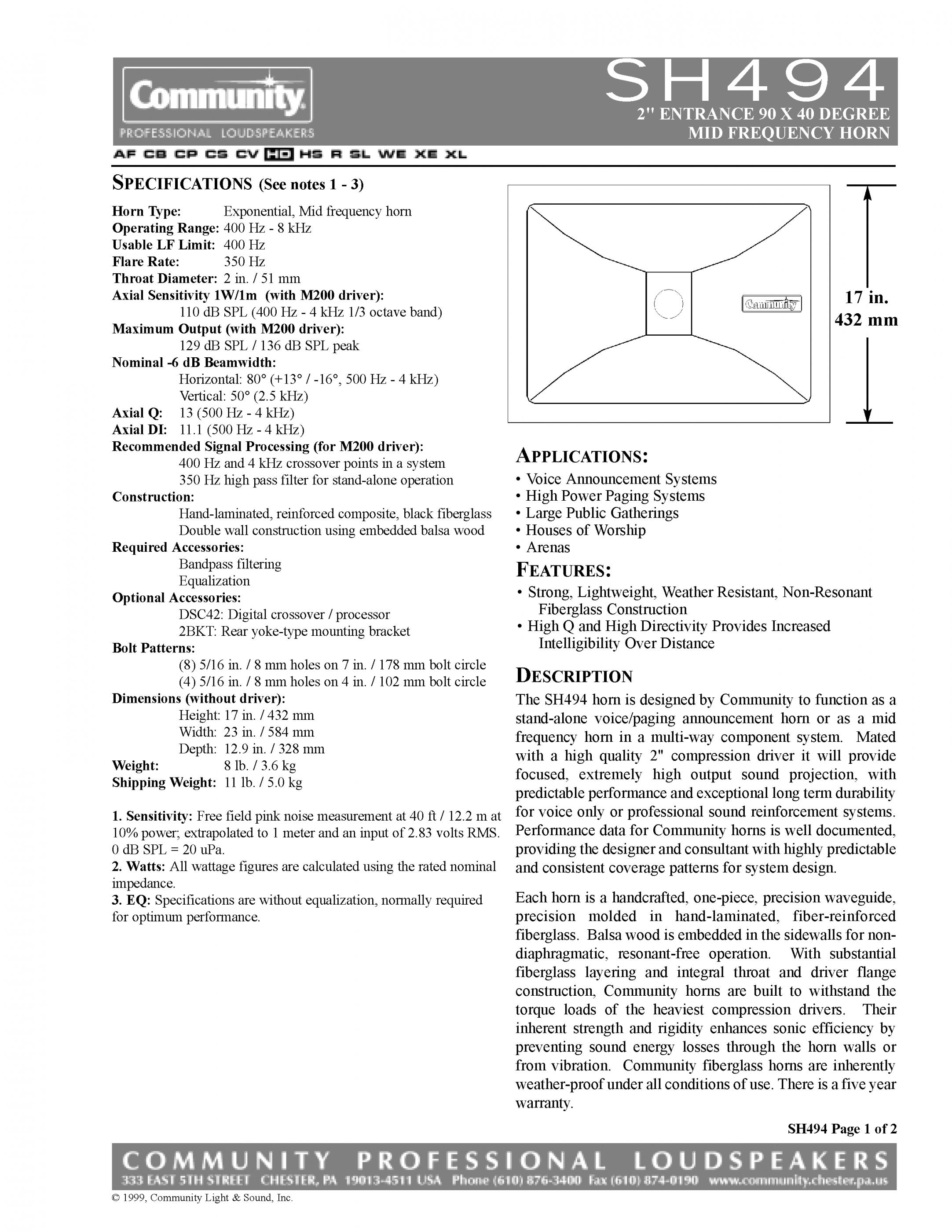

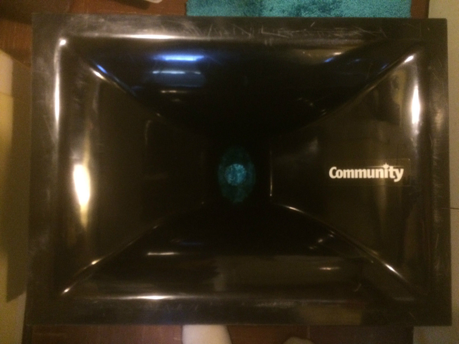

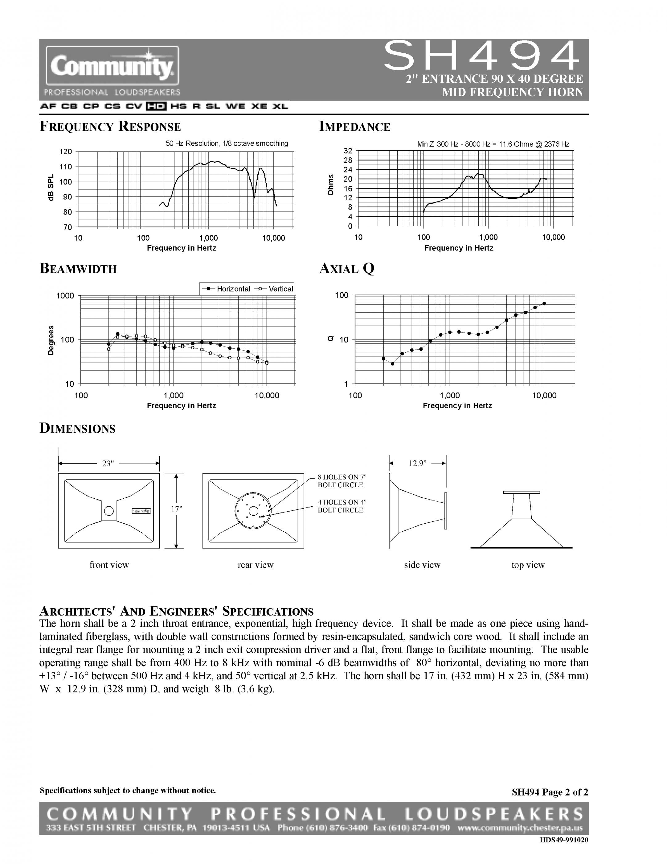

As mentioned before, I think the Red Horns are more similar to Community's SH-494 than to most widely known medium/large format horns.
It's no coincidence the SH-494 is a hidden gem among BMS coaxial users.
The SH-494 is described as an exponential horn (narrowing pattern) though and looks to have issues > 4 kHz in the data sheet. Midrange only?

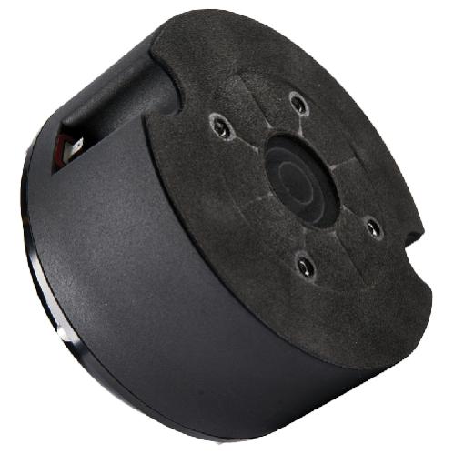

The axi2050 is still listed as OEM only so may as well not exist though. My interest has declined somewhat due to this. Also getting a pair of auto tech SEOS-30 was ~600euro making the whole project a bit expensive.

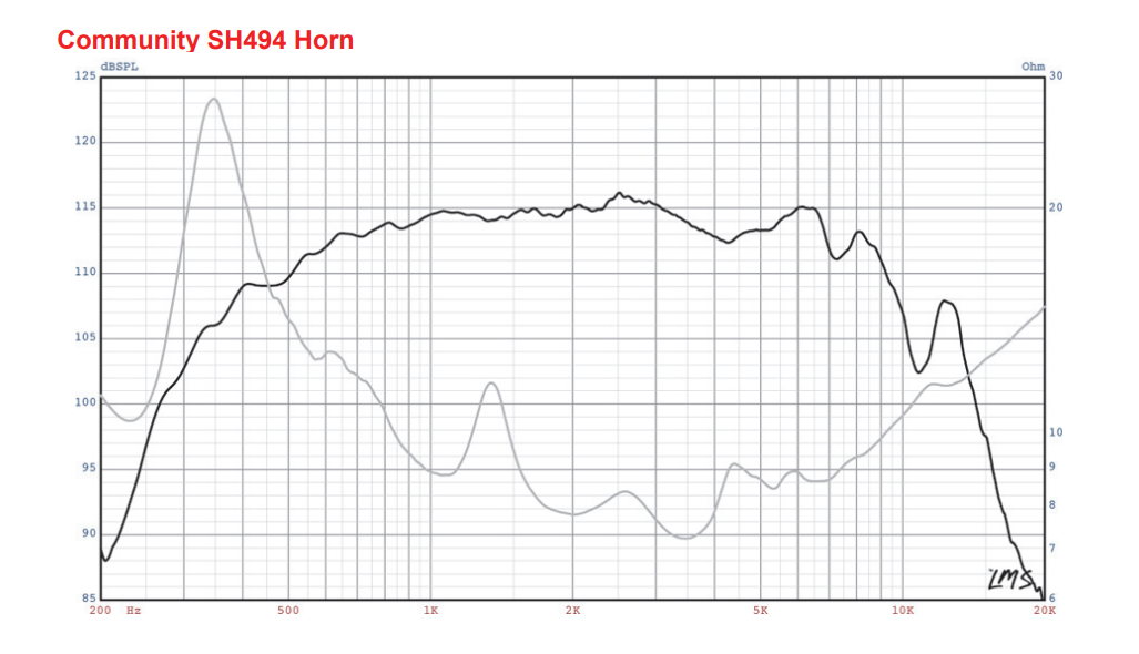

Measurement data were obtained with the Community M200 Midrange driver, which drops like a rock past 4kHz.
Optimum crossover frequencies according to the M200 datasheet are 500Hz / 4kHz.
It's a highly regarded driver nonetheless.
Attached the response of an Eminence PSD3006 with the same horn. This is a mediocre driver though.
I took the SH-494 as an example of a different kind of diffraction horn.

A (thin) mesh grille is visible on the published images of the driver. This is a necessity in some PA environments to prevent debris from penetrating the driver's inards.

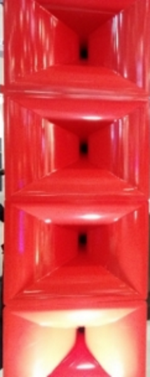

No details of the Red Horn have been published yet, so we can only speculate about the performance of the Axi2050 with the horn.
