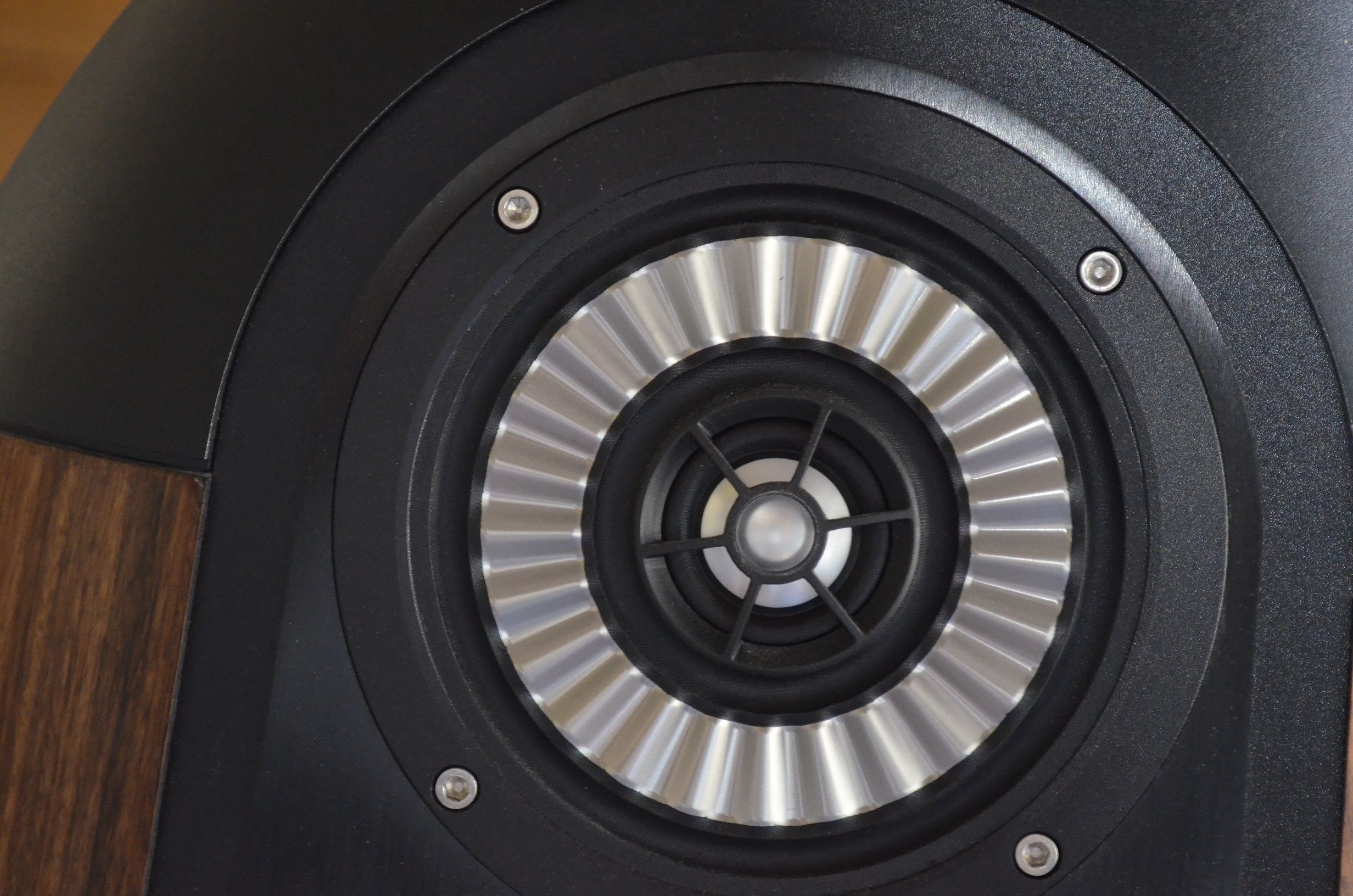

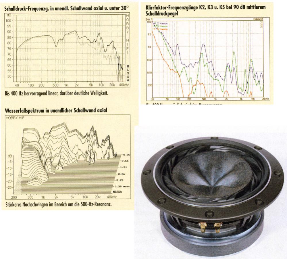

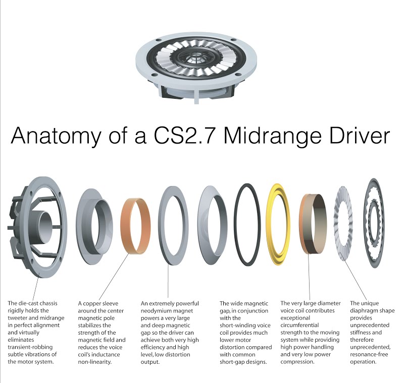

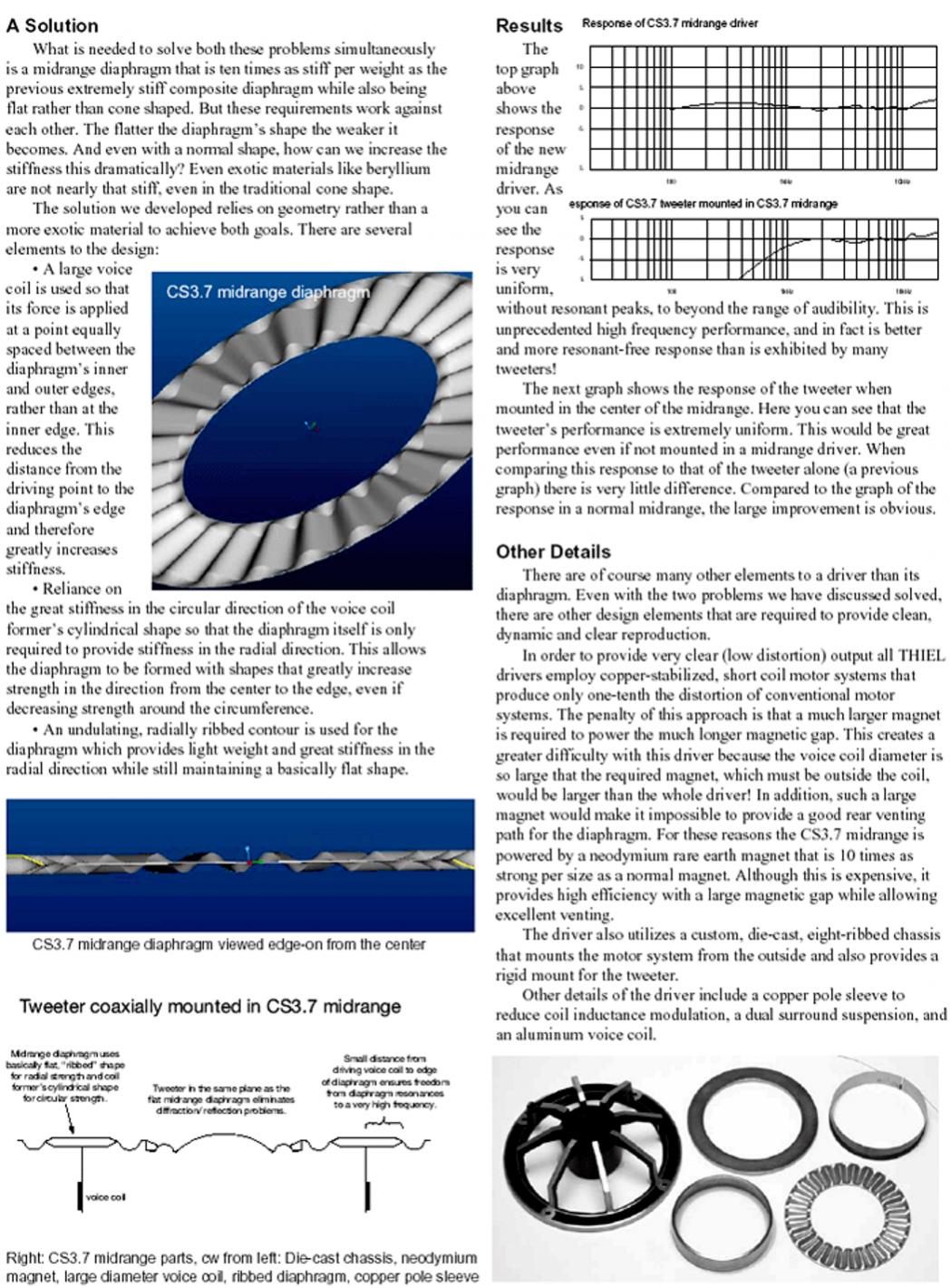

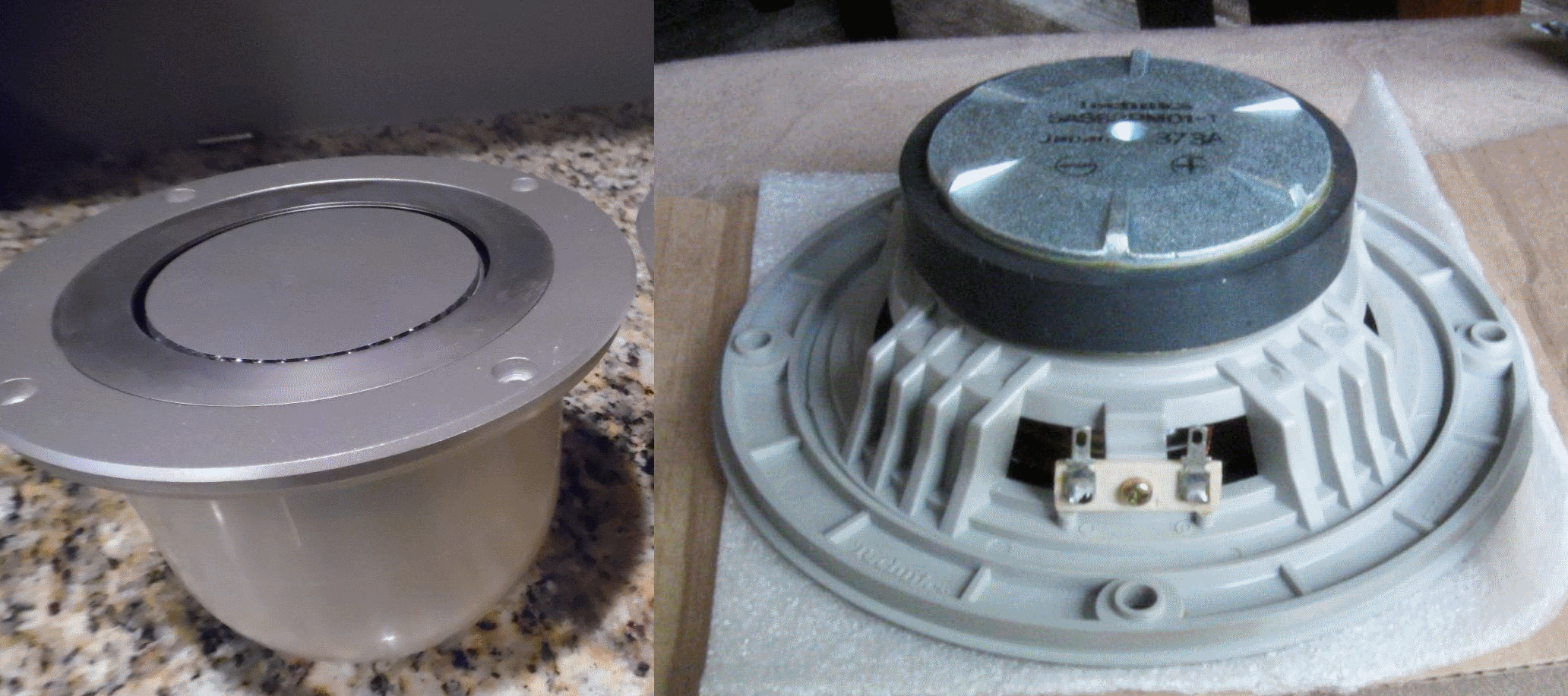

There are some similarities between the Axidriver2050's diaphragm and those from the Thiel and Fostex drivers.
The Thiel Coaxial Coincident Driver 4.5" midrange driver is not a cone. Its an aluminum diaphragm that resembles a flattened, corrugated doughnut. The tweeter nests into the center, where the dustcap would go in a conventional design. The "corrugations" are radial lobular indentations in the aluminum.
It's a very thin diaphragm that operates pistonically—very close to ideally according to Thiel.
The woofer is another essentially flat driver with radially mounted strengthening lobes. Like the midrange driver, it also employs Thiel's long-gap, short-coil drive system, which keeps the coil within a uniform magnetic field throughout its entire range.

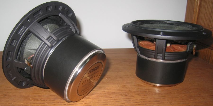

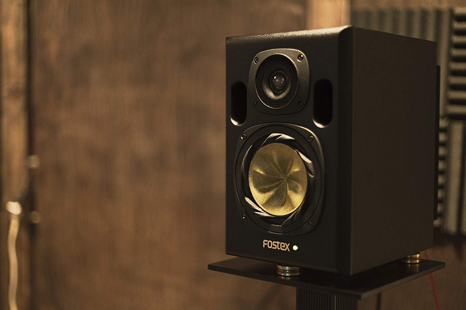

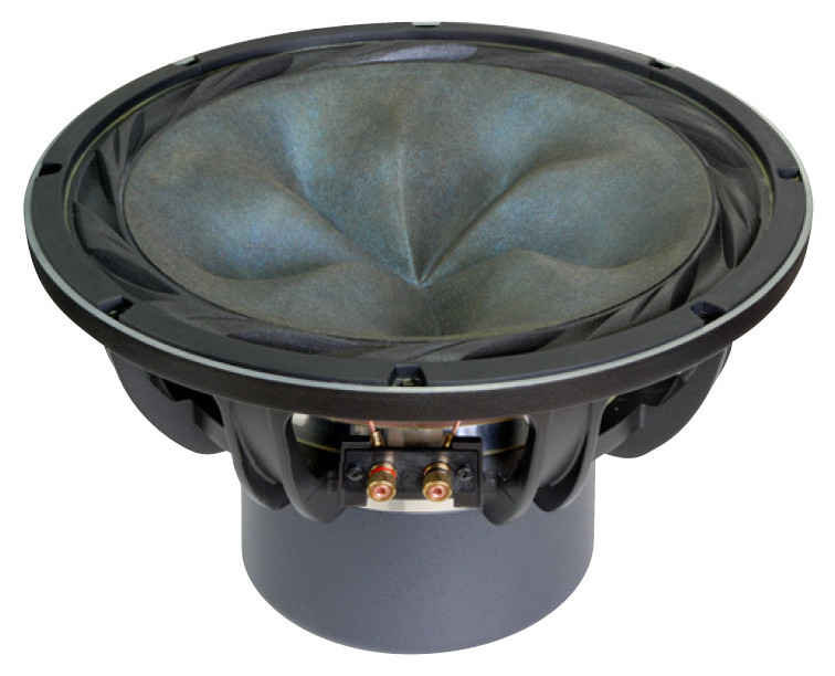

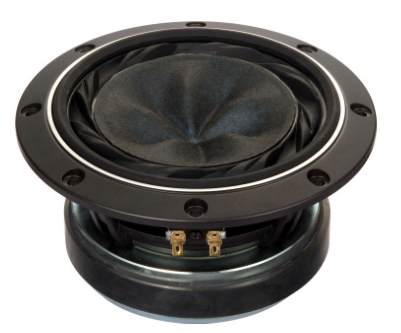

For the Fostex a hi-rigid and reduced inherent resonance HR diaphragm is employed by using a "radial papermaking technique"
and whizzy hybrid materials (whatever that means).
Obviously the claim is reduced distortion. Even the spider is "radialized" (image no. 5).

I don't know what that cone in Fostex serves for, but it measures quite dreadfully.

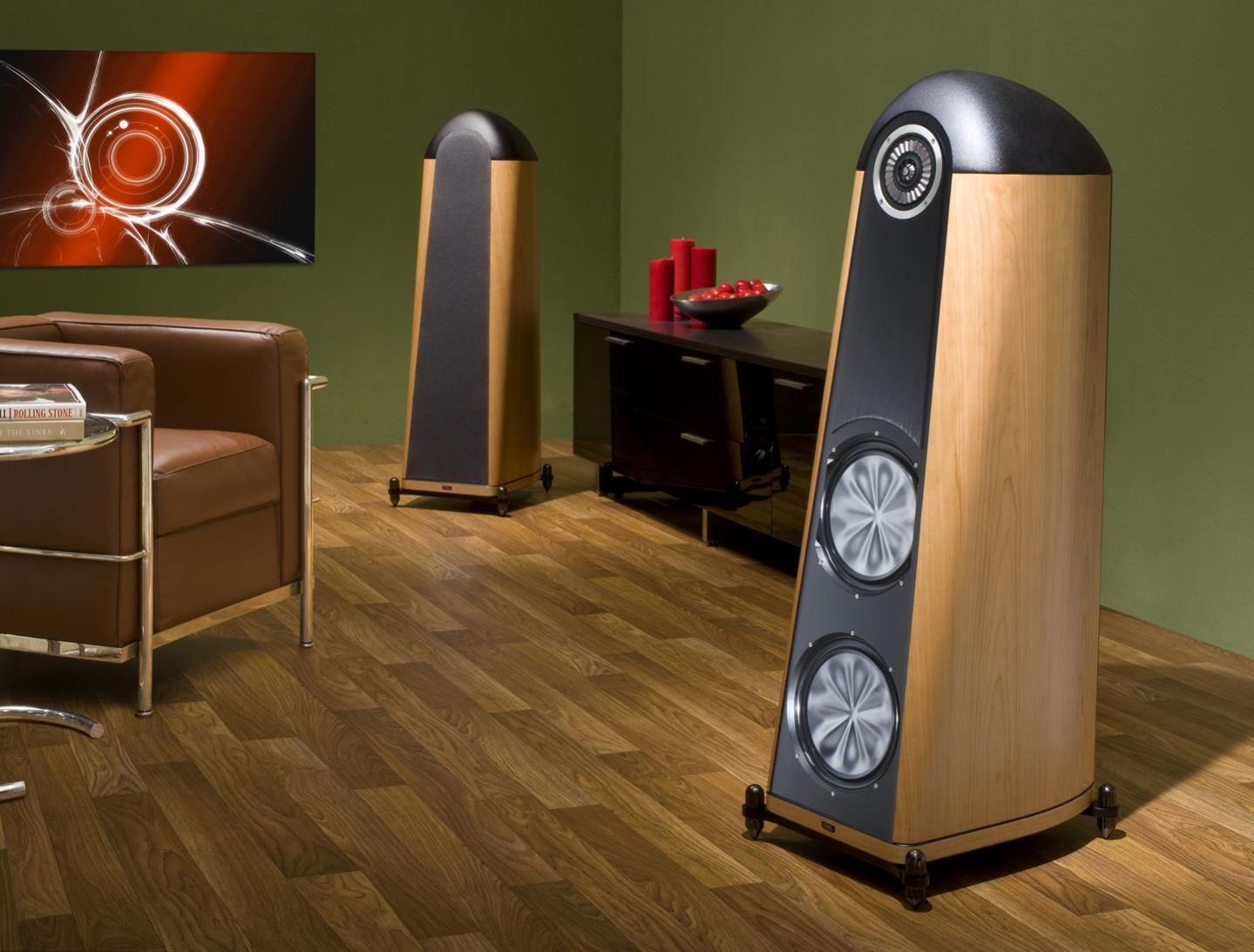

The Thiel, at least as implemented by them, is also very fatiguing sounding. That doesn’t necessarily mean anything about the midrange, except that it’s a horrid tweeter baffle/waveguide.
I once heard these on exorbitantly priced electronics. Although the combination did many things right I also had the impression that I probably wouldn't like to listen to them for long.

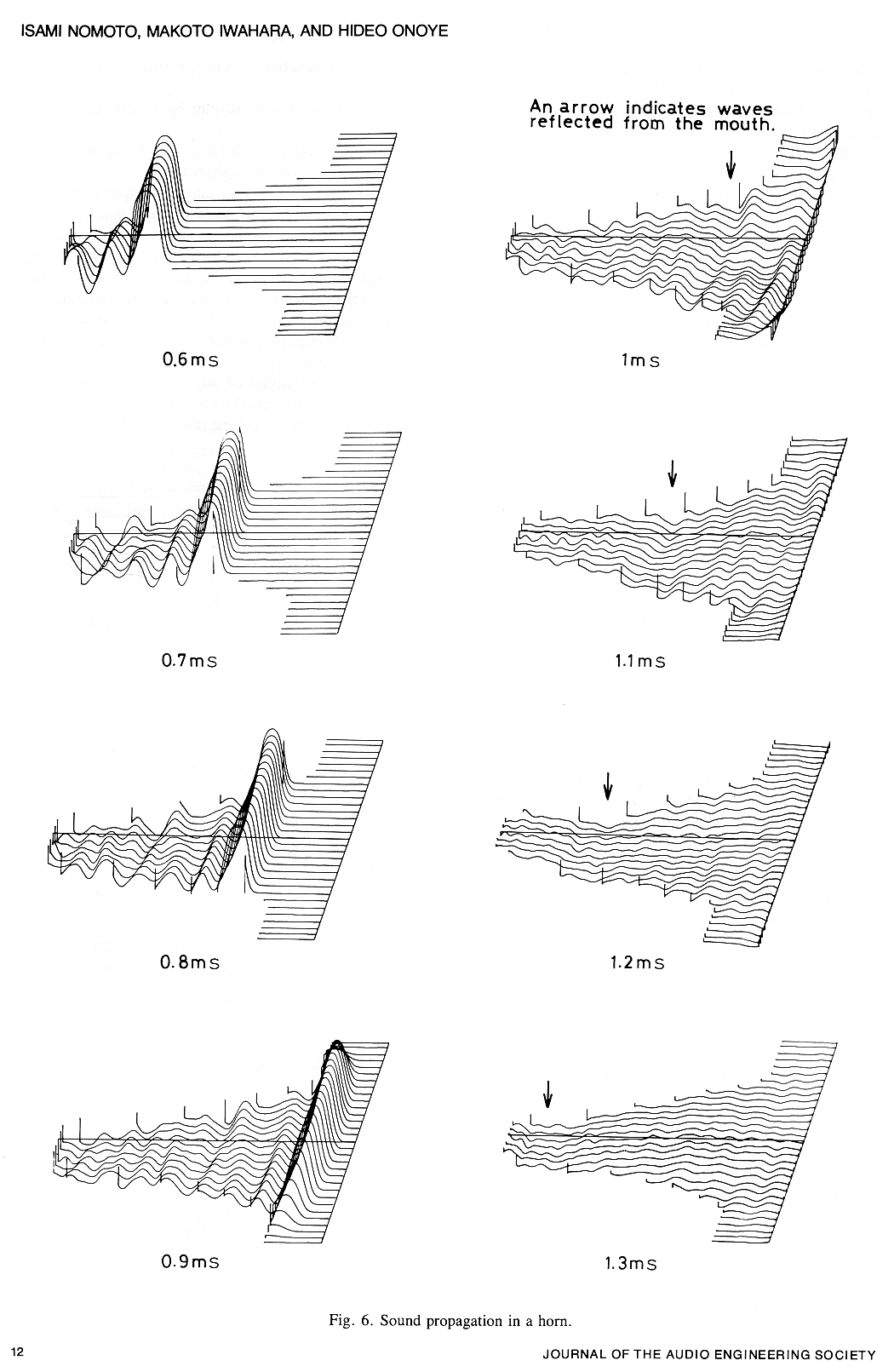

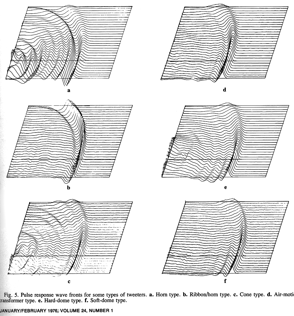

Celestion made pioneering use of Laser Doppler Interferometry to analyse diaphragm behaviour in the 1980's.
Once again, in the seventies the Japanese lead the way in analysing diaphragm behaviour and experimenting with diaphragm materials.
One of the most remarkable research projects was published by ISAMI NOMOTO, MAKOTO IWAHARA, AND HIDEO ONOYE from Victor Company of Japan, Ltd., Tokyo in 1975.
"For a shaped pulse excitation, responses at 3000 points in a plane through the major axis of a loudspeaker are measured and stored. The data are then processed and converted to visual. representations at 10-µs intervals. The resulting display is photographed sequentially for observation of wave-front motion away from the loudspeaker."
In other words, these guys made wave fronts visible!

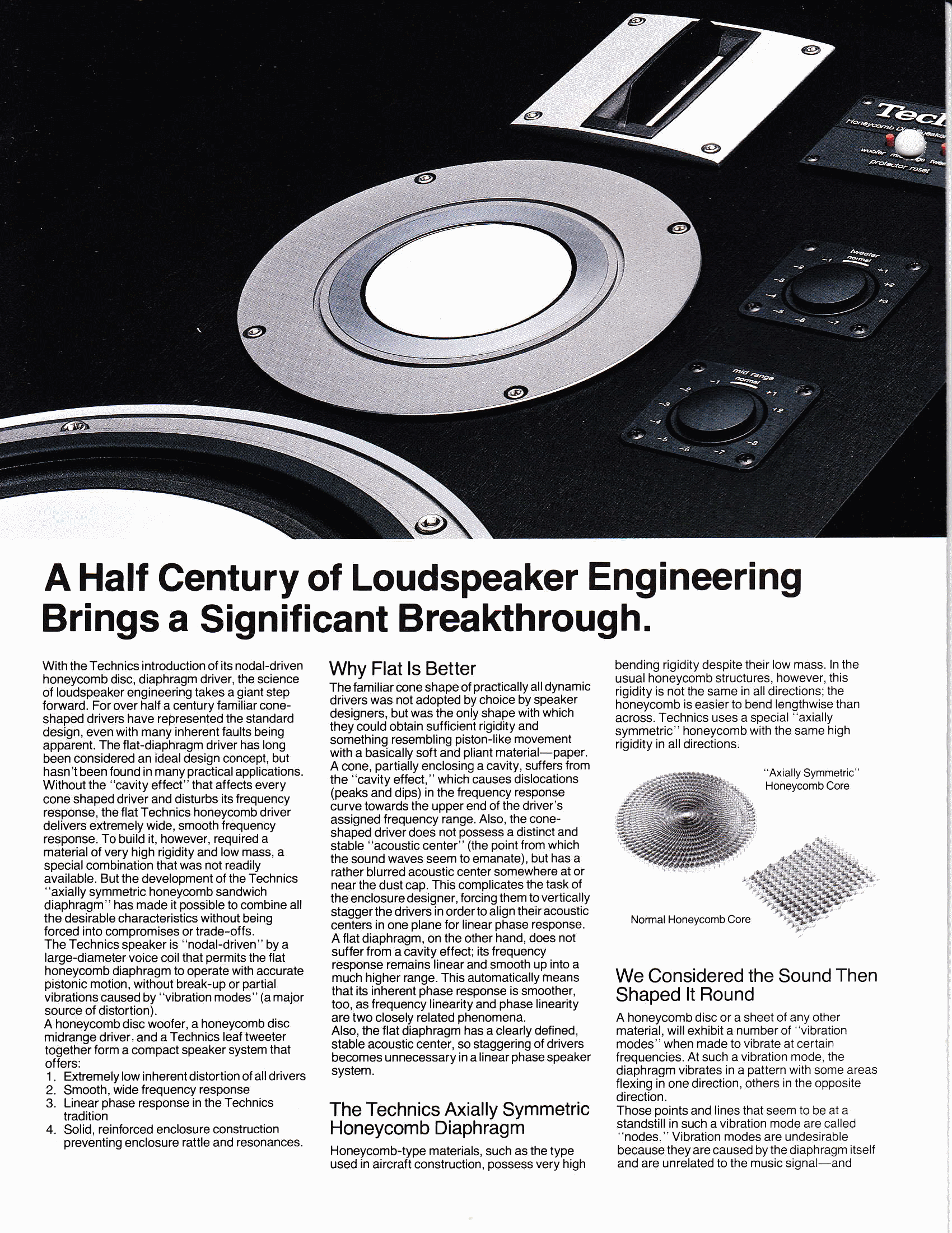

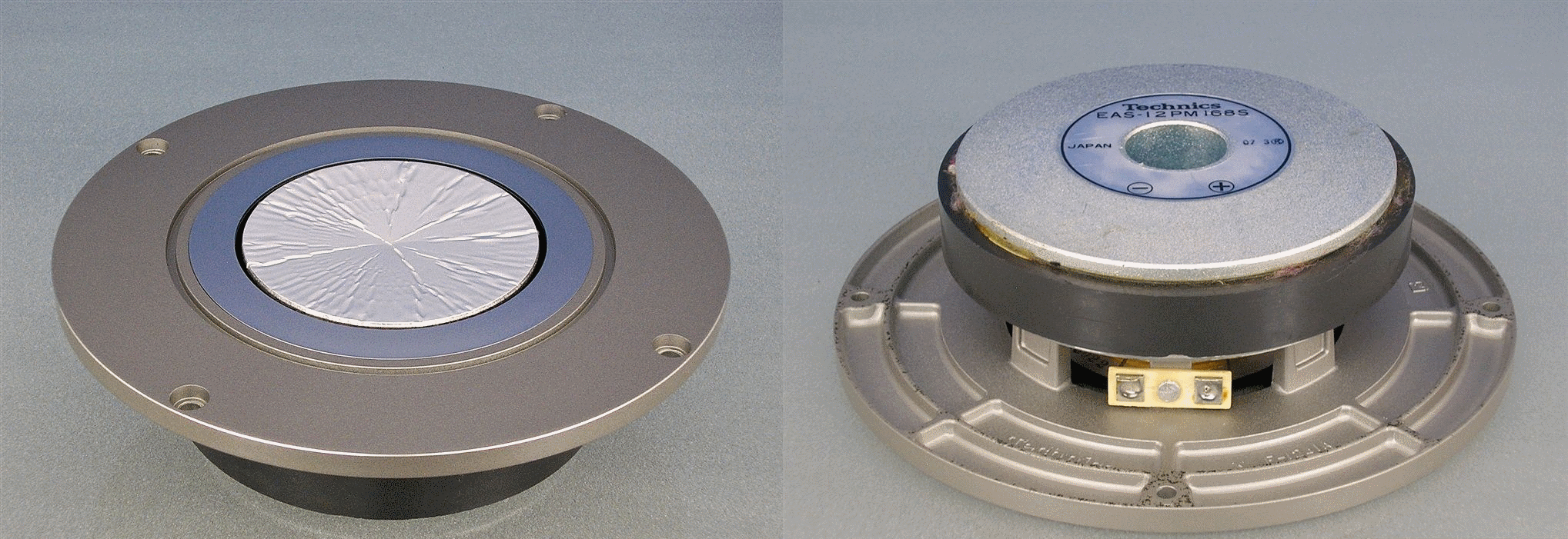

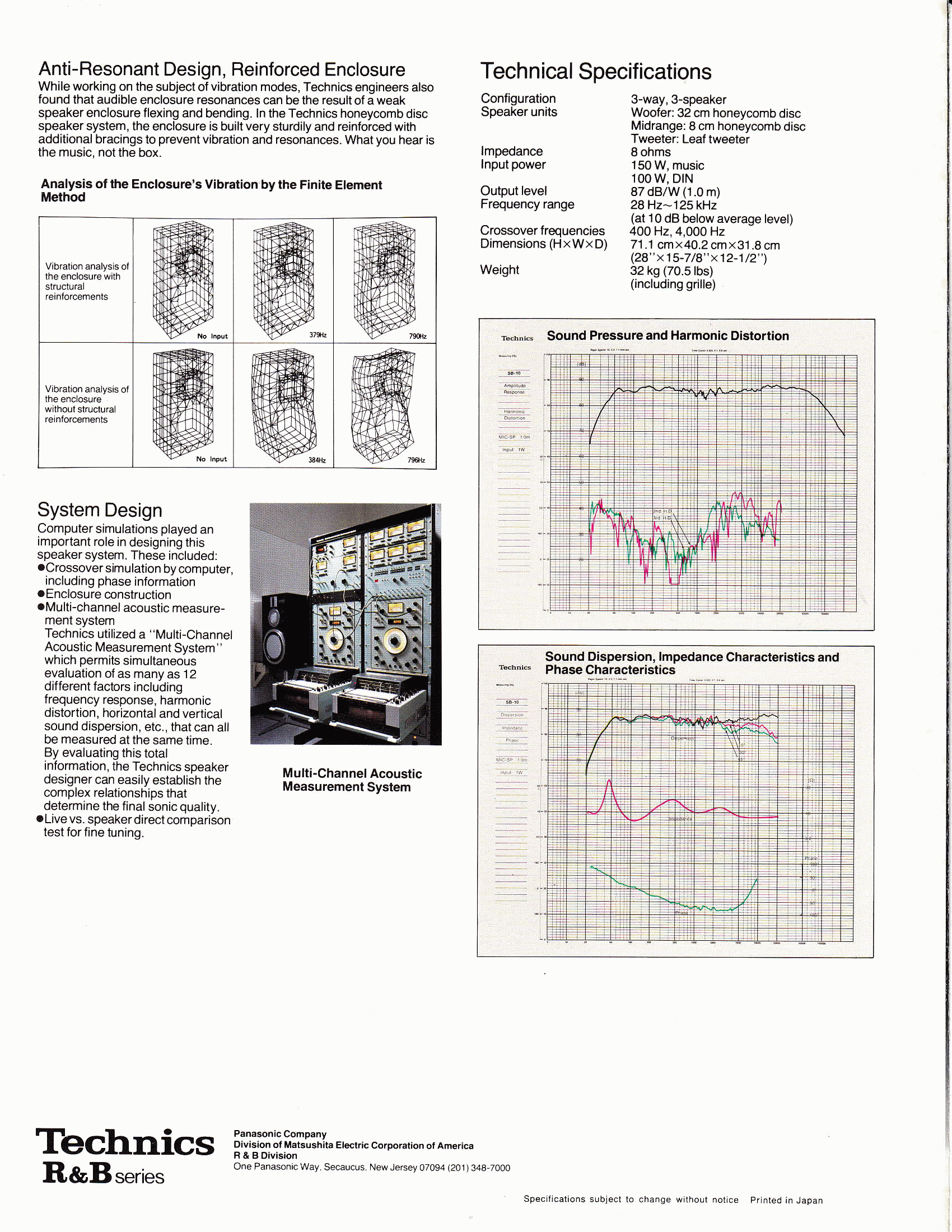

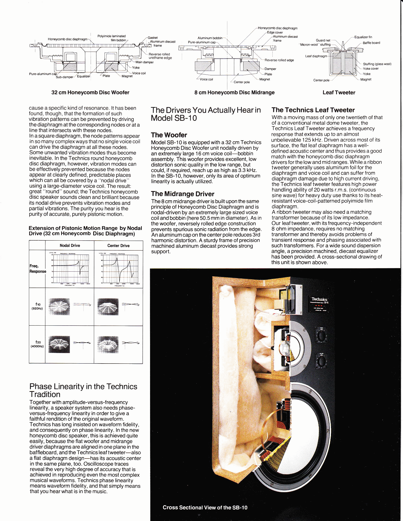

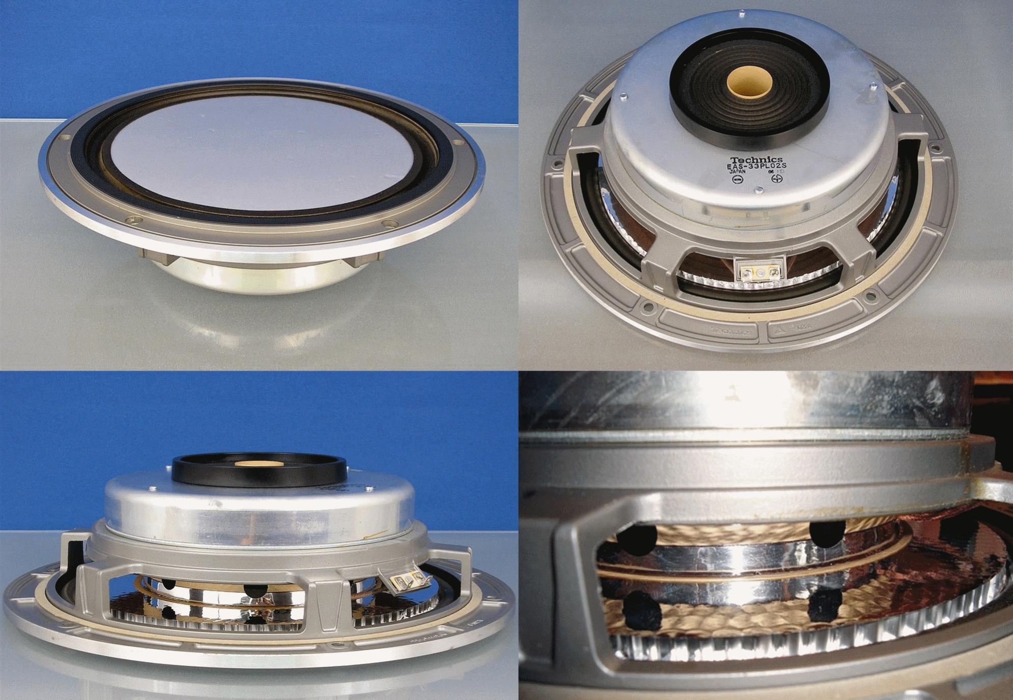

The Axi2050's diaphragm is basically flat, but deviates from existing designs in some respects.
One is the location and size of the voicecoil, another is the shape of the features.

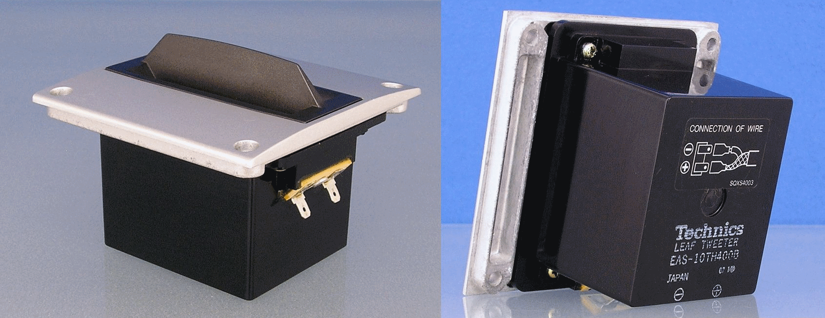

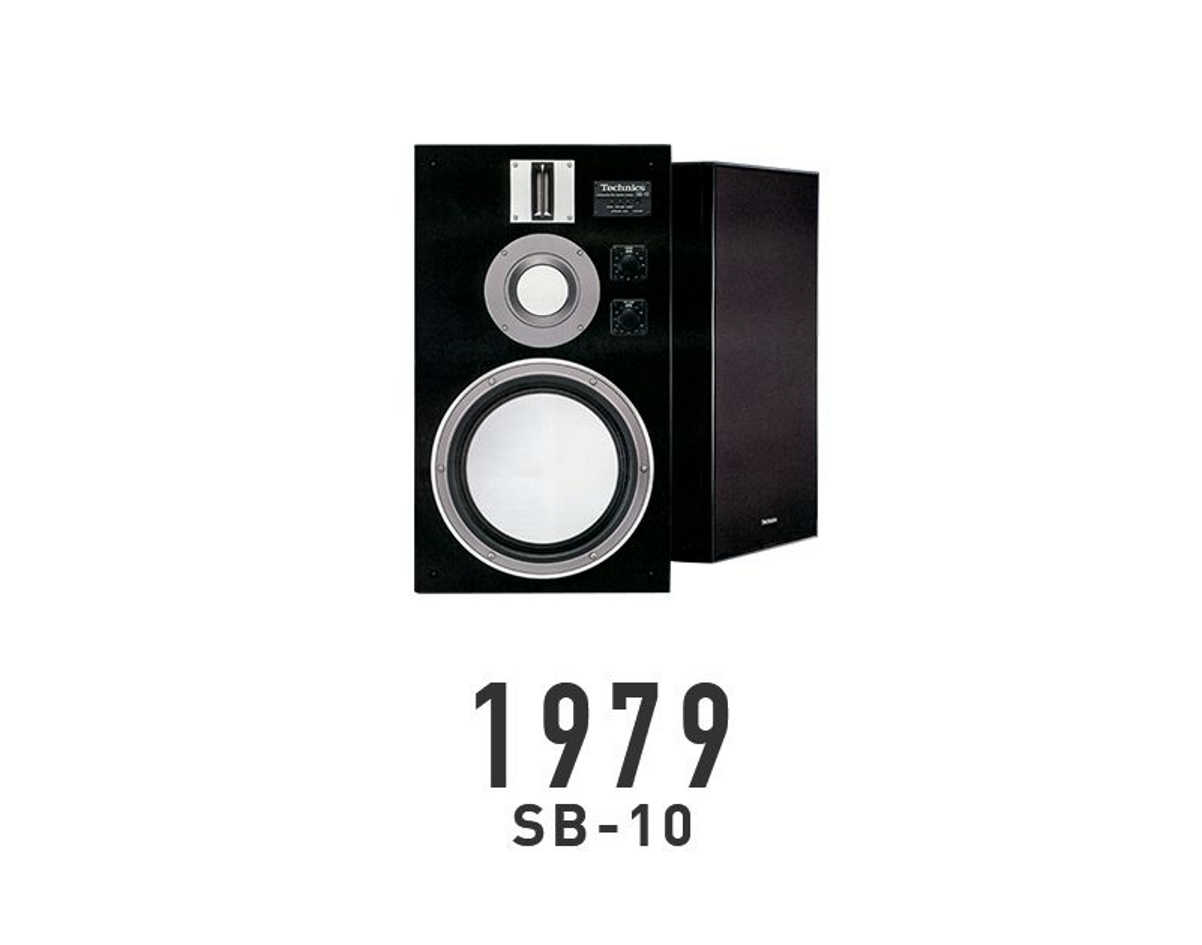

Thiel might have taken a pretty good look at the flat diaphragms developed by the Japanese in the late 1970's and early 1980's. Besides Sony, Technics has put a lot of R&D effort into flat diaphragms.
In 2015 they revived this technology with the launch of Technics SB-10 and SB-R1.
The diaphragms are based on those developed for the SB series from the 70's and 80's.
These vintage Technics speakers were never very popular outside of Asia, but highly regarded by many today.

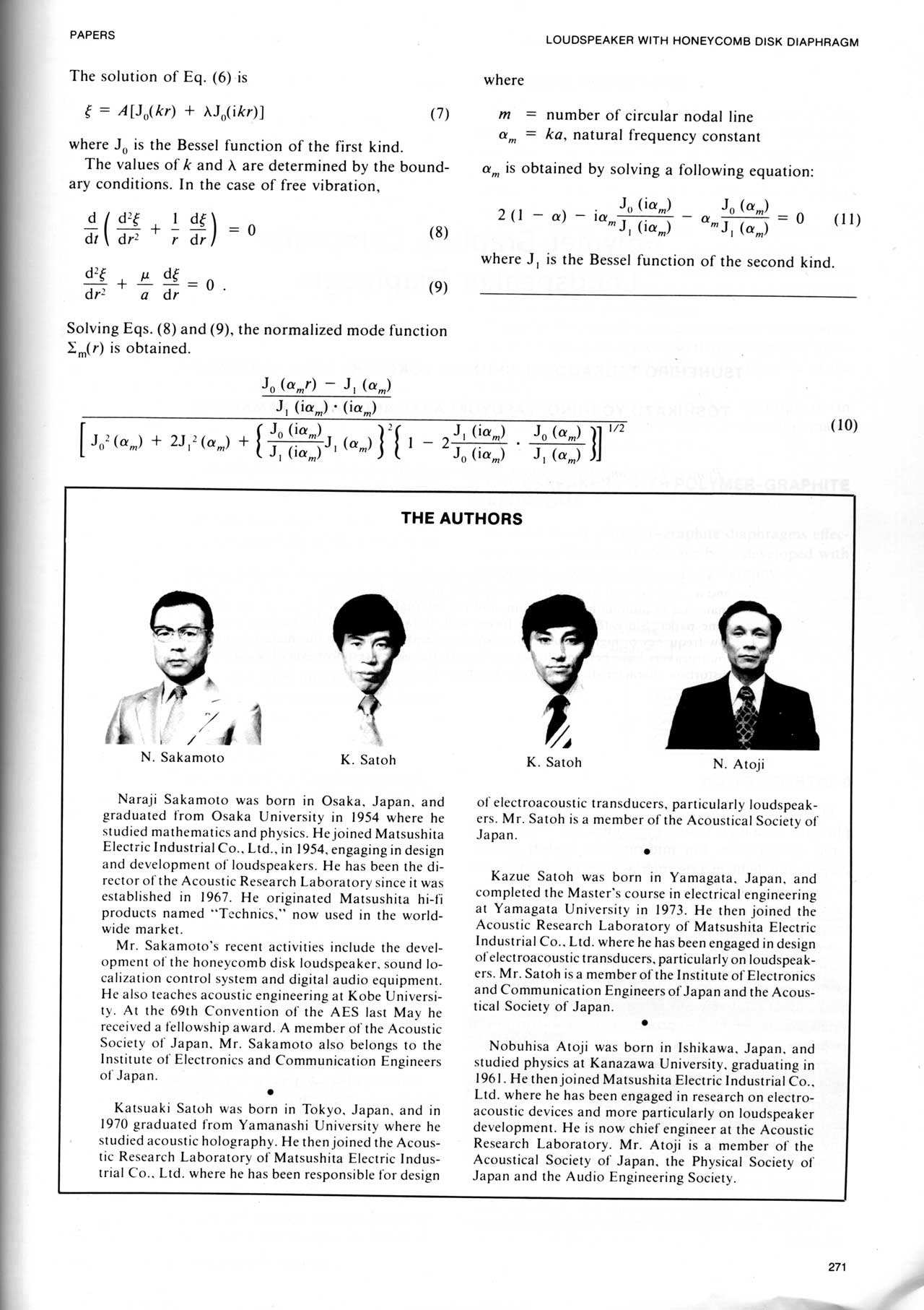

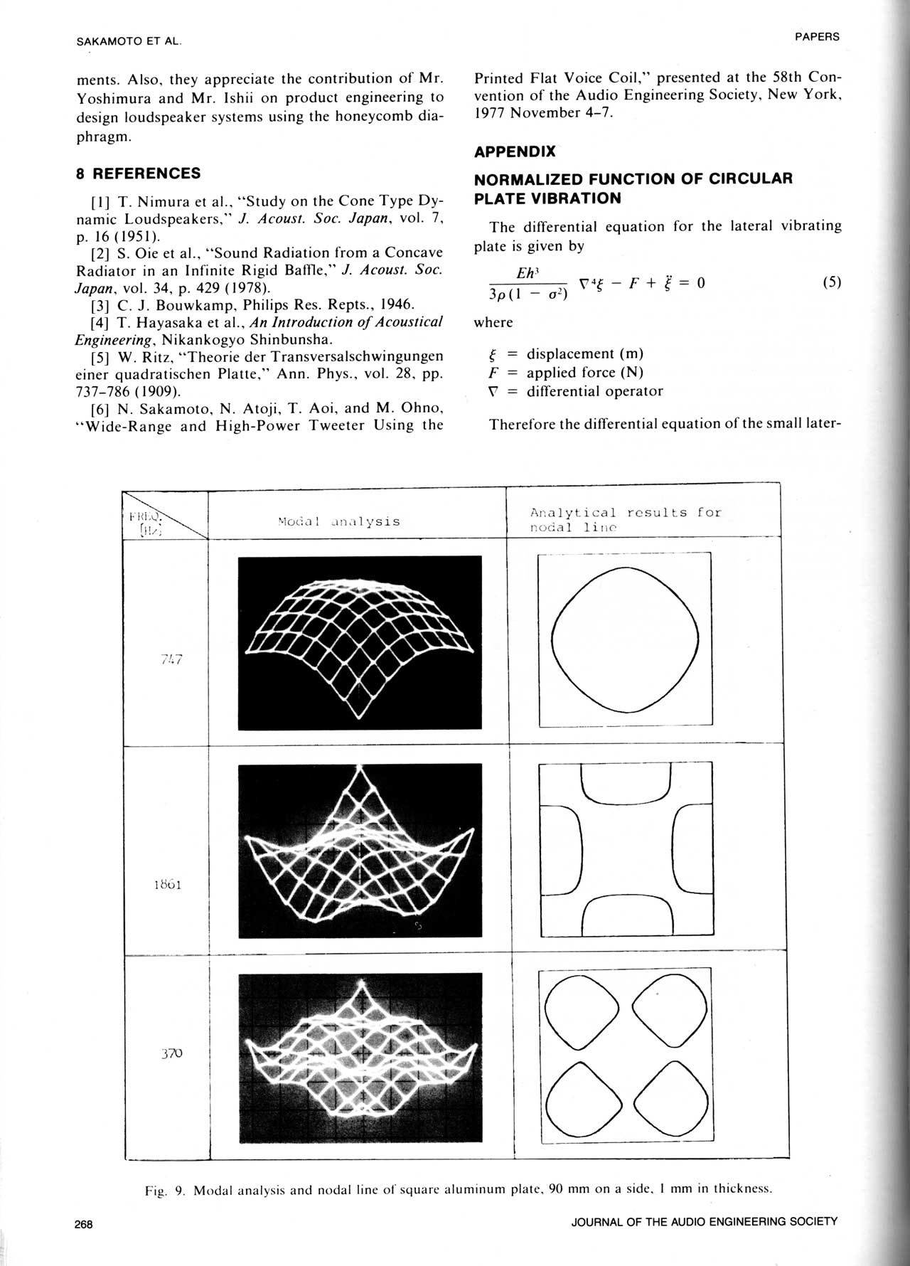

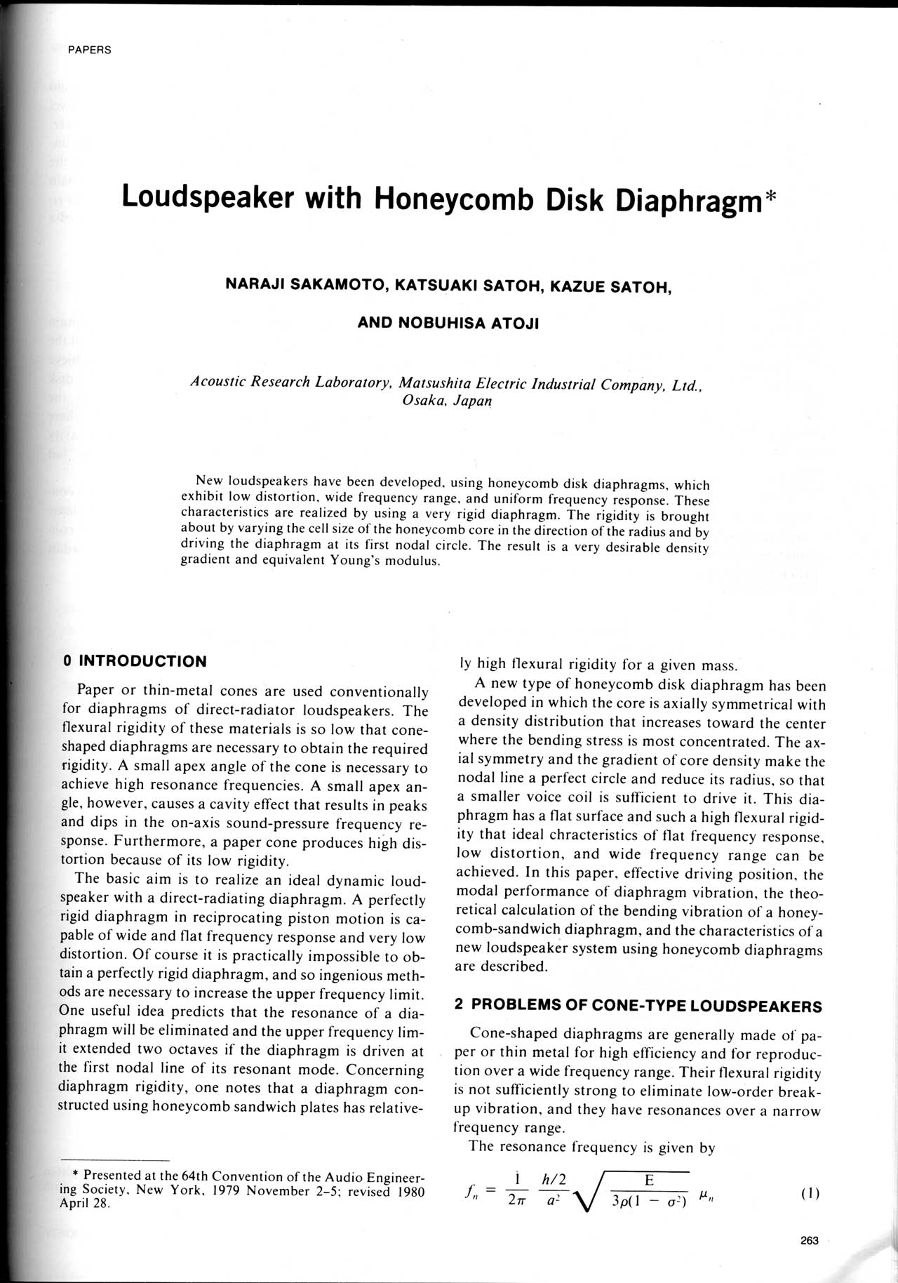

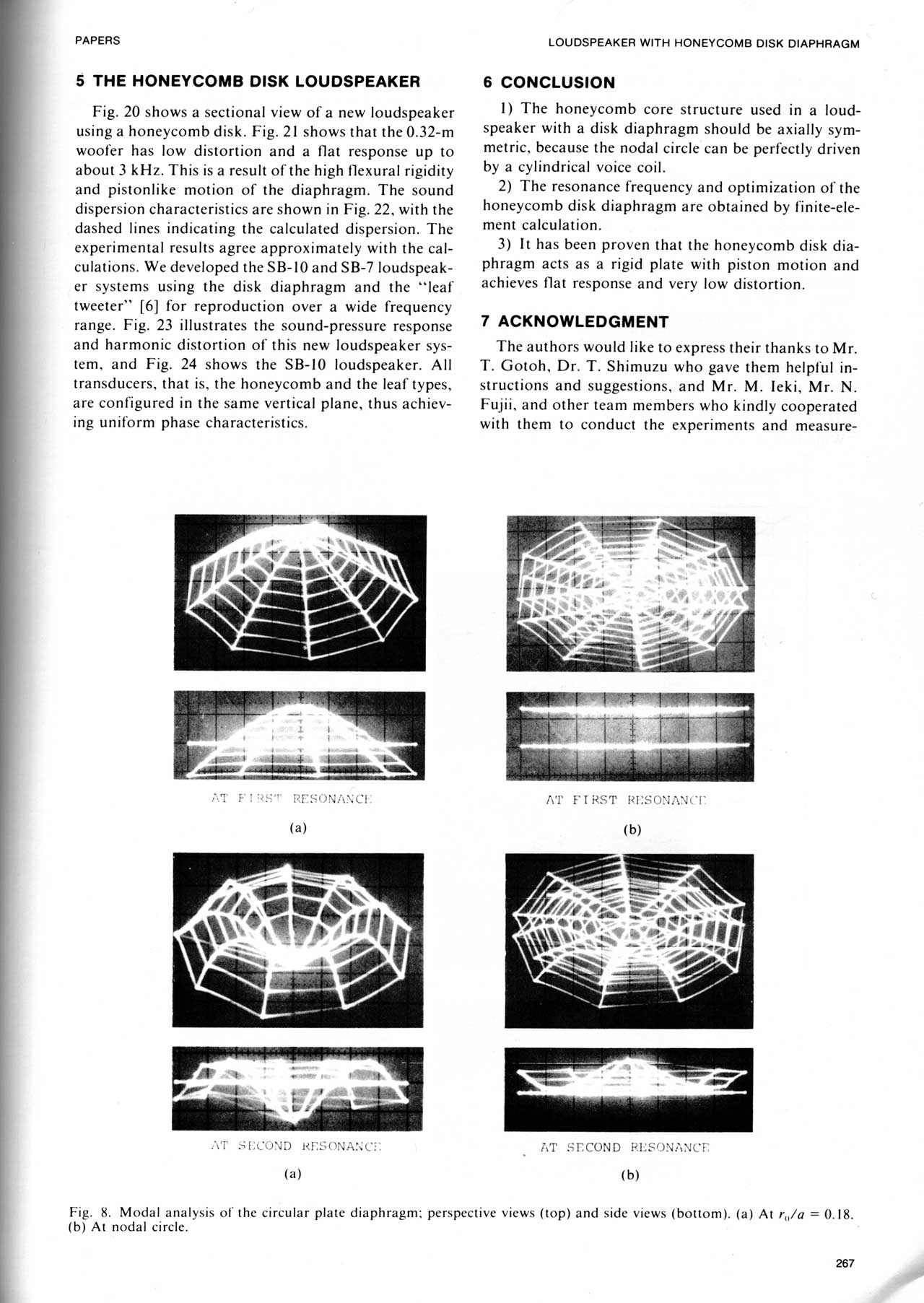

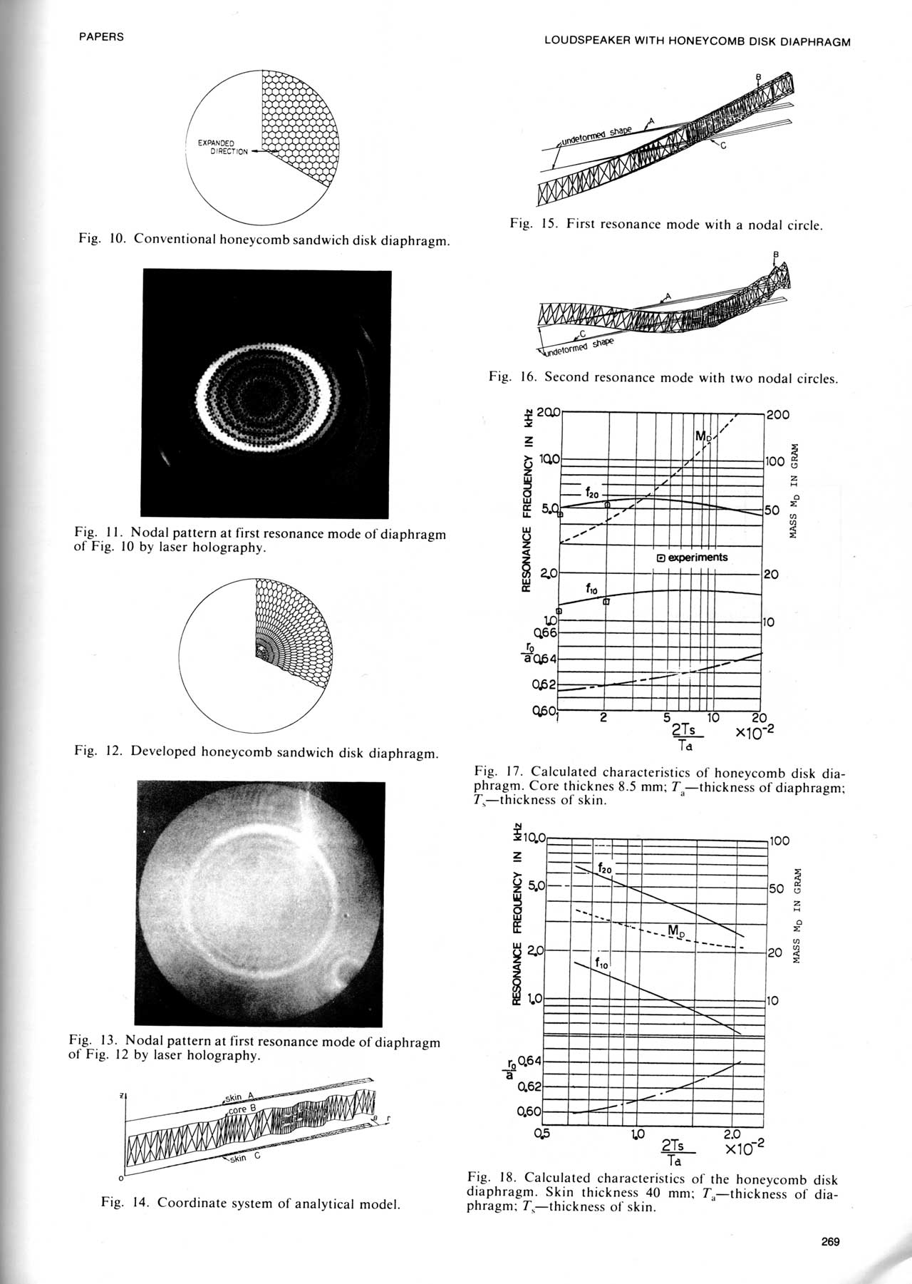

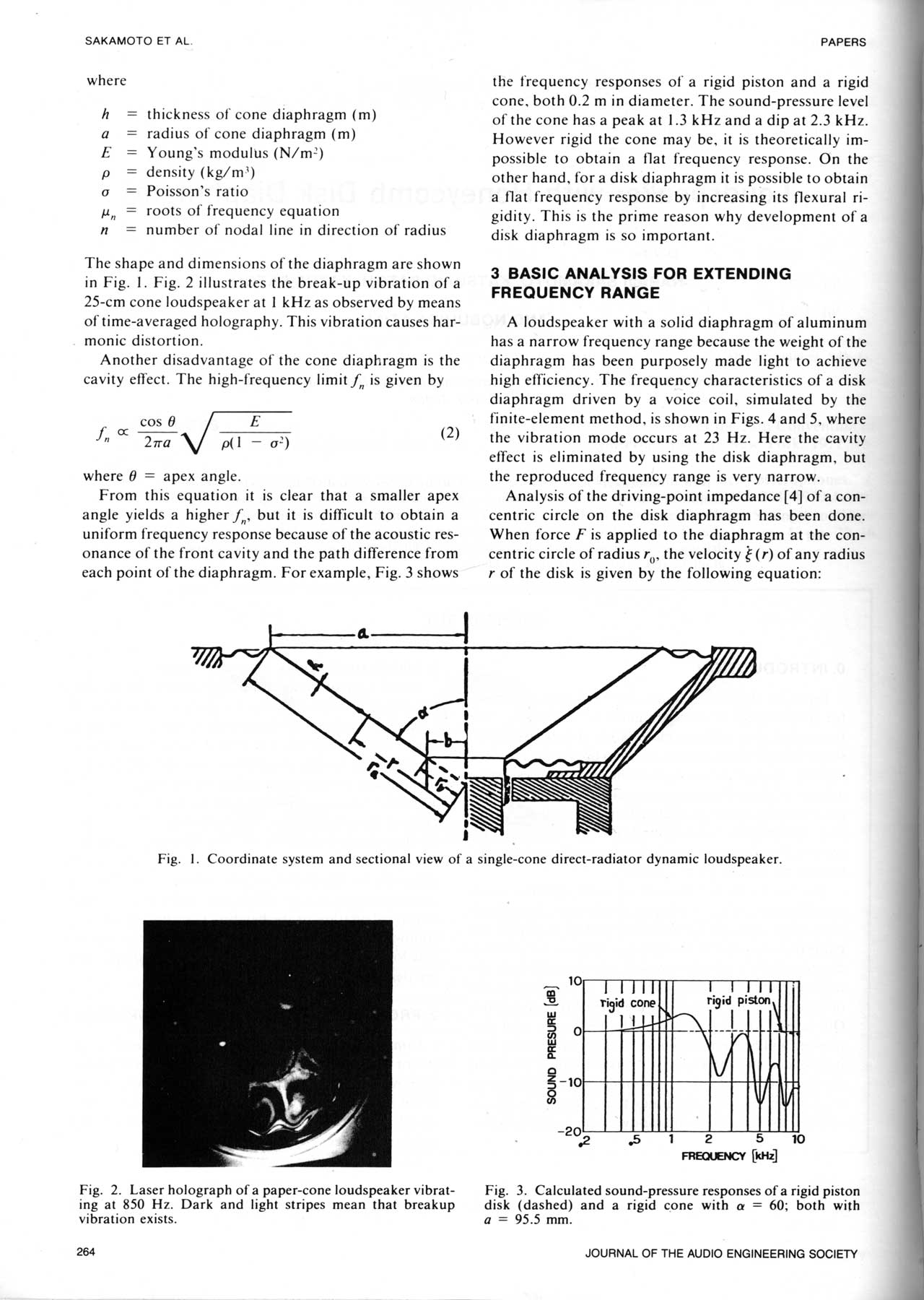

Here's the AES paper "Loudspeaker with Honeycomb Disk Diaphragm" by
Sakamoto, Naraji; Satoh, Katsuaki; Satoh, Kazue; Atoji, Nobuhisa
(Acoustic Research Laboratory, Matsushita Electric Industrial Company, Ltd., Osaka, Japan, 1981)
Description:
New loudspeakers have been developed, using honeycomb disk diaphragms, which exhibit low distortion, wide frequency range, and uniform frequency response. These characteristics are realized by using a very rigid diaphragm. The rigidity is brought about by varying the cell size of the honeycomb core in the direction of the radius and by driving the diaphragm at its first nodal circle. The result is a very desirable density gradient and equivalent Young's modulus.

Is that the fabled HOM I see in the horn plot?
Here's the SB-10 Whitepaper.
Keep in mind, HOMs can be very easily visualized in the Hornresp wavefront simulator.
I find it interesting that such a simple simulator achieves results that are surprisingly similar to BEM tools like axidriver and ABEC, but the Hornresp results are *animated*, which really helps me figure out what the issue is. This is particularly handy for phase plugs.

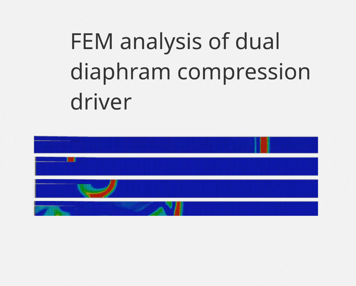

These wavefront sims can be misleading (see attachment).
I know GP Acoustics' subsidiaries utilise high-end software including Siemens PLM.
ABEC and Axidriver are very powerful tools. Hard to beat in terms of price/performance,
but obviously limited compared to Ansys, Comsol, Siemens etc.
