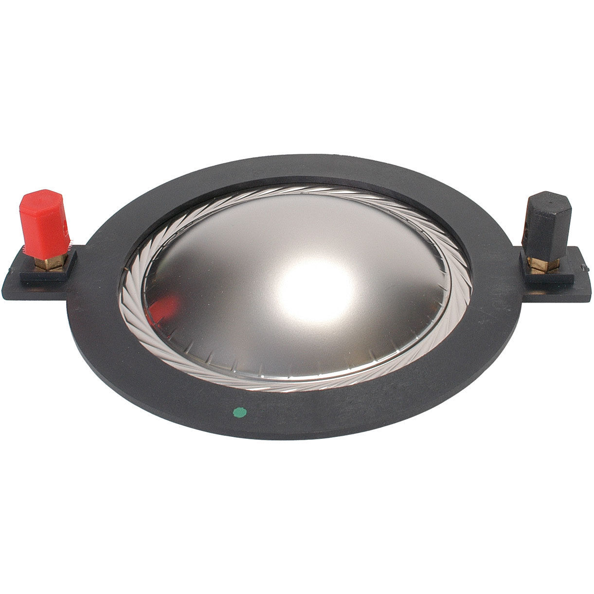

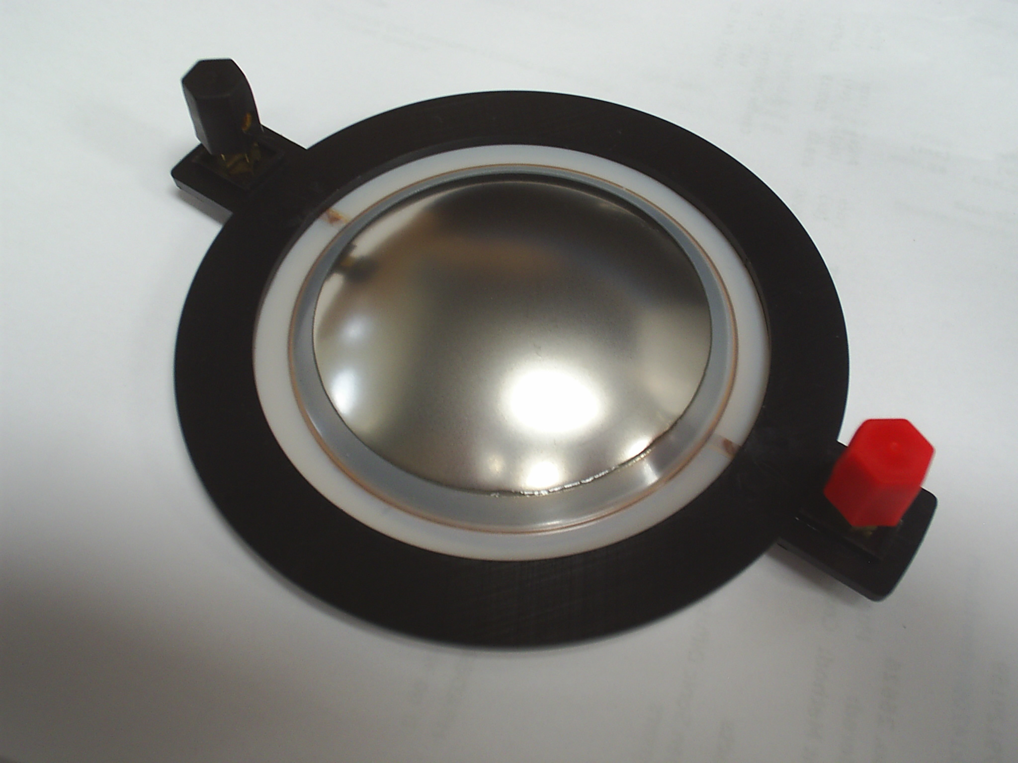

For some of my B&C drivers, 2 different suspensions are available. The differences are subtly visible in measurements, but clearly audible.
Somewhere in the "Geddes on Waveguides" thread, Dr. Geddes refers to compression drivers as "commodities".

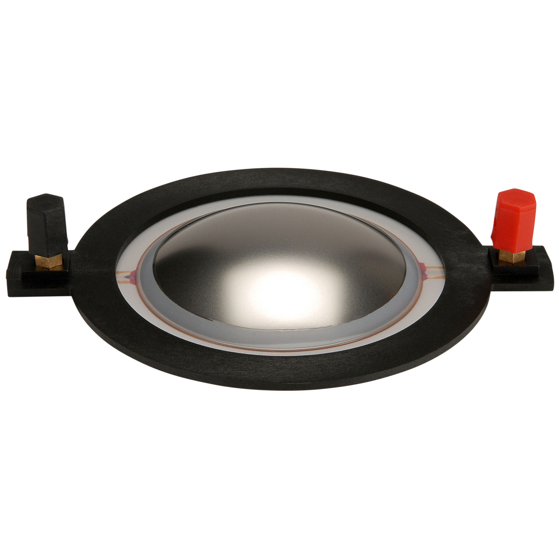

This is an original replacement 3" diaphragm for a Celestion 2" exit driver.
Look for the differences.
What is the difference please ?
Left is a Titanium diaphragm with a Titanium suspension consisting of radial ribs.
Right is a Titanium diaphragm with Mylar suspension.
There are at least 10 compression drivers in which each of these diaphragms can be used.
Each driver does sound different with each diaphragm and 2 randomly picked drivers which the same diaphram will sound (though sometimes maginally) different due to differences in magnet structure, phase plug design, conic exit sections, the addition of ferro fluid, shorting rings etc.

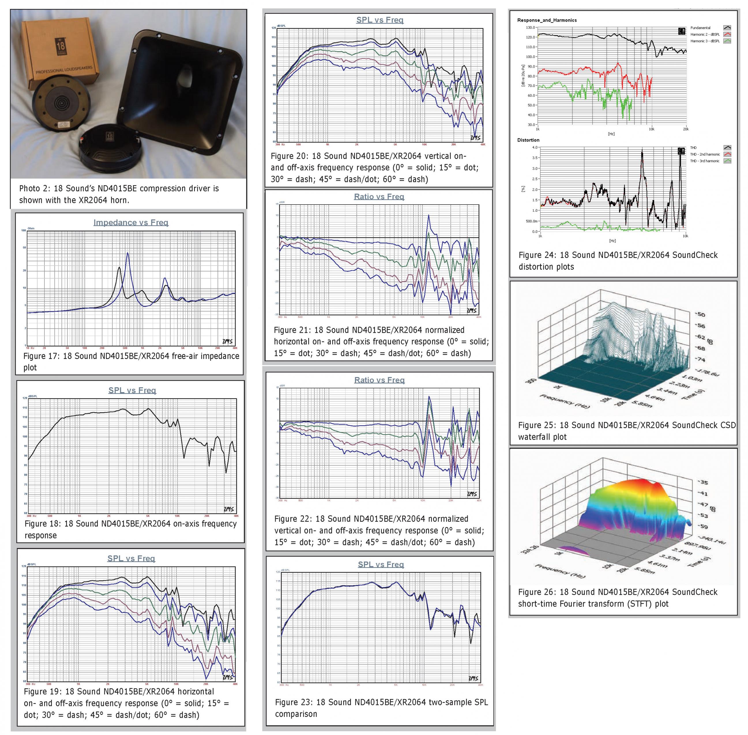

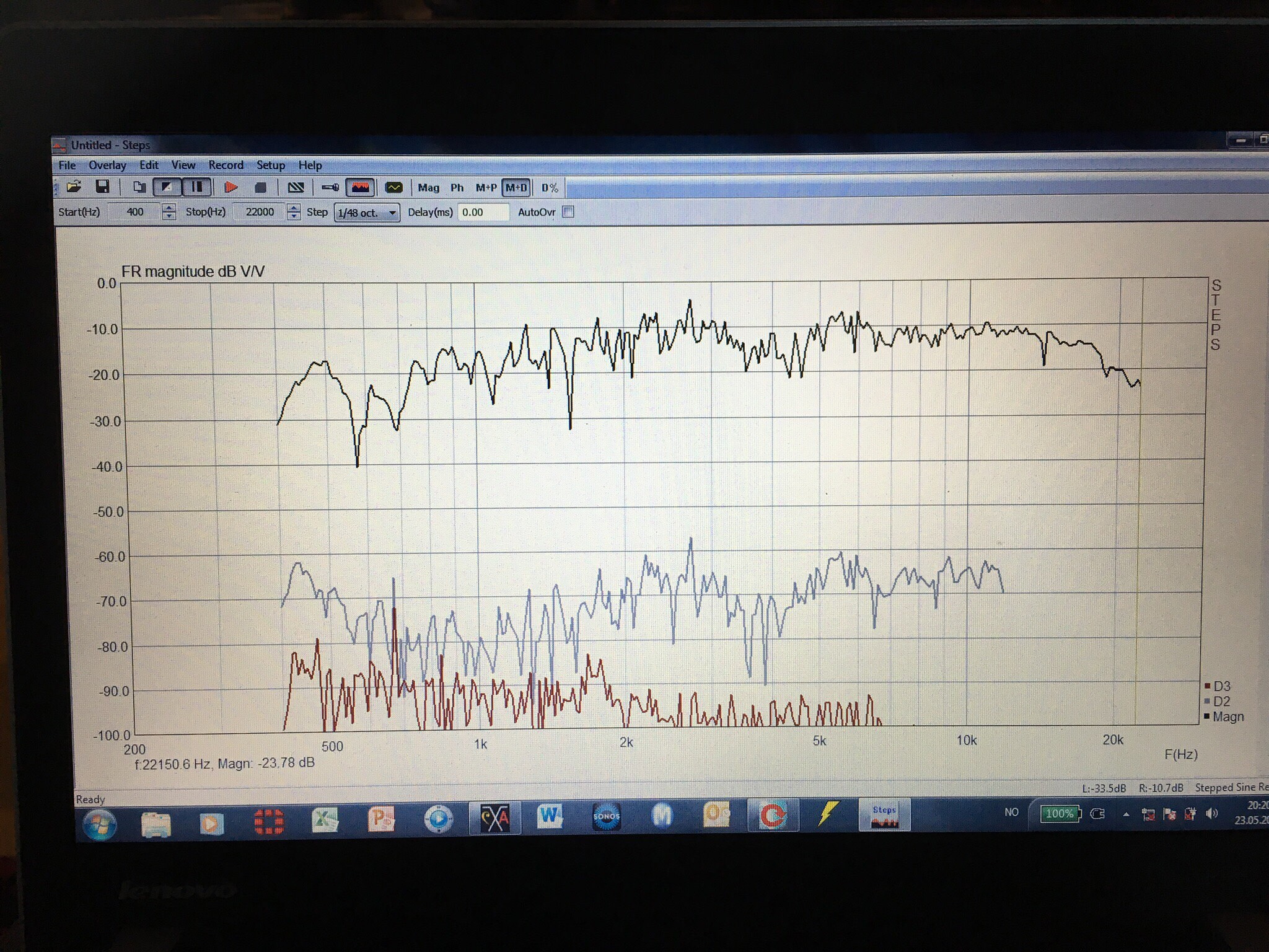

Obvious Candidates are Radian 951 BE and 18Sound ND4015BE, both of which are offered for 1400-1500€. For "even" less you could score a used TAD 4001 or 4002, with the expensive risk of damaged diaphragms.
I am not convinced the Radian drivers can be comfortably used from 350-400Hz. Anyway, their output in the top octave leaves much to be desired.
diyaudio member superlian bought a pair ND1415BEs and took some measurements: high pass 400 Hz 48 dB in the active crossover under the measurements and a 47 uF capacitor for protection.
Quite impressive and better than BE JBLs, according to him.
In the third image are Vance Dickason's measurements of the same driver (and probably not the best horn).

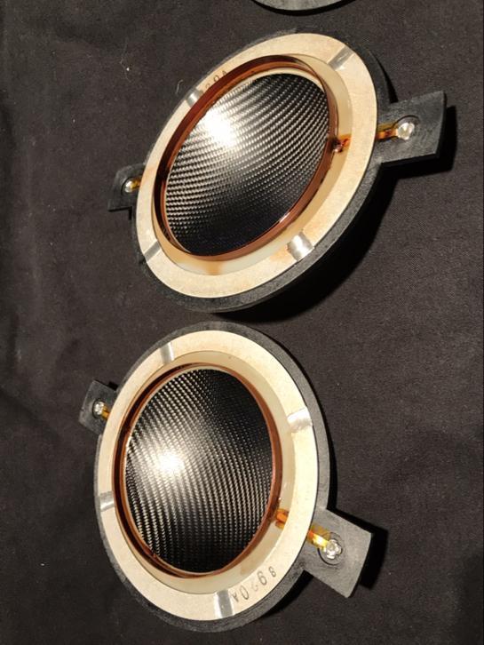

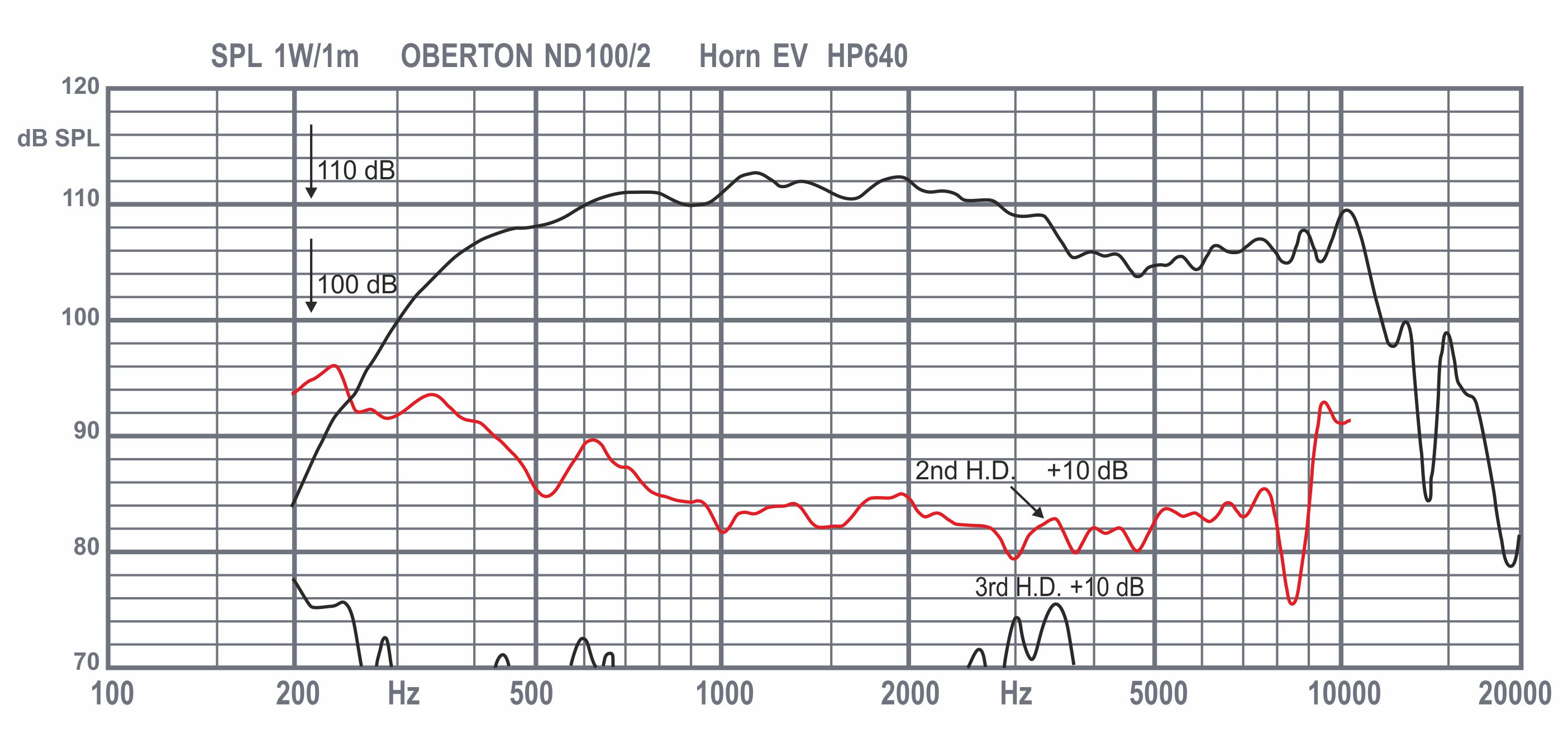

Customized versions of these diaphragms have also been developed...
Are in still in development...
ND100-2

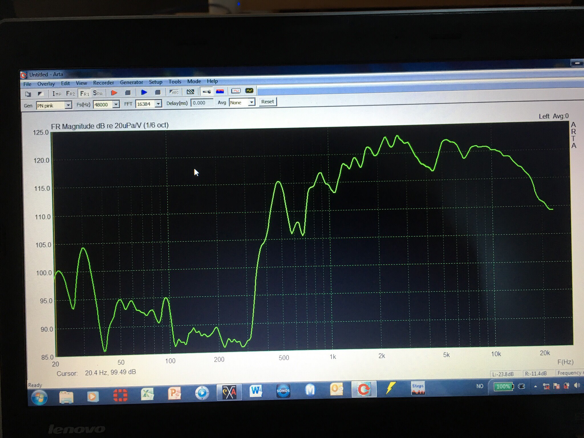

An East European manufacturer has tested this driver. Below is the raw response (without EQ, or HPF) of the ND950 2.0 in a custom 60x40 horn.

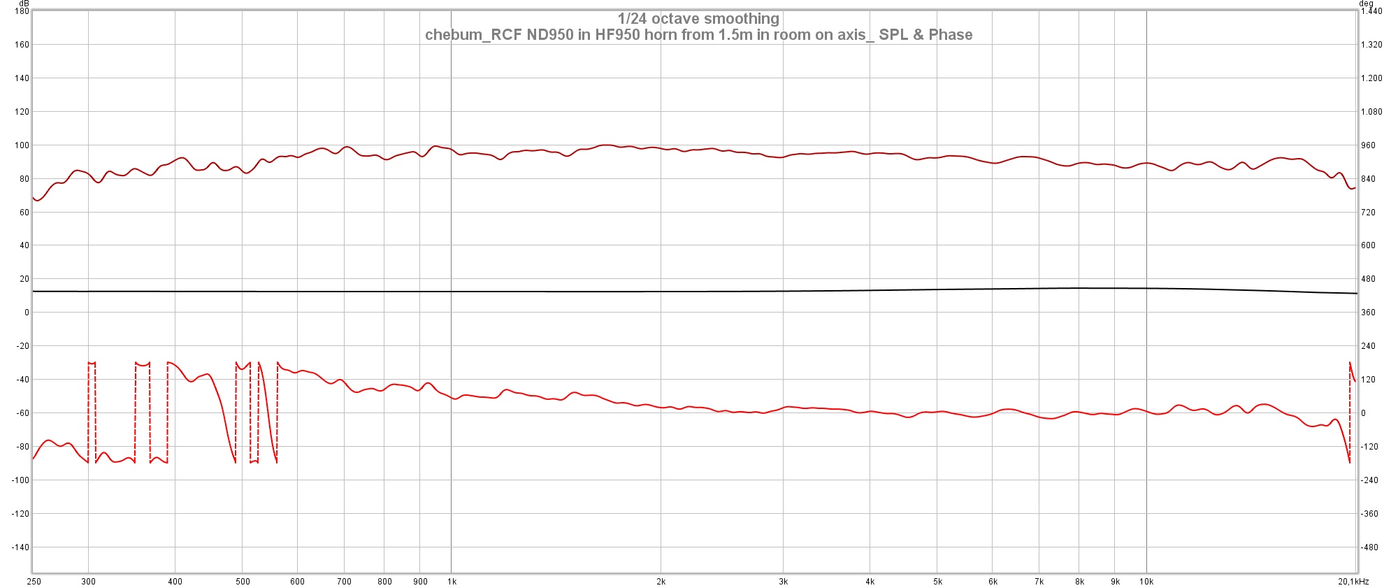

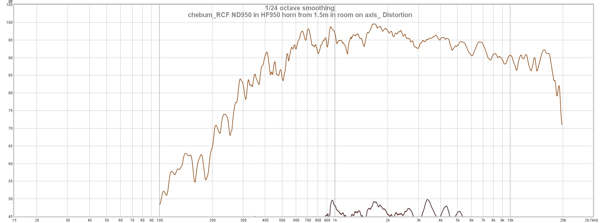

I can confirm RCF ND950 is a good driver. I'm running mine in dedicated HF950 horn from 600Hz up. I'm satisfied with amount of highs, their smoothness and cleanliness. No pronounced "tube" artefacts after equalization. There are some in ND940 sound though. It's a smaller brother with a bit simpler motor. I heard a recording of ND940 in HF950 horns in a system similar to mine (triamped system, ND940/HF950 + beyma 12mwnd in OB + dual 10" servo subs). The recording was made with a tascam handheld recorder. In ND940 there was a little bit of metallic harshness in sibilants. I don't hear these metallic sounds with my pair of ND950. It may be an artefact of the recorder, but the owner of the system told me he hear these as well.
My previous tweeter was Seas 27TBCD/GB-DXT. RCF is as smooth as Seas but are capable of much higher levels. When Seas starts to distorts, RCF keeps playing clean.

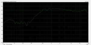

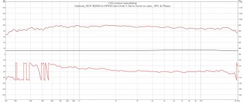

Here is my amateur REW measurement of RCF ND950 in HF950 horn from 1.5m in room on axis:

Thank you for sharing your experience and measurement, chebum.
This confirms my expectations.
I think the difference in sound quality can probably be attributed to the motor and possibly (less advanced) phase plug design of the ND940.
The smaller exit could also contribute to additional interferences.
If it's not too much of a hassle, it would be nice if you could upload a printscreen of your REW measurement.

FWIW: chebum's REW measurement of the RCF ND950 with the HF950 horn from 1.5m in room on axis.
20dB/division. 🙁
