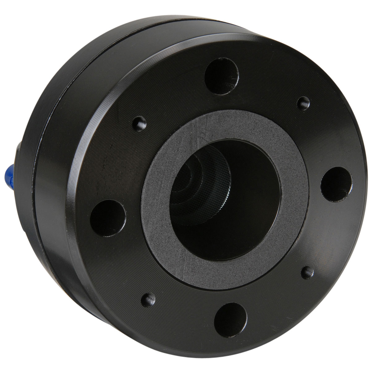

By the way, that's the N481, behind the hornlens.

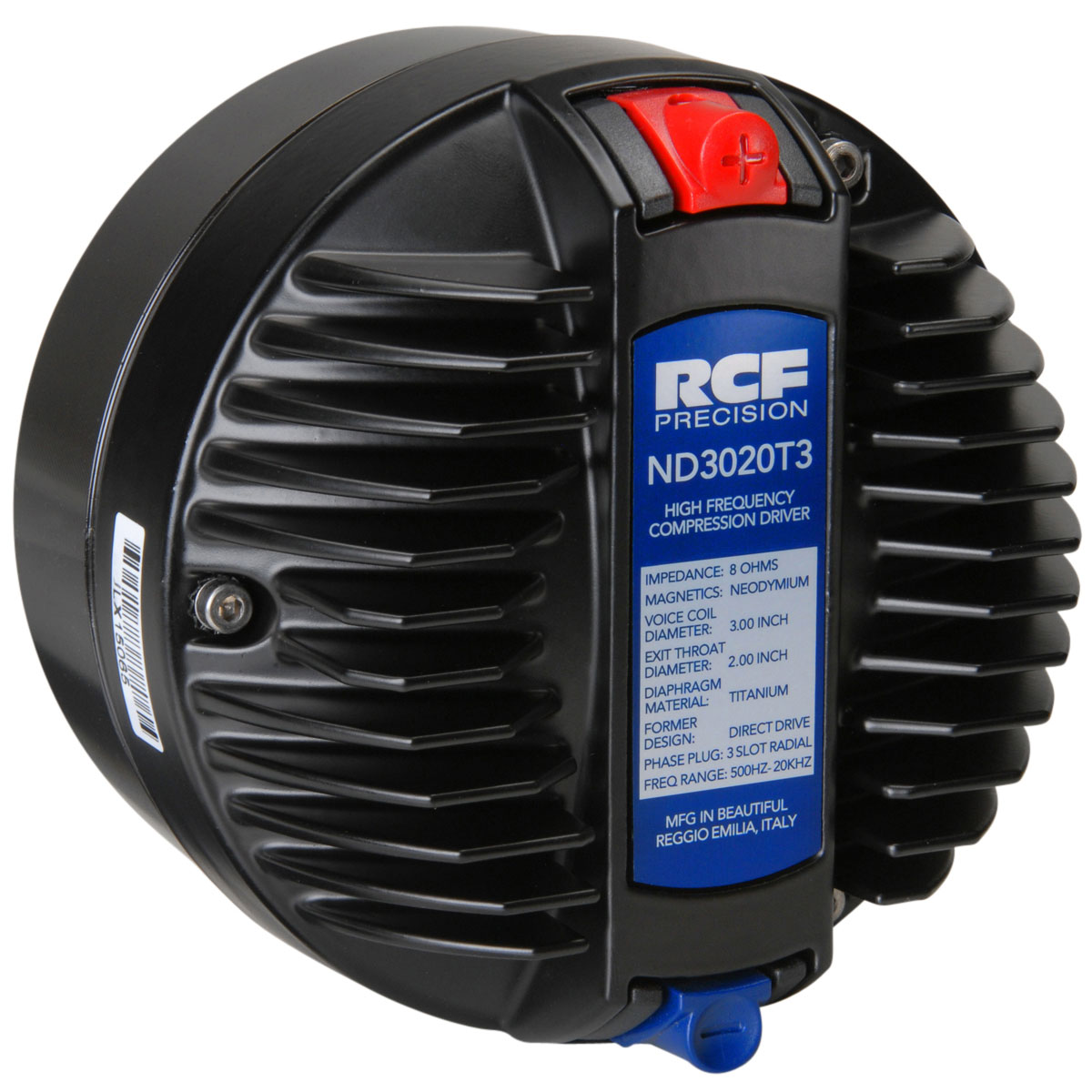

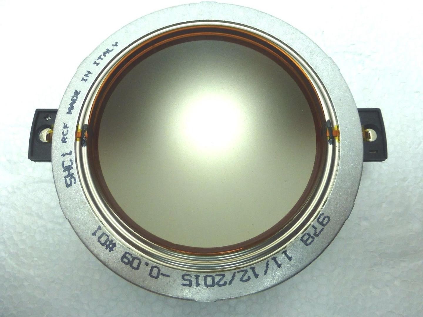

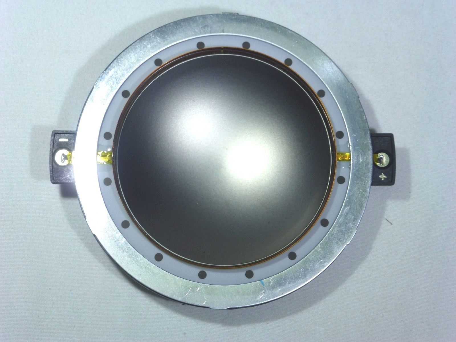

Whilst the ND series are overall very good, I wouldn't buy their older RCF ND3020 driver.

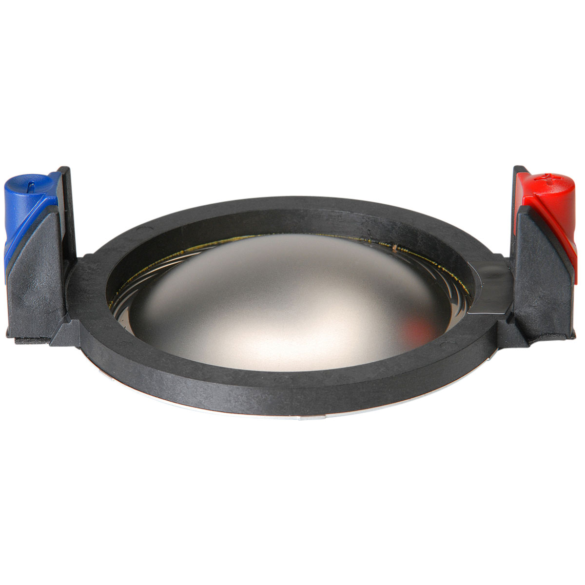

Even the 850 series can sound harsh, especially with the all-metal diaphragm.
Similar to the B&C drivers:

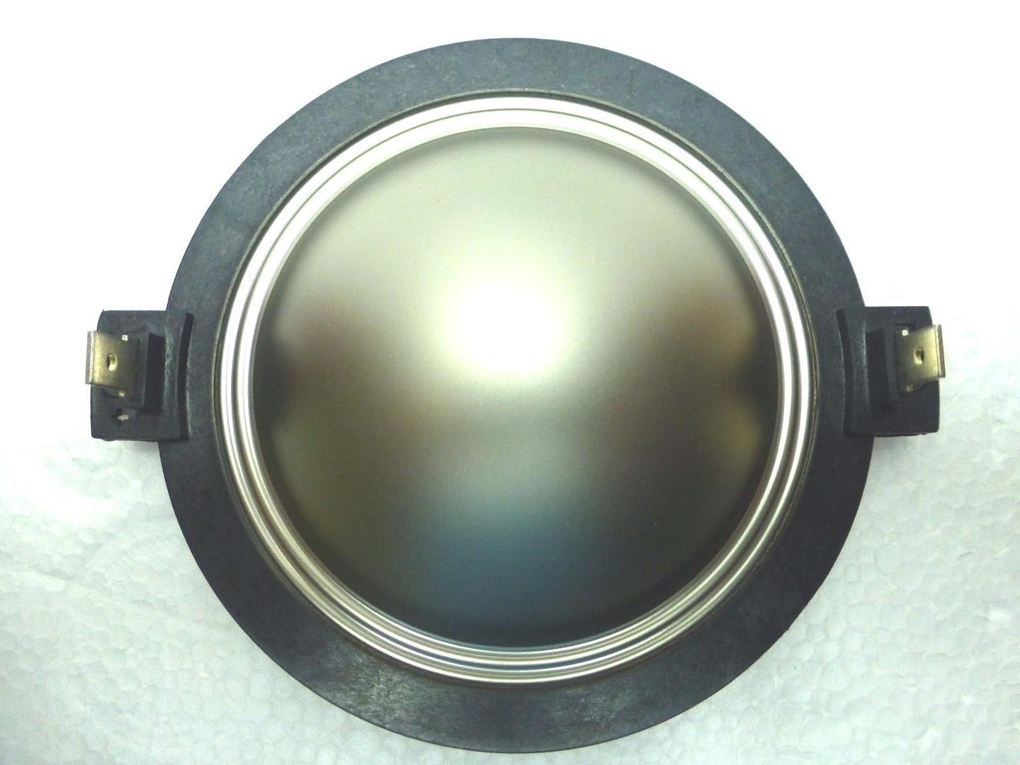

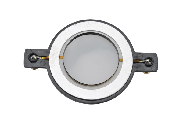

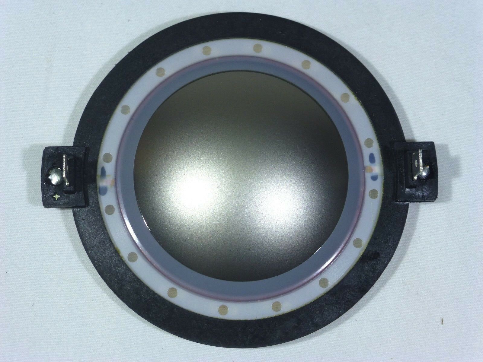

Original Facrory RCF CD850-T3 Diaphragm For CD850 Driver HDL 20A, 8 Ohms 74.4mm.jpg175.6 KB · Views: 483
original-facrory-rcf-cd850-t3_1_576f62adae1c1b4c92640f2c1bae07d0.jpg209.7 KB · Views: 490
Replacement RCF Diaphragm For ND850, CD850 Driver_4.jpg243.6 KB · Views: 491
Replacement RCF Diaphragm For ND850, CD850 Driver_5.jpg212.8 KB · Views: 484

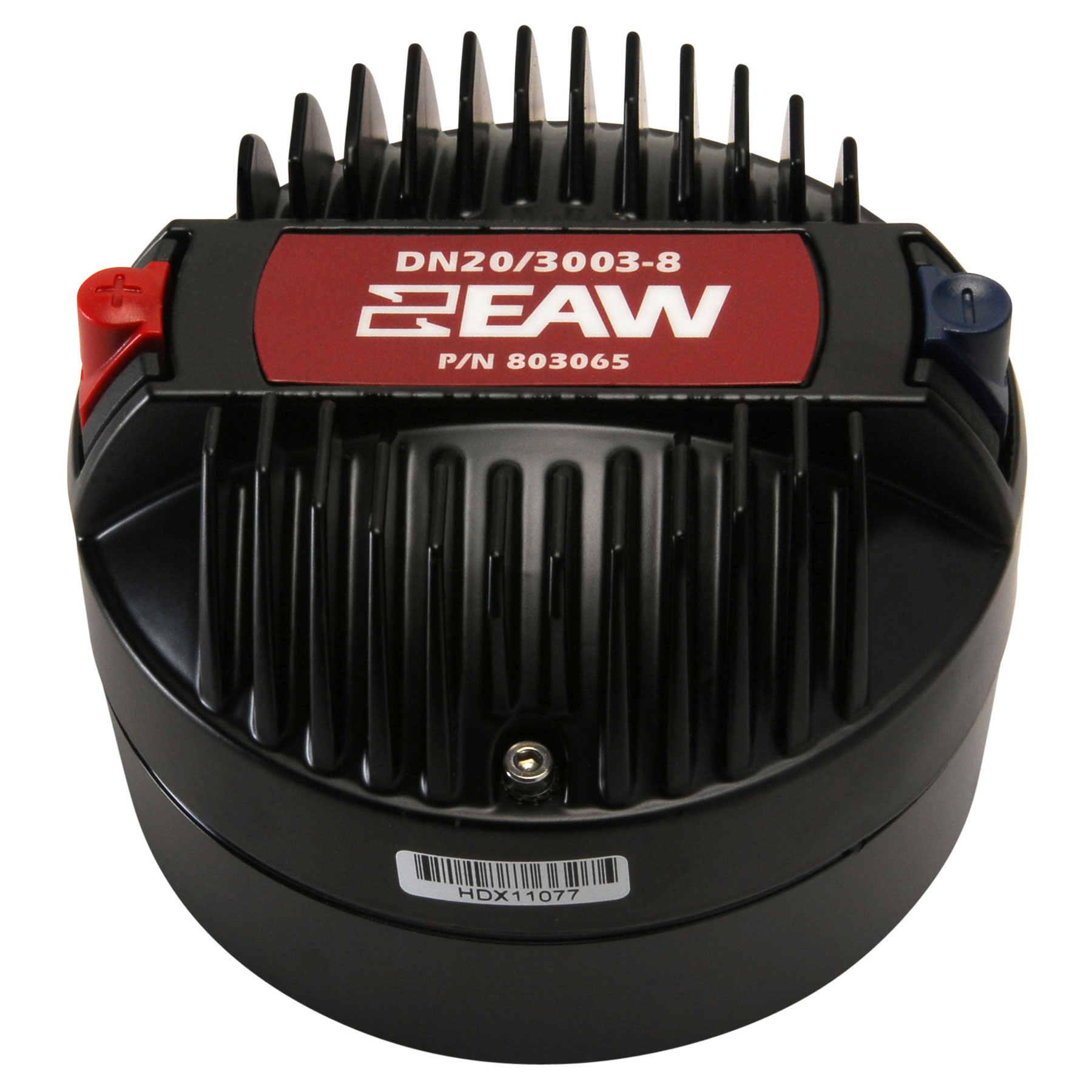

The RCF ND3020-T3 aka EAW DN20-3003:

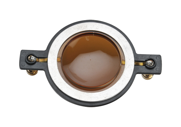

The reason why all-metal diaphragms remain popular, has to do with the prolonged high output levels common in PA.
Mylar/Polymer suspensions are subject to softening, or even melting due to the heat generated by the
system.
"...And that's why these are called soft-suspensions"

It's a well-known fact, serious breakup cannot be EQ-ed.
A mismatch near the throat, or even before the throat (exit > horn entrance) is often cause for "issues" around and beyond 10kHz.

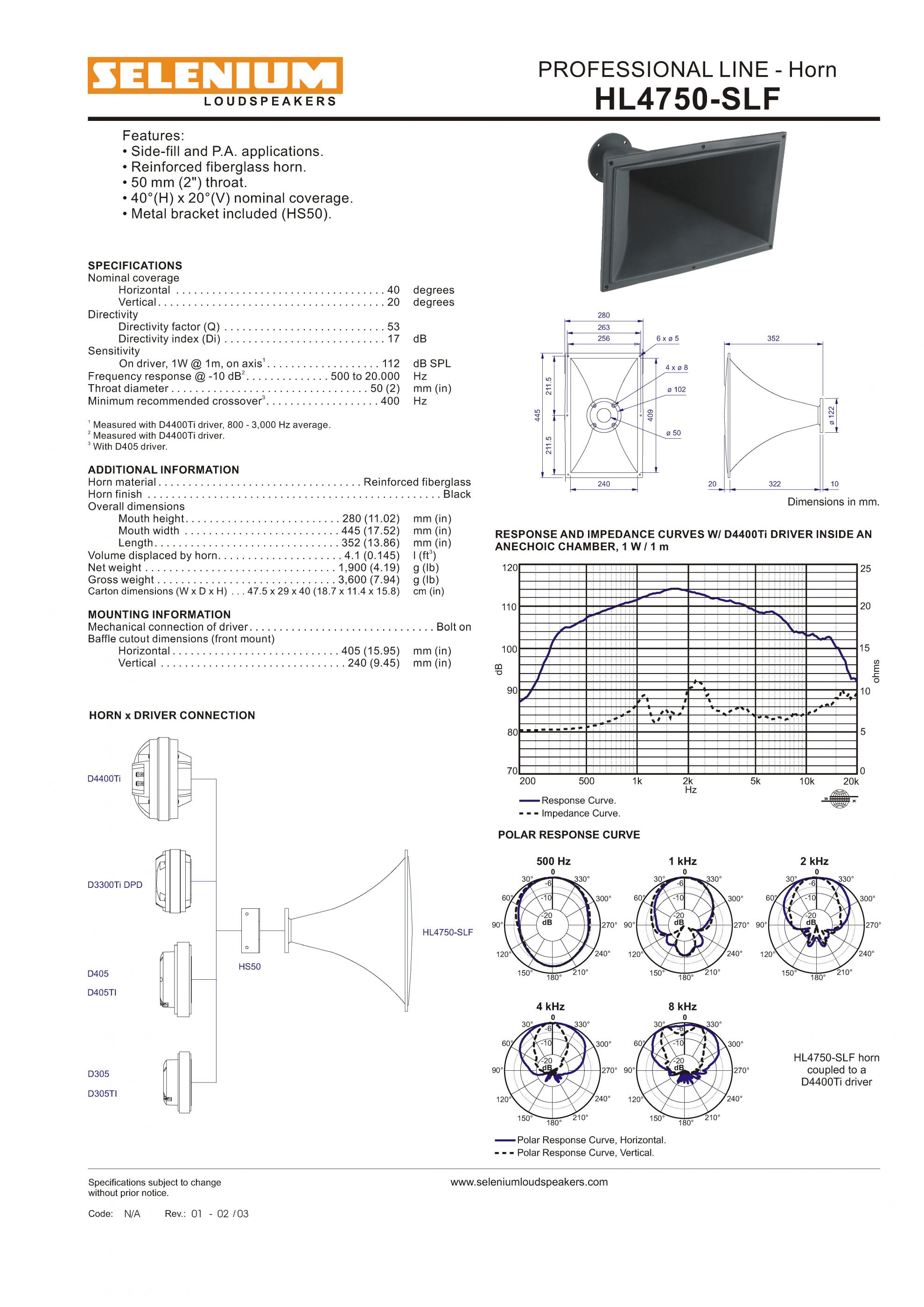

If you don't mind a very narrow dispersion, this one's cut-off is at 400Hz:
It's a clone of the Selenium HL4750-SLF, which is essentially a modernized JBL 2386, a Flat Front Bi-Radial 40° H x 20° V horn,
designed to be used with 2441, 2445, 2446, 2450 2" drivers.
I am not sure if it works with your drivers, but some members of the Klipsch Forum like it a lot.
And so do the people from G.I.P. Laboratory, apparently (it's in the speakers with the silver (Selenium?) bullets on top):

mitchba, I forgot your JBL 2453h-SL is a 1.5" exit driver.
You'll need an adapter for that Selenium horn, if these exist at all.

In the past, I have contacted several Chinese suppliers.
Clone drivers are available for next to nothing: DE250 for $5-10 each, DE500 for 20-25, etc.
However you'll have to place bulk orders. Shipping individual units is quite expensive.
I was tempted to buy a pair of these though, with both diaphragms:

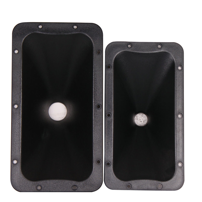

The JBL PT clone horns above, are probably better than the original JBLs.
The throat is completely smooth, whereas the JBLs have tiny diffraction slot.
You would probably have to polish some rough edges, leftover from the molding.

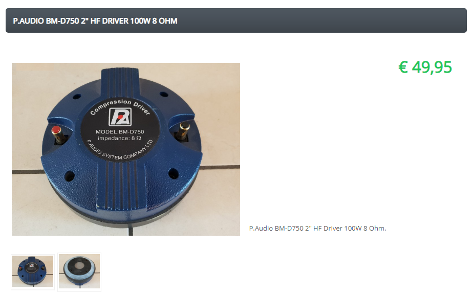

wow the RCF ND950 2.0 looks to be worth the extra money over something like the P-Audio BM-D750
The BM750 cost 50% of a ND950.
Here is the FR + PH of the MK2 diaphragm, technically choosable IMO (Tractrix 350 at the exit no EQ no smoothing)
PS : sorry i've forgot to remove the shelving high shelf filter (6dB at 4K)

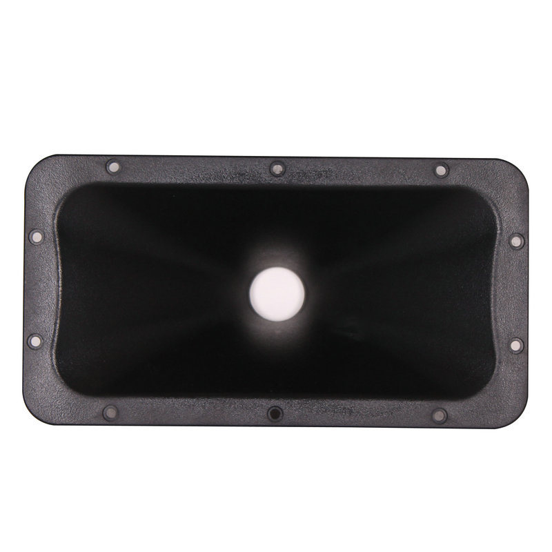

Speaking of China, the PT clone horn on the left (1.5") is available for about $5-10 > fits your JBL, mitchba.
Where can we find these?
