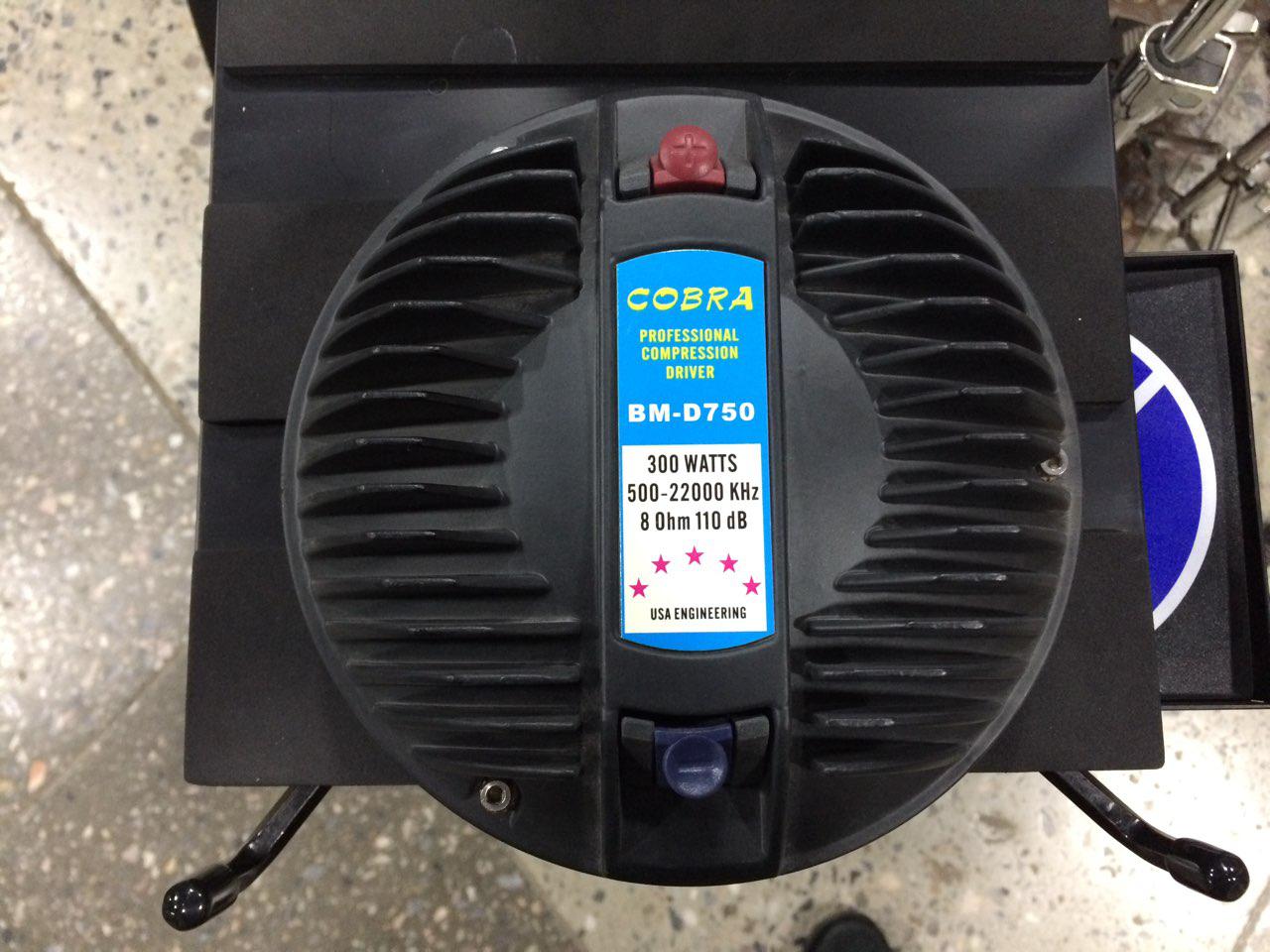

You may wonder why (high-end) manufacturers, as well as (professional) diy-ers prefer a more expensive driver to a cheaper one, such as the BM-D750.
1. Better low frequency capability (650Hz minimum crossover vs. 900Hz)
2. More output at 20kHz
3. Less breakup issues
4. Better power handling
Because they have enough money to pay them, and it will not be satisfying enough if the financial sacrifice is not painful ?You may wonder why (high-end) manufacturers, as well as (professional) diy-ers prefer a more expensive driver to a cheaper one, such as the BM-D750.

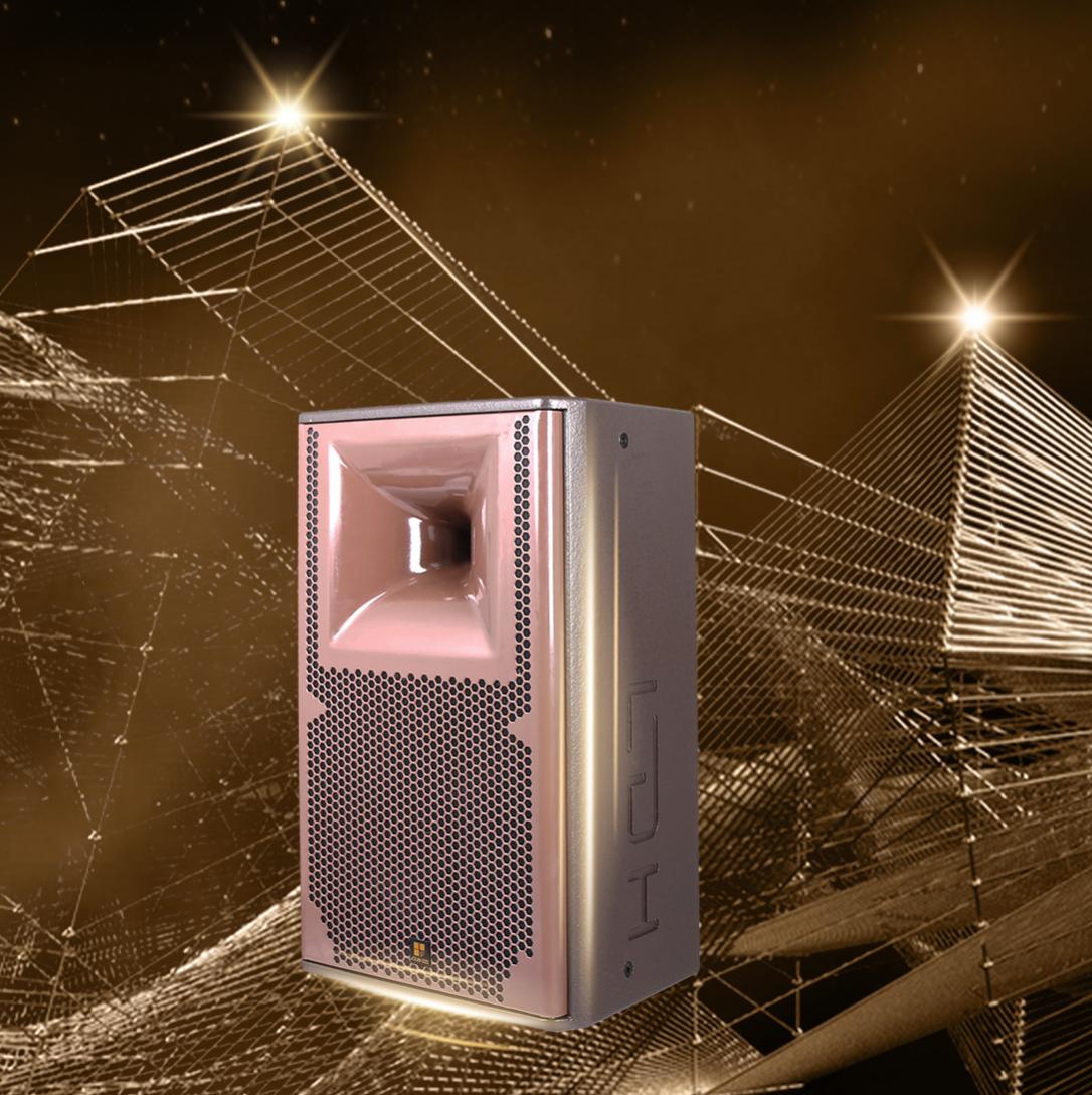

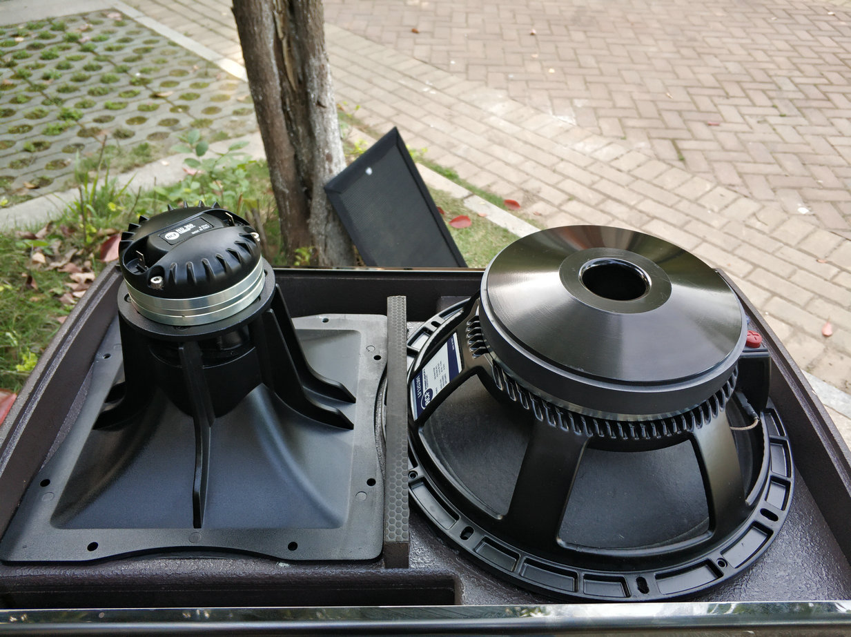

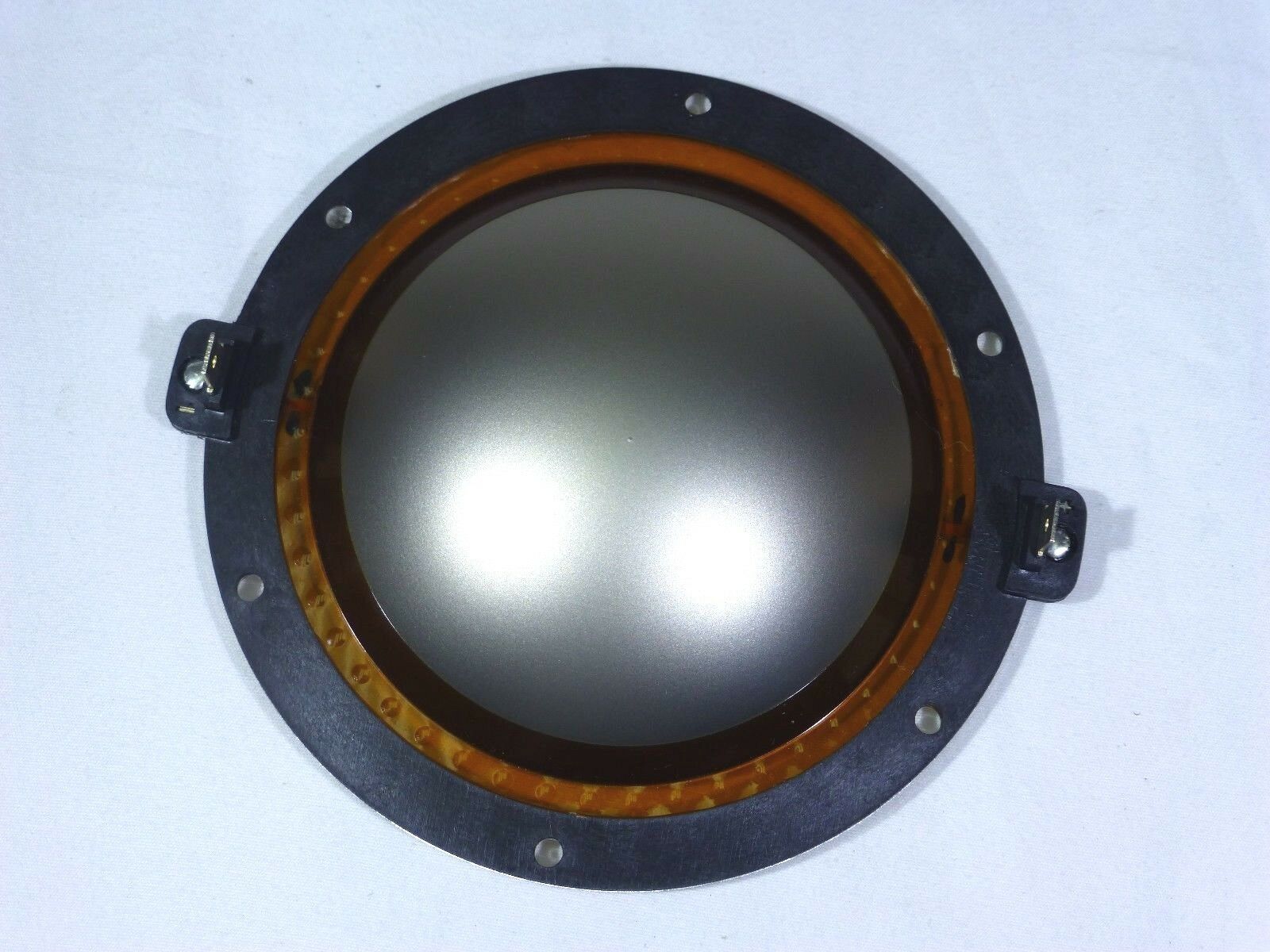

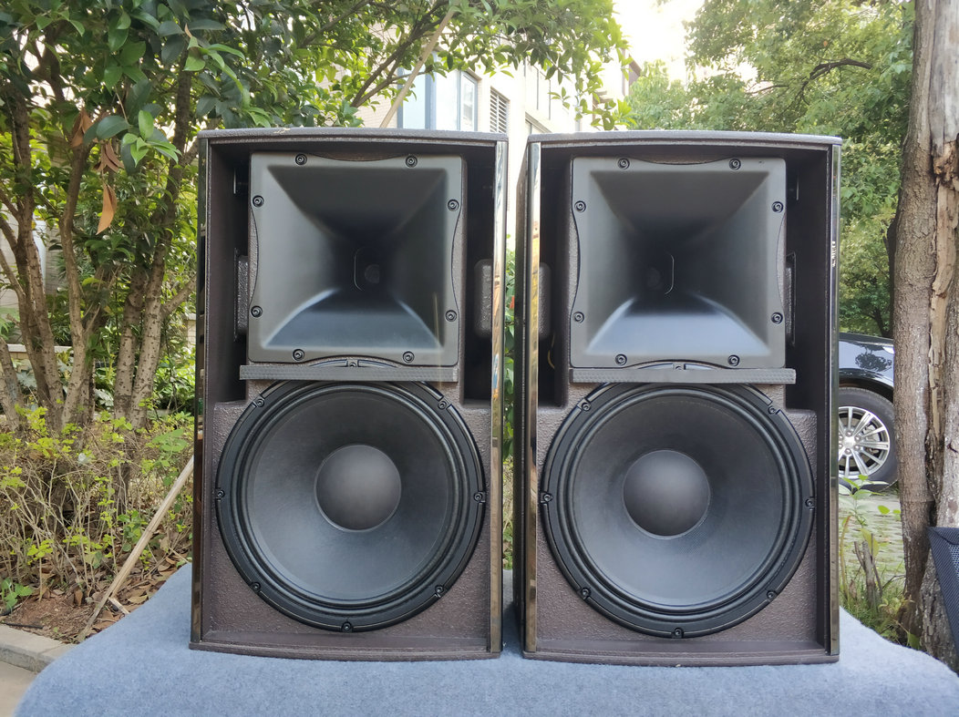

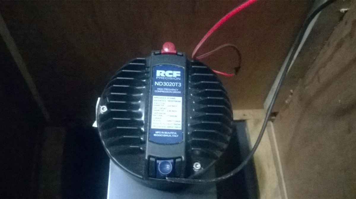

Plastics from China are probably ok for diy, but bare in mind; even the Chinese import components from Italy if they want REAL quality.
Parts inside these drivers are mainly from China, but it's all about production quality and control.
Below, imported original RCF parts and a 2-way from a Chinese RCF partner.
Speaking of China, the PT clone horn on the left (1.5") is available for about $5-10 > fits your JBL, mitchba.

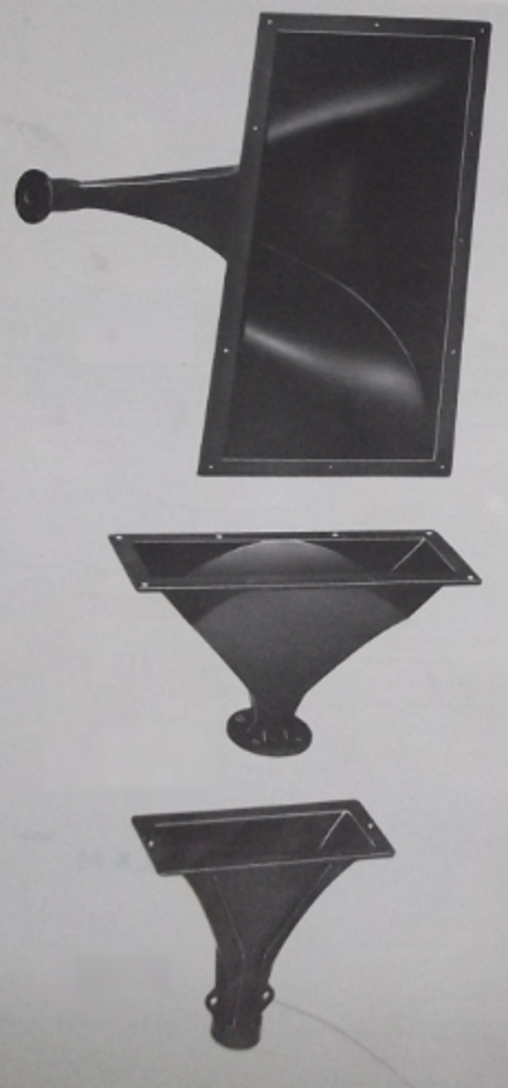

On second thought, the upper horn more closely resembles a Yoshimura Laboratory (YL Acoustic) MB-70.
Imagine, a European company cloning a Japanese product in a period when the Japanese were often accused of shamelessly copying/cloning "inventions of the Western world".
Which, as we know were false arguments in a common fear of loosing our economic hegemony.

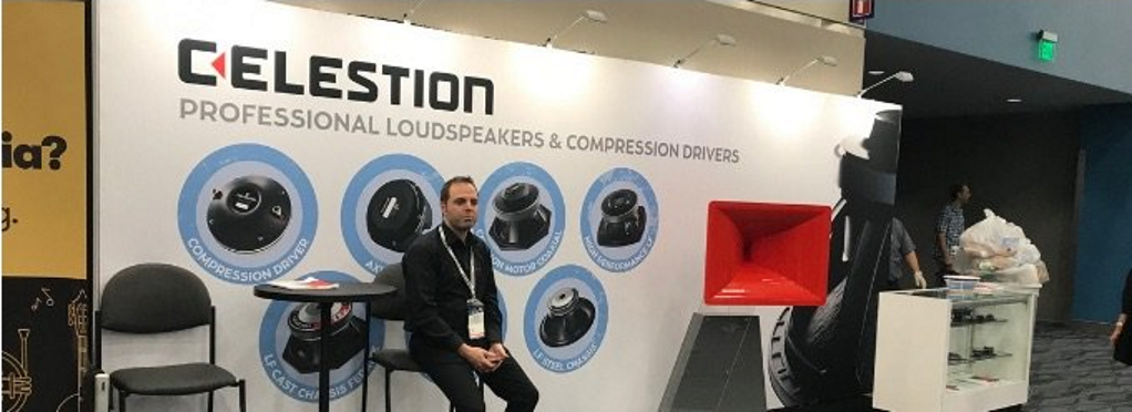

NAMM 2019
Celestion debuted its Axi2050 Axiperiodic Driver, a high-output MF/HF driver that offers ultra wideband (300Hz to 20kHz) that can eliminate the need for a midband crossover. The result of five years research, it’s a single, large-diameter, sculpted, annular diaphragm consisting of many curved, axiperiodically symmetrical elements that adds immense strength to a very thin and light sheet of titanium. Specs include a 2” exit throat, standard mounting and 150W RMS power handling for 140 dB max SPLs.
NAMM 2019
Thanks Rob re: K402... Like the news on the Celestion driver. Looking at the spec sheet says OEM only... Love that red waveguide 🙂
RCF BM-D750???![]()
Do you mean that Paudio have copied RCF ? i'm shocked... why not copy JBL instead !
when they remove the :OEM only" we'll know they've finally figured out how to make it in volume
- New Celestion "AxiPeriodic Driver"
