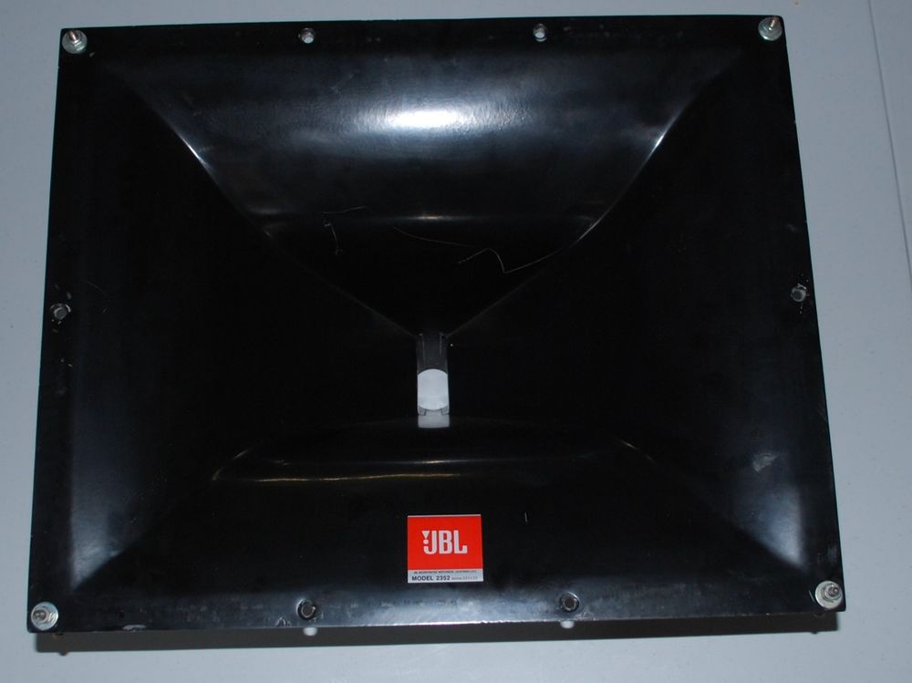

mitchba, you may want to consider on of these:
Optimized aperture bi-radial horns (2354, 5353, 5352) are the last generation specified for a 500Hz crossover, before JBL switched to the PT-style waveguides.
There is a diffraction slot, but the throat of the 60° version doesn't look too bad.
This is the 5352 (90x50).
These are often for sale in scratched condition. You could wrap a piece of sandpaper around a metal strip and gently smooth out the sharp edges of the slot. Repaint them, et voilà!

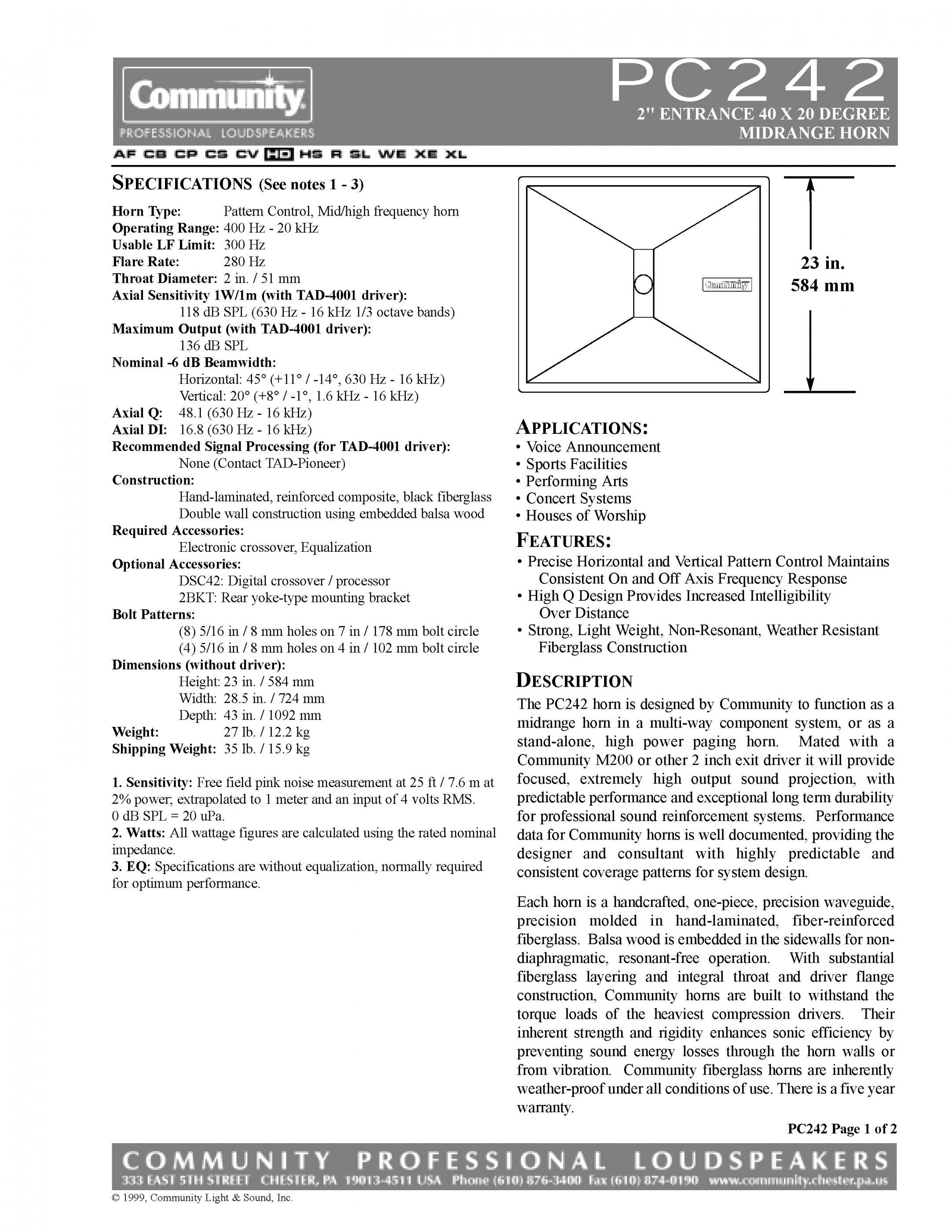

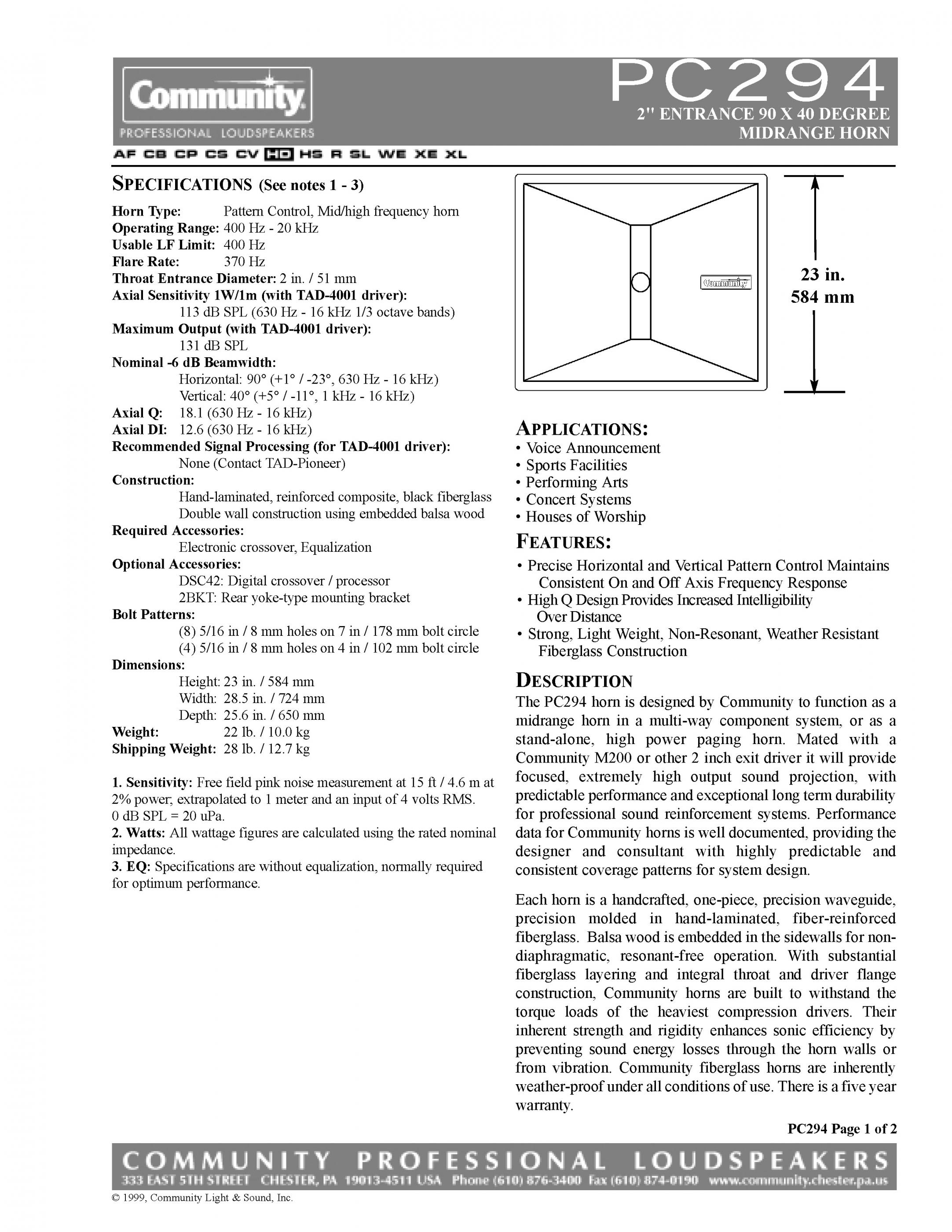

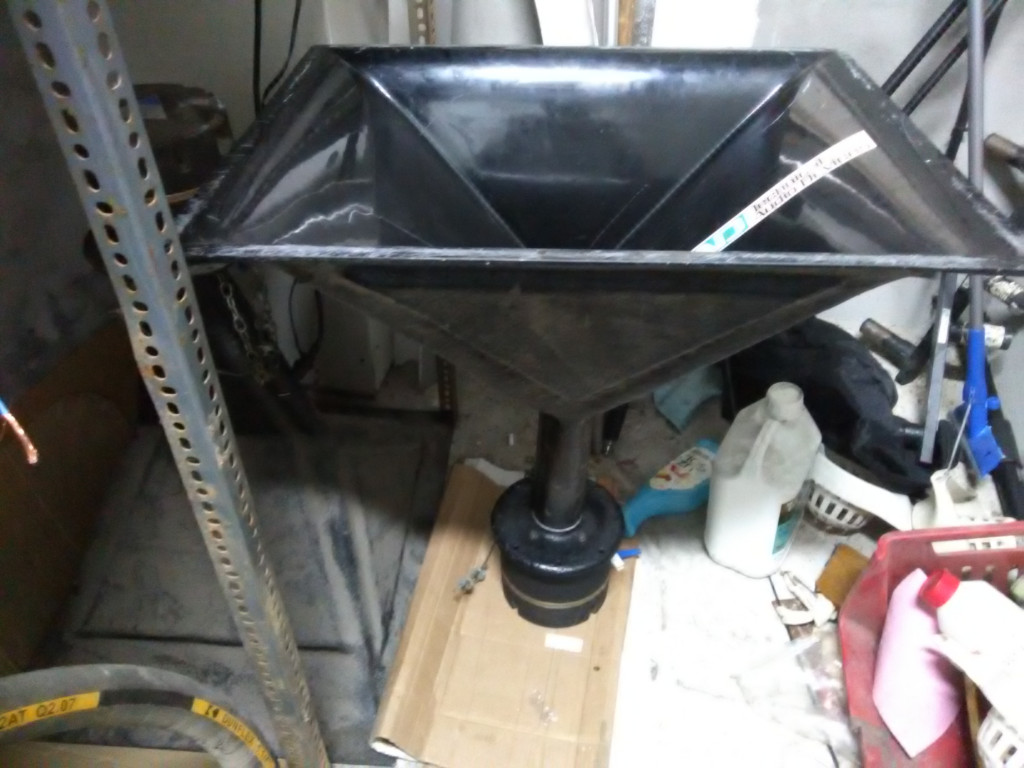

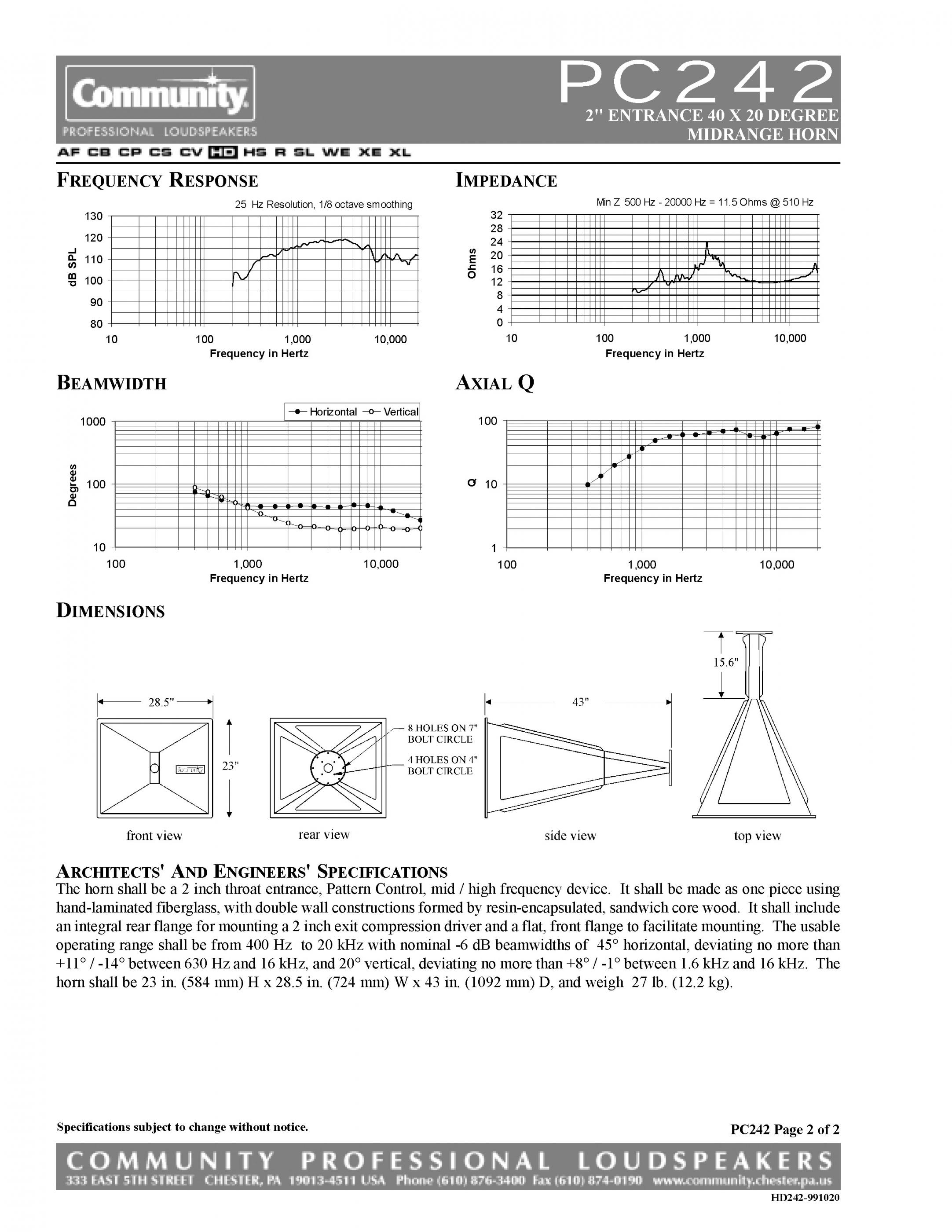

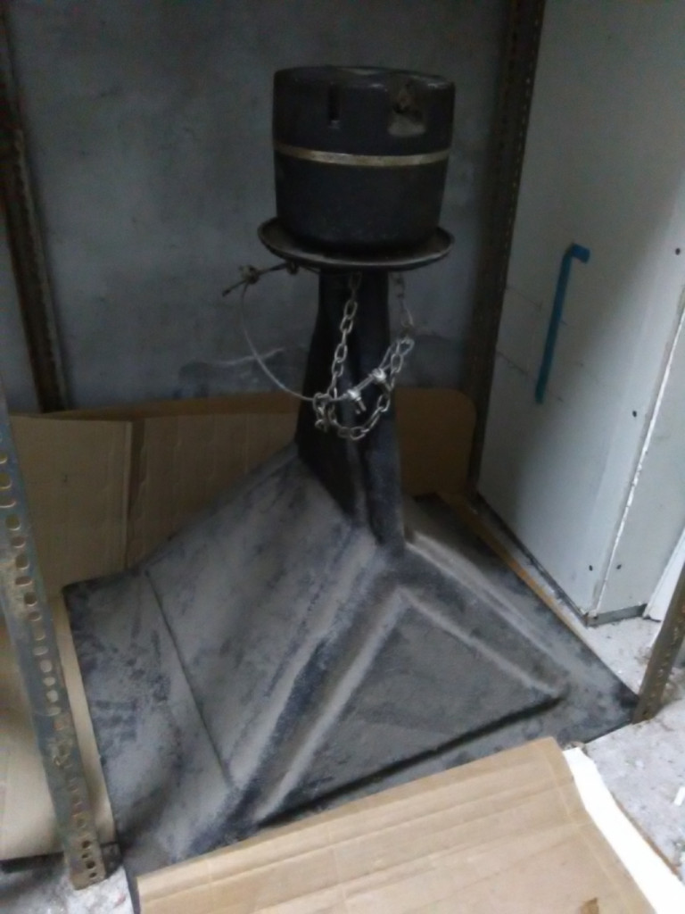

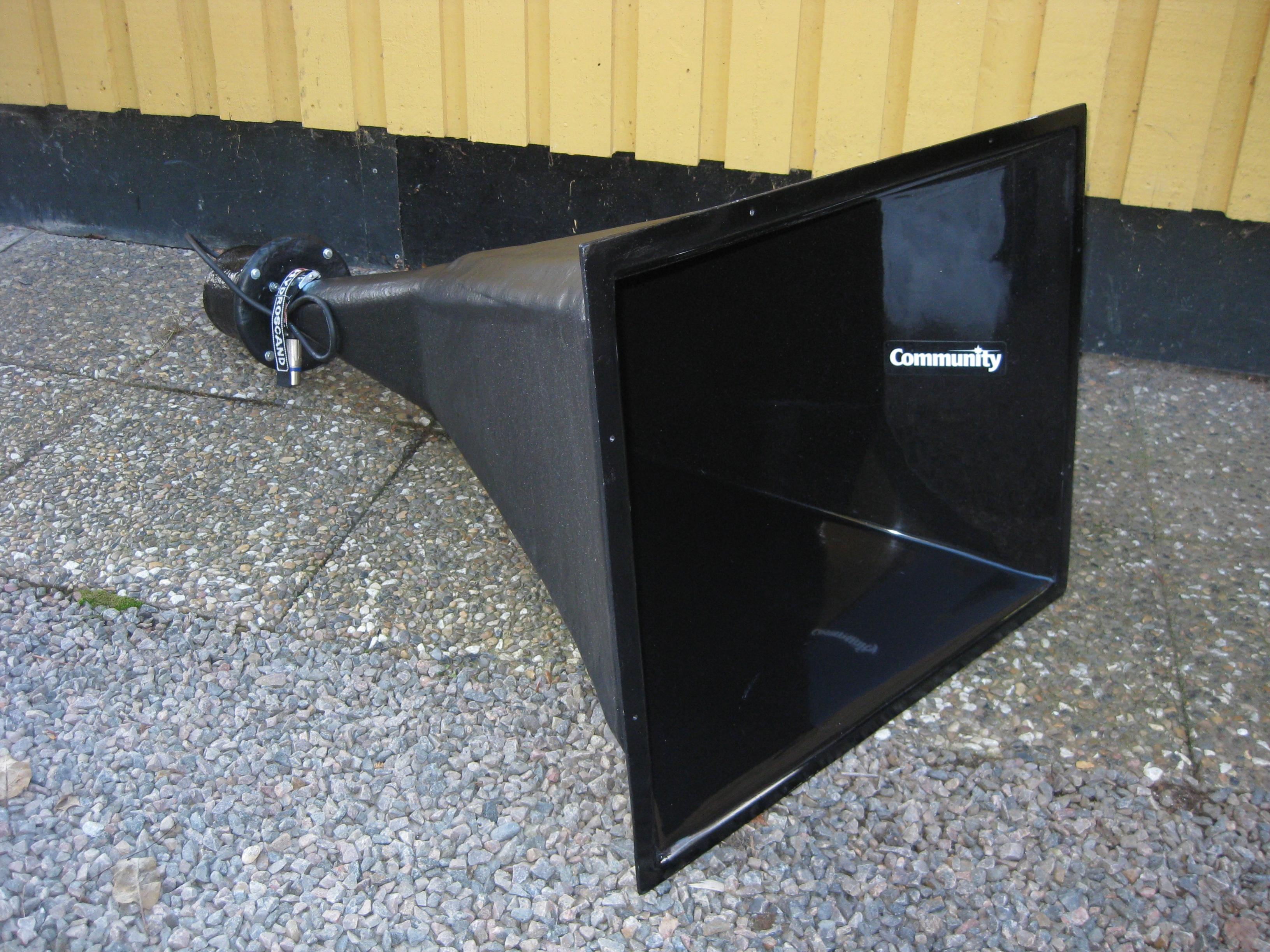

JLOP, you're welcome.
The PC194 is not a unique horn design per se. Apart from some details these are similar to other large format diffraction horns, as far as the overall horn contour is concerned.
I probably wouldn't use the longer Community horns at home, but I find the shorter "soft diffraction" horns very interesting.
Images 1-3: PC294, 2" exit brother of the PC194 is shown
Images 4-6: PC242.
Images 4-6: PC242.

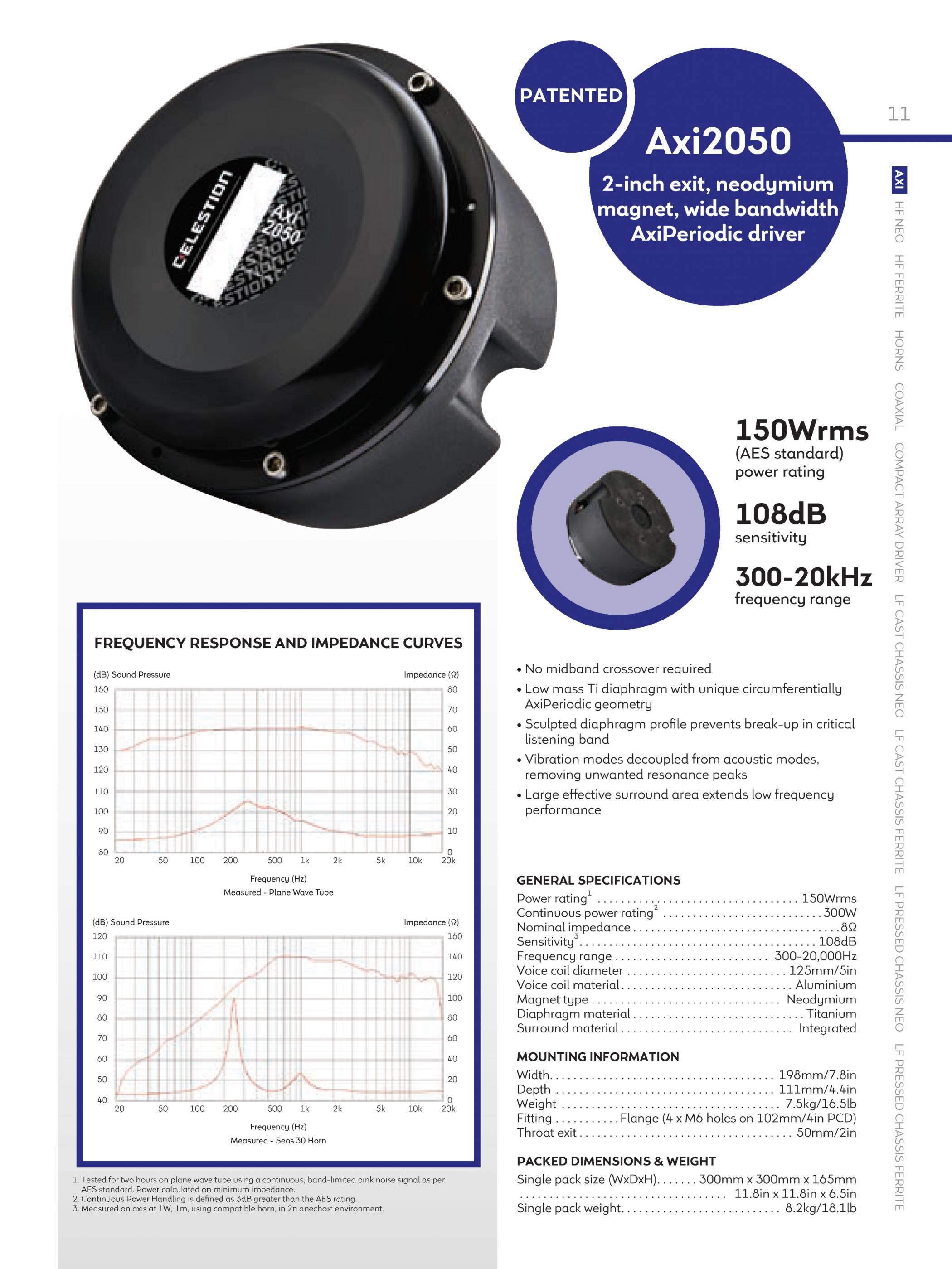

That's what makes the Axi2050 (project) unique and rather fascinating, doesn't it?
It seems the engineers improved the Axi2050's performance, since it was first introduced.
It's quite difficult to compare the curves of the Exponential and the SEOS30 without knowing the specs of the former, but if you also take the PWT into account, the top octave response/output is definitely better in the latest datasheet.
2016/17 vs 2018:
