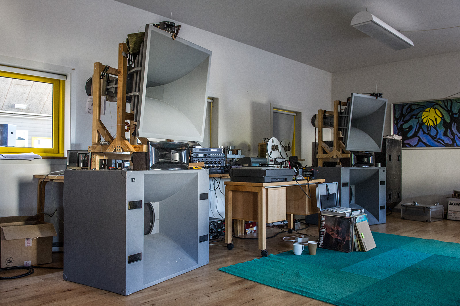

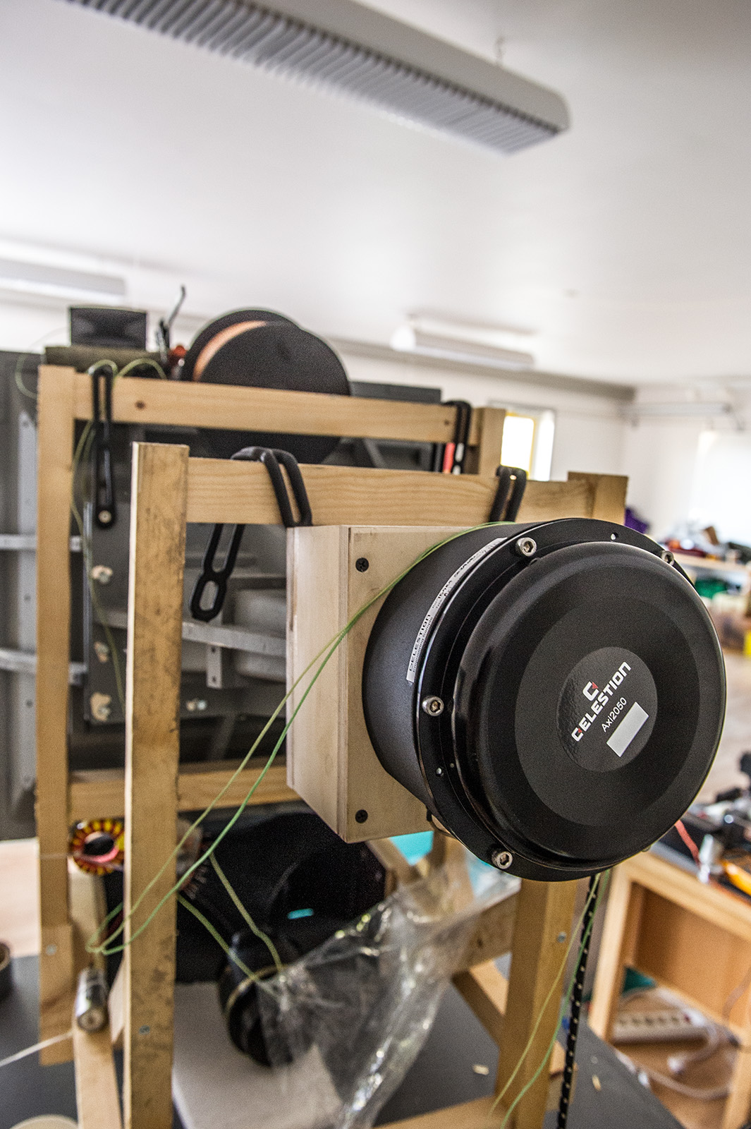

New Celestion "AxiPeriodic Driver"
The Axi2050 would do very well behind that deeeep horn.
Impedance matching "to die for".
A bit smaller: Bjørn Kolbrek's Mid Horn as demoed during ETF 2017.
This comment was posted on another forum:
"The new Celestion drivers were part of our system, and the mid horn is a design by Bjørn Kolbrek and Thomas Dunker, and has nothing to do with WE as such. The Celestion drivers are very good, much better than the (Altec)288. Bjørn Kolbrek works at Celestion, so he arranged the loan of the drivers, they went straight back to Celestion after the festival."

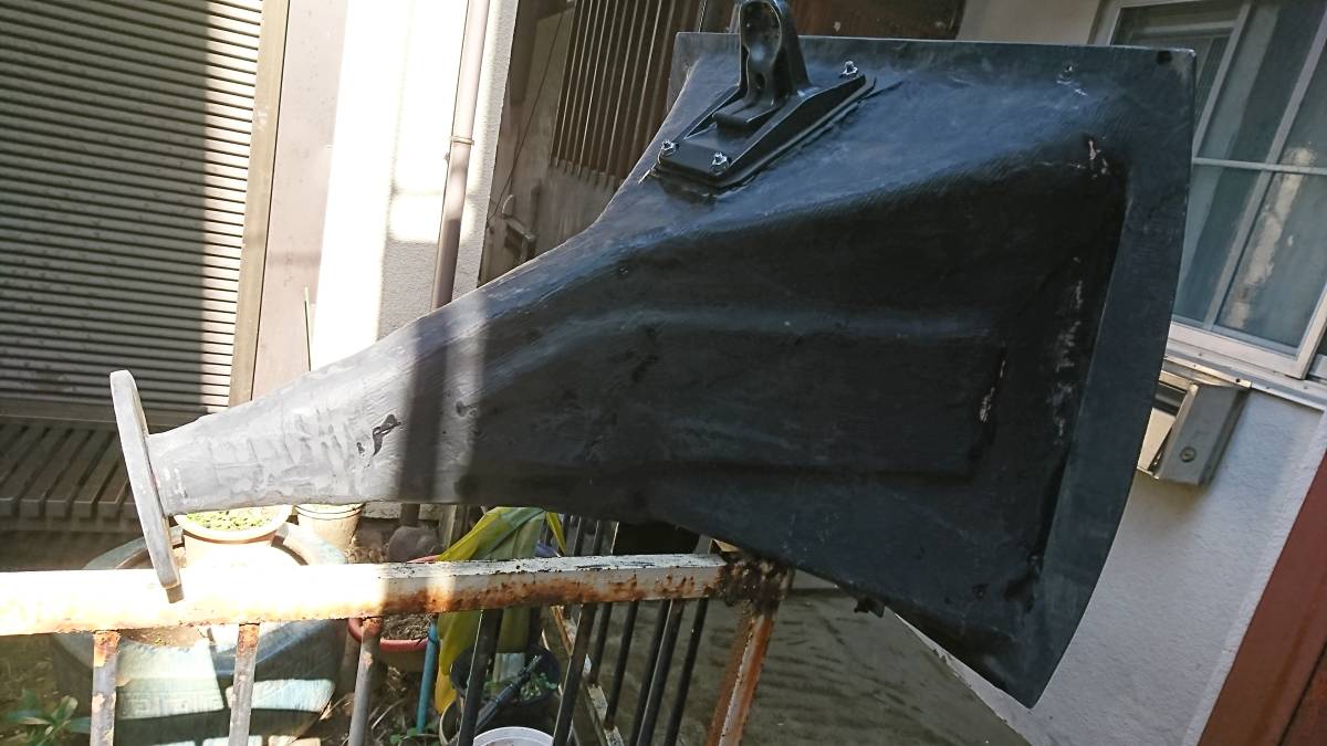

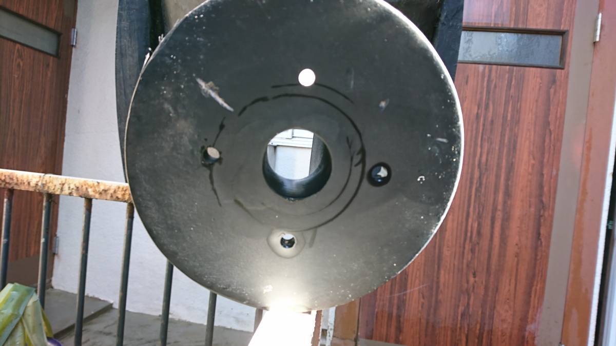

The PC194 is not a unique horn design per se. Apart from some details these are similar to other large format diffraction horns, as far as the overall horn contour is concerned.
I probably wouldn't use the longer Community horns at home, but I find the shorter "soft diffraction" horns very interesting.
Images 1-3: PC294, 2" exit brother of the PC194 is shown
Images 4-6: PC242.

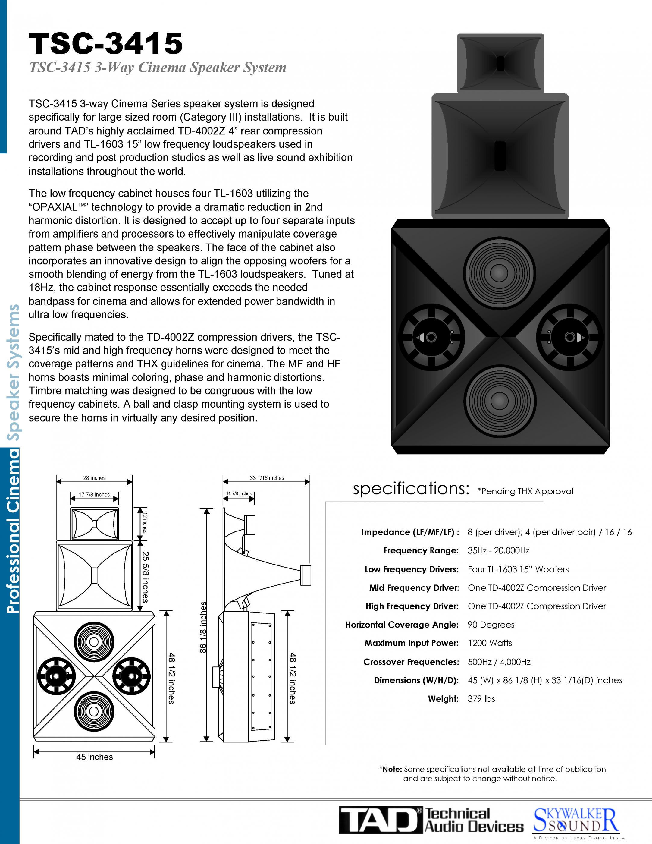

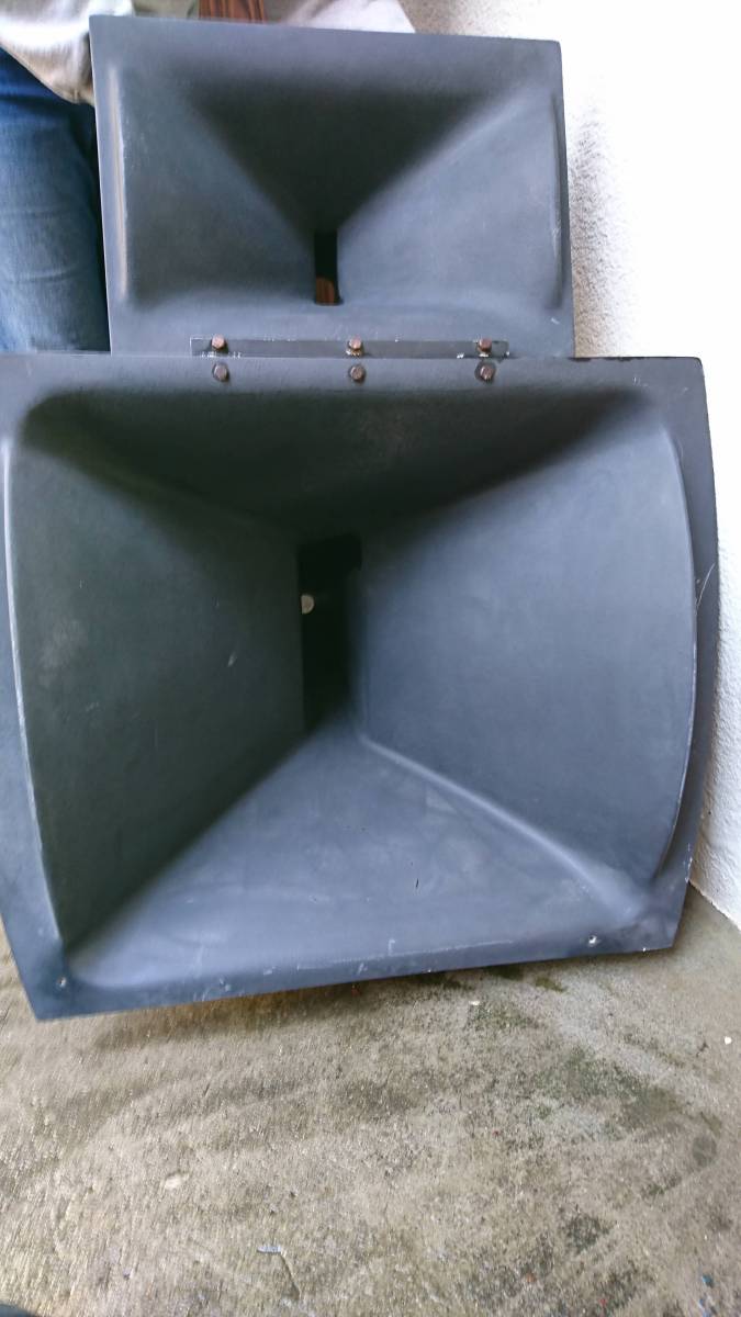

Once you've made a drawing you should be able to simulate it in HornResp.
There's a dedicated HornResp thread and David McBean is a very helpful and knowledgeable person.
If you have to make large diffraction horns you'll probably want to clone (and possibly modify) the best of its kind.
These THX horns were made to order by Community for TAD around the year 2000.
Still of the "hard diffraction" type, but the slot is obviously less constricted (wider) compared to the other TAD labeled Community PC 294, a few pages back. You can see the entire entrance from the front and there's some smoothing between the walls.

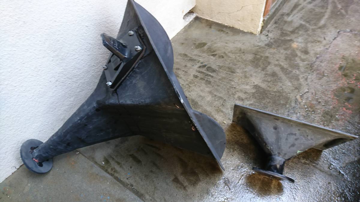

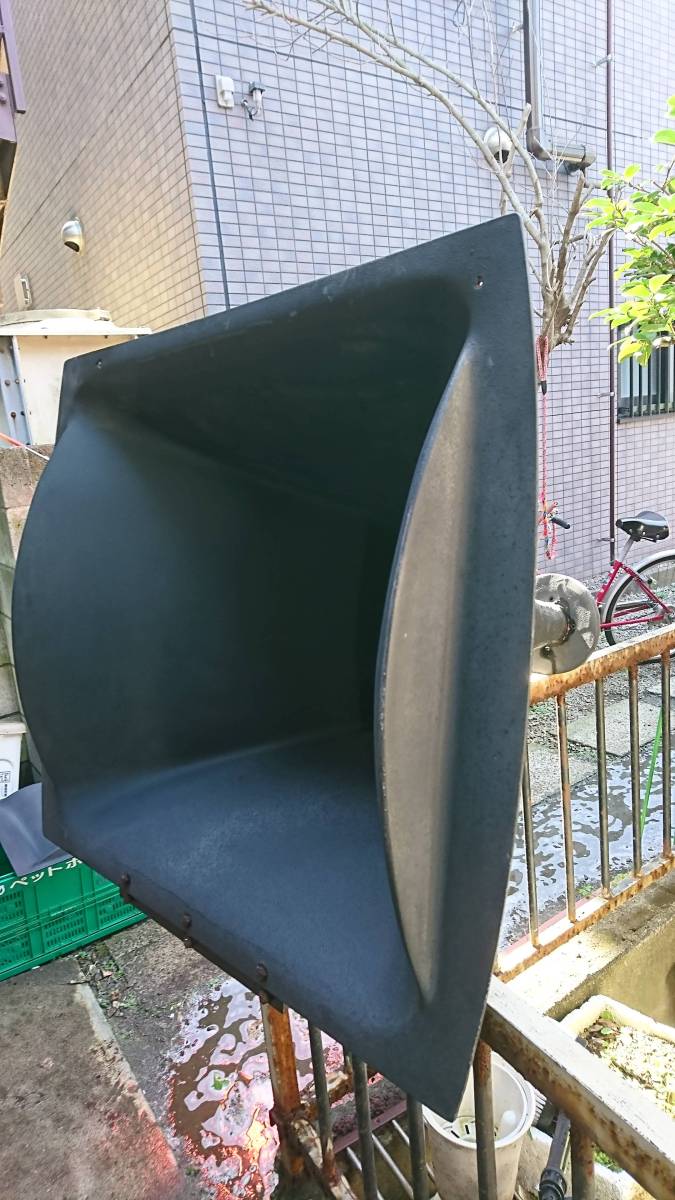

No, even though the edges at the lips look similar.
I found this horn in een shop somewhere in South America. Argentina or Brasil I believe.
This is probably a locally produced horn, because a large wholesaler of Chinese stuff didn't recognize it.
It's very cheap, at least compared to similar sized horns on this side of the pond.

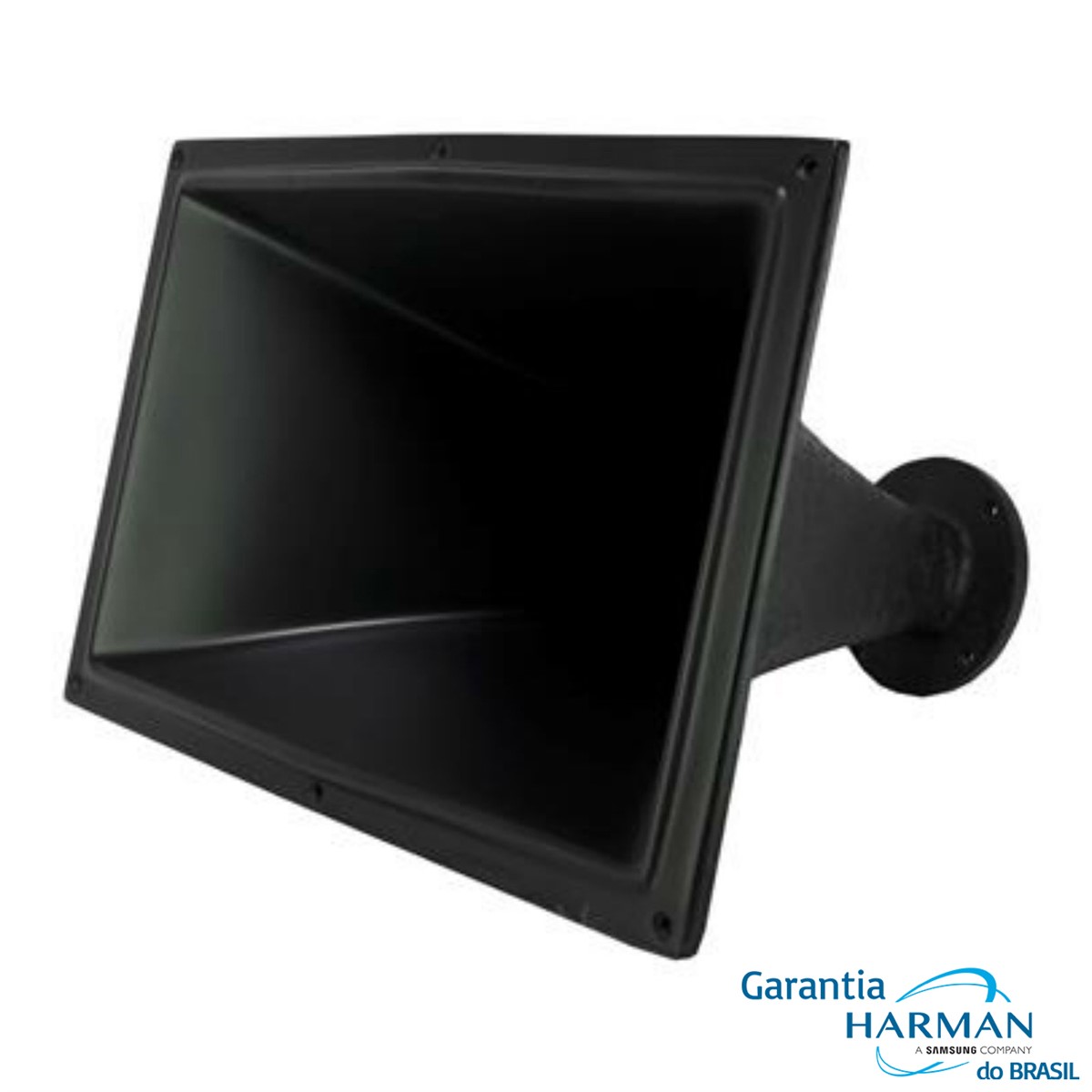

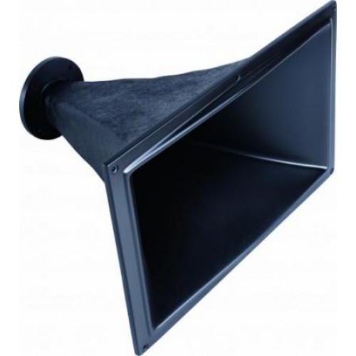

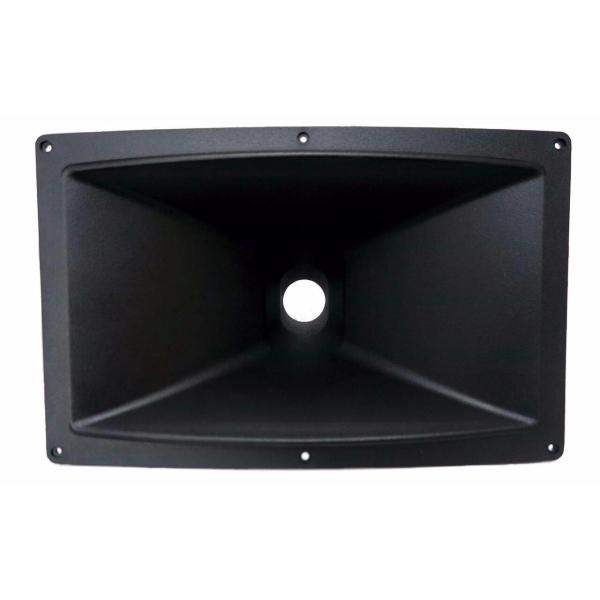

I was talking about this one.
I believe that's a plastic copy of the Selenium HL4750-SLF (which is inspired by a JBL fiberglass Bi-Radial horn).
Selenium is a defunct Brazilian speaker manuf, it was bought off by JBL Pro.
  • hl4750-spf-spec-sheet.pdf
(ABS) Clones of these are widely available in your country for much less money than the original, which is ridiculously expensive considering the build quality.

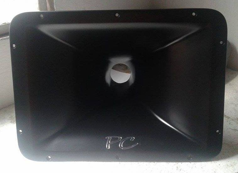

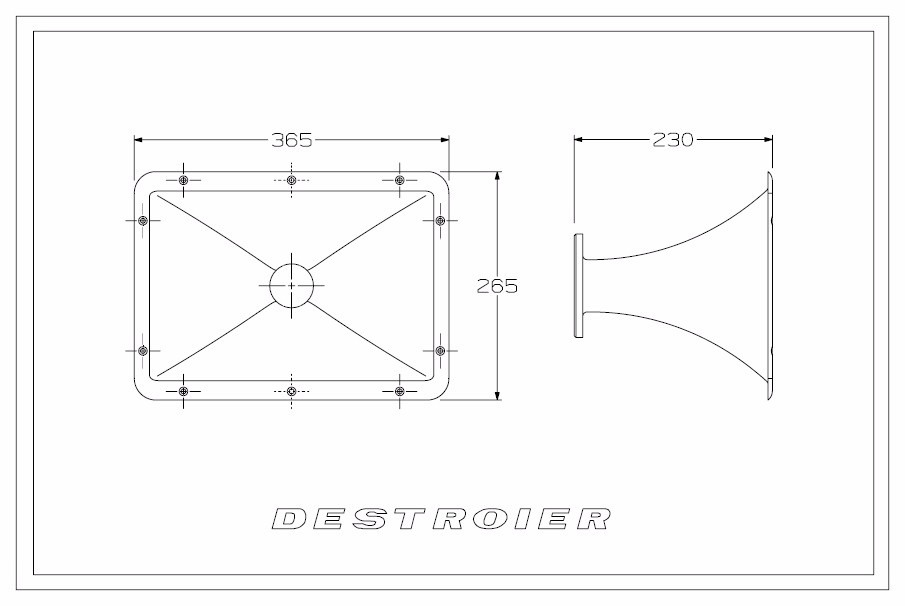

This one doesn't look bad either:
  • corneta-retangular-destroier-preta-pc-cornetas-D_NQ_NP_149601-MLB20375590605_082015-F (2).jpg

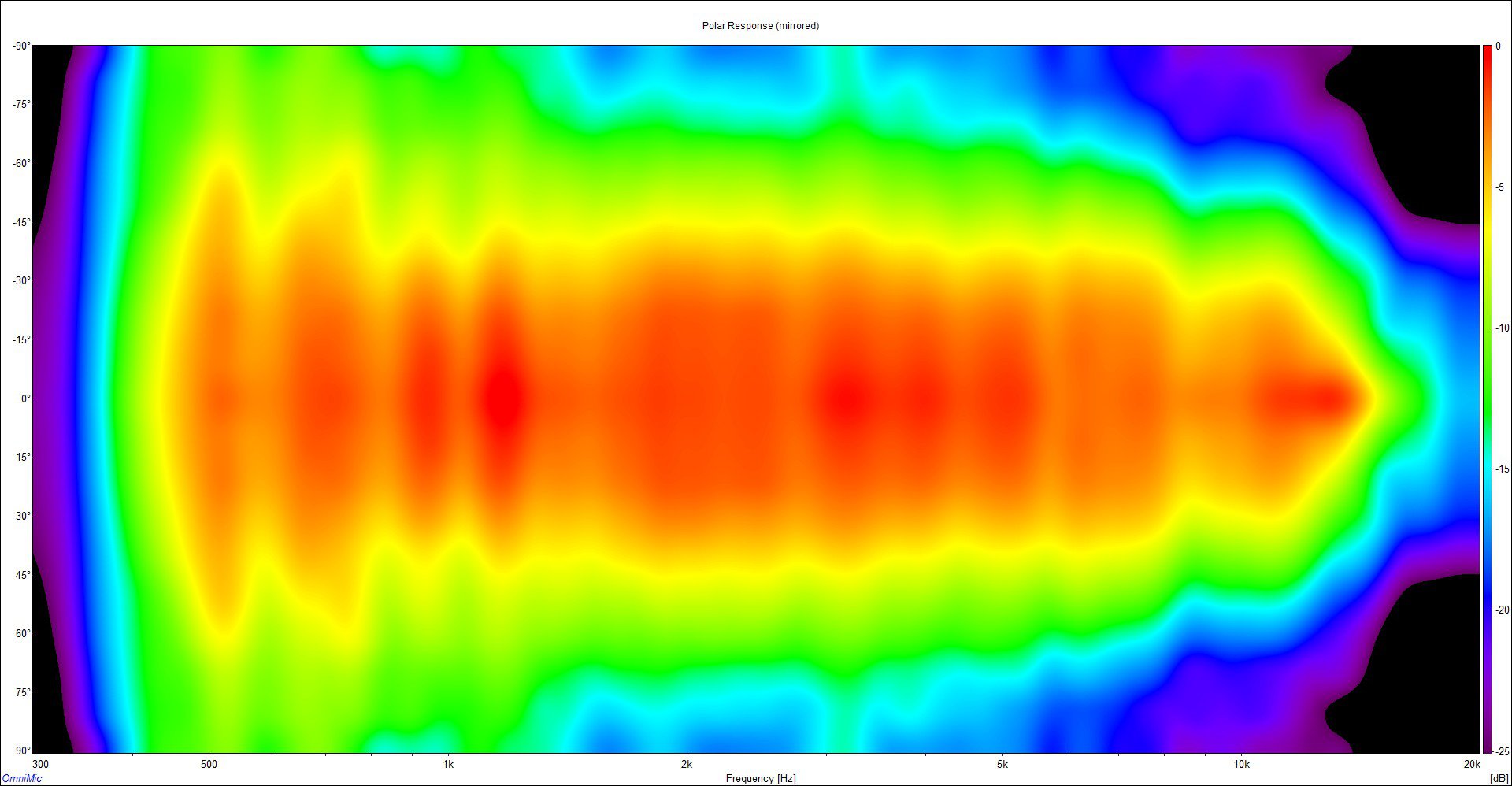

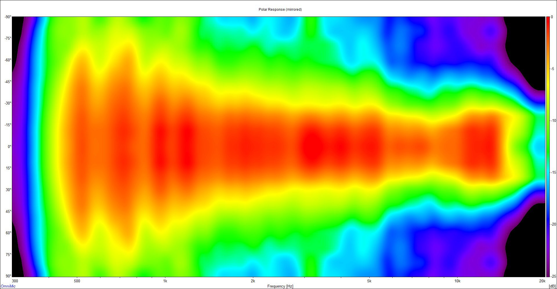

The mouth circumference of the horn with the small slot is even bigger than that of the PC horn.
90x60 degrees and a nice HxW ratio, which combined with the slot, should result in decent coverage.
Theoretically, it's polars should beat the ones below (from the ZXPC 18x10), especially in the vertical plane.
