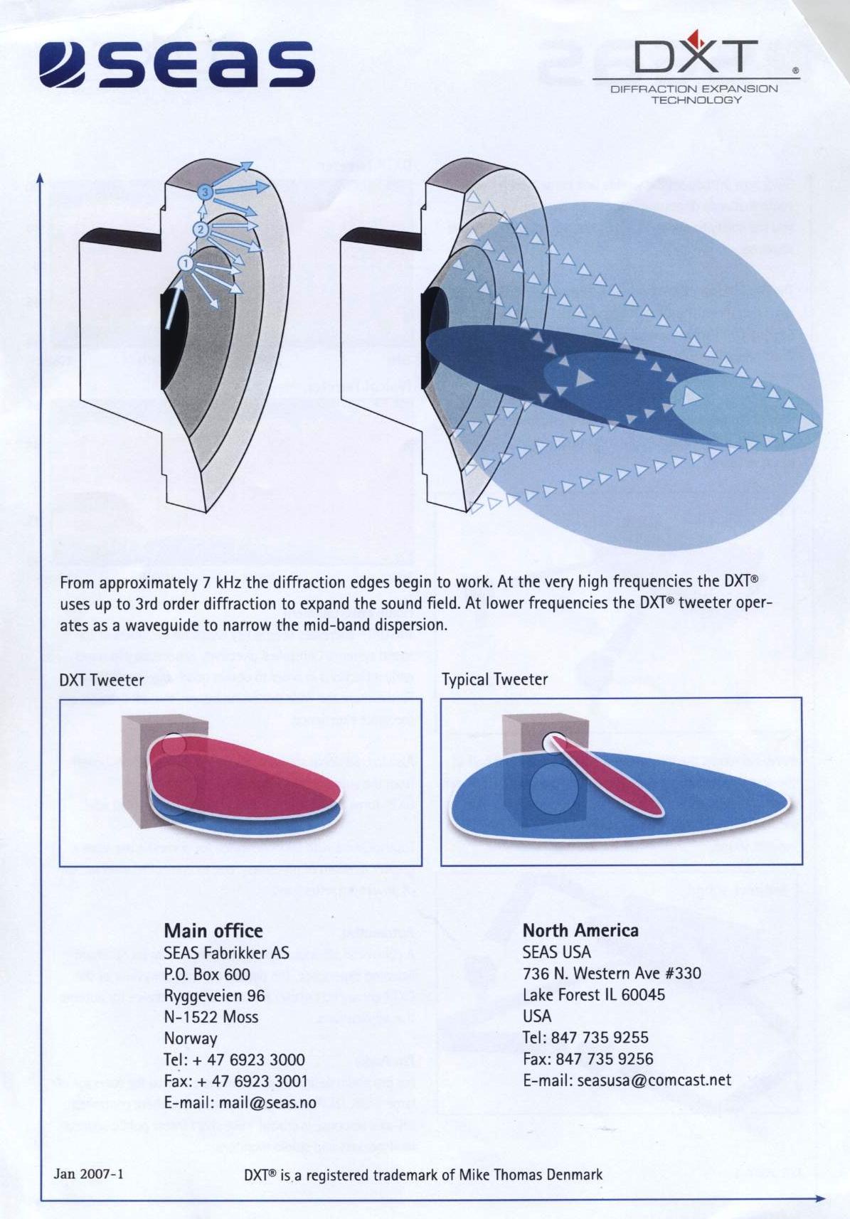

This is not what I am suggesting, but I guess your comment reflects a general observation.
I try to be extremely concise for the guy who thinks that Seas is making horns.

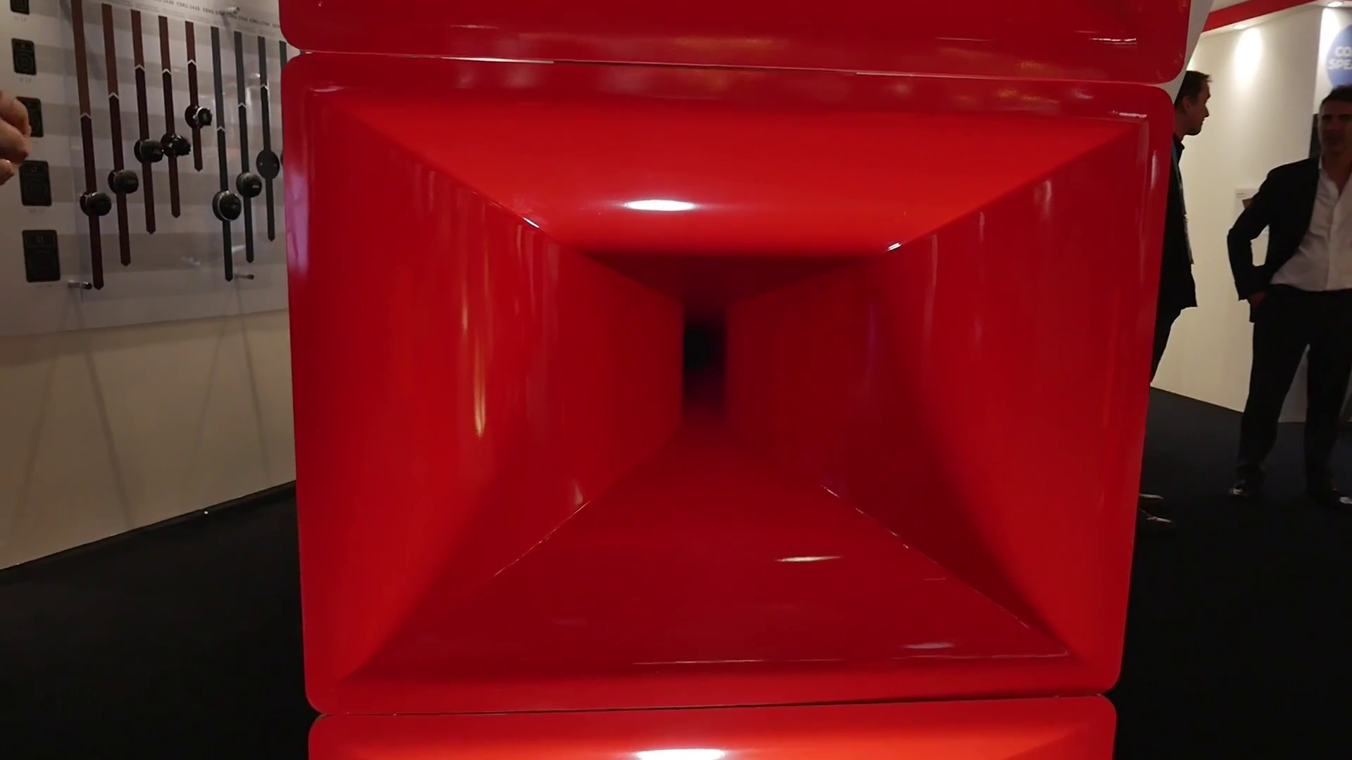

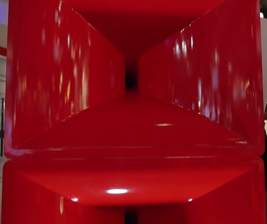

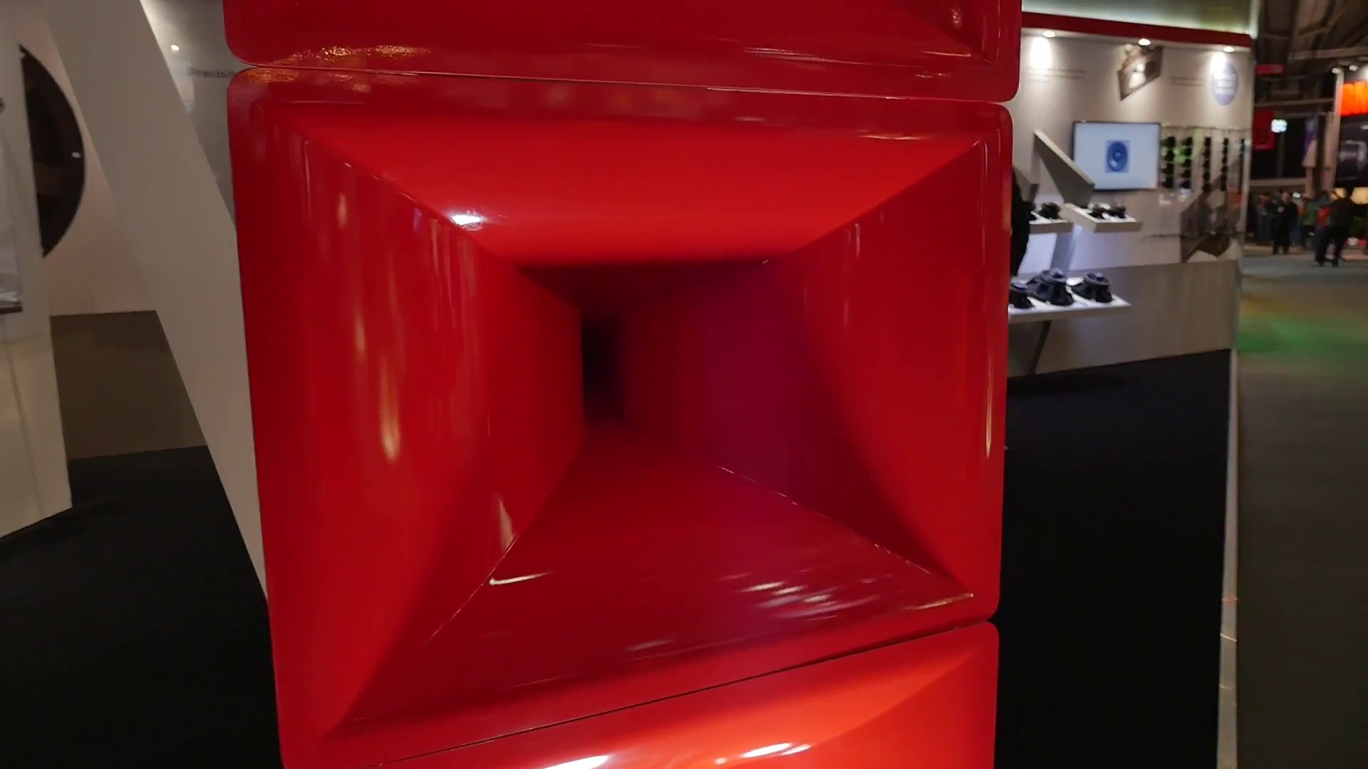

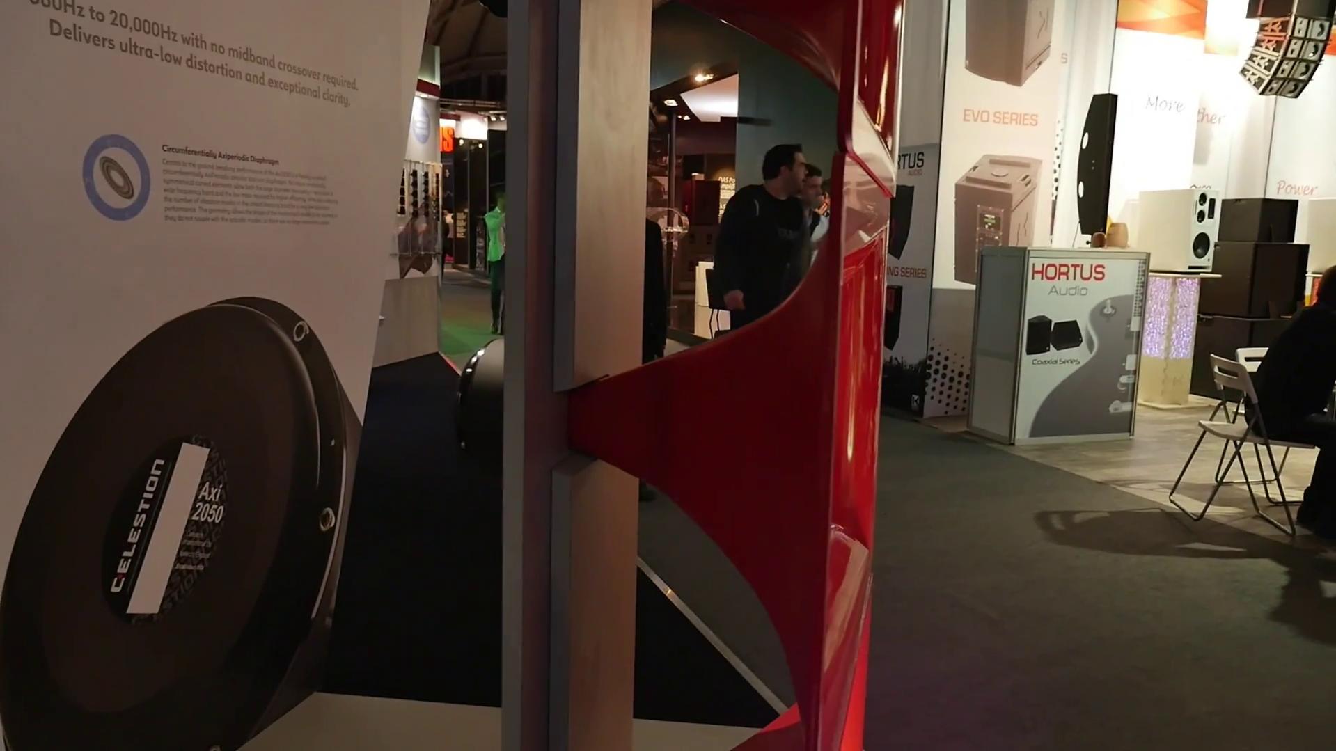

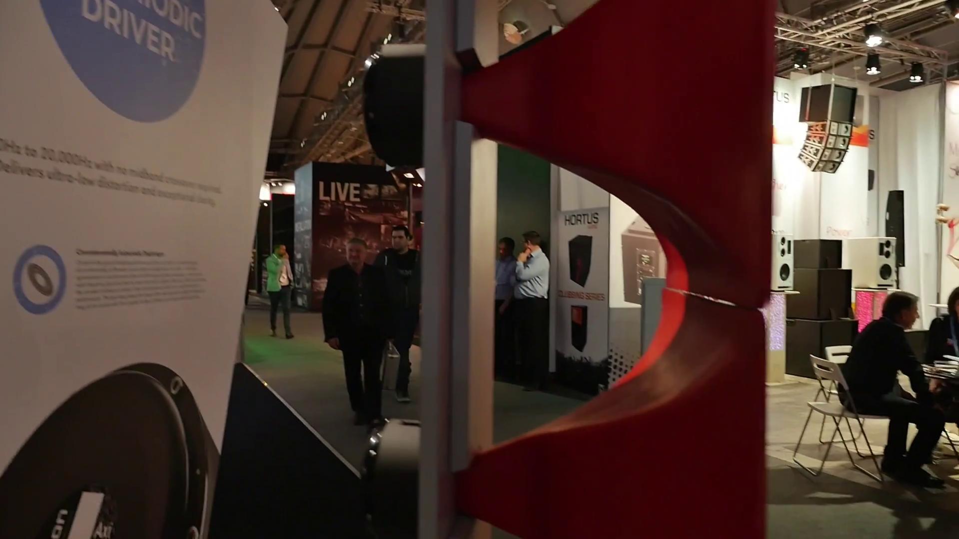

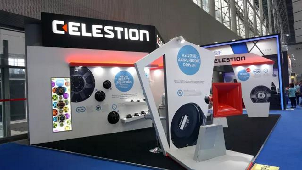

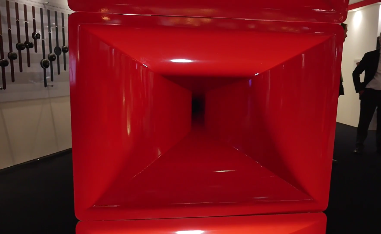

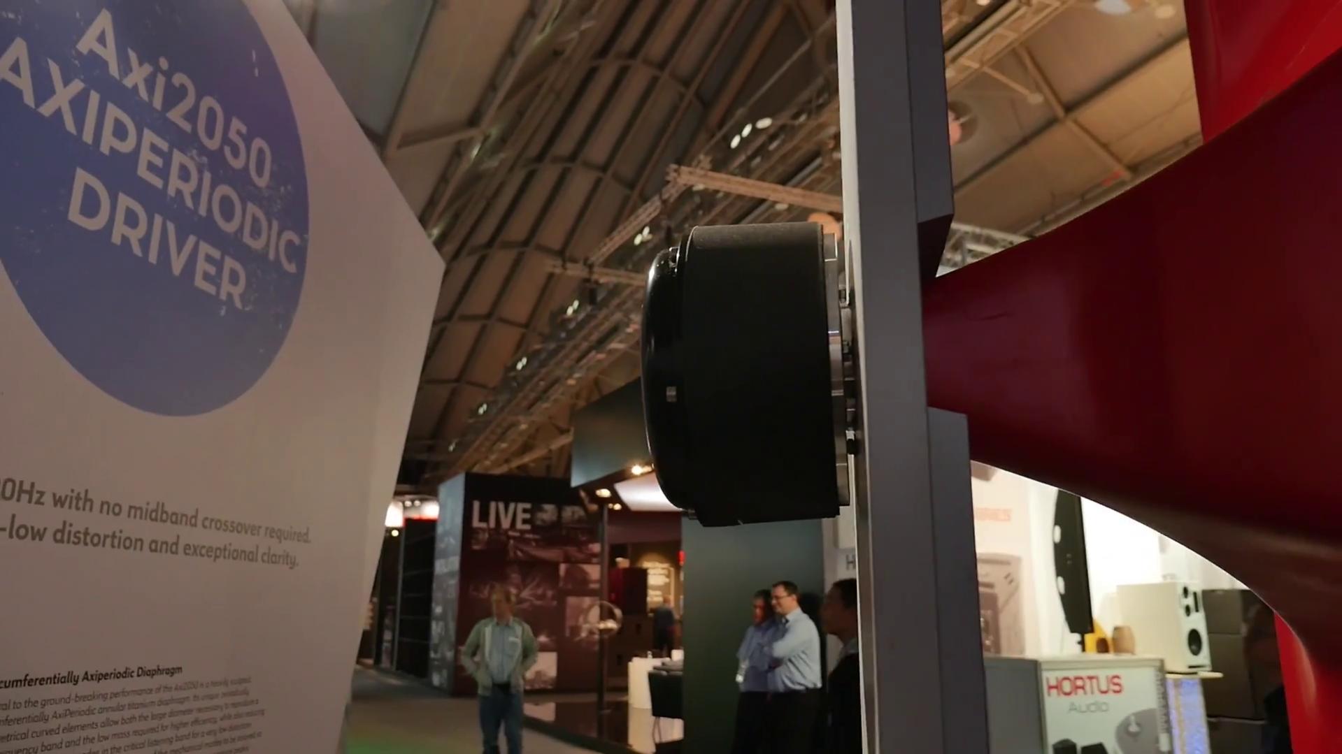

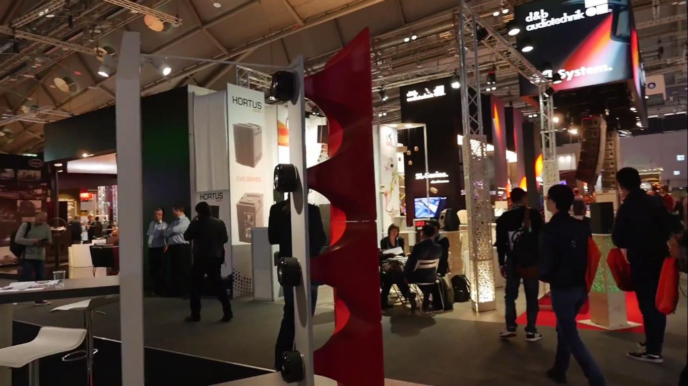

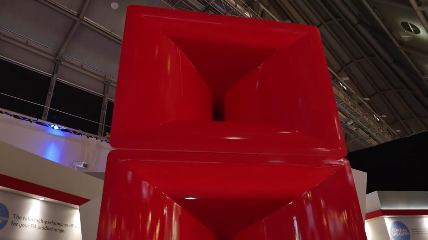

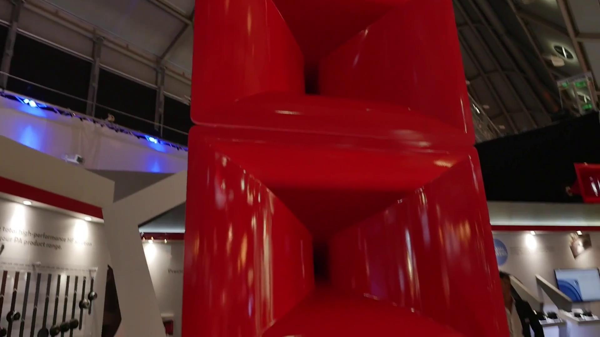

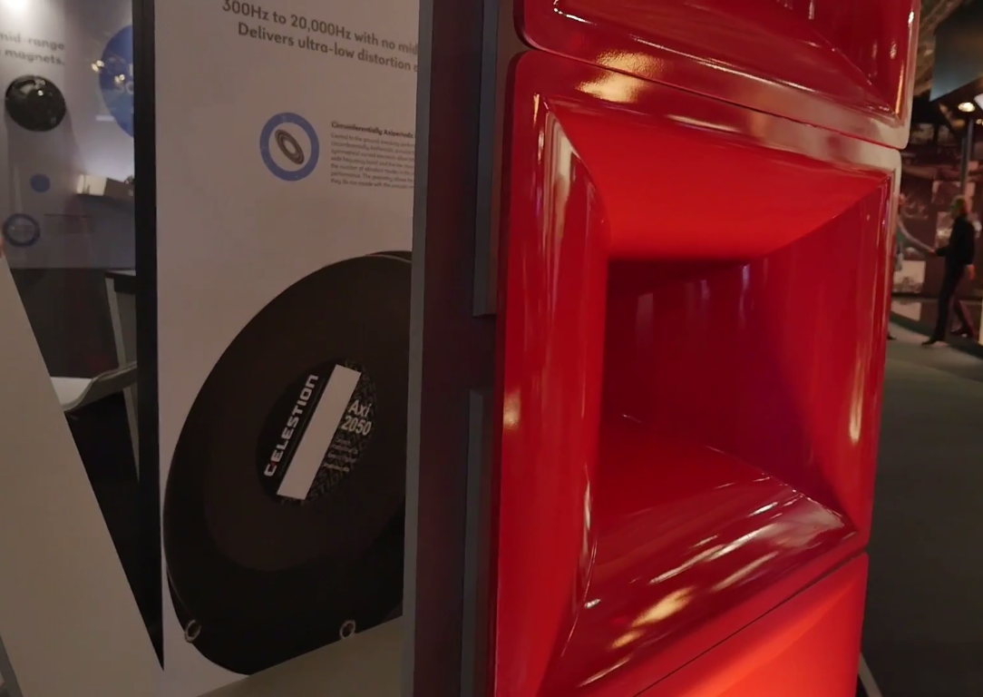

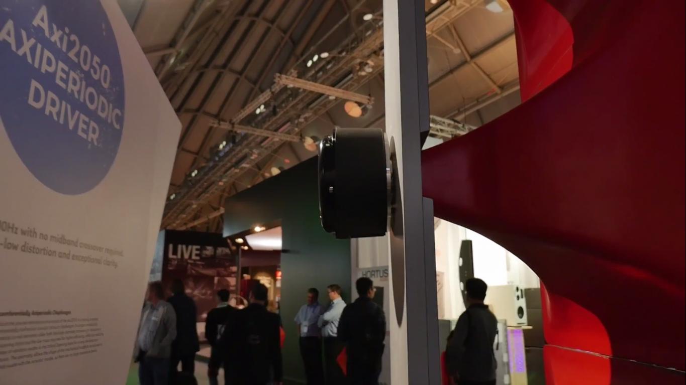

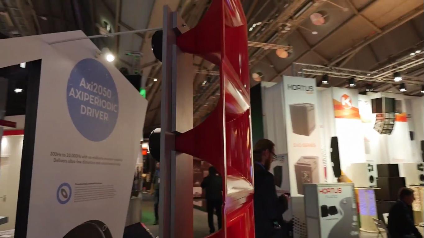

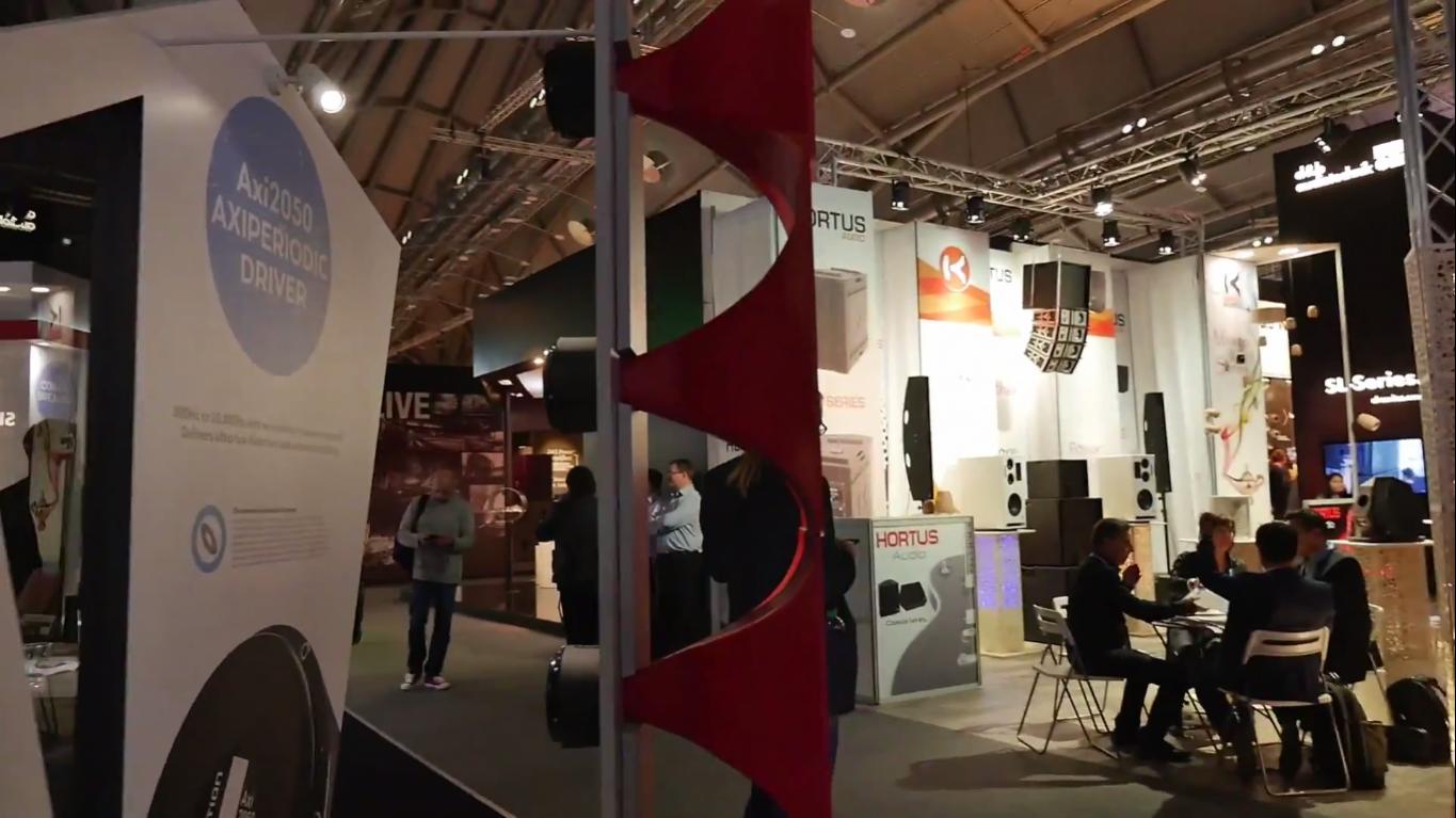

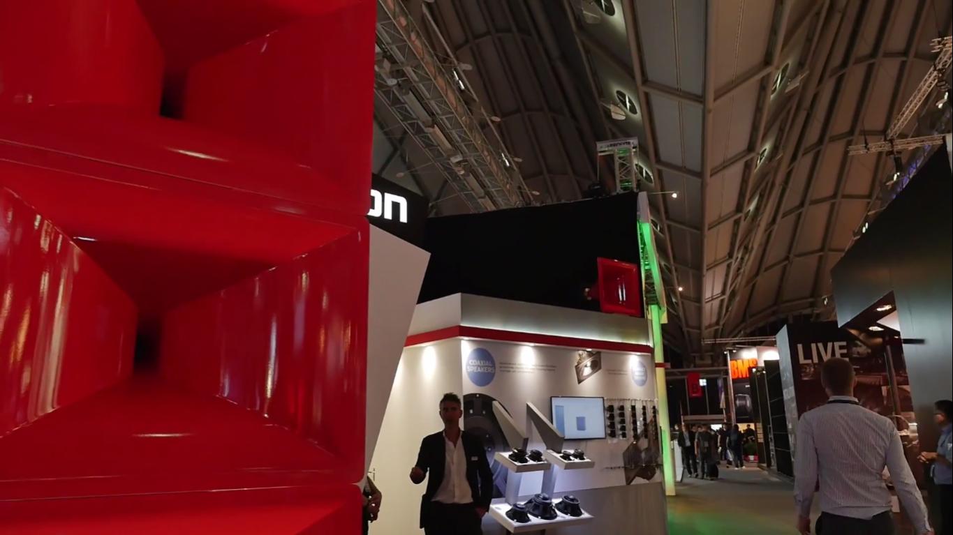

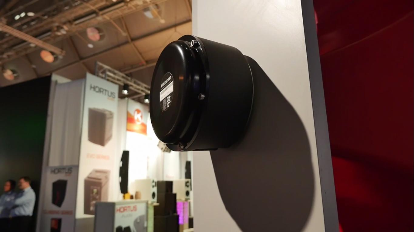

It's time to take a closer look at the Axi2050 mounted to the Big Red Horns.
It turns out Celestion designed 2 horns for the Axi2050.
The stack of horns are 90° x 45° and on top of the booth, visible on the first image below, is another with 60° x 40° coverage.
The latter horn was posted earlier (and again below).
At the time I thought this could be a K-Horn, but I don't think this is the case.
A few more in Full HD (FWIW).

Both horns are probably too small to take full advantage of the low frequency capabilities of the driver.

The square rather than rectangular horn on top of the booth is actually 80° x 60° instead of 60° x 40°, as I erroneously stated.

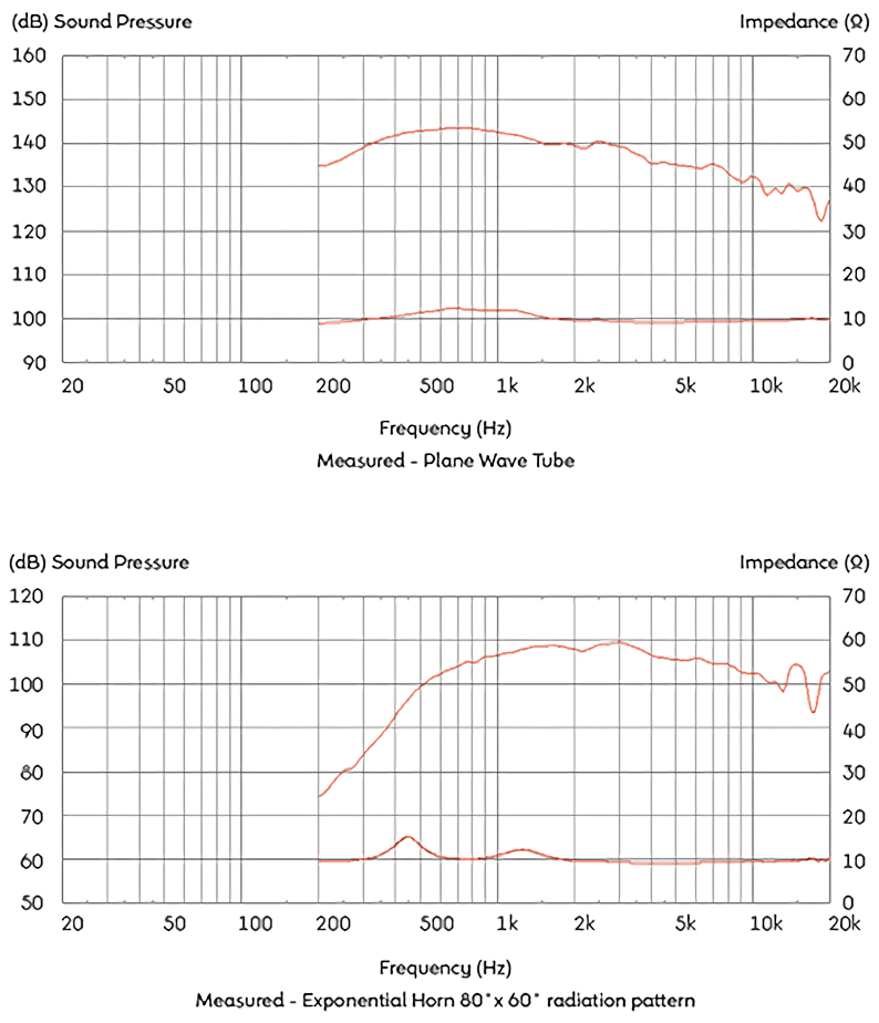

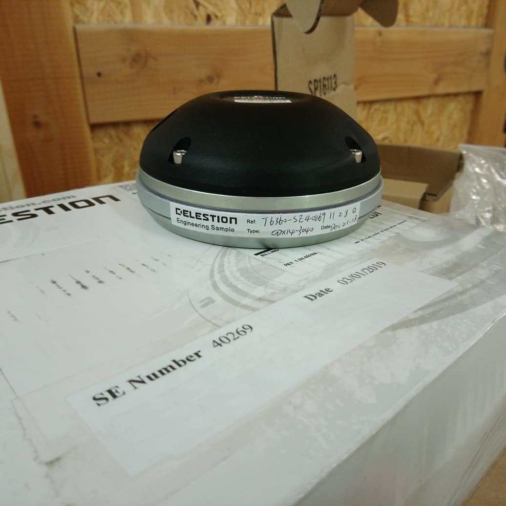

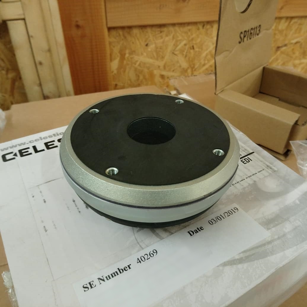

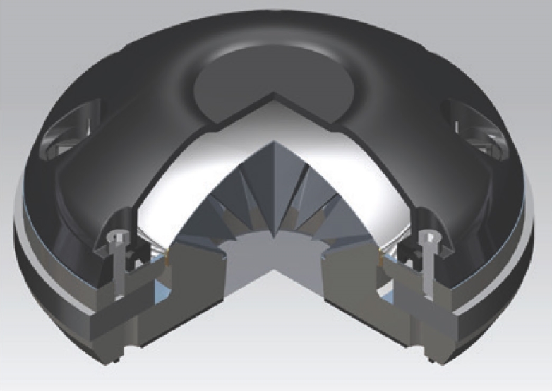

Perhaps less spectacular than the Axi2050, but at least readily available, even though Celestion states "OEM Only".
"The CDX14-3040’s diaphragm surround has a periodic geometry, which effectively eliminates circumferential modes while still allowing for linear excursion. A high-temperature polymer clamp ring is optimized for stiffness through its geometry, ensuring that the dome is always held rigid and preventing the diaphragm from bending. The diaphragm assembly is located into the magnet with a precision-cut aluminium locating ring. This is probably one of the most important parts of the driver, but so often overlooked. The locating ring ensures the coil is always held concentric to the magnet gap, as any offset of the can allow it to hit the magnet assembly. Between the cover and the clamp ring is a semi-rigid layer of a polymer similar to rubber, which spreads clamping pressure more evenly across the diaphragm assembly. This means that the diaphragm assembly is more likely to stay flat, holding the dome without allowing it to deform.
Inside the die-cast aluminium cover, acoustic damping material absorbs much of the vibration to the rear of the dome and makes the sound into behave as if the cavity is slightly bigger than it is. This enables the device to work down to a lower frequency, as the air load behind the diaphragm is often a limiting factor."
..."The CDX14-3040’s diaphragm surround has a periodic geometry".
I call these things radial ribs, but I might be missing something here.
For a hard suspension Titanium diaphragm, the breakup seems well behaved.
Evidently these are manufactures plots, but they look better than those of every other Celestion 3" diaphragm driver.
It's clean to about 13kHz and the impedance peaks are unusually low/smooth.

Interesting. Think I'd rather take a cleaner 700hz up than a duller 300hz and up solution. This is the second occasion someone has slightly preferred another driver in place of the Axi2050.
