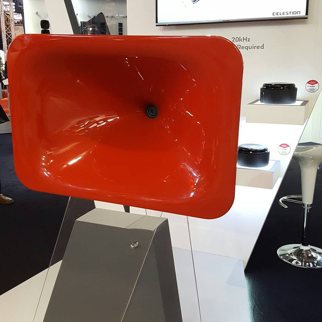

Attached is another image of the Axi2050 with the good ol' SEOS 30.
The SEOS fc is specified at 300Hz, but this may not be low enough to facilitate the low freq. capabilities of the Axi2050.
If you compare the Big Red Horn to the SEOS, some interesting differences can be observed:
- The "soft diffraction slot" in the Red Horn
- A relatively short "mid-section"
- A huge mouth flare compared to the SEOS.
The latter may be designed (presumably by using FEA, BERIM and other mathematical tools) according to the principle of "End Correction".

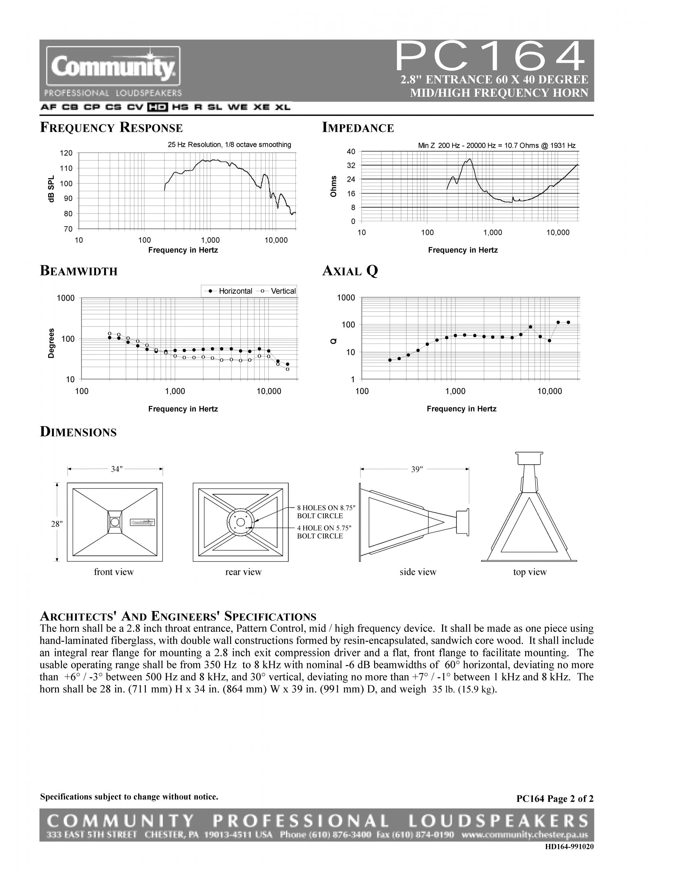

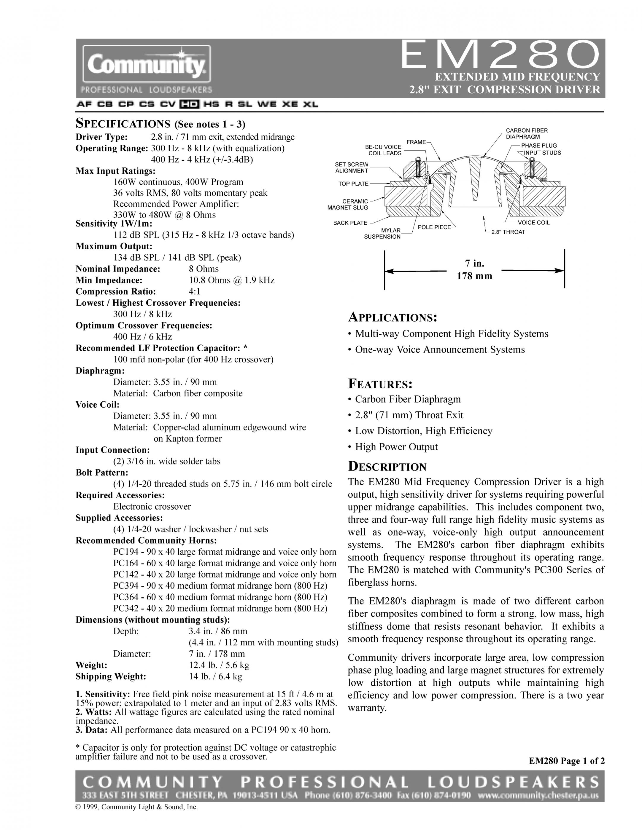

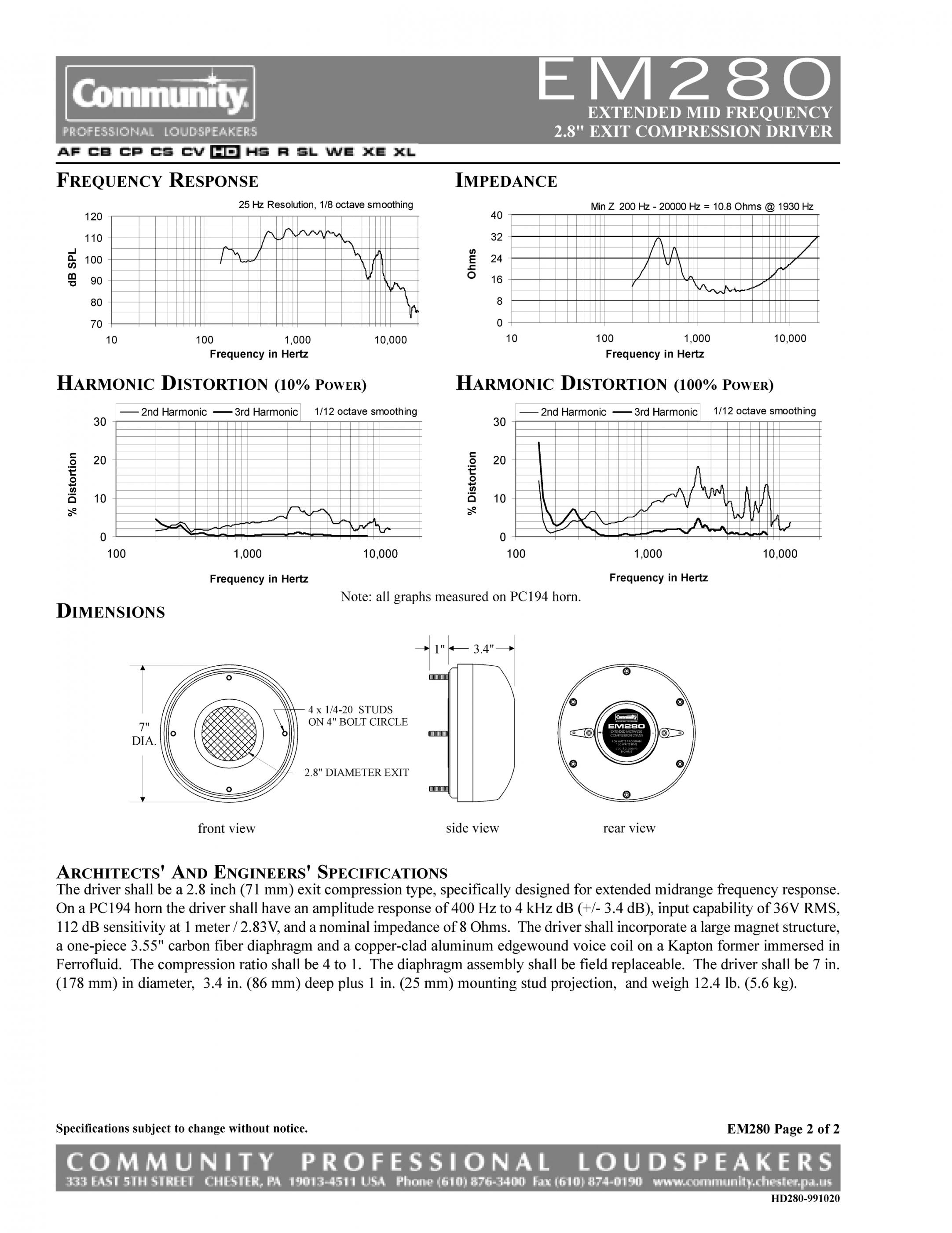

4" exit driver, Community M4:
These drivers are 229mm of deepness, it seems that the compacity haven't been considered by the designers.4" exit driver, Community M4:
This is the size of a tractrix 380, or a tracrix 400 plus a compact neo driver.
It seems not to be gold plated exotic wooden expensive audiophile garbage, the phase plug of the M4 driver is very resembling to the Axidriver.Community drivers and horns were way ahead of their time with respect to sound quality.

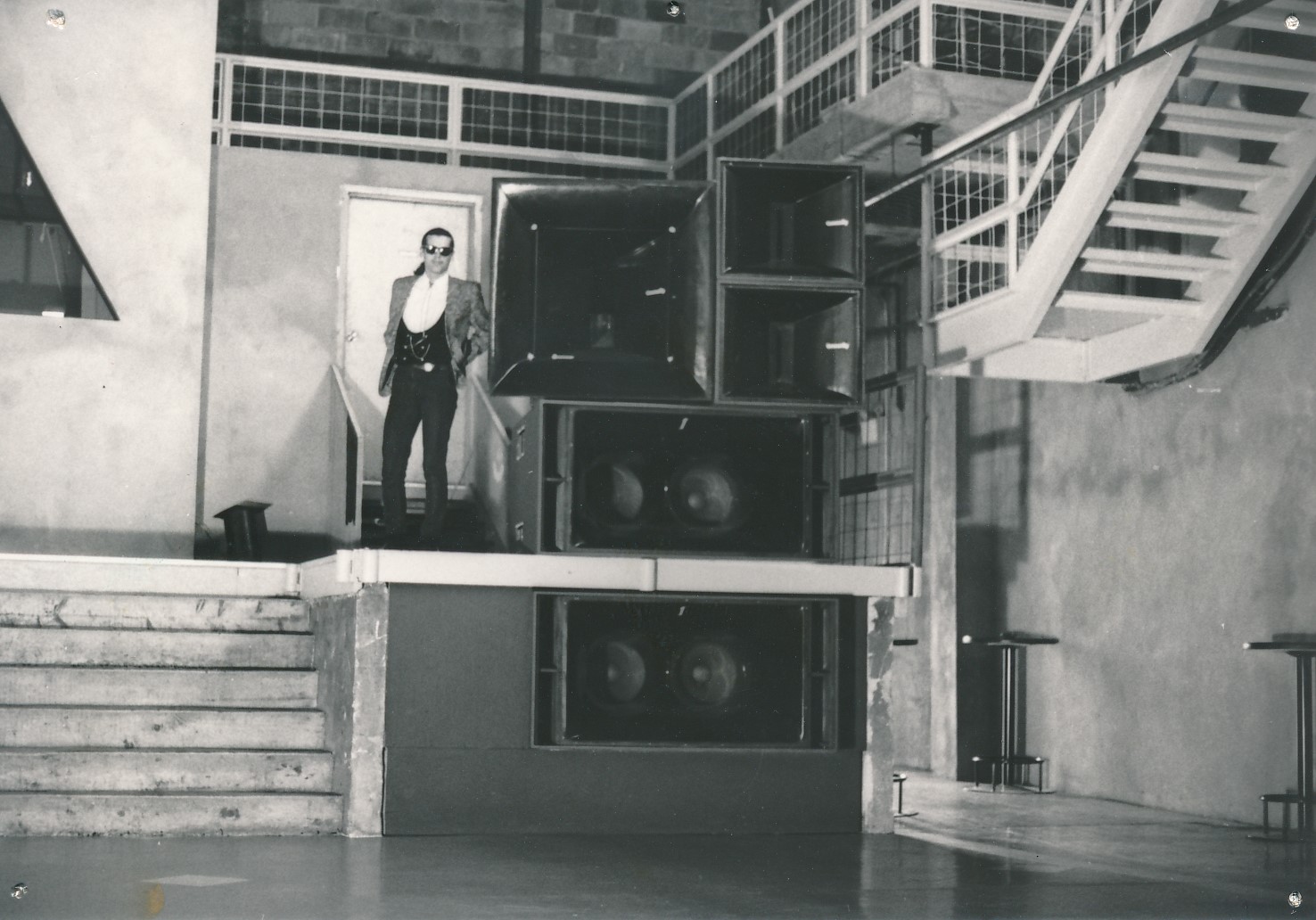

Not me, but the owner of a club in Vancouver in the mid 80's. Not my install, but some buddies. The HF units had two compression drivers each to keep up with the single M4. Best medium size club sound I have heard to date. Vocals crystal clear no matter where you were in the club. Cranking it up for fun would have your eyes involuntary blink with the crack on the snare drum and kick drum you in the chest with those boxer bass bins. Great fun!
