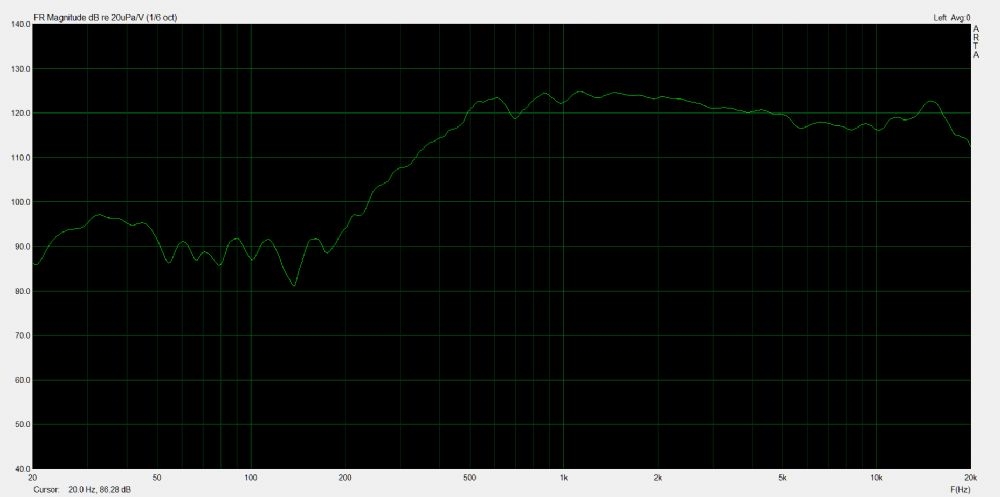

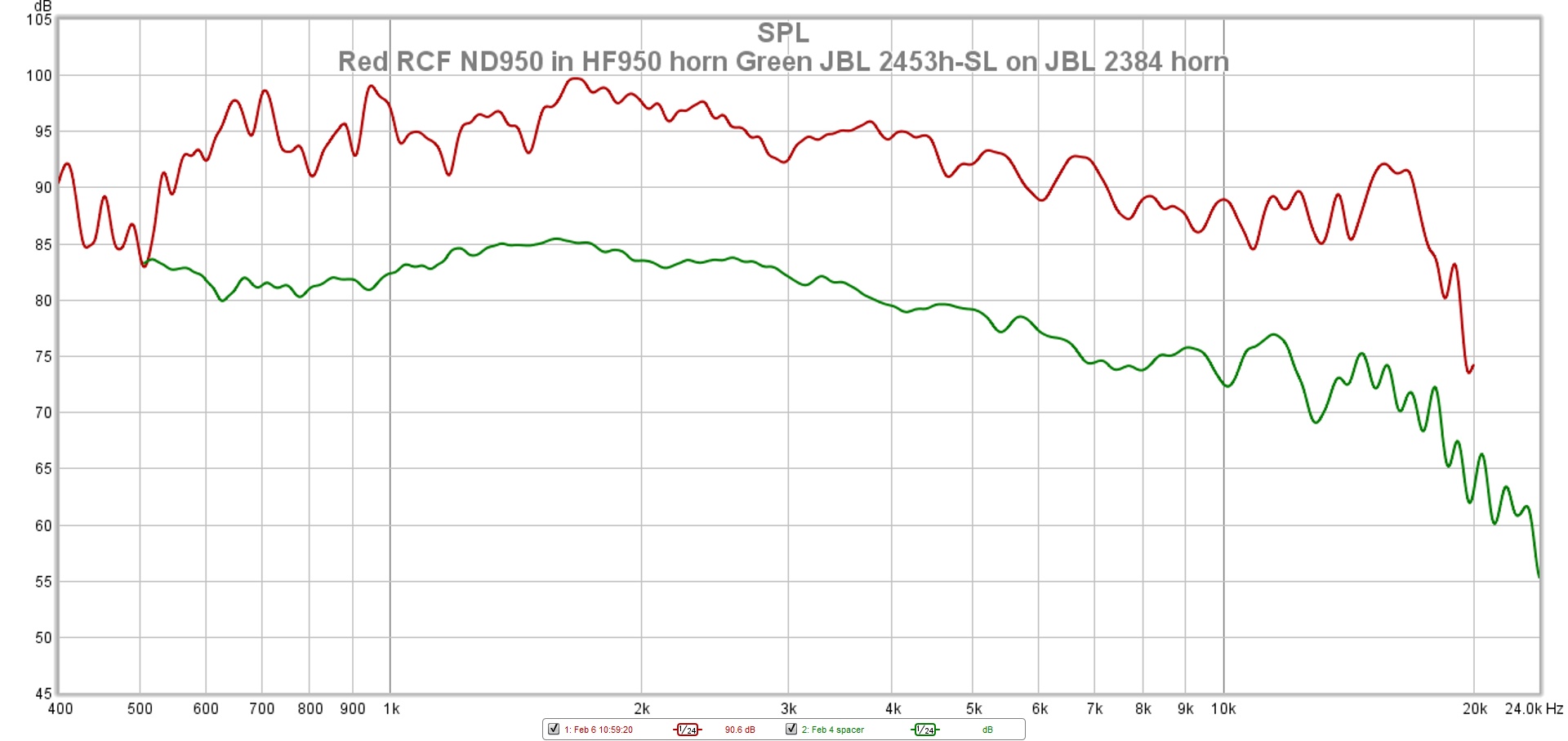

Thanks Chebum for your mdat. Here is an overlay 1/24 oct smoothing. I can't remember if my measurement was at 1m or horn mouth...
attachment.php
The JBL 2453h-SL is Ti aquaplased but still rings. It is not the best match for the JBL 2384 waveguide, even with a 1/2" spacer some anomaly exists at 12 kHz. I tried correcting it with DSP, but it made it worse (harsher sound). So I use DSP for digital XO and constant directivity eq and leave the top octave alone. Edit. the graph above is with no eq.
I am interested in finding the best horn CD combo from around 600 Hz on up...Cool thread.

compare that with the earlier posted results for the RCF ND950 2.0:
735973d1550005605-celestion-axiperiodic-driver-rcf_950_raw-response-custom-60x40-horn-eq-hpf-jpg
I'm seeing HF output only 10dB below peak and no high Q peaks caused by breakup.

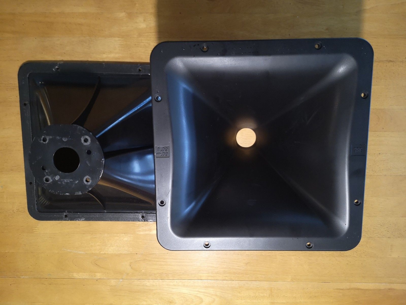

It's a well-known fact, serious breakup cannot be EQ-ed.
A mismatch near the throat, or even before the throat (exit > horn entrance) is often cause for "issues" around and beyond 10kHz.
Have you ever tried (some) PT horns, like these?:
