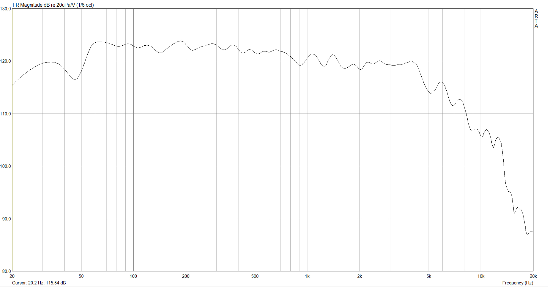

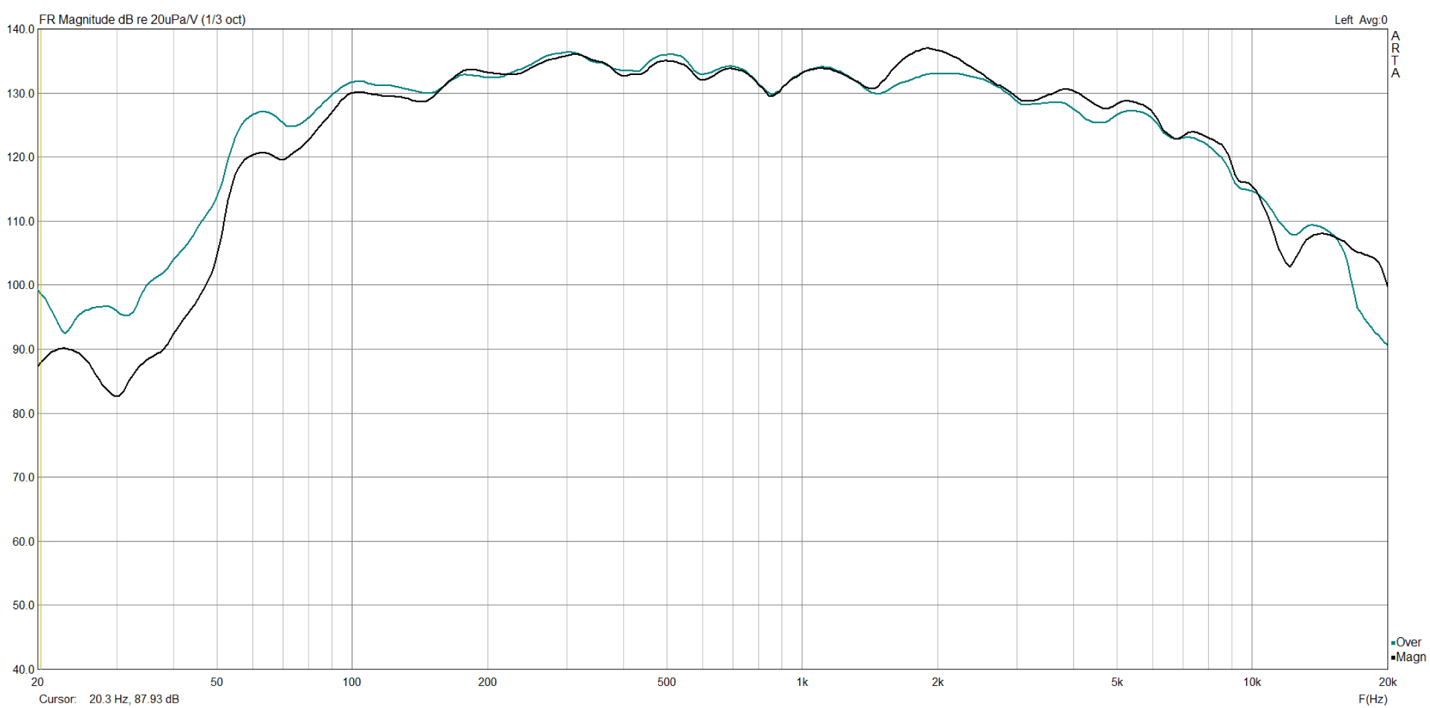

And some plots:
1. Frequency response coupled to a 25.4 mm (1 in) diameter terminated plane wave tube (PWT)
2. LAMAR M1-8 (Blue Line) vs. WE 555 REPLICA (Black Line)
Measurement with 1W input on rated impedance @ 1m distance on axis coupled to a WE15A horn.
  • Frequency response of Model M1-8 Driver coupled to a 25.4 mm (1 in) diameter terminated plane wa.jpg
  • Graph-Measurement-on-WE15A-Horn_LAMAR AUDIO M1-8 (Blue Line) WE 555 REPLICA (Black Line) Measure.jpg
