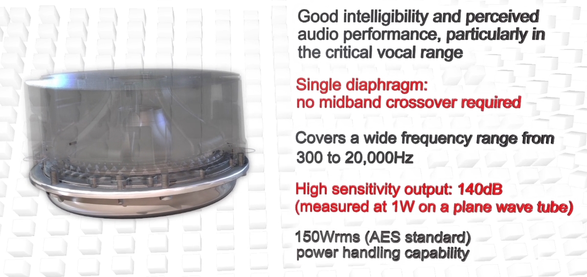

What interests me, is celestion say it needs no Xover ! Of course it's not a piezo, so what's going on ?
Not exactly. What the spec sheet says is:
No midrange crossover required, leading to improved performance across the crucial vocal audio band, for superb intelligibility
Meaning you don't need to pass from one driver to another in the 1-3kHz range, which is true, but you still very much need a high-pass filter, and probably some EQ work as well to get the top octave to behave.

This driver is meant for pro audio purposes, it's power rating is impressive and it's very sensitive, so enough. Judging from the curves, it does have potential for a 2-way, not for 50.000 Hz fetishists though. Looking forward to the first M2 killer, based on this driver in a big WG + 18" 😀

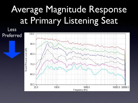

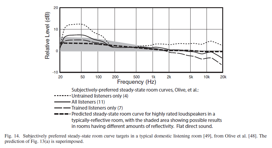

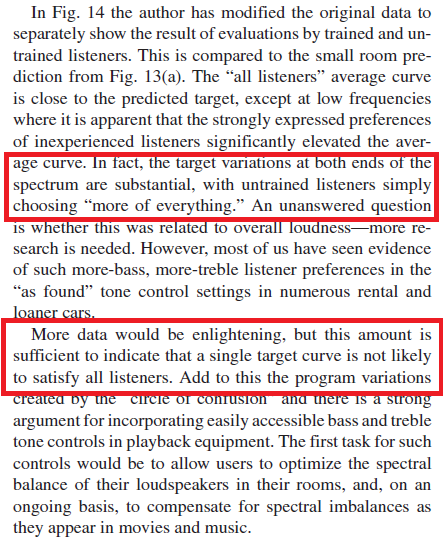

That's what crossed my mind. This driver appears to constitute serious potential for domestic use. I very much like the idea of 1 driver with 1 diaphragm covering 300Hz and up, but who doesn't?
I guess, you're right about the amount of padding and EQ needed, especially considering some research in the field of "preferred room curves".
I wonder if Celestion woud entertain the idea of a group buy for the diy crowd. Maybe get the AVS forum in on this for a wider audience.
You have to admit, that's mainly a problem because there are no horns which can provide a linear response over a that huge frequency range, independently from the driver. Just simulate a few such wide band horns with a theoretical, ideal drivers, they all dive more or less at the top and/or narrow down in dispersion. There are only very, very rare cases a driver/horn combination doesn't need any EQing. Most of the times it's done in the crossover if it's passive or in the Controller/DSP if it's active. The BMS coax doesn't do there anything better than the Celestion Axi2050, rather the opposite, you need a lot more crossover parts and it's still not satisfying passive.

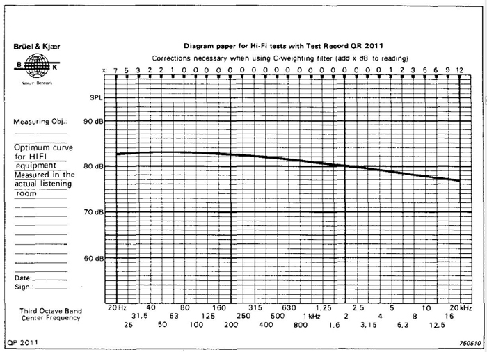

Personally I use the B&K curve exclusively.
The last Magico I heard used the B&K "bright" version. Meaning it lifted up the treble 2-3 dB. It was actually really good as a background speaker. Brought out a lot of detail without being harsh.

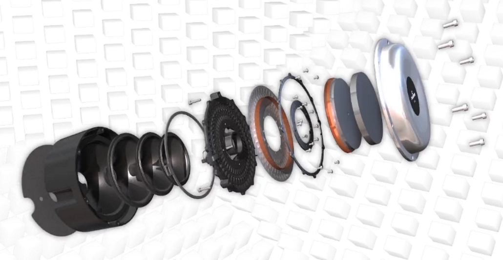

Evidently, horn size vs. loading/narrowing is and will remain a challenge for diaphragms of this size, as is mass breakup above 10Khz.

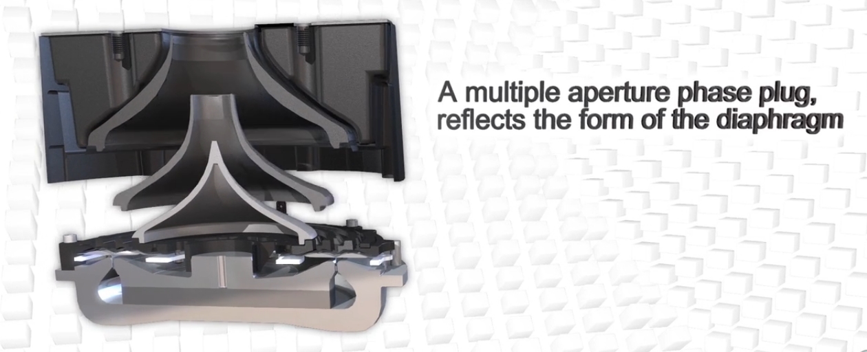

Unless you'd use a big Horn like the Klipsch K-510 (actually a large WG), the first issue needs some clever and creative engineering.

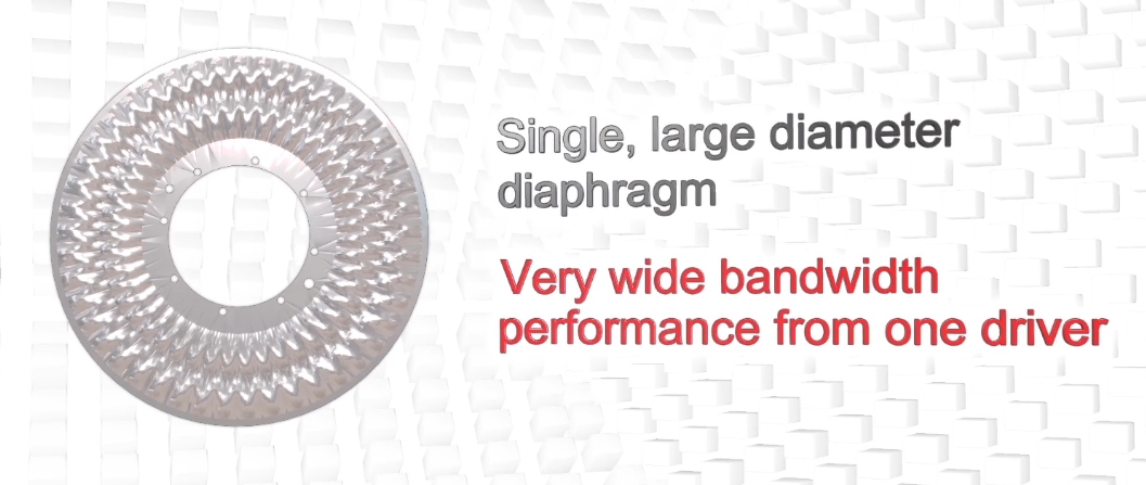

The breakup/falling response is still there, but much less so compared to the classic big guns (WE 555 and the like) due to..... indeed: clever engineering. If you look at the innards you'll notice some unique features, of which the diaphragm + suspension, the multiple aperture phase plug + waveguide are the most obvious.

Dispersion is mainly a product of phase plug, exit vs. entrance (horn/wg termination). If you manipulate a wave front properly (by FEA optimization) you could achieve remarkable results, within the constraints of physics of course.

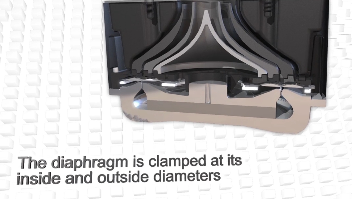

What appears to happen in the Axi 2050: the wave front is squeezed into the multiple aperture in a controlled (frequency dependent) manner and (wave)guided towards the exit. It's like an inverse 3-, or maybe 2-fold horn inside a waveguide. This can only be achieved by many hours of modeling and optimization.

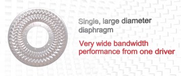

Besides, if you look at the diaphragm you'll realize this won't break up in the same way as a traditional full dome dia.
