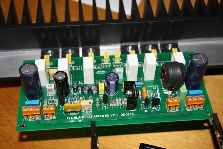

my experiments with 4 NJL diodes and 5 NJL diodes to temperature compensate the output stage bias current have proved unsuccessful.
I tried 4 diodes + resistor at 7mA and at 1.5mA, neither gave anything close to good temp comp. Always goes up with increasing temp.
I tried 5diodes + resistor @ 1.5mA. Bias Voltage far too high for a two stage EF.
Added a bypass resistor across one diode. Had to reduce this resistor so much that the 5th diode was passing <0.5mA (Vf~300mV).
Temp compensation was still poor but better than 4diodes.
I am now in the process of modifying the PCB/layout to incorporate a three stage EF with 5 NJL diodes and a series resistor.
Has anyone else managed to get good temp comp for the NJLs with either 4 or 5 NJL diodes? How did you do it? How well did it perform?

Might be time to go to a BD139 Vbe multiplier with 1K5 from collector to base, and 330R with 200R trimpot in series from bass to emitter. Fit a quality 22uF bypass cap from collector to emitter.
Mounted atop one of the outputs, this works incredibly well on all my amps.

This makes the "vaporware" NJL's quite useless , doesn't it ? The NJW's are the same die as the NJL's (minus the diode), but at 1.21 US $ , much more economical. The VBE on leads mounted atop an OP has survived the test of time and abuse for me. +- 1mv on the emitter resistors can be tolerated without unacceptable operaton or degradation of the sound quality in a standard type 2 EF.
BTW , I use 2.2k/680R (mje340) or (aksa's right on the money) 1.5k/450R with the BD's.

the four NJL diodes can be used in a Leach type VBE multiplier.
If the Diode current is made adjustable (by bypassing some of the VAS bias) then the temp comp can be dialed in.

the Vbe multiplier needs to supply a fixed voltage that matches the total of the Vbe drops of the output stage and the two Vre when the output is biased to it's operational current.
Assume for first guess that Vre = 20mV
Vbe of drivers and outputs = 600mV
total = 2.42V for a two stage EF
total 3.62V for a three stage EF (including the pre-drivers).
At low bias currents this total voltage is likely to be less, maybe even as low as 80% of that first guess.
5series NJL diodes will give ~2.0V to 2.5V. If the output stage requires <<2.42V you cannot insert a resistor to adjust the bias current.

Adding a Leach style VBE multiplier to the design that used the embedded diodes would be pretty straight forward. Is that a worthy enhancement to the circuit and layout?
Or do we wait for Phoenix to tell us all how well the current implementation works? Thoughts? Concensus??
