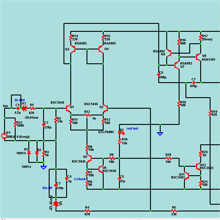

I think you are confirming that at 13.5mA to 13.7mA that the protection is affecting the signal being passed through.
I think you are also confirming that the protection transistor starts turning on much earlier than when Vbe~600mVbe.
can you monitor what the protection transistor is doing to the signal when lower values of Vbe are applied? I.e. can you see the start of turning on at lower output current?
12.5 ma is where the signal starts getting effected. The protection transistor goes from a few nA's to .1x mA's Ic. Not to go off-topic for this thread , these enhancements are quite worthy of the ULD as well (including the cap multipliers). A 4Q wilson CM is the only addition I can think to perfect this amp.
OS
what output current could be sourced with this level of VAS current?12.5 ma is where the signal starts getting effected.
12.5mA, how much passes through the 47r? What is the Vbe at turn on?

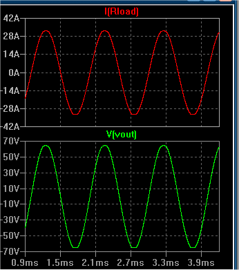

Way too much !! (below) At 2R the OPS "soft clips" (a side benefit of this technique). Without Q9 ,this topology has exhibits VERY bad clipping behavior.
12.5ma passes through the resistor , and Vbe is close to .6V.
OS
voltage clips at ~65Vpk, giving ~32Apk.
That would certainly drive an 8ohm speaker.
Is it sufficient to drive a 6ohm speaker or a 4ohm speaker? probably OK for a 6ohm and not a 4ohm.
At a lower level , It would do ( I've done it.) But not at this level.
4R is essentially ULD/AX triple territory (I will do it).

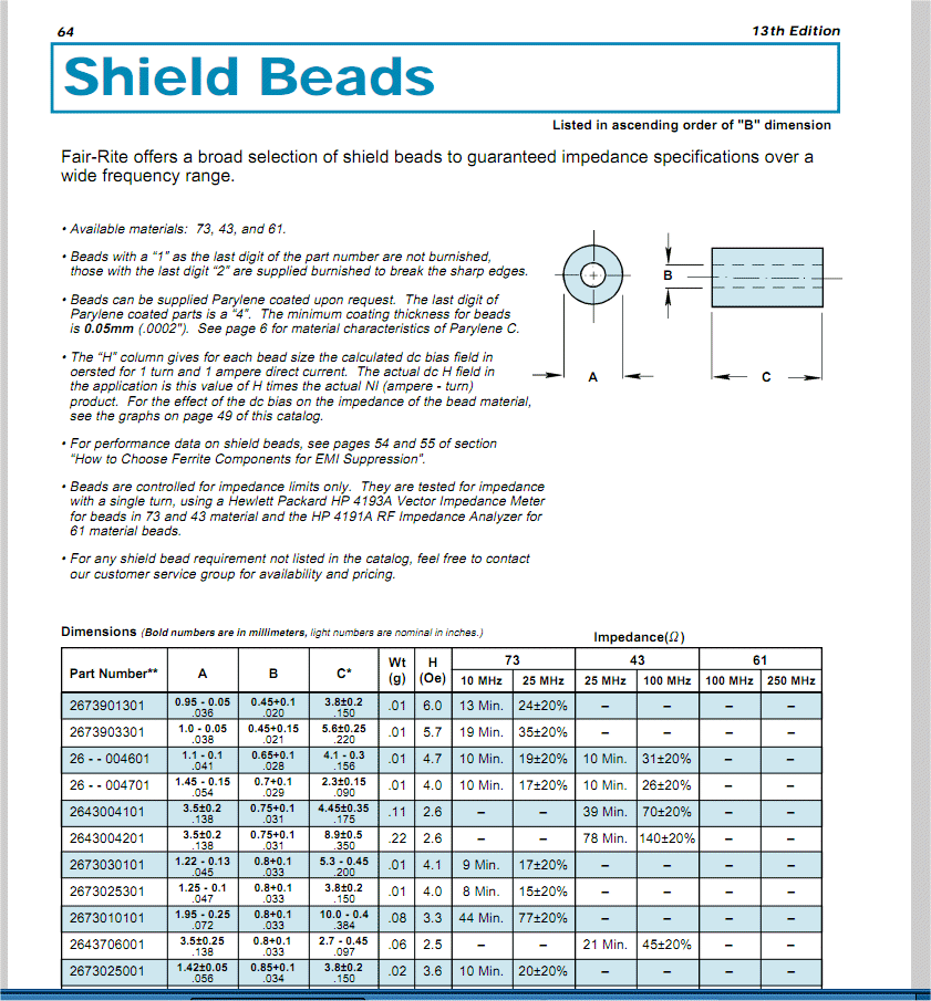

Dave , what type of ferrites ? the small ones you see on switching MOSFET gates ? (below 1)
Where would you put them ... on the base leads ?
OS
Hi OS
The f14 ferrite needs to be in series with the vas emitter and preferably as close to the vas device as possible. If you use a small emitter resistor on the VAS then the f14 or F25 bead could be installed over the resistor lead closest to the VAS transistor.

So integrate it with the degeneration resistor that is VERY close to the main VAS device (R17 below) ?. Insulate the resistor lead and pass 2 turns through the f14. Just to be sure ... is this a f14 ??
BTW , you realize this amp has "magical sound". I can't get over it ... had to get new tweeters and mids (below 1)to fully realize just how accurate it's sound was. Near perfection. I will share the final design (below 2 - r25 is just to test CCS current , not on real amp)... 0 thump (not even a "glitch" on the CRO) , 0 offset (0c - 60c) , can't be overdriven , and 100% awesome sound. It will run from 10V to 80V rails maintaining it's 6mA CCS current.
I've built every voltage stage out there and this one stands out. I can swap stages in 30 seconds , so I KNOW.

Os, those TV baluns look the part, grade-wise. If they were for VHF reception, rather than just UHF, they'd be suitable. If you have access to the ARRL handbook in some form, it's usually a great guide to ferrites. I see there's some guidelines there too in the catalog you posted. The 6-hole "bead" Dave is using is, in my example, 6mm dia. x10 long.

Yes they are probably 3x standard beads. I will set up a bread board test cct and sweep Z over 1-50 MHz. I should also really use a 10mA dc bias to better simulate a VAS environment.
So integrate it with the degeneration resistor that is VERY close to the main VAS device (R17 below) ?. Insulate the resistor lead and pass 2 turns through the f14. Just to be sure ... is this a f14 ??OS
If it's sold as a vhf grade former then yes it's probably what I call F14.
It's a specific blend of nickel + zinc that's effectively lossy > 10MHz.
NAL F14
Fair -Rite ferrites
This would seem to be the equivalent part in the US. The nearest standard Ni/Zn grade is 43 and fig. 1 (unwound) appears identical. As Dave suggests, a few smaller, plain beads may suffice. I guess we'll hear shortly.
Fair-Rite Catalog | Wound Beads
