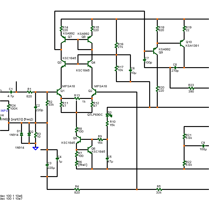

I use 100p/270p with a 470R TMC feedback resistor , this matches my bode plot for a 47p traditional miller SM cap.

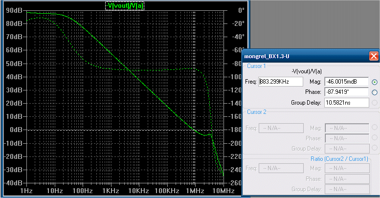

Increasing the resistor, the compensation converge
to a classical miller comp.
I simulated with a 100pf/220pf/1K network..

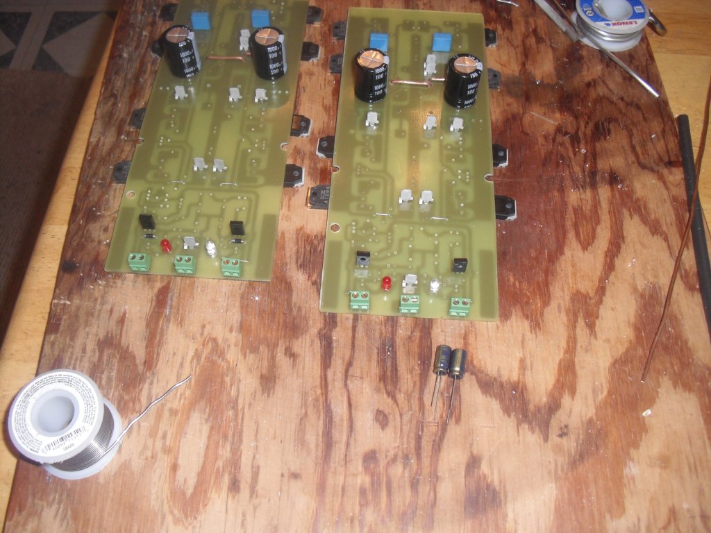

As you might or might not know , I jumped on E. stuart's TMC implementation with the blameless. I had 2 pair of blameless modules (AX,BX- below). I ascertained that it WAS working on the actual module(s) as I was able to even grossly underbias before the onset of audible Xover distortion. subjectively , I will say my search for the best sounding amp is over (pix 2- FFT) , it is below. Carlos (DX) came close (blame ES-ST), but I like low noise inputs and gobs of power at under 200ppm (below 3 - amps).
I also TMC'ed the AX , which for all purposes is a ULD voltage stage. It sounded wonderful if not sterile. The 2 gold panasonic EE's (front- pix 3) do actually give life to the sound , hard to believe with a amp that does 12ppm at 50w/1k. As I might of stated before ,100/270p with a 390R TMC feedback cap gives exactly the 875KHZ UG point as a conventional miller of 47p (pix4 - BODE). Clipping errata is the same (tested on my 40v rail setup - bx1.3) , I now move past the prototype , on to the good sound.

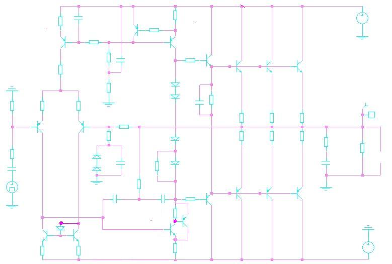

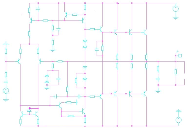

VHF man,
Please post your revised schematic.
I modified the Ostripper schematic.
The first schematic is what I'm using now and the second (alt2) is the next (preferred) variation.
Variations include TMC, a diode in the CM and VAS degeneration.
I prefer the CFP VAS. It sounds better and avoids the bias problems that the darlington can introduce.
FWIW, the amp sounds fantastic. Much better than any commercial class AB amp I have ever heard and miles ahead of a Meridian 557 that I use as a reference.
