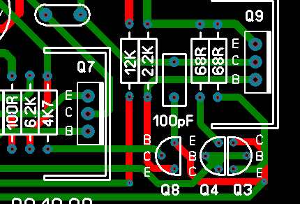

Attention all,
Hugh Dean has been busy working with Peter Doyle to debug his amplifier and they have found two layout mistakes! Both undoubtedly slipped in at the same time and are located in the same area of the PCB. The good news for those of you that have fabbed PCBs the fix is an easy one. By the time you have read this I will have updated the layout and gerbers that are online for download and post the URL again.
Error #1 before the fix
And now the fix to error #1. The trace between the 470uF cap and 10 ohm resistor is no longer shorted to the 100 pF cap
And now the fix to error #2. The 100pF cap was not properly routed to the base of Q8
Thanks to Carl, Hugh and Dean for their work. I imagine that these sent them a little stir crazy. Probably wanted to 🙁 😕 and 😡 and
and
but in the end their just 😎 and 😀.
Well done.
Terry 😱 (well I did check the board.)
Well done.
Thanks Carl!!
No cigar yet. 🙁
Peter still has to come back in ten days for instalment two, where we fix the second mistake and actually trial the amp on the test bench.
These errors might require new boards as they are tricky to fix on the existing ones, but then, there are only three boards in existence, no big deal.
In the meantime Carl will work on the existing pcb and put up new gerbers for those who would like to build their own. 😉
Hang off until we get it going and playing music....... 😎
Hugh
