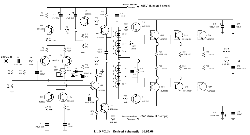

Not sure if this is real but looking at the schematic, Cdom is wrapped around the two-device VAS. I've seen a lower noise floor in the Harry77 sims if you don't do this. I put Cdom around the 2nd device only so that it's being driven from both ends and not from the LTP.
In this design which is a variation on the DS blameless theme the 2 VAS transistors are in effect one high beta device so it's correct that both are nested within cdom. This results in a much lower VAS output impedance (XC/beta) which in turn reduces some of the gm doubling induced distortions.

My schemat is V2.0i, with no designations, so I will assume that C2 is the LPF in the input - silver mica is fine and dandy and my preference anyway - and C12 is the 150nF Zobel cap on the output. For this cap, which takes the full output swing of the amp and copes with reactive kickback from the speakers, polyprop is preferred because it is, to some degree, self-healing. However, an MKS is just fine, particularly at that very high rating.
The CCS device, Q7 (pnp) and VAS Q9 (npn), could be BF470, a Philips 250V, low Cob 70MHz device and 2SC3423, a 150V 1.8pF Cob 50mA 200MHz device from Toshiba, respectively. I use them exclusively and they are wonderful devices. It is helpful to have the CCS a tad slower than the VAS.

Thanks for that, I think there are some shortcommings with this layout we may have gone a little too compact. I have been sifting though this thread and found other reccomendations from yourself as follows
Q7 2SA1360
Q8 2SC1845 Reduce emitter resistor from 2K2 to 470R.
Q9 2SC3423
Do these mods still stand ?
ps. I have attached latest schematic,

The current schematic with all the changes and part numbers that matches the PCB layout is on Dudainc's website that is referenced back in Post #260.
Nothing has changed since those files were posted. The PCB was laid out assuming parts readily available from Mouser and Digikey. The PCB is an evolution of a version that I successfully built some time ago. There were no parts placement issues when building that version of the amplifier. But then again those were common parts from Mouser and Digikey.
Nichicon electrolytics are physically larger than the Panansonic FC caps that were assumed when the PCB was laid out. I had assumed only one Nichicon cap (C5) when the board was laid out.

Stay with 2K2 rather than 470R for the EF load resistor...... I agree with Sandy.
The A1360 is a Toshiba device, complement to C3423 in fact, and while it is fast, I always prefer to have the active device, the C3423, faster than the CCS which serves it. So leave the BF470 as is, bearing in mind it has very low Cob anyway, around 2.5pF.
Carl,
I think your layout is brilliant, and I doffs me cap. I certainly could do no better. I also applaud your component choices, Digikey and Mouser are excellent references, and your choices should make the amp rather better than the original. I've a couple of the SC boards here, courtesy Jeremy Howard, and they are NOT well designed at all.
My concern about this amp rests with the biasing scheme and the new diode equipped outputs. There is sufficient flexiibility in Carl's design to skirt around this should it prove tetchy, however, and I strongly endorse Carl's use of higher emitter resistors, 0.22R rather than 0.1R originally specified.
Optimal output stage bias changes with emitter resistor choice. It should be 26mV regardless of this resistor value; for 0.47R this means 55mA, for 0.22R it means 118mA, close to that actually recommended in the original design. For 0.1R, note, it means the optimal bias level in the output stage should be 260mA!!

The emitter resistors in the final schematic are shown as .22R. Those are Mouser #280-PRM5-0.22-RC. The PCB layout assumes that part number. The value can change but the vendor and part family cannot without placement problems.
You can use a Nichicon MUSE SE 47uF 16 volt cap for C1 if you like. That one fits.
