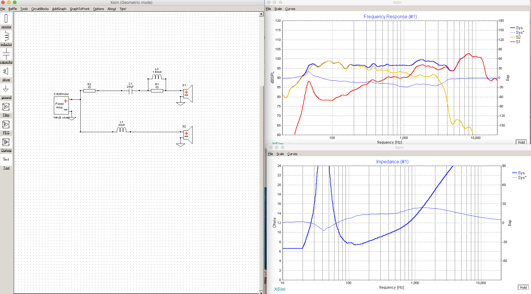

Here's a quick sim of the two drivers.
You can start without the BSC (L3 and R1) at first.
If you feel the driver is too bright, you can add it later.

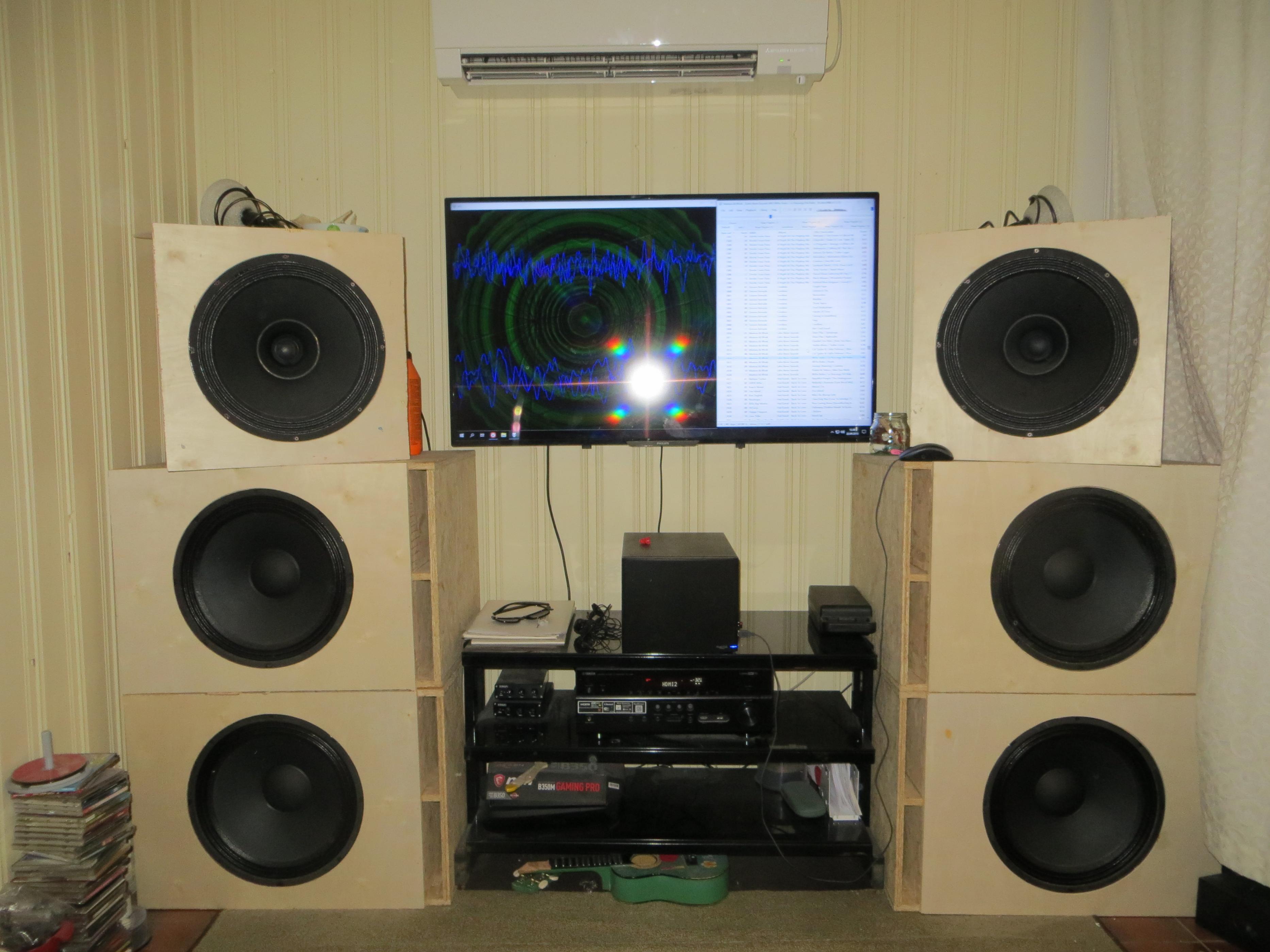

As the drivers break in they sound better and better. I have 2 full range and 2 LF 15 inch Fane drivers which cost me $760cad, a minidsp $150cad and Baltic birch ply, cut at the lumber yard, for the final cabs $93cad for a total of almost exactly $1000cad. I had to buy a second amp, a Crown D75, more cables and connectors but expect the total to be under $1500cad. A great price to performance ratio.
I am using a Fane Sovereign 15-400LF per side for low frequencies and am satisfied with the response.
200 hz Bessel in a minidsp which I believe is 12 db/octave. Should mention this is on a 60x100 cm baffle.
Thank you KaffiMann for reposting. mauri99, you are too kind, in that what I have done is similar to the efforts of other members. Keep it simple. Measure the drivers before you cut holes in the plywood. My drivers are 385mm not the 381mm listed on the spec sheet. Set up a crossover and listen, it takes quite a while for the drivers to break in. Then you need a measuring microphone and use REW, seems to be the most popular choice in software, and it's measure, adjust, measure, adjust till you like the result. Obviously, easier done in the digital domain. I put small wheels on the speakers as you will be moving them around to adjust the sound in your room. Sit back and enjoy.

mauri99, I'm very satisfied with the results. Full bodied, natural vocals, strong mid-bass are some words that come to mind. I have screwed 8-10 cm wide strips on the back side near the baffle edge as much to hide the drivers from view as to bolster the bass. I have used speakOn professional connectors since they are cheap, lock in place and were ordered in different colours so I don't confuse which wire is for the full range or bass driver.

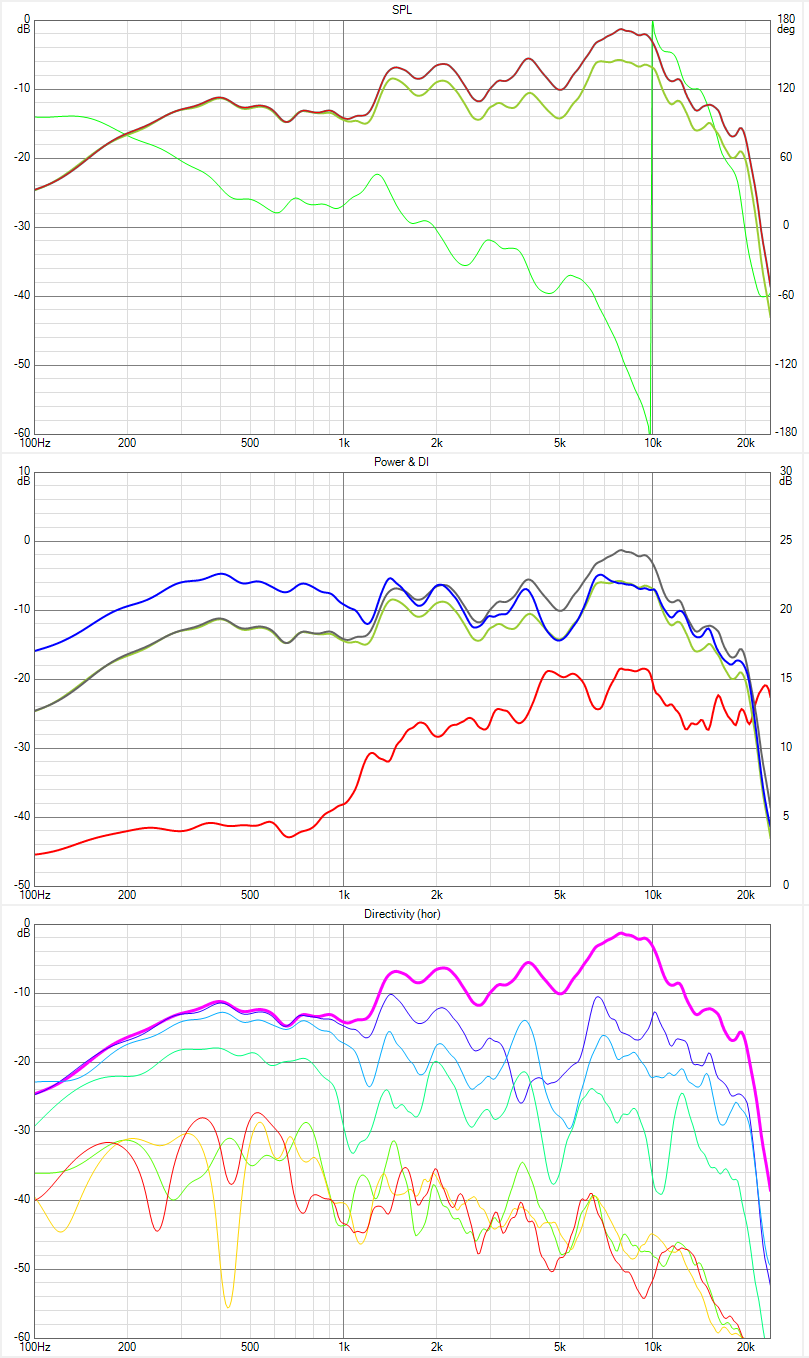

The measurements attached are in the test baffle, h115xb50, with rear damping by thick carpet, no EQ, 6ms window, 15 deg. steps 0-15-30...180 degrees. Not calibrated!
Note the lack of strong peaks in the power response (middle, dark blue)

Hello Thimios, I do not have that setup myself, I am using the now discontinued Fane 15-400 for bass, 2 per channel in ca 120 liter vented box per bass driver, and my beloved FC152 are in ca 80 liter sealed. Here is a picture anyway.
Will be several more days before I can hear them again
Looking forward to firing up the system maybe on saturday.
