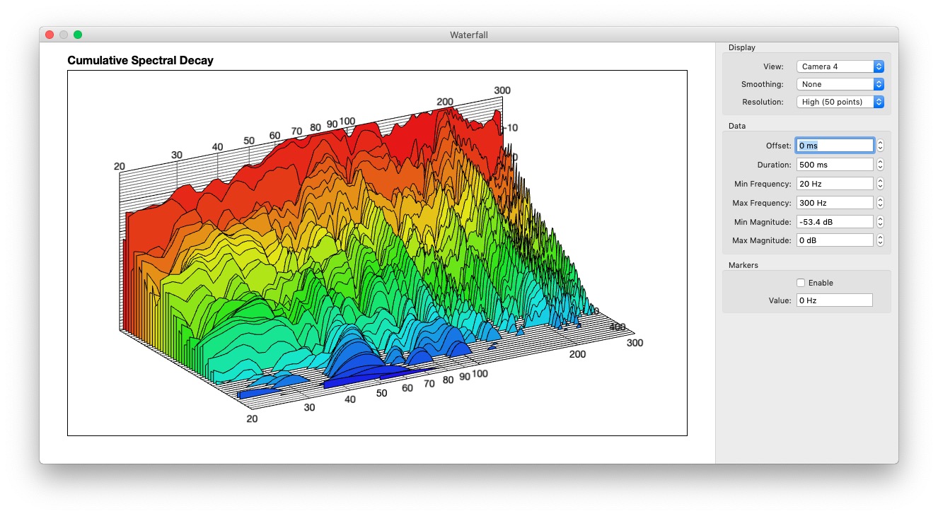

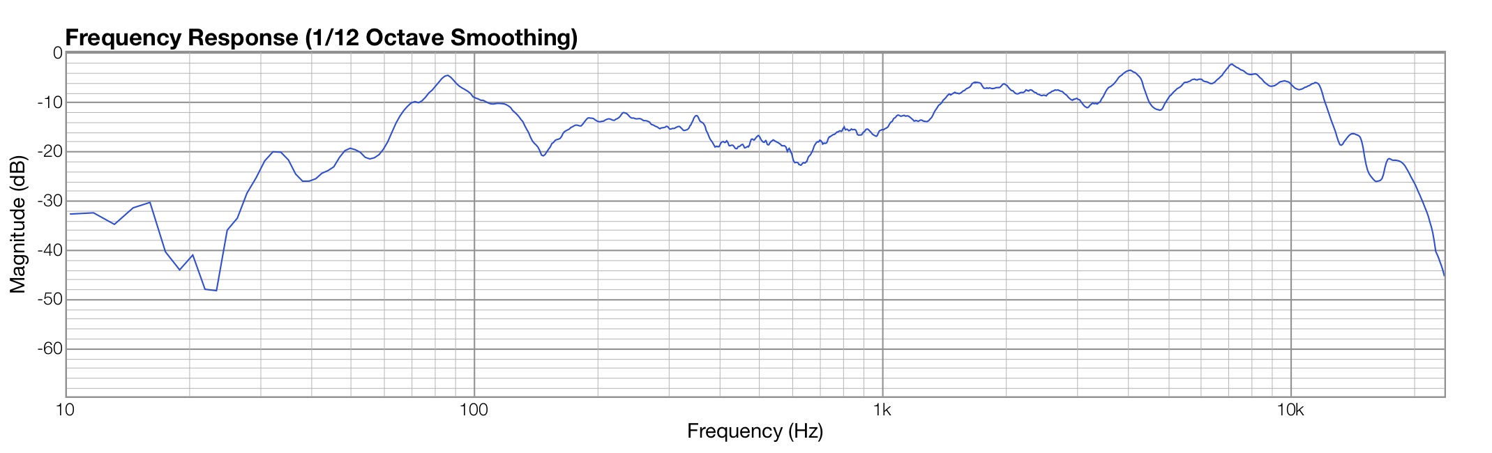

coating

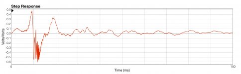

Hello
I like experimentating even if I don't really know what I am doing..
After reading some articles about whizzer coating, why not give it a try?
Don't have varnish on hand so I used this glue:
Tolex Kleber SG5, 500 ml - Tube-Town GmbH
It is a soft glue, it probably does not stiffen but dampen.
one layer on each whizzer, two layers on the dust cap.
Measure on axis mic at about 40cm.
As expected, sound presentation is different, less "sparkle" but not "dull".
More "relaxed", it sounds now a little bit more like a multiway speaker.
Take a look at the FR from 300Hz, it does not tell the story but that's interesting.

Your experiences match mine, more or less. But that measured reponse? From only just a bit of glue? I do not believe it, it is ruler flat from ca 2400hz to ca 12khz. Are you using DIRAC? Off axis response would suffer greatly, with an on axis graph like this.

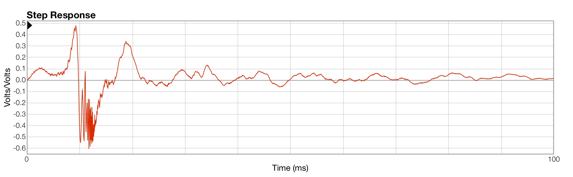

EMK2, how is your mic placed? Your impulse and waterfall doesn't seem to match with the FR...
The mic was placed at 40cm in front of the speaker but as I don't have a tripod, it was set on a box (to be at the right height). I'll take a picture and do measures again.
Yes, measured response, no EQ at all. Only glue. Hard to believe, I admit. As said, I'll redo some measures later.

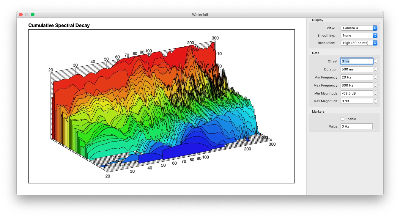

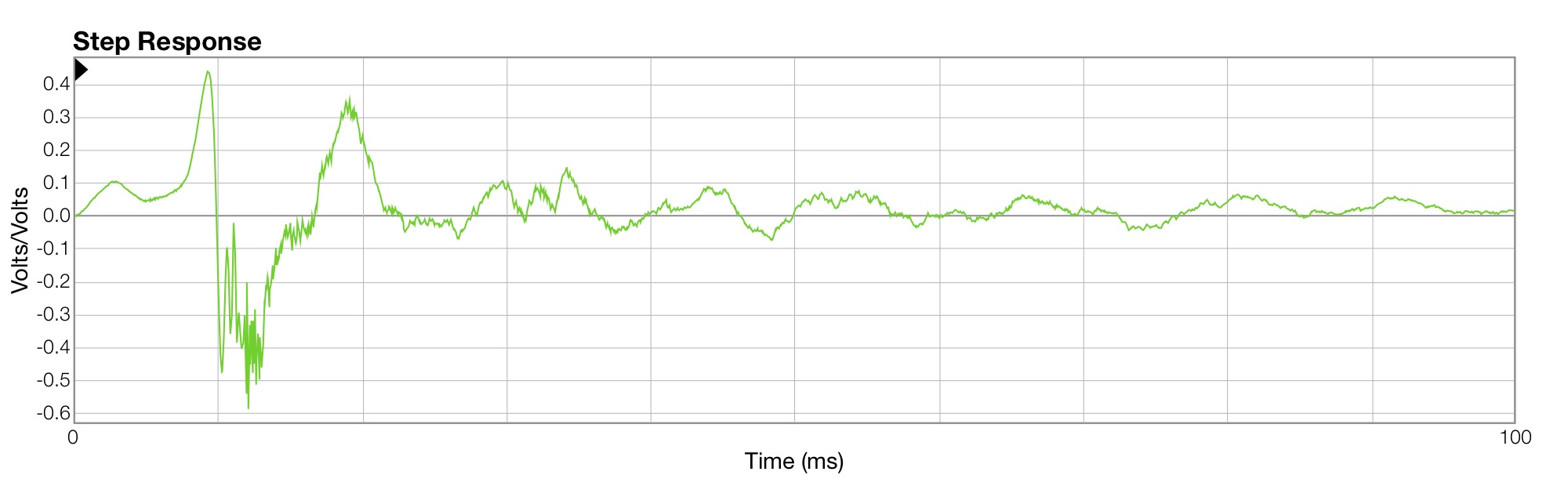

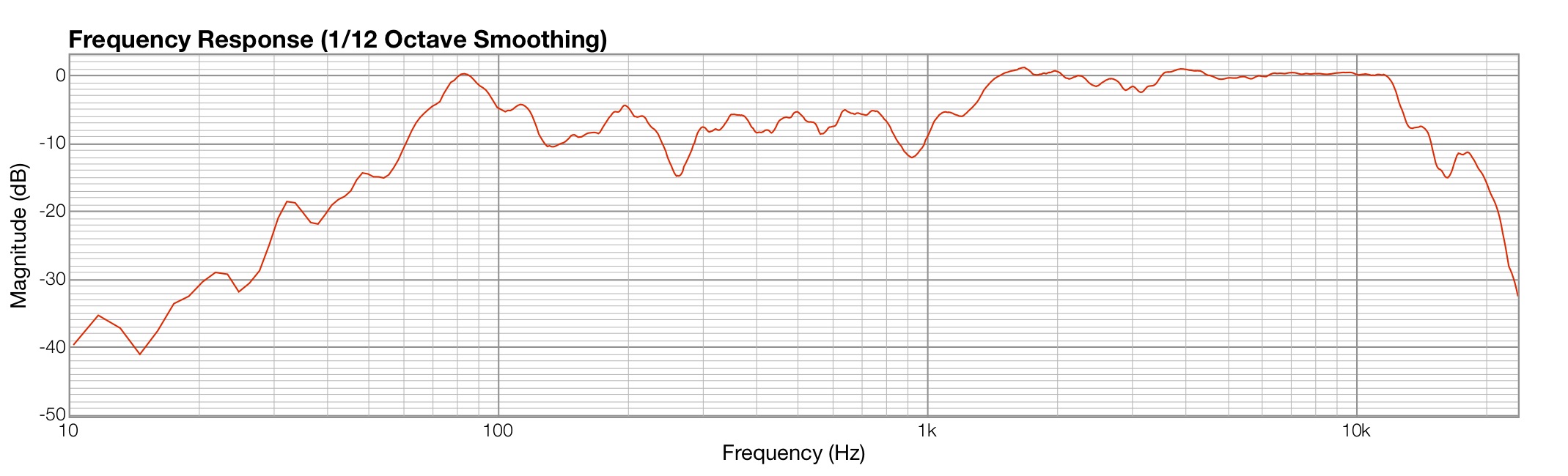

Attached another FR, mic about 30° off axis, 40 cm distance too.
Forgot to post it yesterday.

... I do not think it looks any better, the peaks and dips have shifted a bit, but the response is maybe a tiny bit less smooth, too much glue perhaps? The 1800-2000hz shelf/peak behaviour has shifted to maybe 1500hz and seems steeper/harder to deal with, you've lost some top end also, I suspect it drops like a rock off axis, do you have any more measurements?
It looks more pretty since you have 10db/div, for instance there is a ca 8db difference between around 1300hz to around 1500hz.
