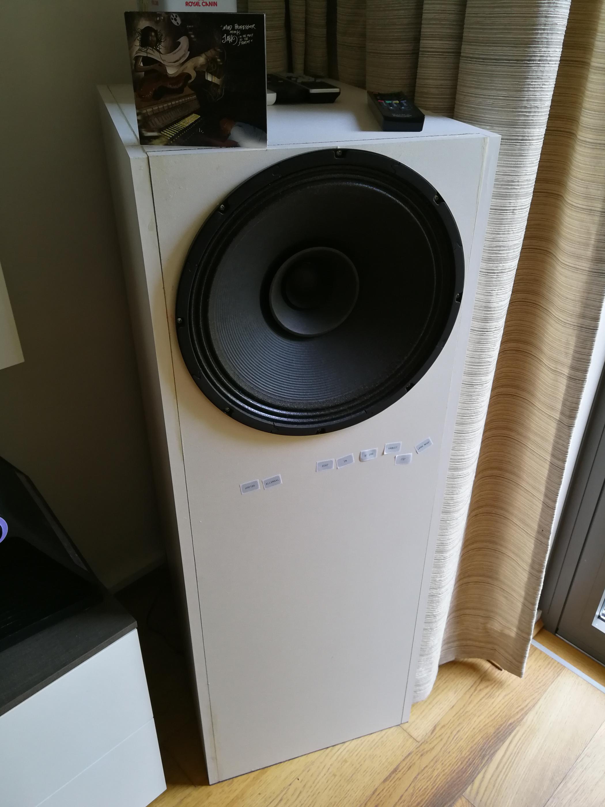

I have them in my backloaded horns, they are a kind of BIB variation. I drive them with a Marantz NR1603 slimline AVR with Audyssey MultiEQ auto-equalization. No foam or other driver tweaks.
In-room response -3dB is below 20 Hz before EQ. I can hardly feel the cones move. Presence or absence of bass does not seem to affect mid/high performance at all. I really don't miss subwoofers or feel I should unstrain the Fanes.
I feel the community is slow to recognize the driver for what it is. It's one of the best fullrange drivers available in its price range. More people should be building cool speakers with it.
Here's a picture of the horn.
Simple, non-threatening. ;-)

I used BIB design rules for proportions for a simple and reliable design procedure. I think it would look better if it would back up a bit more, and I really like the look of the Jensen Imperial corner horn. So I am slowly working on a redesign in that style, wider and shallower, angled rear corners etc. But I want to get it right and use good materials, so nobody.hold their breath.

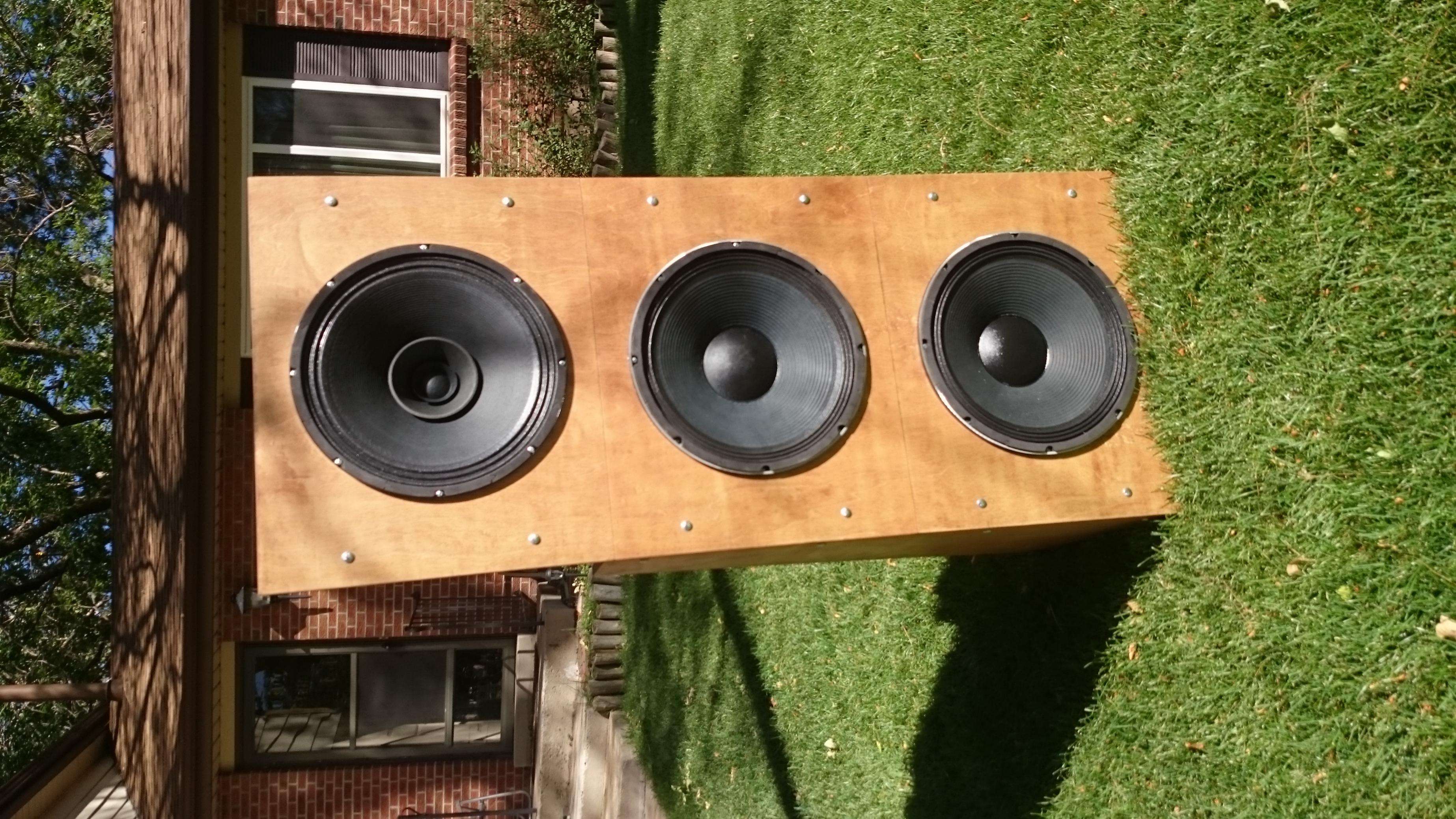

Ivo, thats impressive deep bass, good job. These Fanes are a well kept secret. There is more performance to be had with some mods. I plan to post some info on the mods too. My build is an open baffle with two MCM audio 55-2963 woofers.

bknop, are you running sans filter? What mods are you planning?

Kaffimann, the bottom woofer has a 15mh coil (Erse super q). For the top two, I've been messing around with both series and parallel crossover types. For series operation there is a. 68 uf cap and about 70 ohms Aresistance across the mcm woofer terminals. I may try putting a large coil like 10 - 15 mh across the Fane to reduce cone excursion if I want to play them at near concert level volume. Changing the resistance is a great way to adjust the mids. For the parallel crossover, the middle MCM gets a .68mh coil, the Fane gets a 2.25 mh coil. A .68 uf cap and about a 14 ohm resistor in parallel with the 2.25 mh coil, the bottom woofer a 15 mh coil. These values are aproximate as I have not finalized the design.

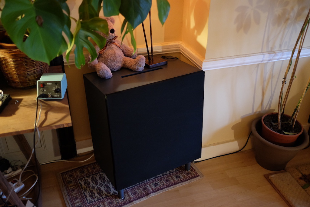

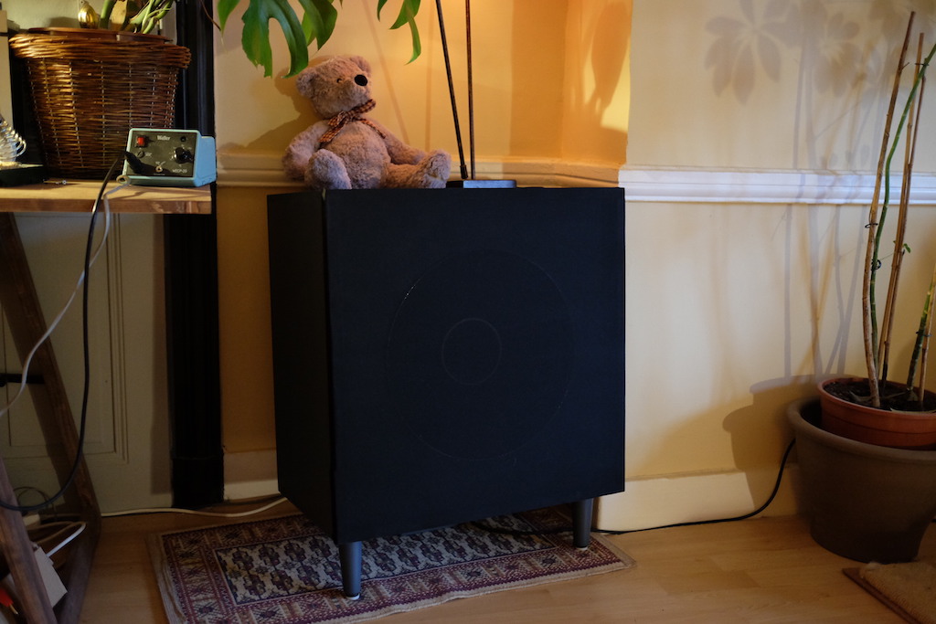

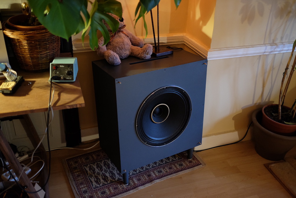

Ordered a pair of these Fane exactly one year ago, still very pleased with them.
To me it's a mistake to dismiss them because they don't have a big strong magnet.
Not boomy in a small 90L enclosure, even vented.
Plenty loud with 1W tube amp.
