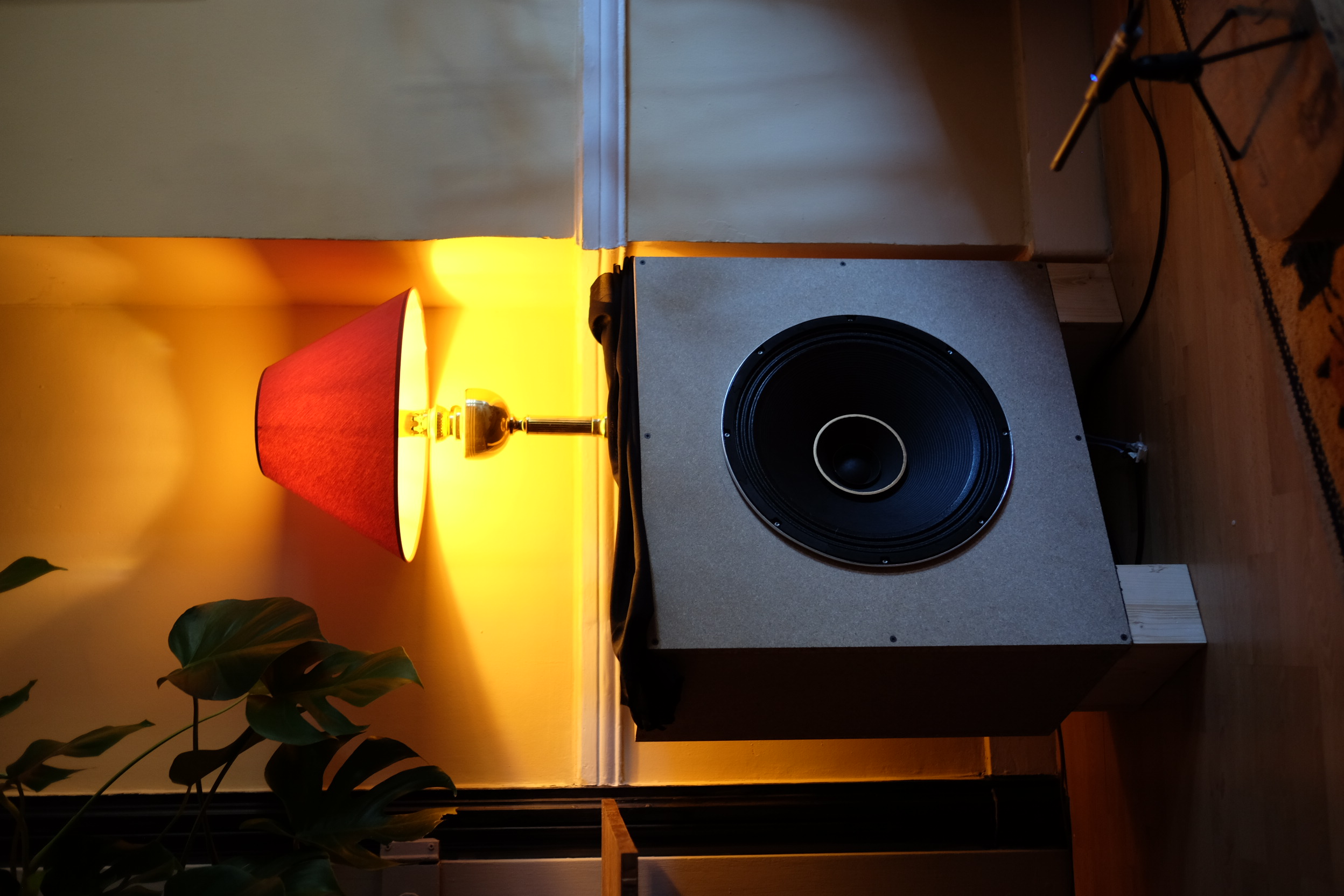

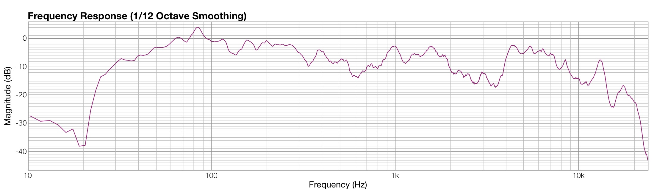

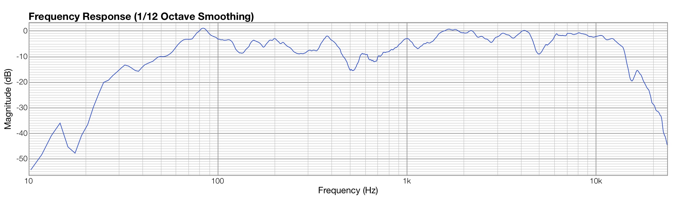

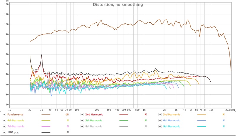

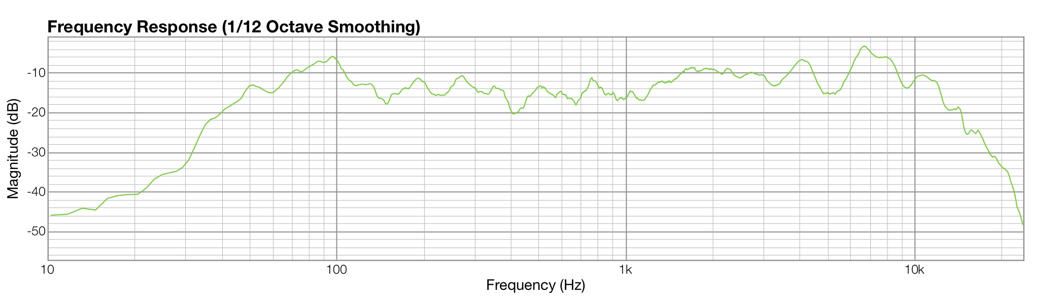

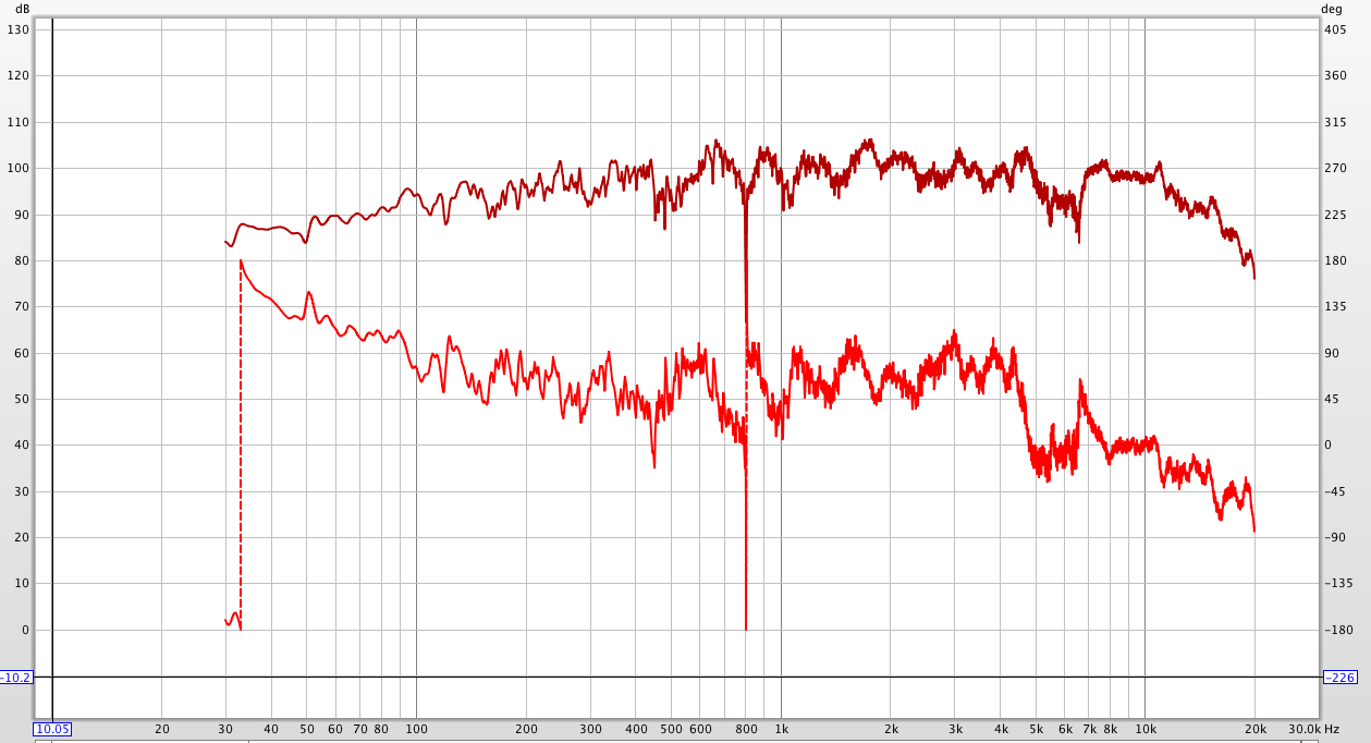

Some outdoor measurements of the 12-250tc I made with REW, you will need a copy of REW then just open the file with it and you can play with the data until your hearts content.
Loudspeaker on a 14 inch square ish baffle, approx 5' off the ground on a tripod, Earthworks M30 mic approx 1m away, boundaries approx 5M.
'no f = no foam'
Outside 5inch1x30mm1x20mm1meterdist.mdat - Google Drive
'no f = no foam'
Just finishing of some CAD drawings now for some 12-250tc's to send to get CNC'd for stage monitor duty, with a foam acoustic lens, a 40L box and 150 taps of FIR these things will sing for small to medium size stage use, prototype is excellent, extremely well behaved step response, loads of gain before feedback and an awesome vocal sound, useful down to 70Hz.

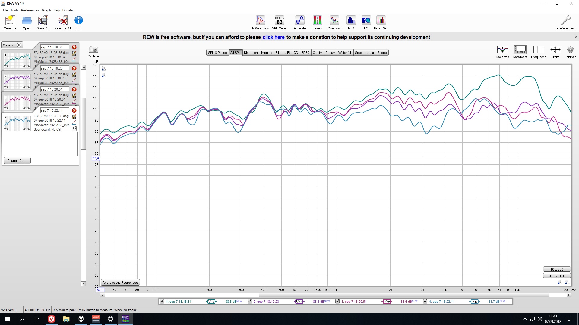

Adason: Here's what I think might be 0-15-25-35 degrees measurements.
Again, this is in-room, noise floor is ca 36db, and there might have been stuff rattlin'. I was wearing ear protection so couldn't tell.
And this is just the FC152 going solo btw.

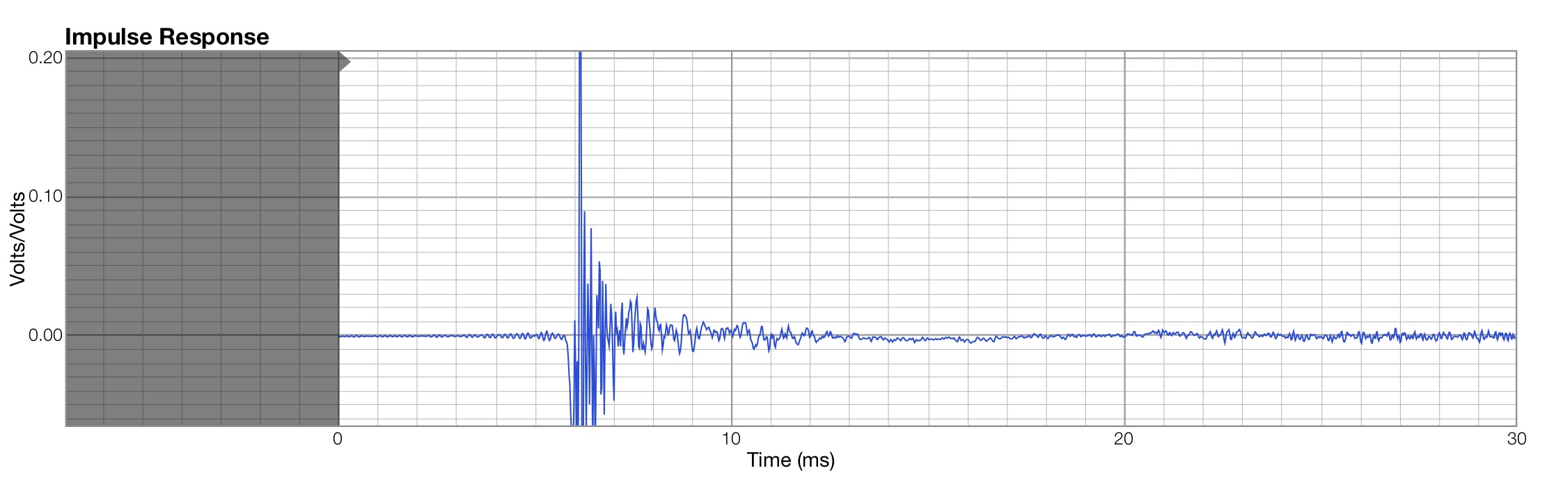

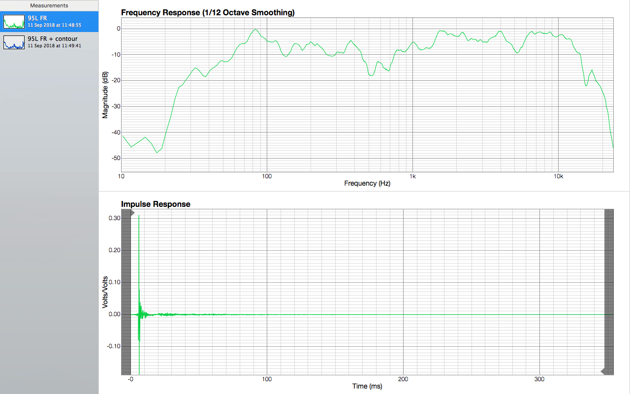

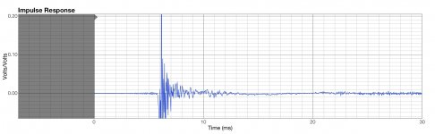

I've been listening these 15 inch Fane's for a several months in a OB setup 120cm tall, 60 cm wide baffle. Now I decided to listen little 0.53x Karlson's with Dayton Audio drivers. Funny thing is that these Karlson's require little bit more volume from the amp than the OB setup.
Now in a 92 liters box (55x55x30).
Very disappointing at the begining, serious lack of low end, even with a vent.. until I added rockwool on the back face. Something were self-cancelling 😕

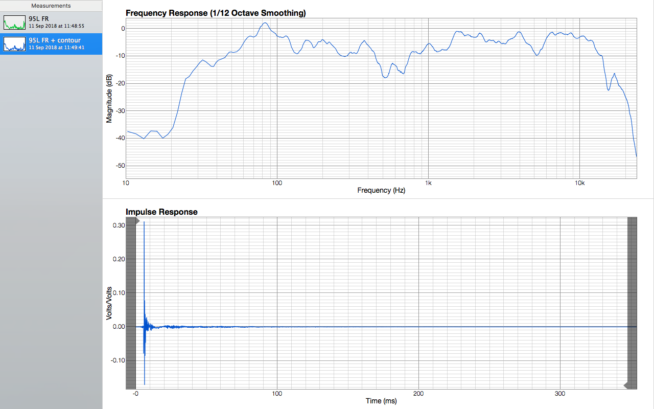

Two measures on-axis at about 40cm, one with "contour" (from Rotel RC-1070 preamp).
Do you know what is the cause of the dip in the 450-750Hz region? it was near the same with a 145 liters box.. but not when OB.
Thinking of build big boxes this time but with a limited depth.
Something like 30cm D x 55cm W x 125cm H.
Is there a problem with a small depth?
How much rock wool did you add?
Did you try moving the speaker 30cm in one direction and measuring again?
Are the dips the same?
I don't like thin enclosures, especially for woofers. The energy that is bounced back can be very detrimental to the sound.

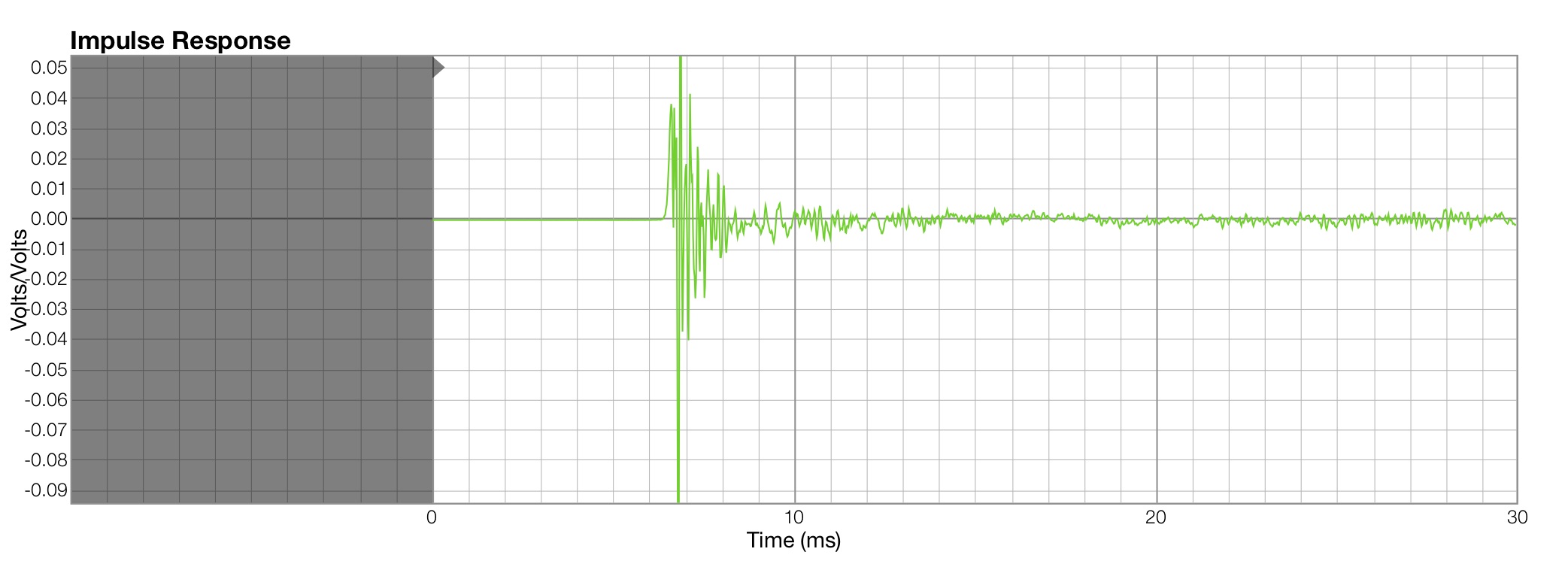

There's also no way to see anything with the scale of your impulse graph.
Try to limit the time to something like 30ms.
Let's see... 573.3Hz
345m/s, divided by 573.3 = 0.60 meter, of which half a wavelength is 0.3 meters. So that correlates with the depth of your box. But I see your box is also 0.55 high and close to the ground, which will also cause a cancellation at the same frequency. It appears to be an unlucky combination of dimensions. You might be able to fix it rather quickly by raising it substantially off the ground and putting more damping material in your enclosure. But too much sounds less good, so maybe you could place some diffusors inside the box.
There.
Diffusers and a bit more rock wool, I would also do at least one side wall.
Another thing. I don't know if other users of the Fane can correlate the impulse you got. There's a lot of action happening in the first ms, then slowly quieting down 2ms later.
Maybe you still have the impulse from when you had yours on OB. Do they still look that ragged in the first couple ms?

Thank you both.
Tomorrow I'll add some rock wool (this time where speaker is mounted on?) and also on one side, and raise them from the ground.
Yes, see attachements, it doesn't look very good too 😕
The measurement was done last year, if I remember correctly it was a basic OB 2 meters high, 60cm wide, speaker centered at 1 meter but NOT centered wide.
Mic at about 2 meters more or less on axis (by hand).
It would be nice if we can get others using the Fane 15 to post their impulse as well. Might tell us a bit more about your box.
But, yes, I would add some more rock wool, and one or two sides as well. Or a side and the "roof".
Moving them off the floor would be a good idea too.
Then, measure again and see if it helps.

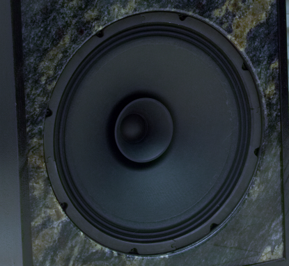

I have a pair Taiwan made 15" full rangers that also work reasonably well. Mine are on OB, and here's the impulse I have.
Let it play for a week before doing any decisions. Curious to know what you did on the steel frame and the main wizzer there though 🙂
Which driver is it? 🙂
Just some very light paint on the wizzer and "chrome" trim on the outside 🙂
This morning I added some rockwool on "roof", one side and a bit more in front of the magnet.
One measure on axis at about 40cm, another off axis (mic to the right, 30 cm from center).
Speakers not raised yet from the ground., I'll try later.
Locally made driver. Factory is in Taichung. They used to be bigger, but now most of the factories relocated to China. Very few left, including this company and another famous Taiwanese company, Usher.
Nothing much in terms of new tech into these speakers. They just continue to produce some with their old ways. Still ok and the ratio of quality vs price is very good, these drivers cost $84 each.

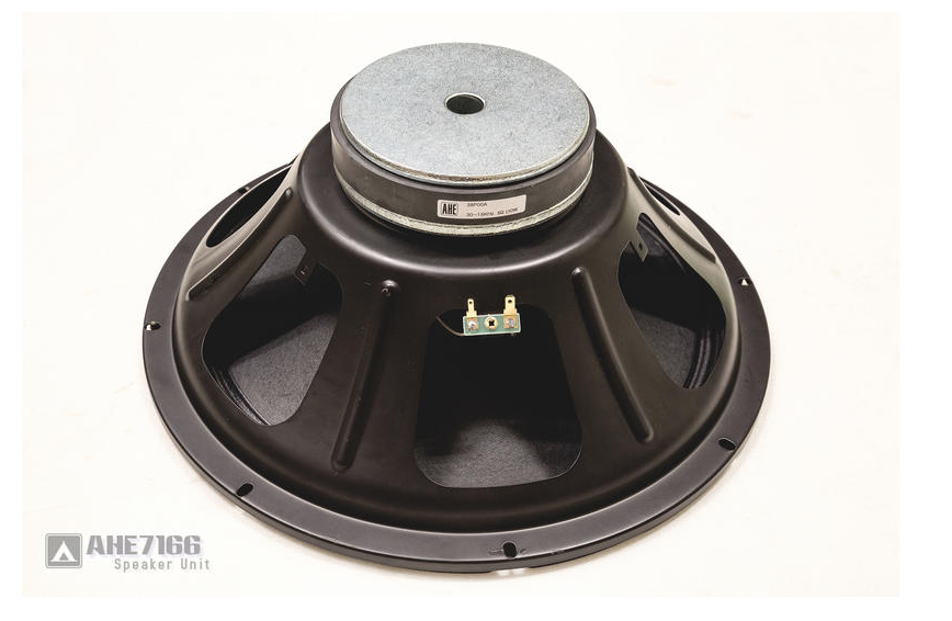

Those measurements look pretty good. I'm guessing that's with the EQ shown in place.
I wish they'd done these with a more powerful motor so they'll go into some compact stage monitors.

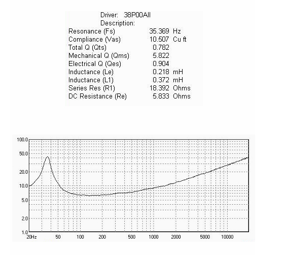

Just a quick follow-up on this.
Around 25x neo rod magnets (20mm long, 5mm diameter) and a large jubilee clip to hold them all to the magnet resulted in the Qts moving from 0.925 to 0.876.
I did get some steel bar to try adding, which would join the neo magnets to the top/back plates of the driver, but it doesn't look like there's much point in persuing that further. At least, not with the magnets I have at the moment.
